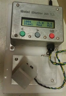

Homemade Electro Etching Machine
gelandangan on homemadetools.net
Homemade electro etching machine utilizing saline electrolyte and silk screen stencils to create permanent marks on steel. Compatible with both AC and DC operation, current application time can be varied between .5 - 30 seconds, in half-second increments.
