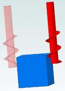

Homemade End Mill Effective Diameter Measurement Method
rgsparber on homemadetools.net
Homemade end mill effective diameter measurement method comprised of making precise cuts on a block of scrap aluminum. Actual measurements are then compared with DRO readings to yield the effective diameter.
