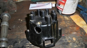

Homemade engine timing aid consisting of a surplus distributor cap drilled to facilitiate direct observation of rotor position with respect to the timing mark. Utilized to verify that the engine is on its compression stroke.
