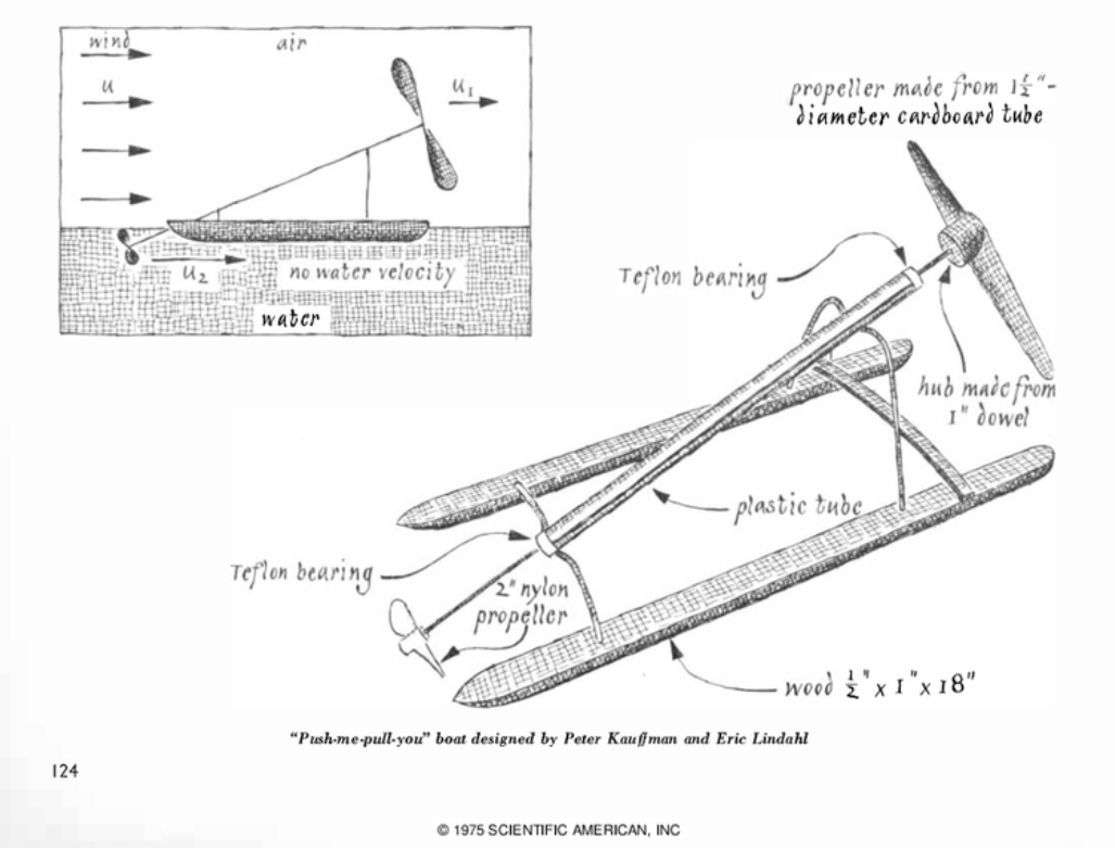

Over 45 years ago, when I was still "young and promising" I read a Scientific American article* on this concept,
but instead it being a wind powered boat going straight into the wind.
It could actually only go into the wind by its very design:
It was supposed to have a pulling propeller in the water, powered by a slanting axle up to an air driven propeller:
Attachment 40065

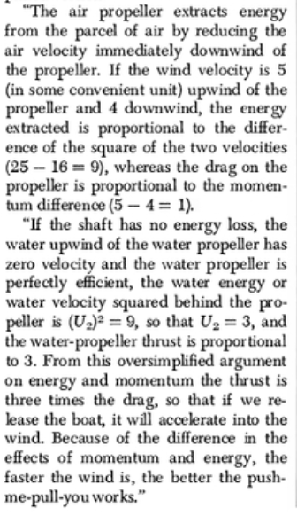

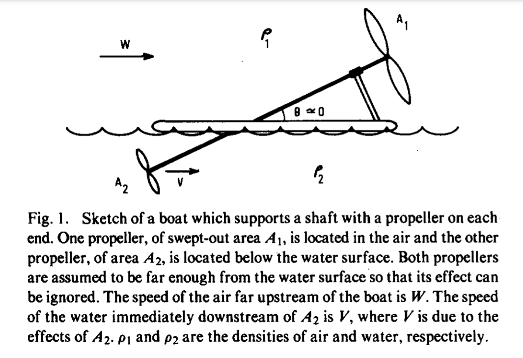

Still remember the "The Push-me-pull-you boat" title of the article,
which apparently came from Scientific American [Martin, Sci. Am. 233 (No. 12), 125( 1975)..]
(which I back then occasionally read at the city library),
and I could even found an online analysis of of it this morning (the article, stupid - NOT the library!):
Attachment 40064
Attachment 40063
