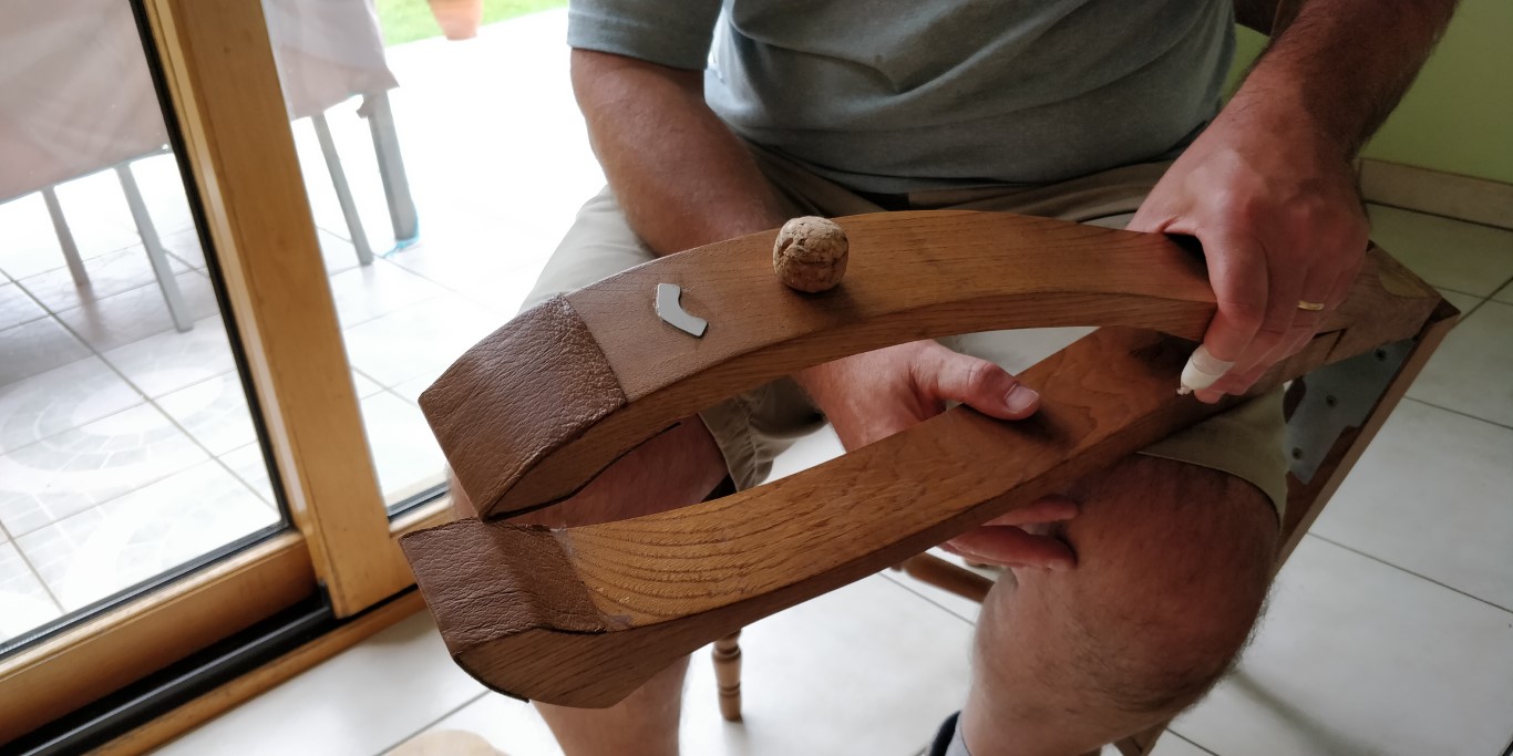

Hi,
Different from the stitching pony and stitching horse, here is a stitching clamp (some even say clam in English) we use the most in France, even in the greatest houses like Hermes.

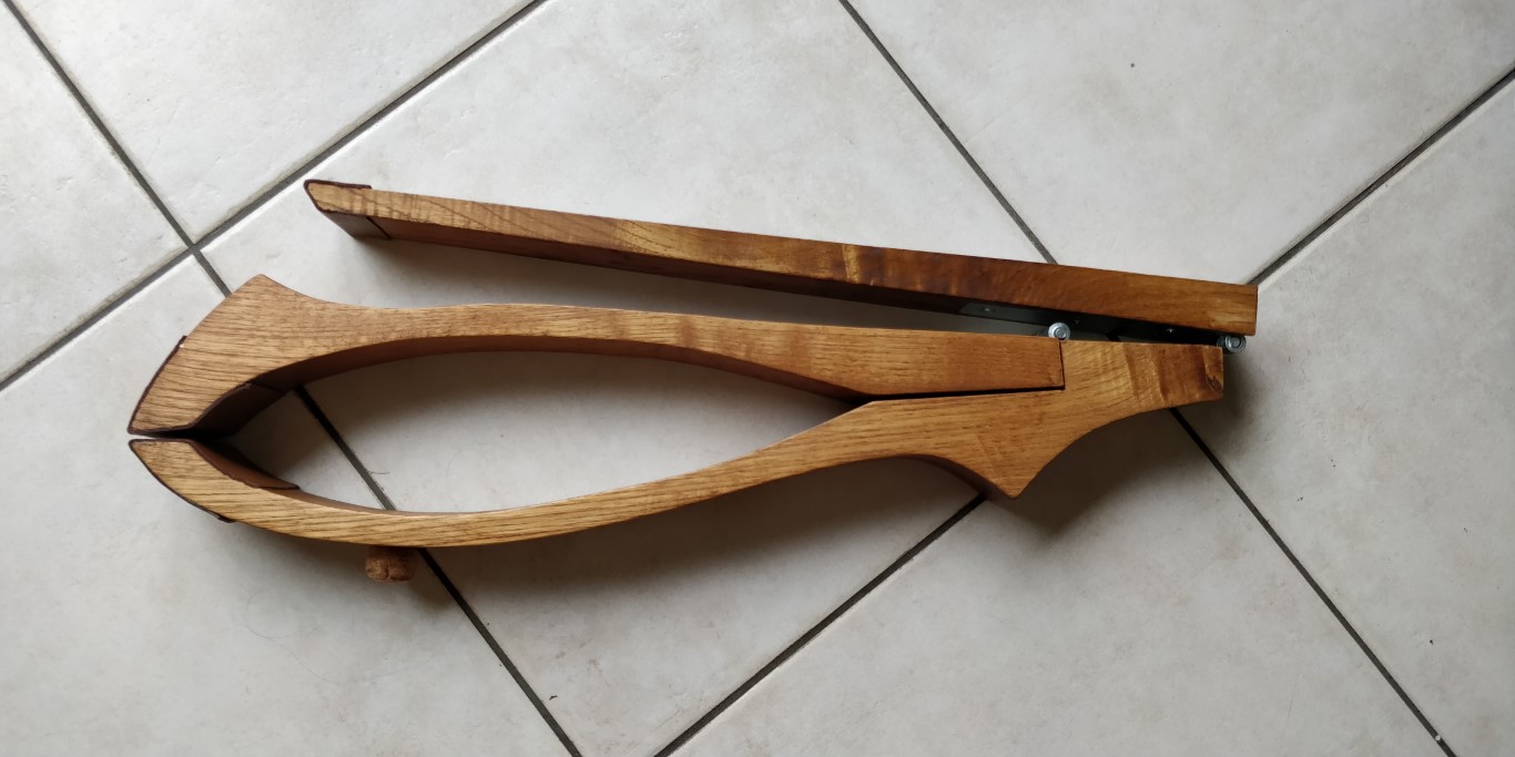

This is a three pieces clamp with a fix jaw, and a mobile jaw, nothing in between, leaving full room for holding a big piece between the jaws.
And there is a leg pushing down to the ground.
I made mine out of chestnut tree wood (common where I leave), taking care of the orientation of the grain.
It is stained, pore filled and waxed.
For those wishing to make one, I provide my drawing here below at the end of the post.
Here is a full picture :
http://www.labellenote.fr/file/homem...llier_0001.jpg
The leg is foldable for convenience :
http://www.labellenote.fr/file/homem...llier_0002.jpg

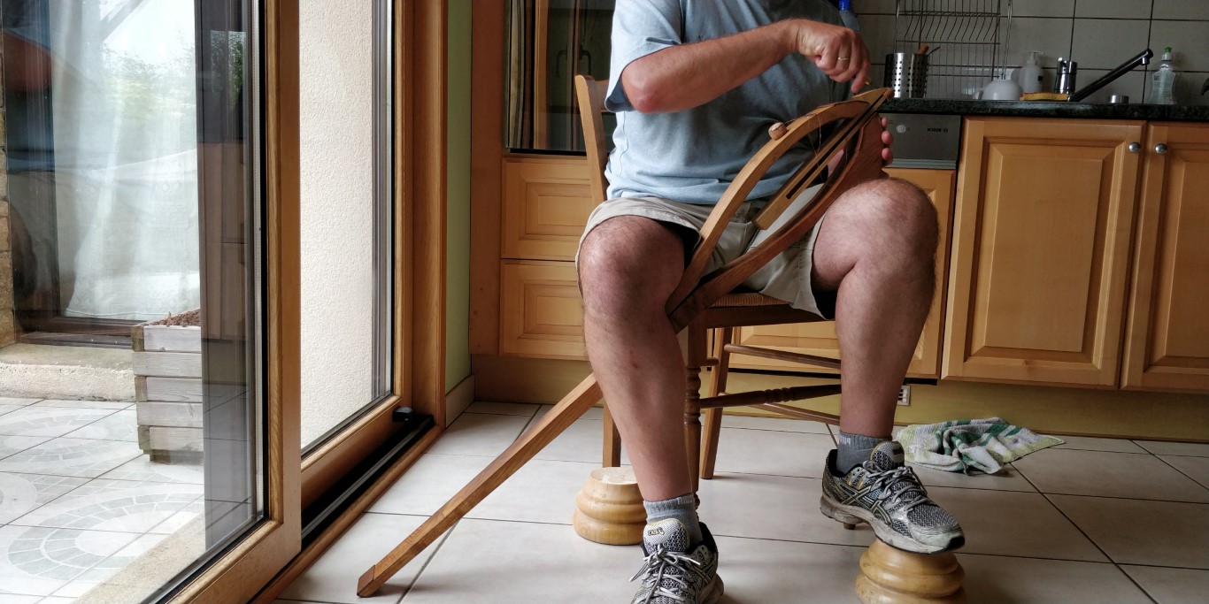

It is used between the user's legs, and it is the upper leg that presses down onto the the jaws in order to close them.
The big advantage is that you don't have to unscrew anything to progress on your work, you just have to lift a bit the leg in order to release the piece.
Note that you can also raise your left foot, like a guitar player, in order to get closer from your work:
(on this photo, I'm using an extension small clamp I will show next time)
http://www.labellenote.fr/file/homem...llier_0006.jpg

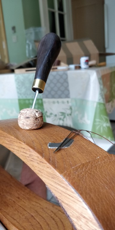

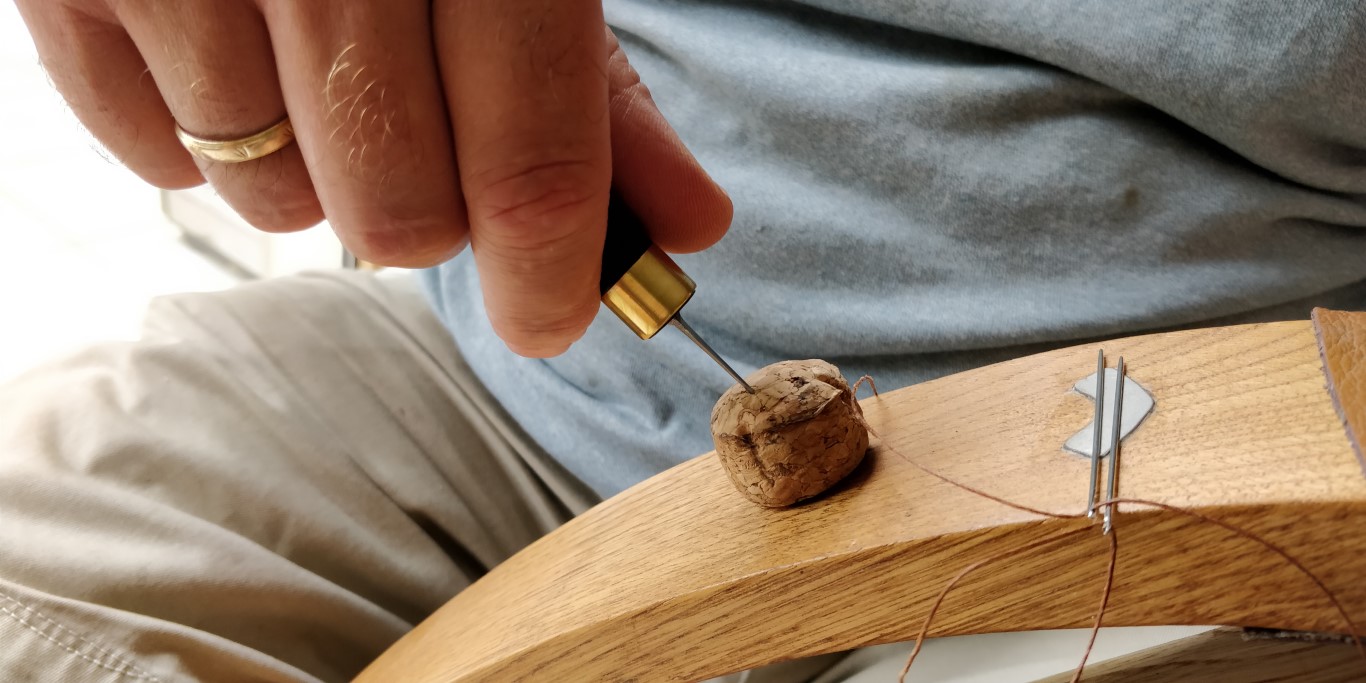

A couple of personal additions :
I inlaid a rare earth magnet (salvaged from an old hdd), in order to hold the needles.
I also added my French touch, I added a hole that can fit a champagne bottle cork, in order to hold the awls. It is not glued, you can replace it once it is worn out.
http://www.labellenote.fr/file/homem...llier_0003.jpg
http://www.labellenote.fr/file/homem...llier_0004.jpg
http://www.labellenote.fr/file/homem...llier_0005.jpg

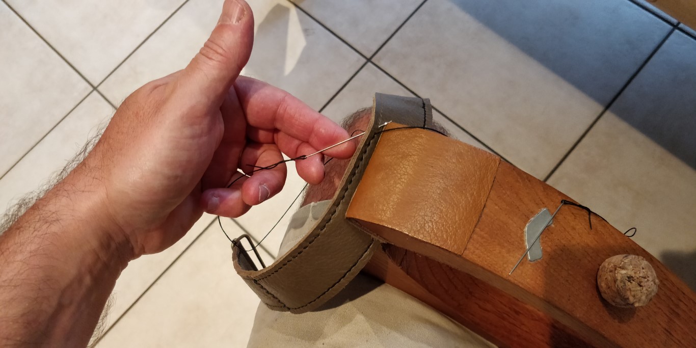

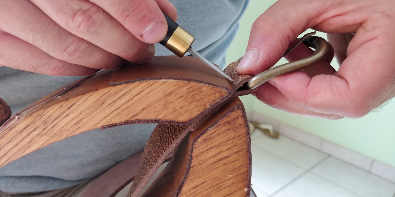

Example at use :
Note that the jaws are padded with leather to protect the workpiece.
