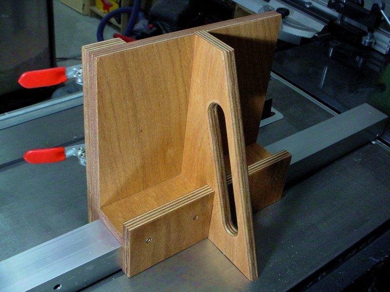

Hi here is a rebuild of a tool found in the encyclopedia :
http://www.labellenote.fr/file/Woodw...o_tenon_00.jpg
Here is my version, slightly different, I found a little improvement to make ;)
The front is the same, except I didn't have phenolic plywood, so I made it with outdoor plywood.
http://www.labellenote.fr/file/Woodw...ing_Jig_01.jpg

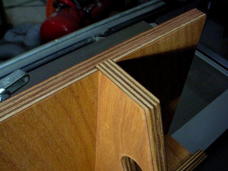

Here is the improvement, to get a more clear reference and guaranty that the workpiece is old square to the surface of the table, I enlarged the strut with the handle towards the right, so that it slides on the table.
http://www.labellenote.fr/file/Woodw...ing_Jig_02.jpg

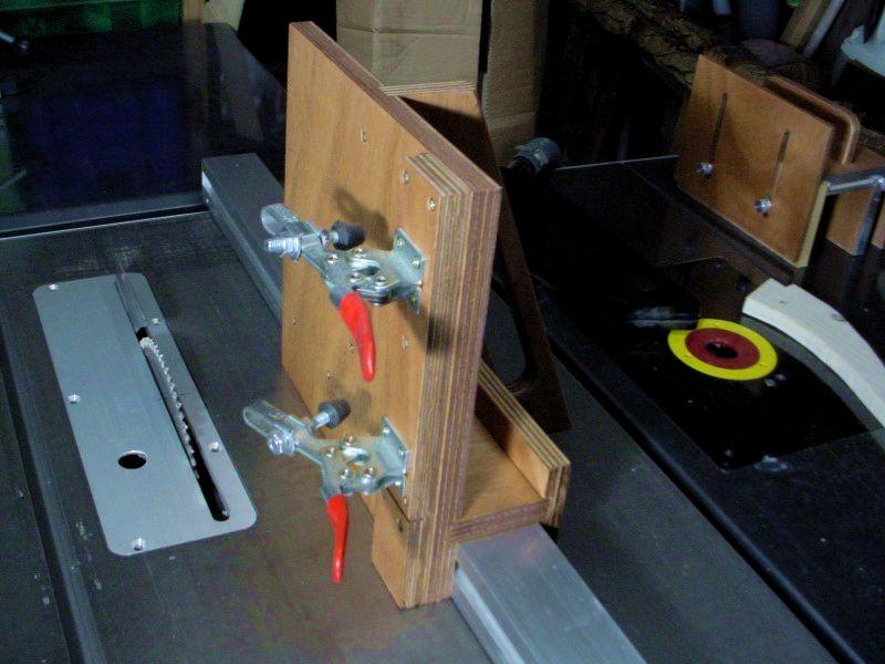

The assemblies are made as on the original one.
http://www.labellenote.fr/file/Woodw...ing_Jig_03.jpg

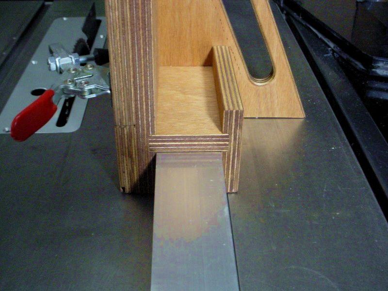

To have a good gliding on the aluminium and steel, I rubbed the sliding surfaces with paraffin wax.
http://www.labellenote.fr/file/Woodw...ing_Jig_04.jpg

Your jig adaptation is beautifully made using the outdoor plywood. I have a couple questions: 1) what are the approximate dimensions of the vertical jig carriage? 2) did you make your own table saw fence from an aluminum u-channel or did it come with the saw?
Thank you for the posting and link to you article.
Paul
Hi Paul,
Thanks for the comment,
For the dimensions, if I remember well, it is 30cm high.
And yes, the fence is the original one, of square section, and it is anchored on both ends.
