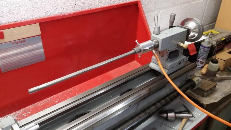

In terms of tooling, I have already showed here my D bits and steady rest, the article focuses on the method and strategy and errors to be avoided.

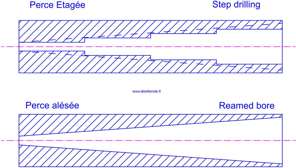

Conical bores will be roughed out by step drilling :

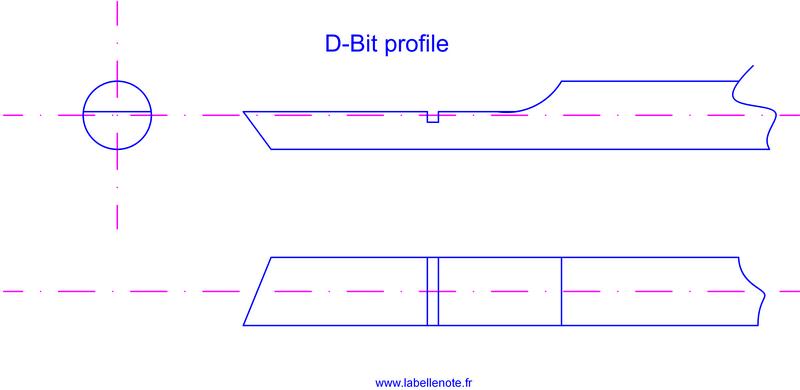

Instead use Dbits or gun drills :
http://www.labellenote.fr/file/Luthe...ongue/DBit.png
http://www.labellenote.fr/file/Luthe..._holder_04.jpg

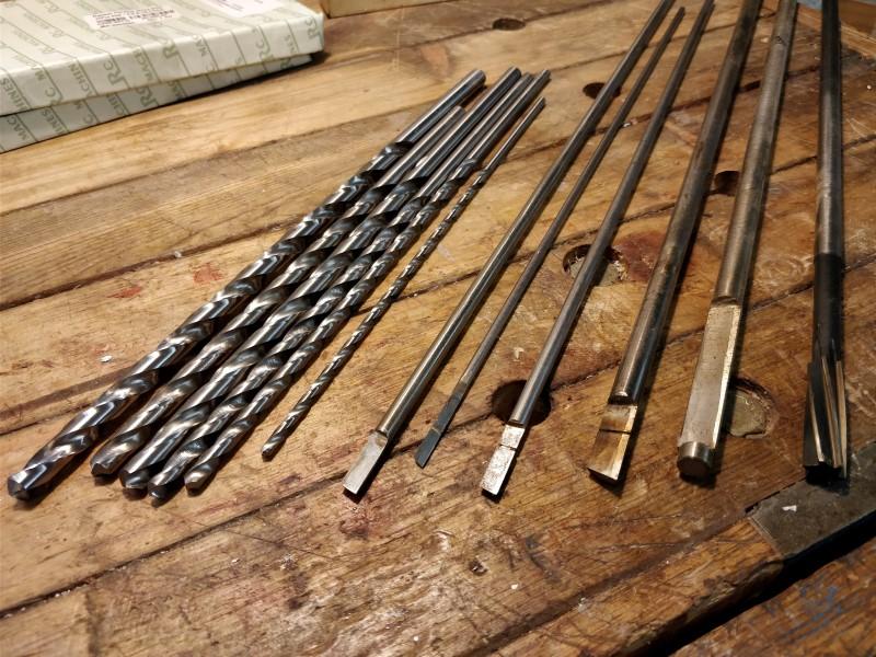

Then enlarge the bore with long drill bits, but preferably metal ones, with conical, self centering tips :
For cylinrical bores, note on the right of this photo how a machine reamer can be brazed at the end of an extension rod in order
to finish the bore. In case of cylindrical bore, the initial bore can be larger than for conical ones, hence the use of larger d-bits.
Note also an exemple, second from the right, of D bit made for enlarging with a guiding pin.
http://www.labellenote.fr/file/Luthe...its_Reamer.jpg

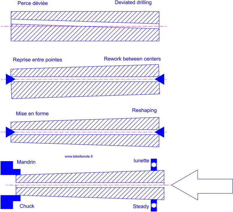

In case of small drift, which is always difficult to completely avoid, you can always recenter the workpiece
http://www.labellenote.fr/file/Luthe...erivePerce.png
