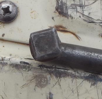

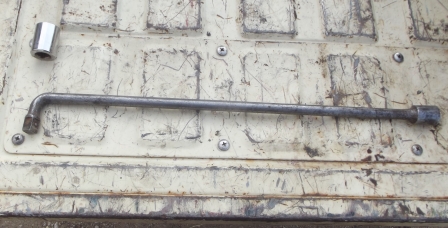

I needed a slim breaker bar the regular breakover bar I had wouldn't fit between the steel lines so I used an extra 20" 1/2" drive extension that I had .
First I heated and bent it to a 90° angle with the square part positioned at a 45° angle to the bar then as it was cooling down some I oil quenched it then water quenched for a final cool down
