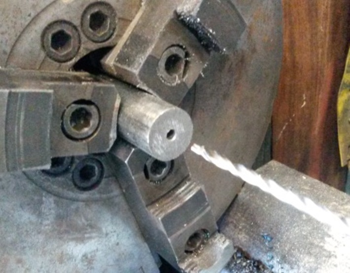

I have installed hardened sleeves in the leaf springs which will be the rear pivot for the top clamp. also a half moon cup that the spring eye nests in is already welded in place making it imperative that the holes in the side plates for the pivot shaft must be concentric with the cup.

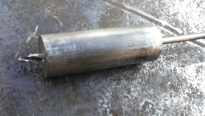

So I made this drill guide/ transfer punch adapter out of 1 " cold roll by drilling a 5/32" hole through it
Attachment 19818 Attachment 19819

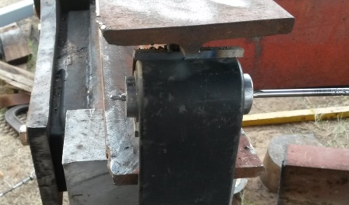

By clamping 1 side plate in place I can use my hand drill to mark or drill a pilot hole
Attachment 19820
