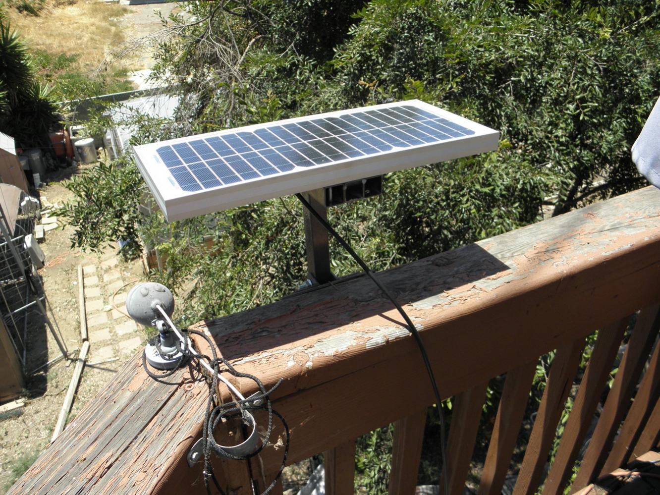

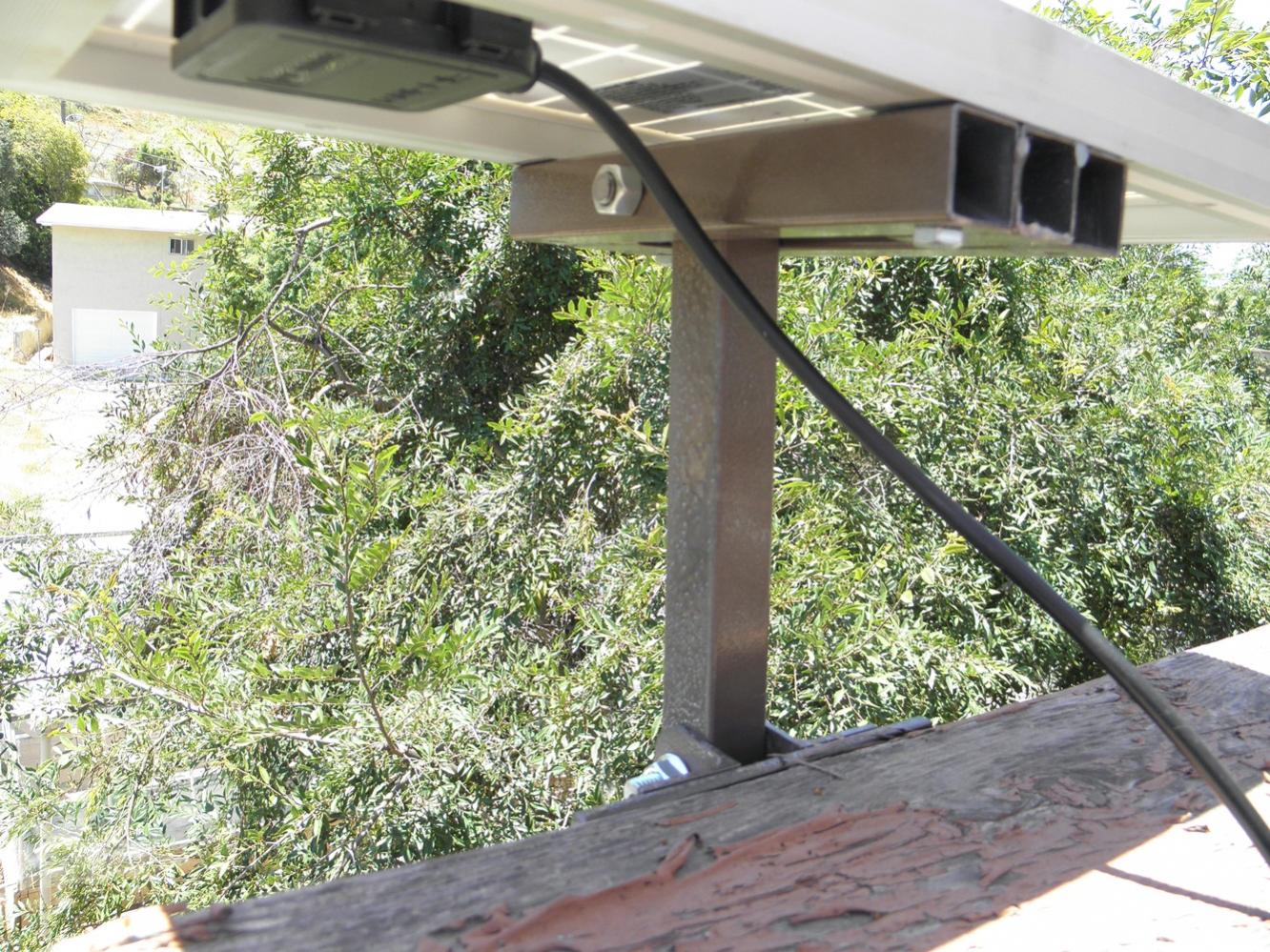

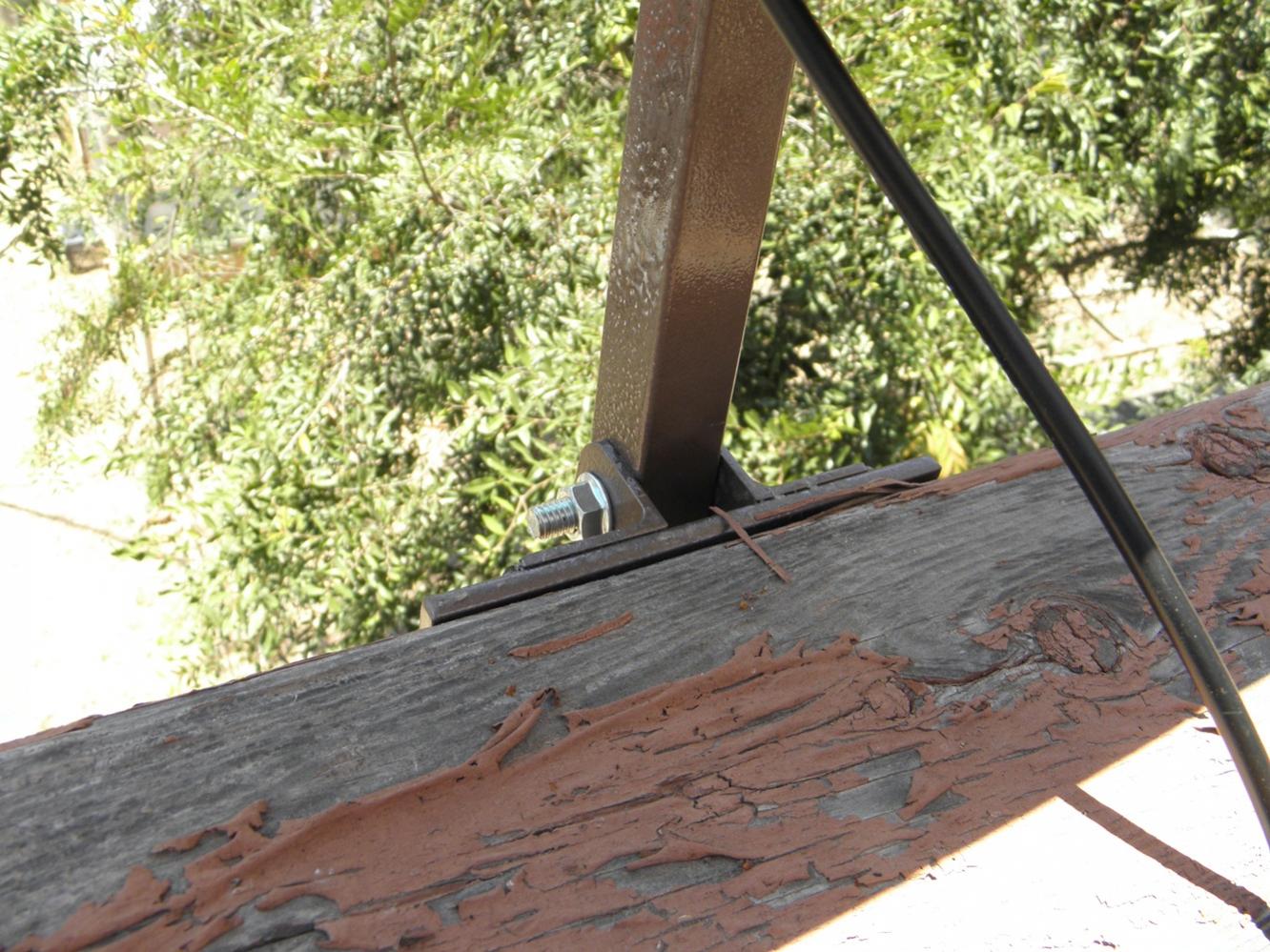

10 Watt solar panel mounting bracket. made from 1''x 1/16 " square tubing. 1 1/2 " x 1/8 " angle steel and 1 1/2" x 1/8" bar
Solar panel 10 watt $25.00 incl ship keeps a marine battery charged up.

"10 Watt articulating" looks fixed to me I don't see any articulation.
Ralph
Yes Ralph. the main shaft square tube rotates on both axis from where the bolts are.
I'll have to take your word on it, I cannot see it.
http://www.homemadetools.net/forum/1...352#post113476
I can see where it could tip front to back on the narrow access but do not see any motors or is it tipped by hand?
Nice build by the way, looks substantial.
Ralph
Hi Ralph, Thanks, yea its just tipped by hand after I loosen the nut/bolts.
I will be moving it from time to time to better point it at the sun . Cheers.
