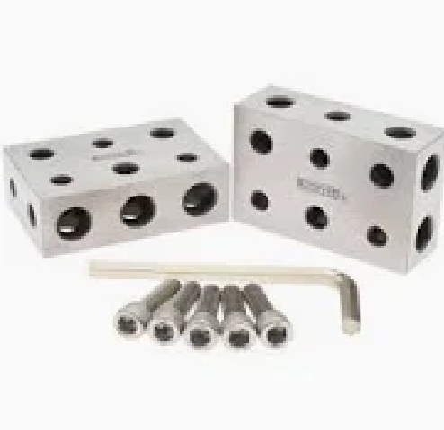

123/2 blocks
123 blocks are very useful devices, both for setups and also for simplifying measurements as I showed here...
http://www.homemadetools.net/forum/m...g-tapers-55135
Much of what I do is on a smaller scale, though, so 123 blocks are a bit oversized many times. I decided to make a half-scale set of blocks with dimensions 1/2 - 2/2 - 3/2 or, in simpler nomenclature, 123/2 blocks.
They're not NASA-grade precision but, even so, they've proven to be very handy indeed. I use them by themselves and also in conjunction with their full-size "parents" on those rare occasions where a larger setup is needed.
I haven't drilled and tapped them yet. I had planned to wait until a need for holes arose and, so far, it hasn't so they remain blank.
Marv,
Great idea, especially the measurement of tapers. The simple approach is always the best.
Shelly

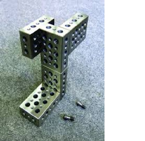

Hi Gang: I find the 123 blocks that you can screw together and form angle plates, etc, the most useful.
Attachment 50234 Attachment 50235
ARC Euro Trade had some 1-2-4 cm blocks for metric folks and also 2-4-8 blocks. Handy for smaller work.
Carl.
