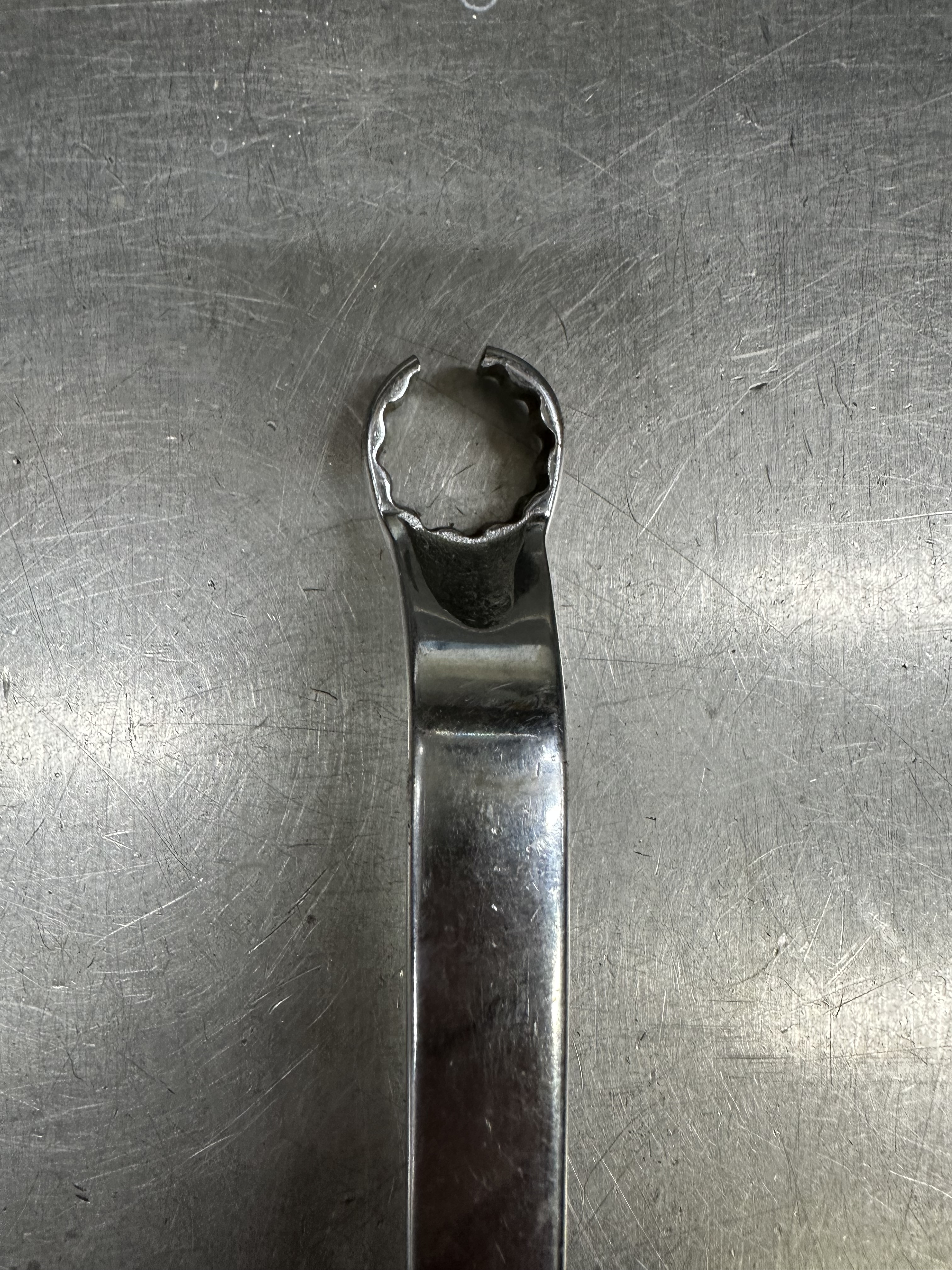

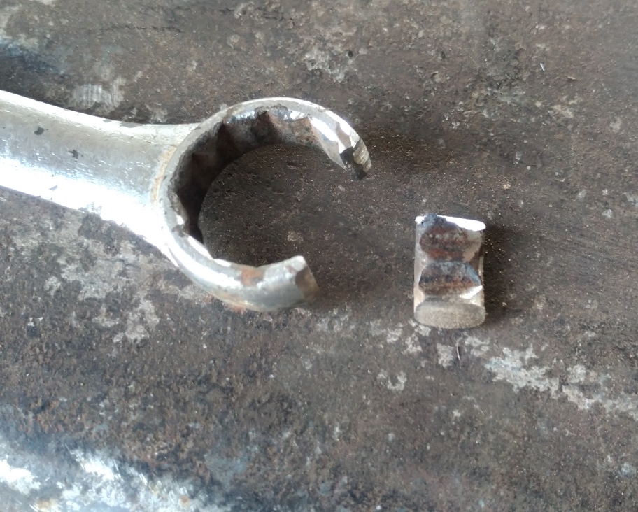

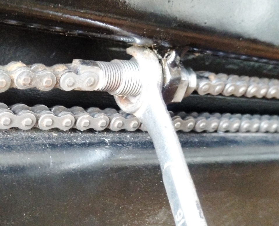

    I have a set of line wrenches but they are all too thick to fit in some places. My set of crows feet wrenches will not always get into the tight spaces I sometimes encounter. Hense a sacrificial box end wrench to the rescue
    13/16" line wrench form box end-img_20220413_164003lw.jpg
    13/16" line wrench form box end-img_20220413_164057lw.jpg

    Got a few of those floating around the toolbox. The greatly offset ones are essential on some jobs but damn hard chopping up an expensive spanner and you need some decent quality or they just spring apart and bugger up the hex on the thing you are trying to get out.
    Extra long deep reach hex sockets with slots cut out of the sides are handy too.
