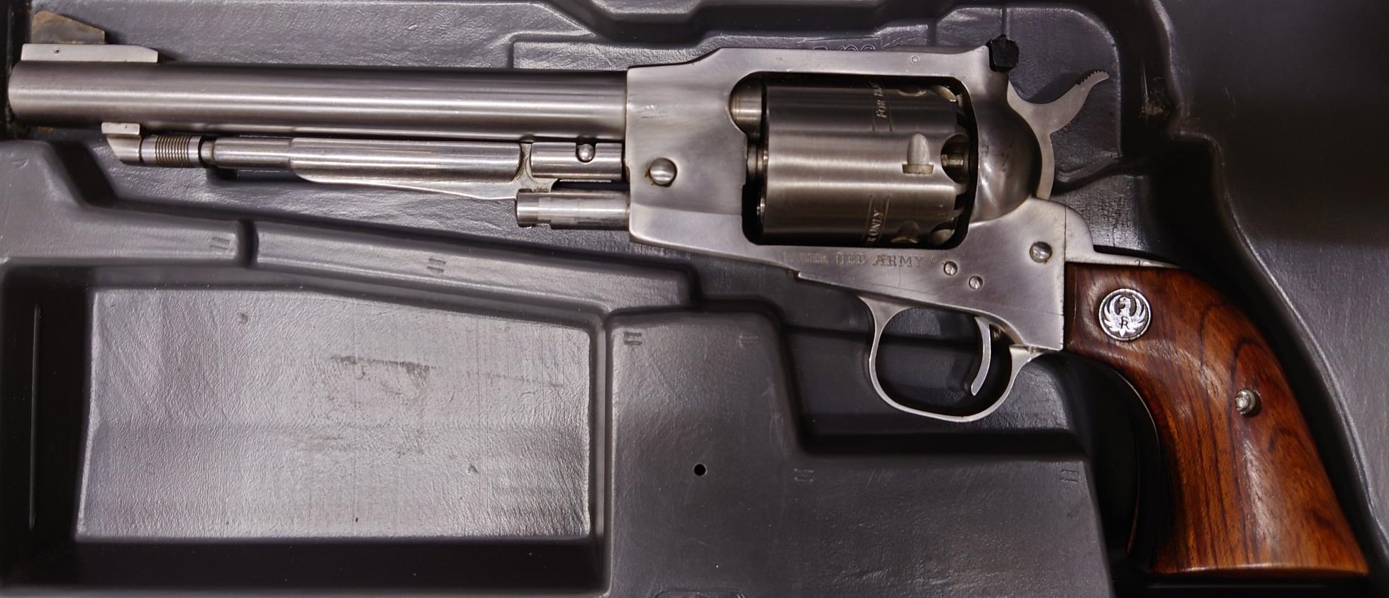

    'Tis a thing of Beauty m'boy...
    interesting comments about safe loading methods, IIRC the NRA (US not UK, though they are following I'm told) has initiated a safe loading scheme, using paper cartridges, some with ball some plus ball, to eliminate the biggest issue of hot residue igniting power pouring from a flask into the cylinder or down the bore, a shooter lost his hand and sight in one eye on a UK range from that not so long ago. As a ROA shooter I do 'cap' the loaded cartridge and ball with soft bee's wax and oil mix (Renapur leather balsam) to seal the chamber from the front, even though with the correct sized ball is should shave on loading to give a perfect seal on the chamber mouths sharp edges, and no wad between the 30 Gn's of 777 and the ball. Post incident analysis showed most chain-fires occurred due to poorly fitting percussion caps and worn nipples allowing leakage out and into the next cap, something Bill Ruger's design of safety notches helps avoid perhaps.1853 engraved Colt Dragoon revolver - photo-20240609_143603.jpg
