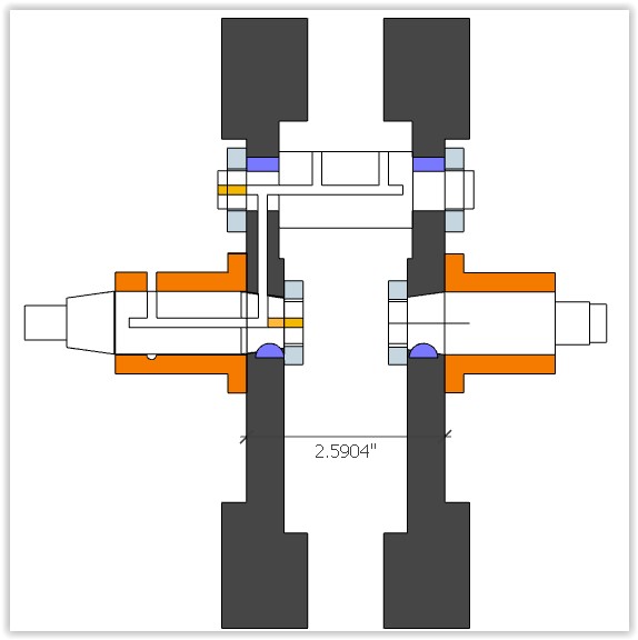

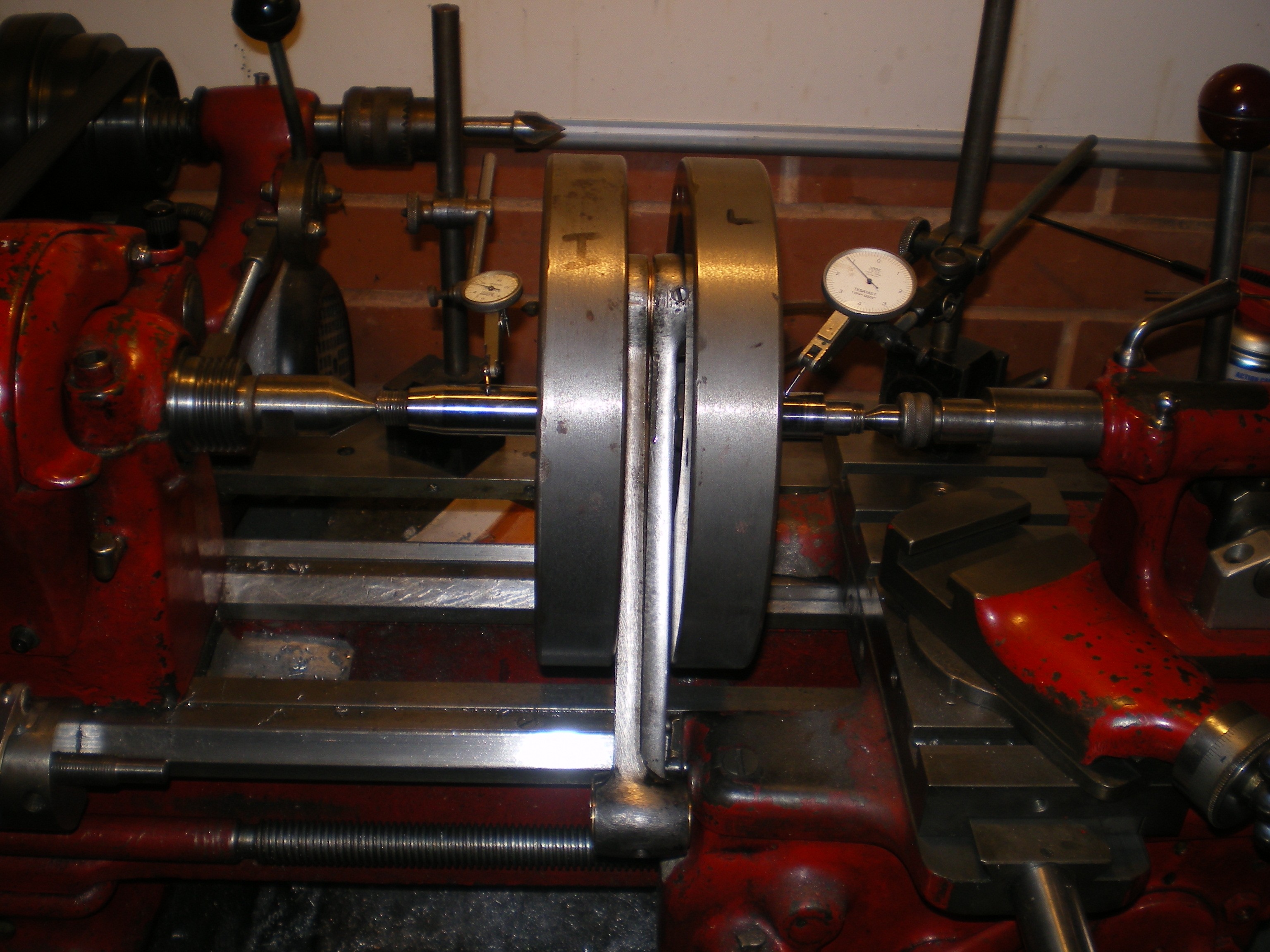

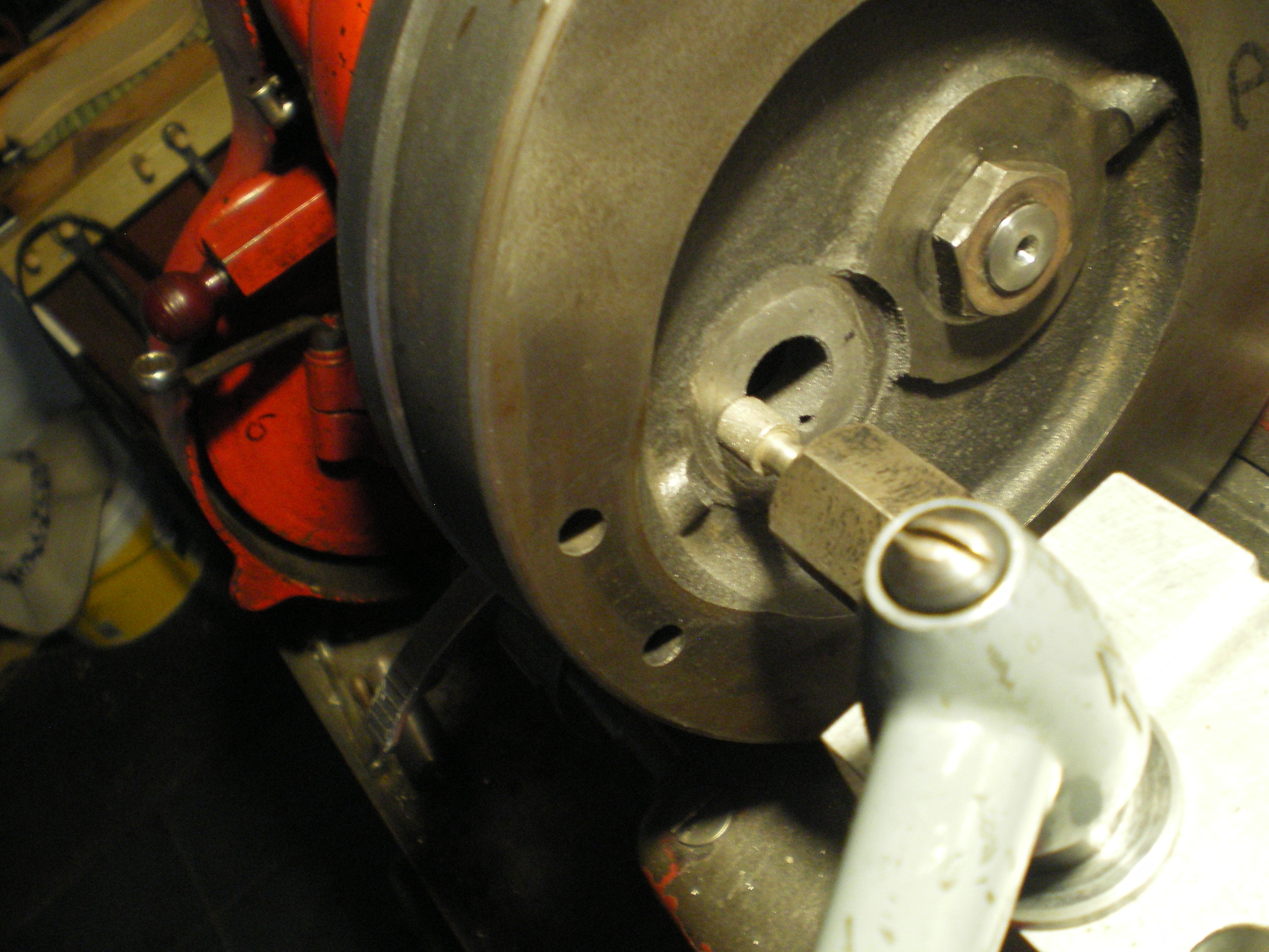

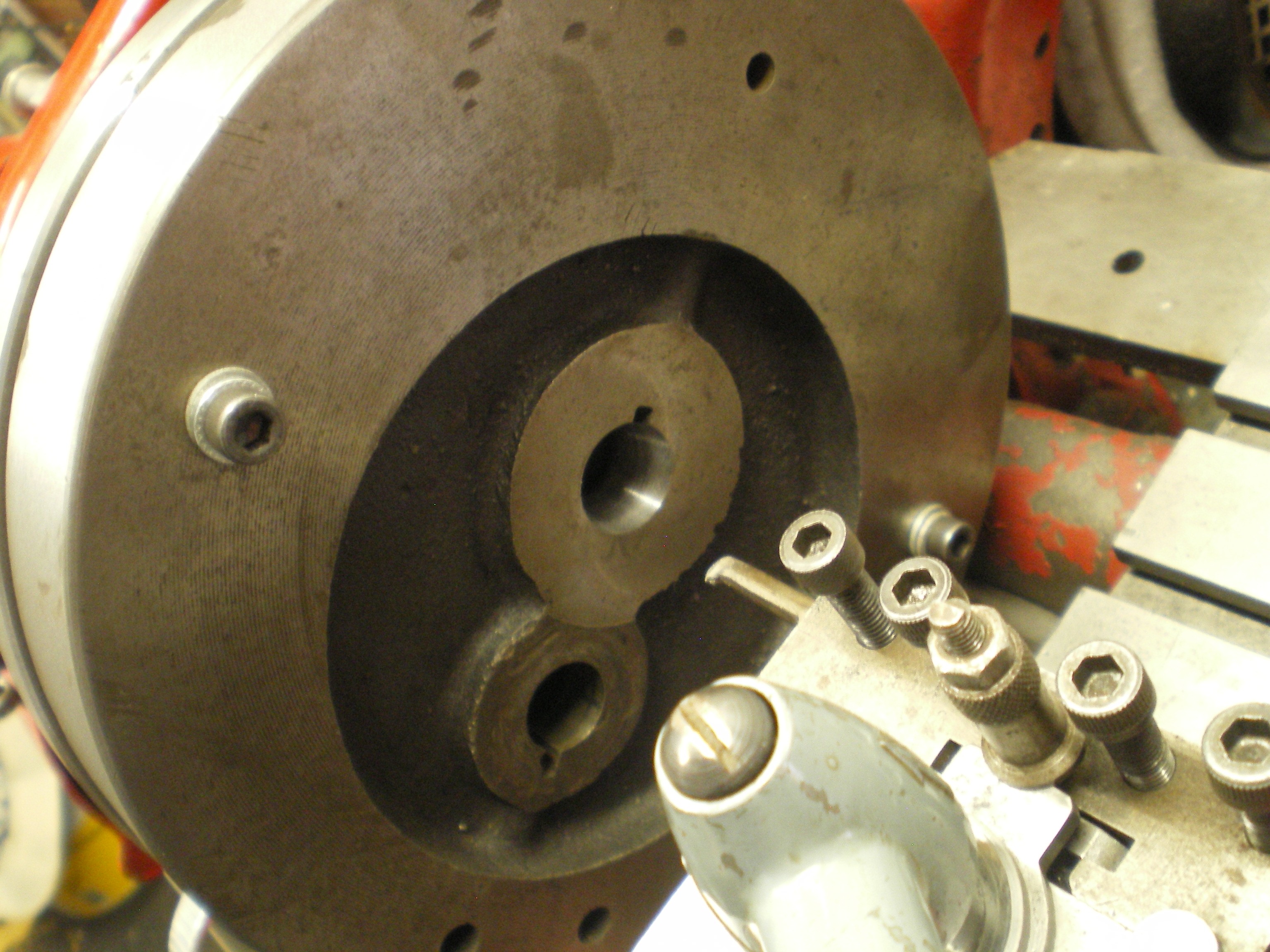

    After making new bushes and shafts for the crankshaft and rods I was pleasantly surprised when the gudgeon pins slid though both conrod eyes when fitted to the big end.
    The whole crankshaft assy however is real problem to get running true, the tapers in the flywheels are clapped out and not seating properly due I think to the engine being run with loose seatings (everything is of bolt up construction). Best I can achieve so far is a .005” TIR error on both main shafts which is no good and not helped by a 3.5" stroke. My only option is to skim the tapers in the flywheels to reclaim them, fortunately they will just fit on my home made faceplate. I cannot afford to remake the shafts again as I no longer have access to tool room equipment i.e hardening and grinding. In a last ditch attempt to save this potentially scrap engine I decided to grind the inner flywheel conrod faces with a milling spindle and a diamond speed pin, this was successful as the fly wheels are truly spaced when assembled on the crankpin. This has brought the run out down to .0004" tir which is the best I can do and for all I know is as good as the original. This has taken around forty hours so far and it is pure stubbornness that has kept me going. Next the main bearings and case assembly.

    Alan,
    That old design of taper and nut fitting was never good, particularly when applied to the bigend also. The width of the nut takes away potential engagement length of the pin in the wheels. Velocette eliminated the nut on the bigend.
    As you have ground the tapers, the pins must seat in a bit further, has that resulted in having to shim the gear/s on the timing side to restore their lateral position?
    The more modern approach of pressed in parallel pins in relatively wide wheels results in a more robust crank. Of course when you are restoring an old engine you have to work with what you have. Good luck with it.
    BTW 0.0004" runout will be better than the original spec.

    Thanks Tony
    I totally agree this is a bad design.
    You are correct in that the main shafts have protruded into the flywheels a little further (it is a 16 degree inc taper), I had to shorten the small taper end and the threads to compensate. I actually ground the nut clamping faces and faced the nuts from a tight fitting screw cut mandrel to avoid any bias to the crankpin. This is an old chuffer of an engine and only rated at 4HP which is why it survived the abuse. I havent got to the timing gears yet and the cases have had a fair bit if welding so more trouble ahead.

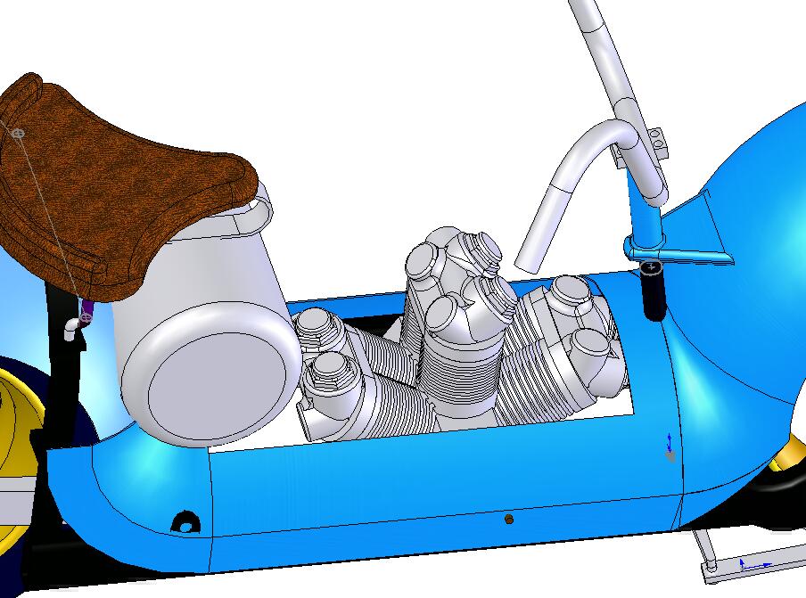

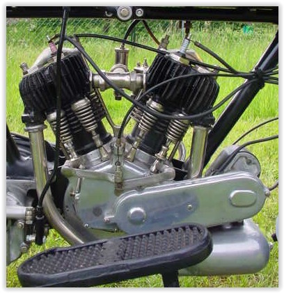

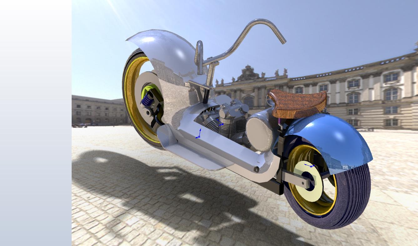

    My original HP figure was a typo, the official one is 6HP.
    If the crank assy is a flimsy affair how about the barrels and heads held down by a stirrup with two bolts each and a bicycle type rim brake on the front.
    Be careful with that much power.
    I think it was Panther which had extra bosses cast under the main bearings with a groove in. Then large U bolts went under the bosses and fitted in the grooves. The legs of the U bolts went up into the head in a normal fashion. It sounds crude and it was, but it meant that the combustion forces were taken all the way down to under the main bearings, so you were not trying to tear the crankcase apart like you do with most engines. So it was not quite the crazy idea that it sounds.

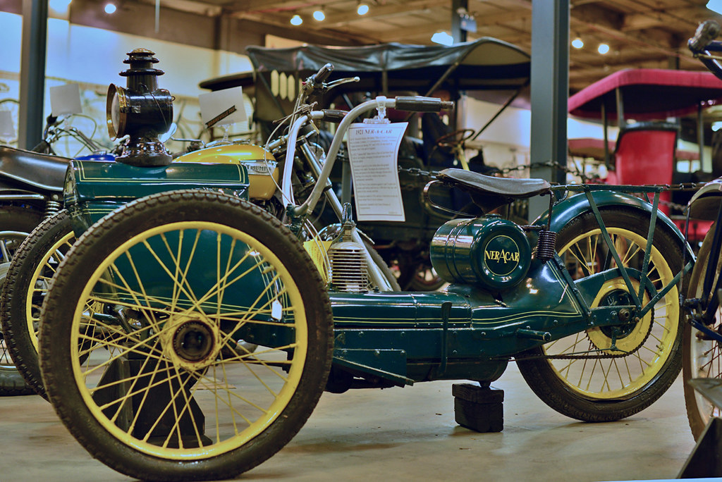

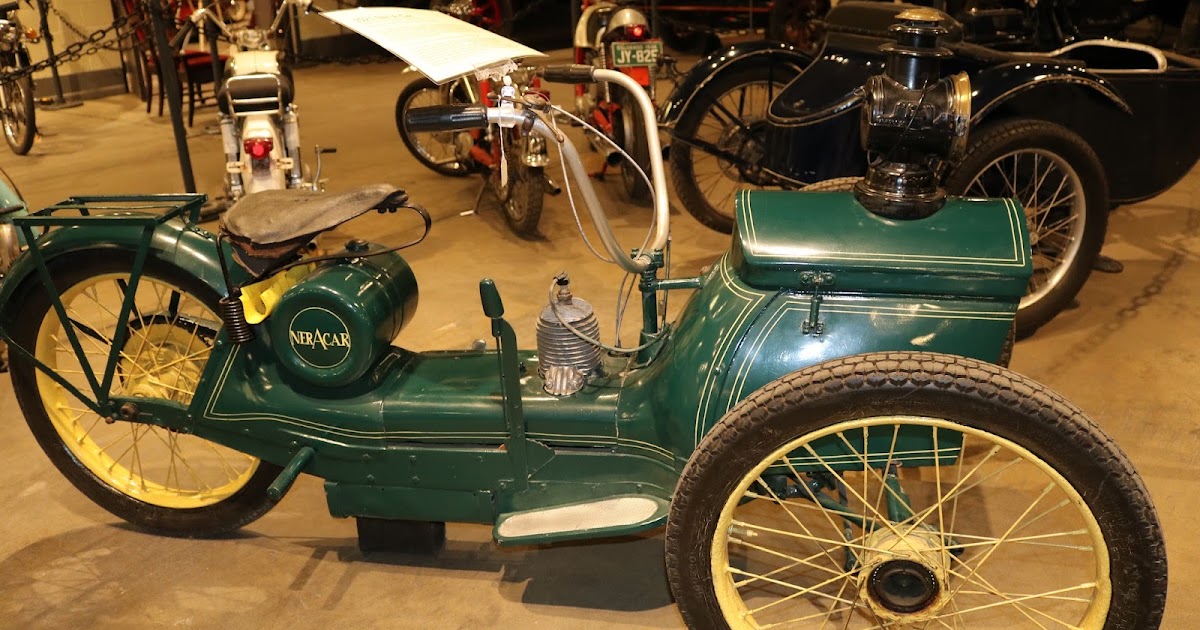

    A friend gave me a 1923 Ner-a-car chassis that was more rust than motorcycle. but eventually I had more motorcycle than rust just no engine for it or rims I even wound up with a set of drawings for most of the engine components. Someone in England had built one back in the day with a 4 cylinder inline which got me to thinking about going that route but things transpired and the whole project was abandoned and left in Kuwait.
    The Ner-a-car was unusual because it was made in England and the US. There were some technical differences but I do not recall just what.
    Here is a pic of my good friend the late Vic Willoughby.
