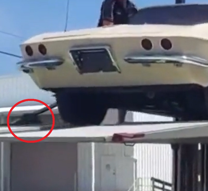

The chock was a small one . . . and only one!
Attachment 45891

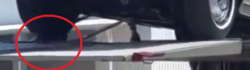

Notice how the tire is elevated here (on top of the chock) and the right side is flat on the deck.
Attachment 45892

A rig like SHOULD have a winch in front to pull the car into position. That which SHOULD have been used in reverse to allow the car to back out under total control while still connected to the winch. When the car was in place on the elevator, the chock should have been set it place. Then brake in the car set and the transmission put into park or a low gear. ONLY THEN should the winch cable be disconnected.
Chocks are not meant to stop a rolling vehicle, they are meant to keep one already stopped from rolling away.
Well, it's his chock block because that's what he called it.
That guy is fired AND broke for a long time paying for that mistake. Not to mention the damage to one of the finest cars ever produced! Even if the lift had a built in "chock" I would carry my own just for that reason. It's never a bad idea to have a secondary failsafe.
