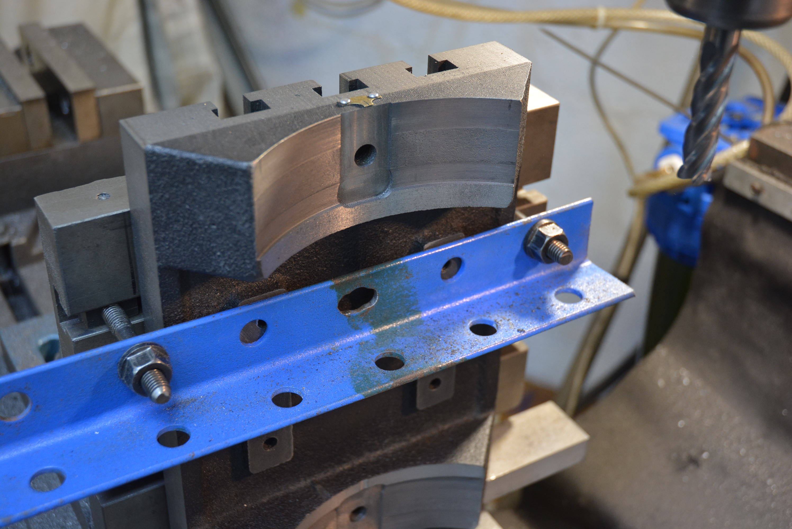

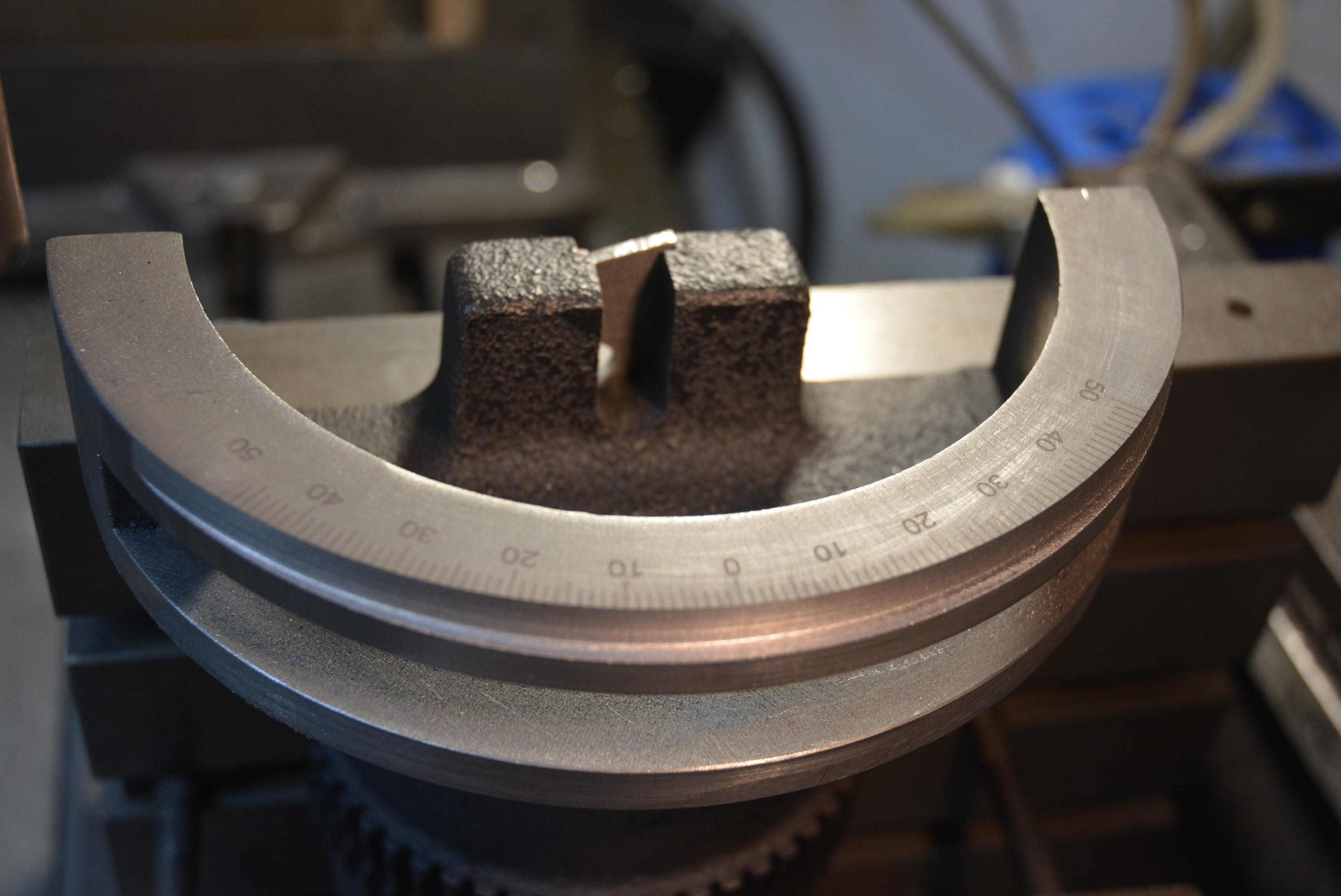

For Xmas I was given a chinese tilting table and a chinese rotary table. The tilting table was crap, over 1 mm out of level over the length of the table and there was considerable rock when it was put on a surface plate. The base and top had mismatched radii and most surfaces looked like they had been "machined" on a linisher not a grinder nor mill. The castings were very good though and after machining the whole thing I have a nice table. On the other hand the rotab came with a calibration certificate which I confirmed and was machined to a high standard and had no need of improvement. It is hard to tell in advance what the quality will be on any particular item.
Attachment 44660 Attachment 44661 Click image for full size.
Showing the extent of the radii mismatch on the tilting table.

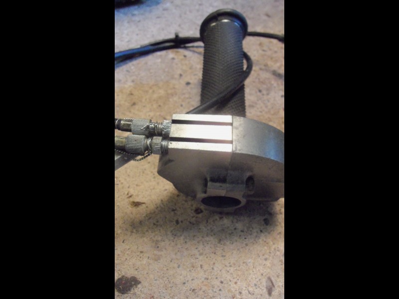

You could junk the splitter completely if you used the 1970s TZ yamaha dual throttle control. The throttle action is smoother than you get with a splitter. Genuine ones will be hard to find at a reasonable price but new "clones" are available, but you easily have the skills to make one. If you become interested in making one I can take detailed internal photos.
Attachment 45210 Click for full size
Original TZ Yamaha

The 74 TX650 came with a dual cable throttle, nothing but a PITA, so I 'junked' it using a splitter I made for the BS38s. Post 149 here:
https://www.homemadetools.net/forum/...build-80821-15
This system was far, far superier to the dual throttle, easy to sync, neat and tidy and only one cable to worry about
