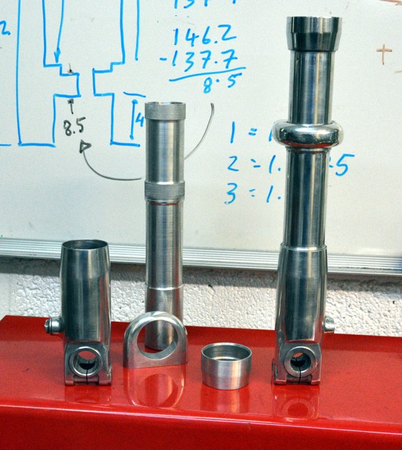

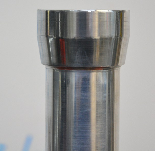

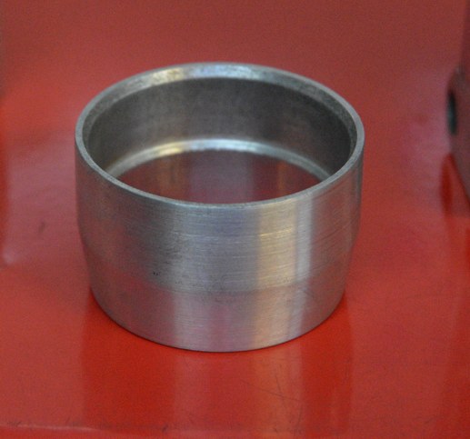

I bought some modern CBX forks from a S/H parts place because I wanted the cartridge damping pieces. One pair of sliders were even worse than yours, the previous owner had actually drilled holes under the seal.
I do not know if you are familiar with the Ceriani forks of the 1960/70s (maybe earlier as well) but they were made from tube with extra pieces glued on. The glued pieces were the axle carrier, mudguard and brake torque arm mounting and the seal holders.
The damping pieces that I mentioned were for some replica Cerianis that I made for my classic race bike. I made the mudguard mounts and seal holders but for the axle carrier I cut the bottoms off the CBX forks which saved a lot of machining. Here are some pix.
Attachment 37791 Click thumbnails for full size
Attachment 37792 Attachment 37793
I used a size for size fit which I lightly knurled and glued the pieces on with Loctite. The knurling gave a slight interference but the main purpose was as reservoirs for the Loctite.
The Ceriani form of construction is a successful precedent to what you propose for the Yam forks. I agree about the circlip, I have never found them necessary. The only force trying to move them is friction and that should be minimal.
