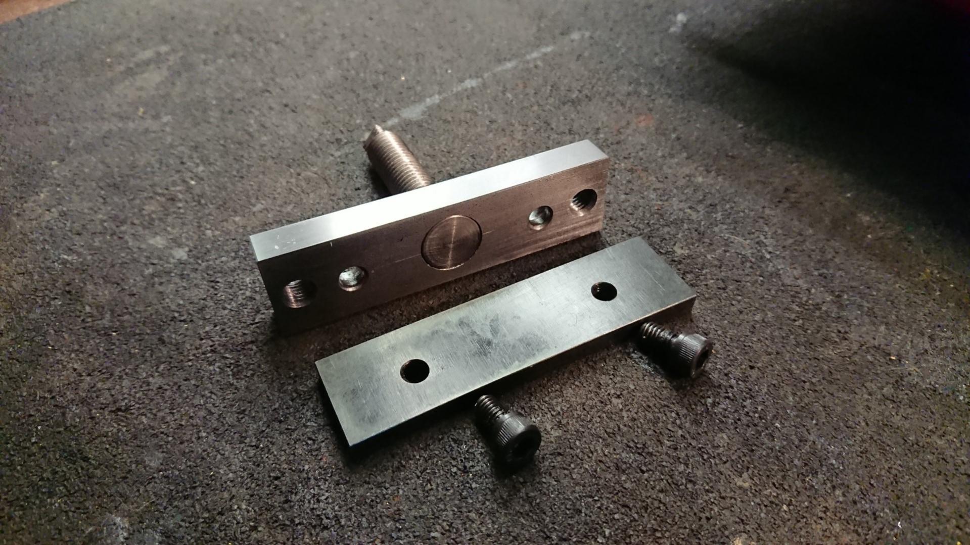

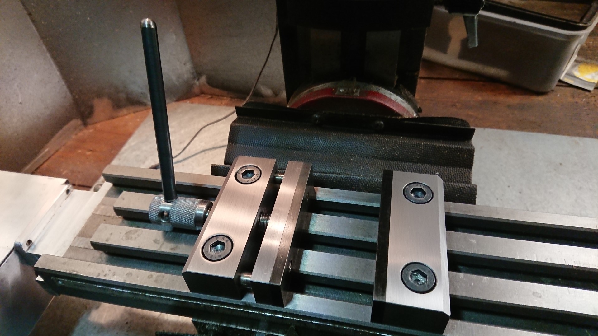

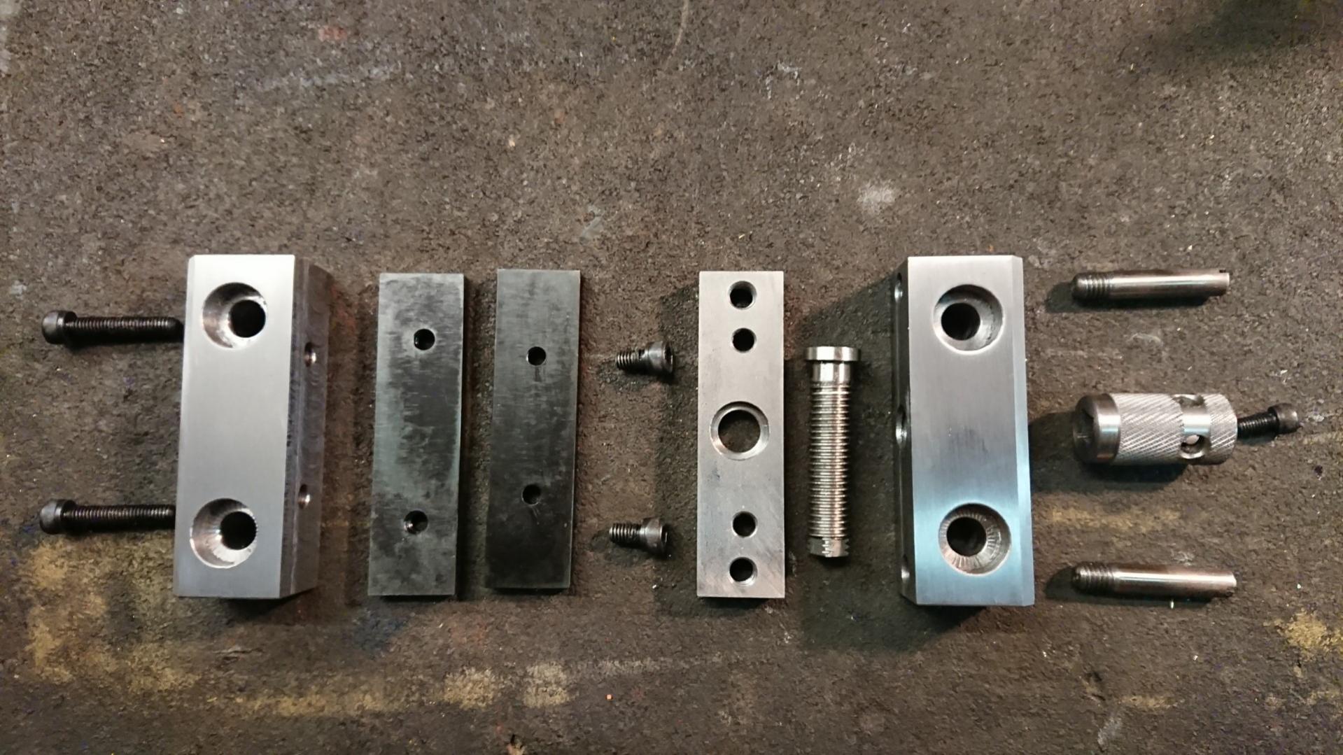

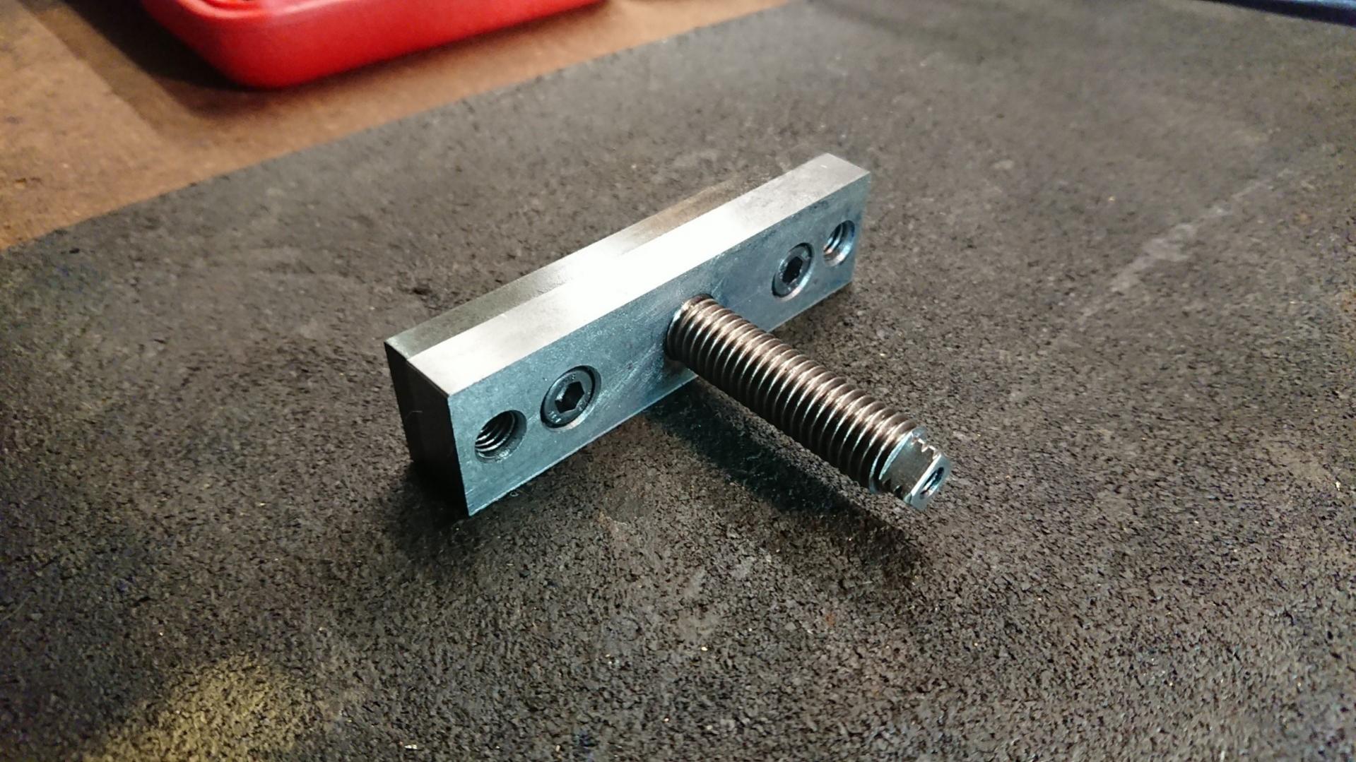

hey fellow shed dwellers,
I saw one of these online while searching for vice styles, had to have one.
Main body: mild steel
Jaws: 01 tool steel
Thread: 12mm stainless bolt
Attachment 24549
Attachment 24550
Attachment 24551
Attachment 24552

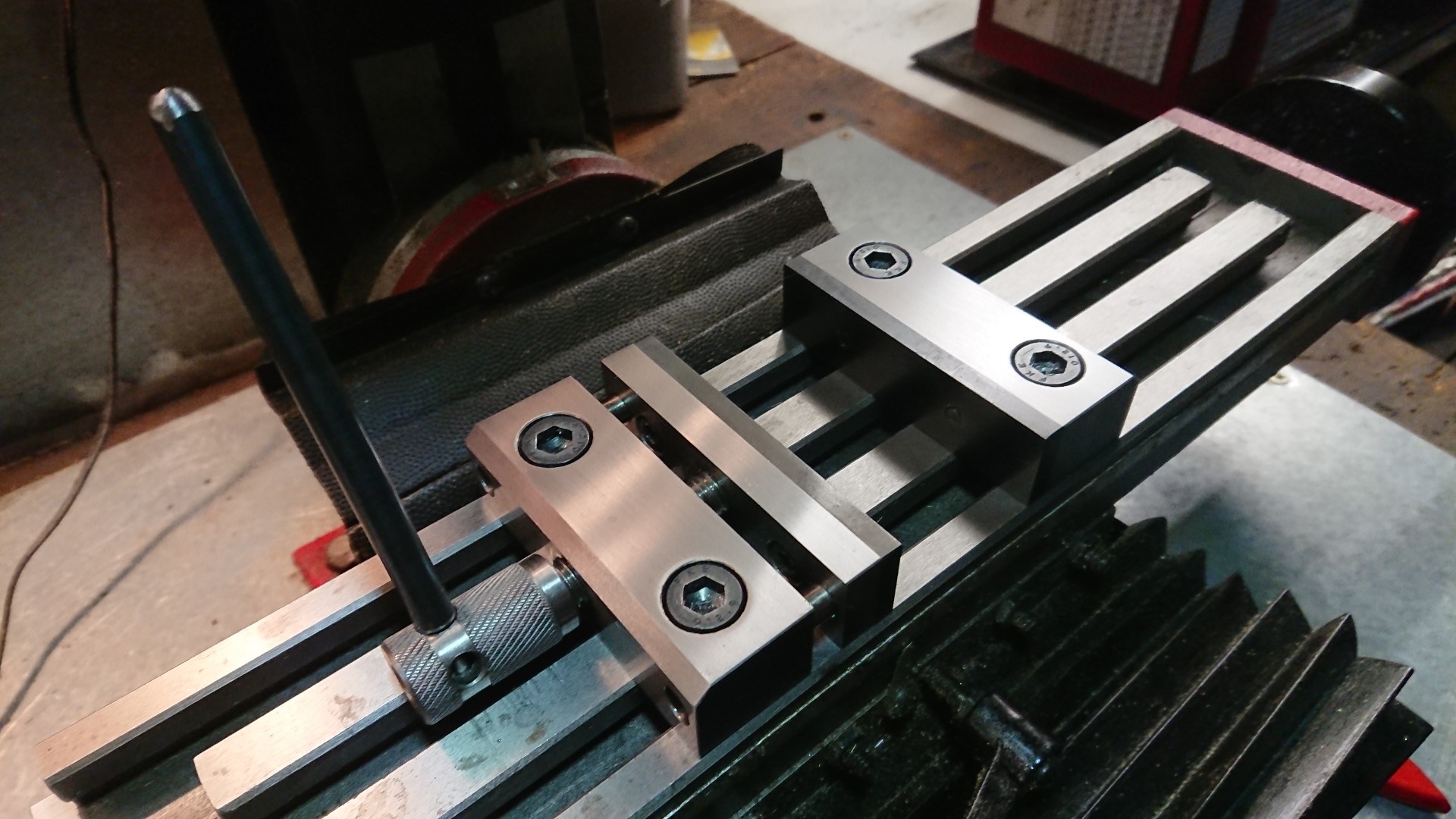

The black handle is from a gas strut. While on the pushbike ride a few years back came across a cardboard box, found 50 brand new gas struts inside so balanced precariously on one leg and riding one handed got them home, wasn't gunna leave them to get car.
Have since used a few for handles on several pieces, the rods have a tough case hardened finish with an 8mm thread.
cheers stevoh
Attachment 24553
