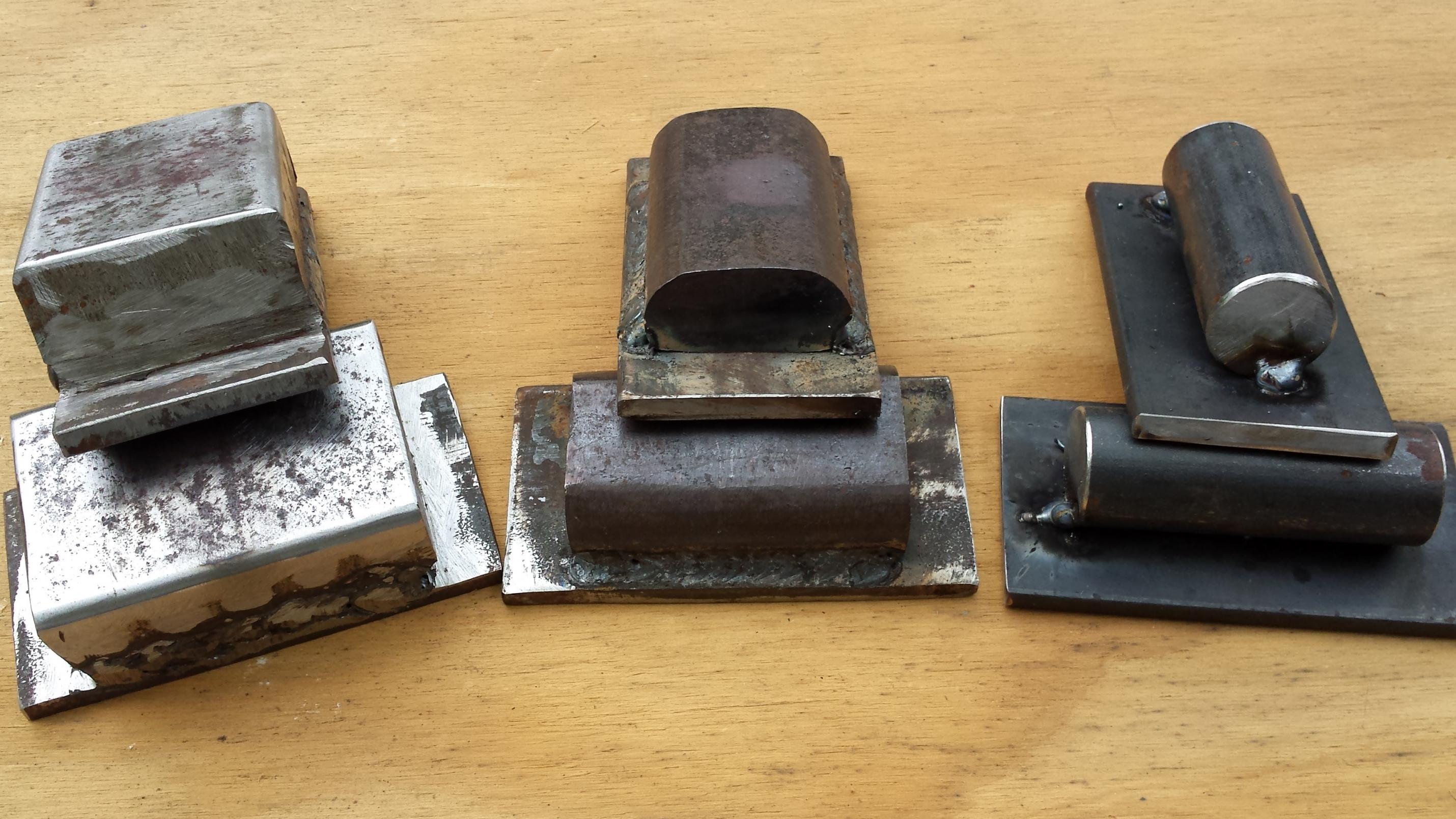

Here's a pic of the dies and the foot pedal.
Attachment 17706
These are only the first of the dies. I'm sure to make more as needed, since it doesn't take much to whip up a set. You can weld anything onto a piece of .25" x 2"x 4" steel with the dies being 3" wide.
Attachment 17707

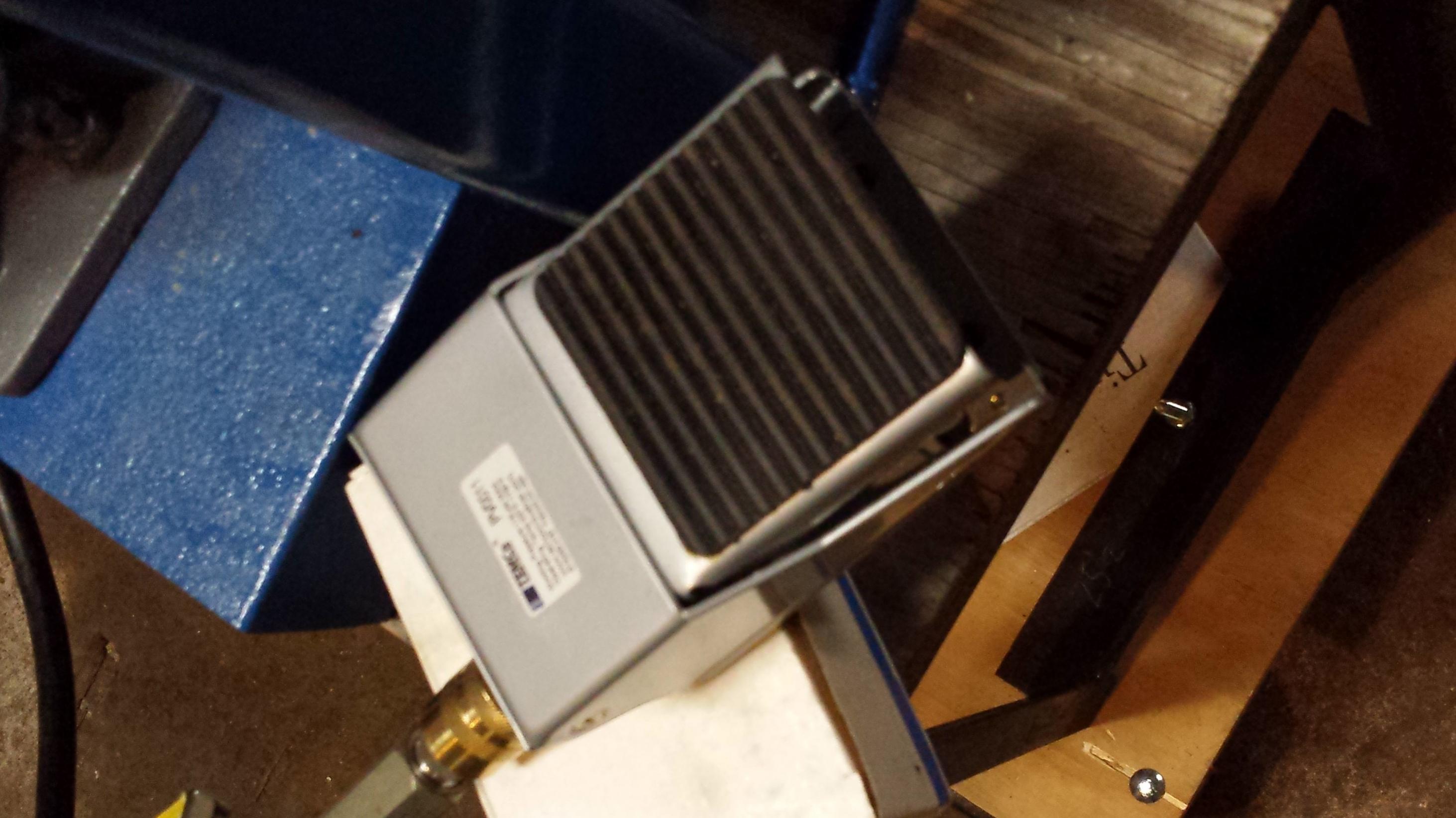

this foot pedal has one inlet and two outlets. I capped one outlet. It is a TEMCo PV0011. I got it off fleabay. Hope this helps.
If I get more involved in the press work I'll have my brother in law put something together for me. That will cost though. This project was actually around $100 with the foot pedal.
Thanks, I would like to see a video of the dies in action. I ordered that foot pedal.
