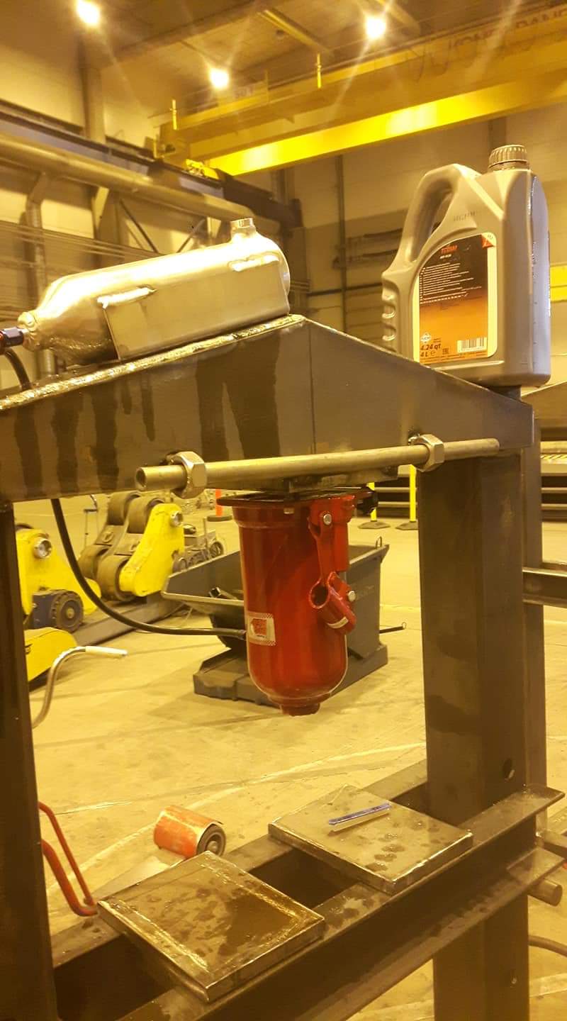

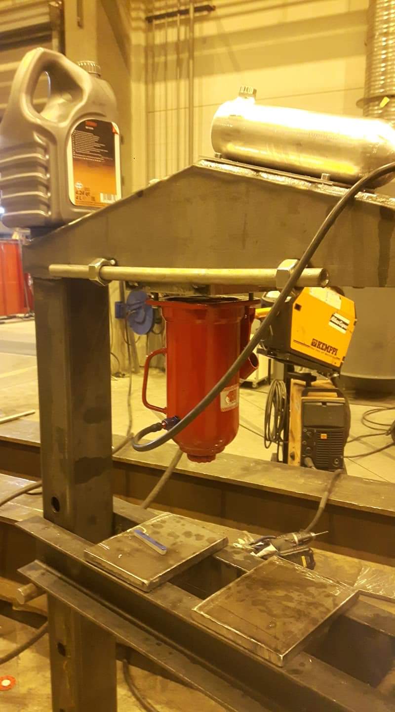

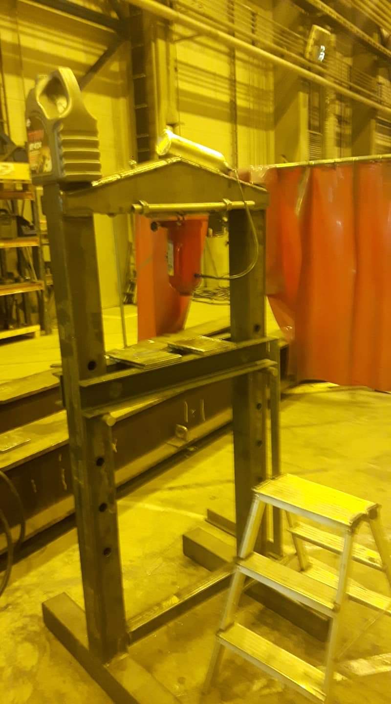

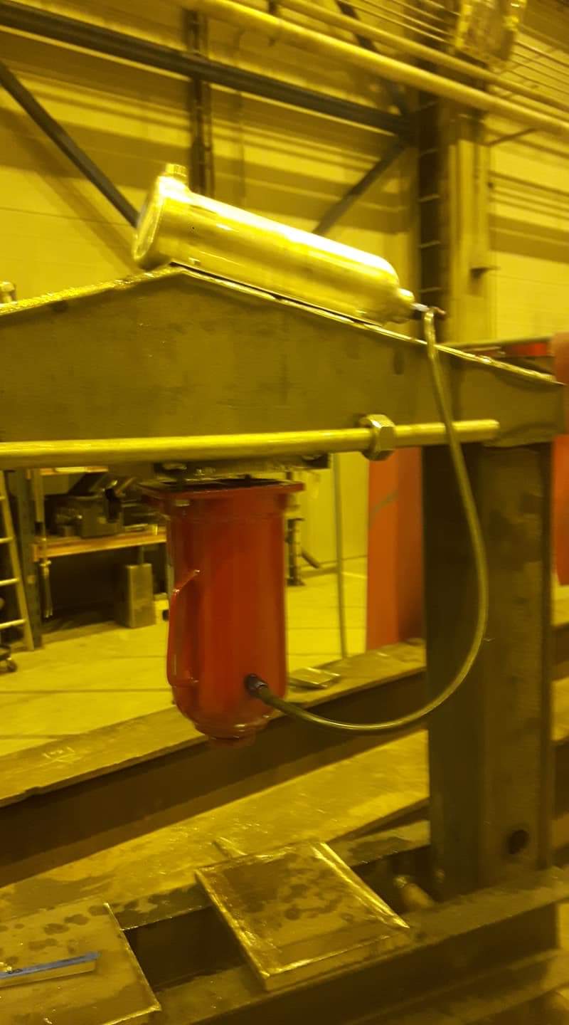

Finishing simple 20 ton press, very traditional design.
That was asked.

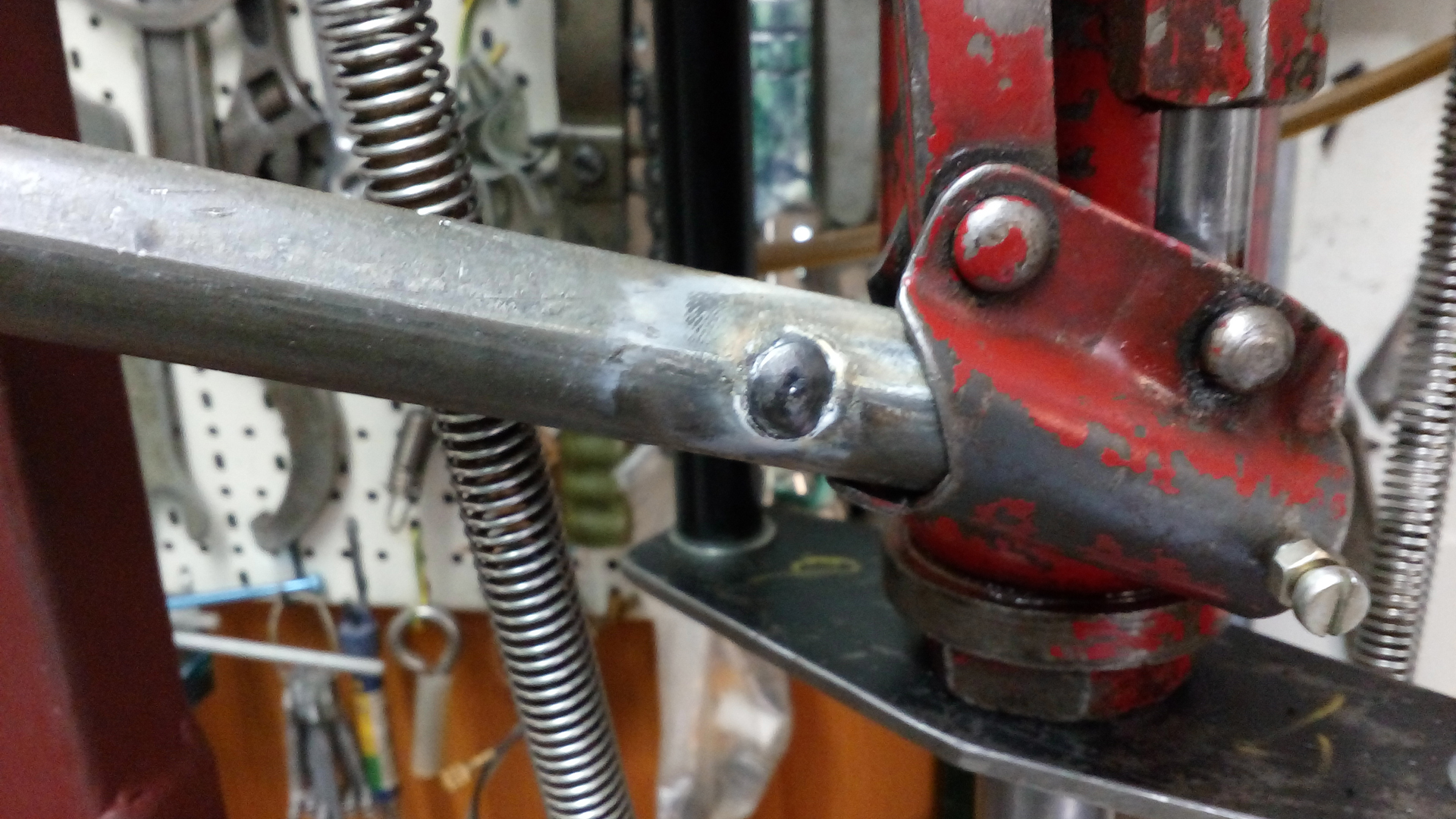

Inverting jack is made same way than this video:
https://youtu.be/rNIFP5E8C6c
Container is made from alumine gas bottle. ( Tire repairing foam bottle )
Attachment 26476
Attachment 26477
Attachment 26478
Attachment 26479
Jack moves sideways 350mm
"Rails" are made from pipes and connected to frame with nuts. Loose connectio between nuts and pipe, so in use javk leans against frame.
Sorry about blurry images, better ones when the build is ready.
Thanks for checking this out.
