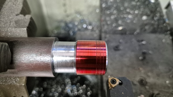

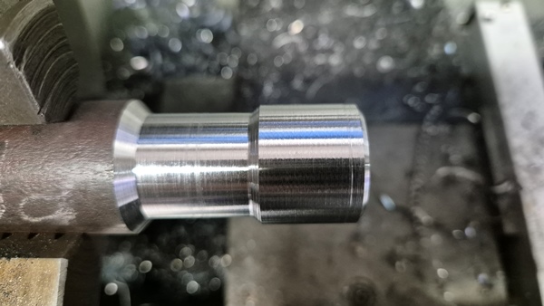

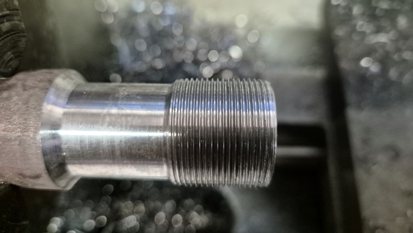

I repair motorcycles for a living, and recently has to remove a gearbox from a BMW R1150GS. The swingarm, which houses the driveshaft, pivots inside the aluminium gearbox casing. Unfortunately, whilst removing the pivots, one of them went threadbound and ripped the thread in the casing.
This necessitated making a 27mm 1.25Pitch tap, and a jig to make sure the repair was straight and inline with the opposite side. I started off with a 30mm piece of EN36.
Attachment 47862
Added some marking dye
Attachment 47863

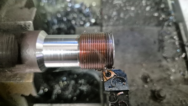

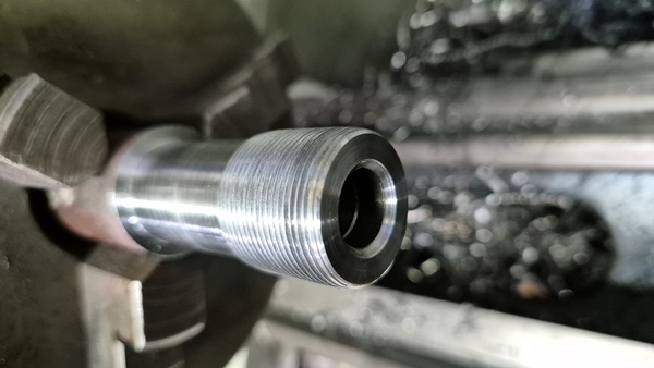

And single pointed a 1.25mm pitch thread.
Attachment 47864
Attachment 47865

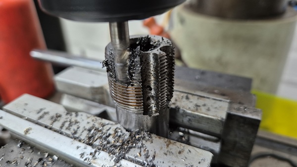

Drilled and reamed a 12mm hole down the center
Attachment 47866

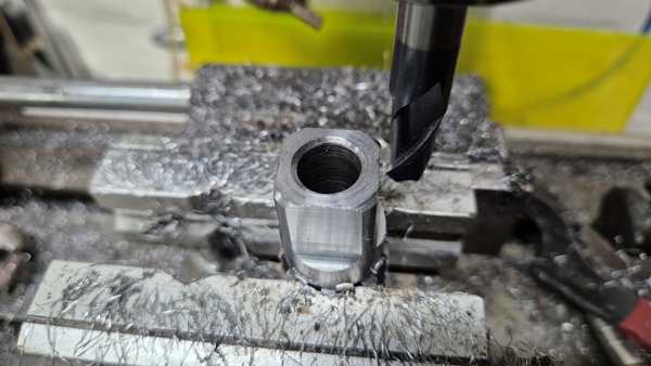

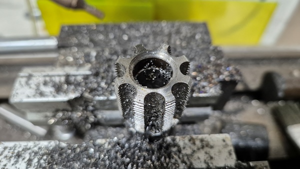

Then took it over to the milling machine for a few flutes.
Attachment 47867
8 in total
Attachment 47868

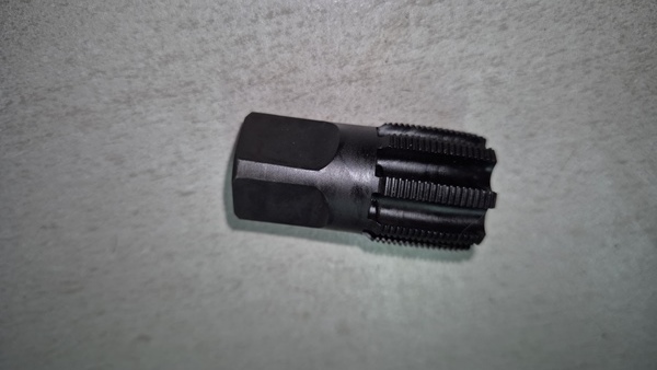

Then flipped it over to cut a square on the back end
Attachment 47869

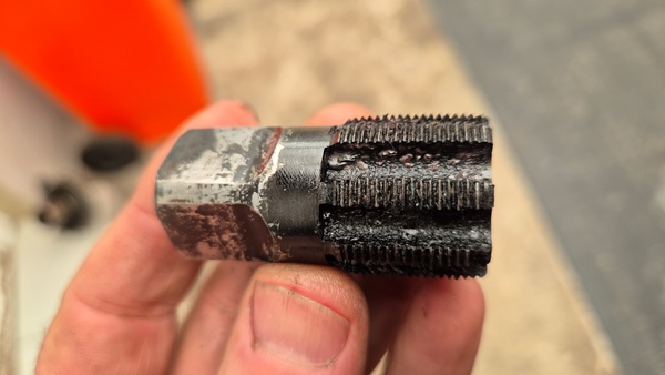

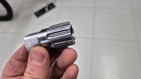

Done
Attachment 47870
Looks a bit messy after the heat treat, but nothing a scotchbright wheel cannot solve

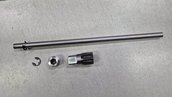

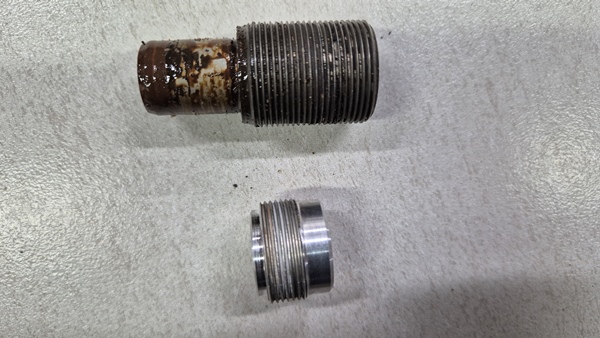

Then made a small guide adapter for the opposite side from and old buggered pivot
Attachment 47872
And finished of with a 12mm stainless guide shaft.
Attachment 47873

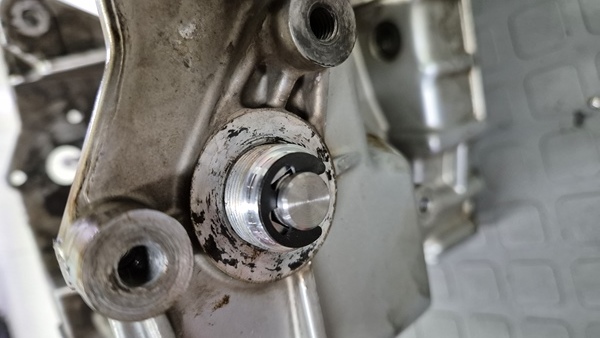

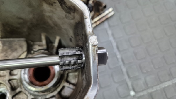

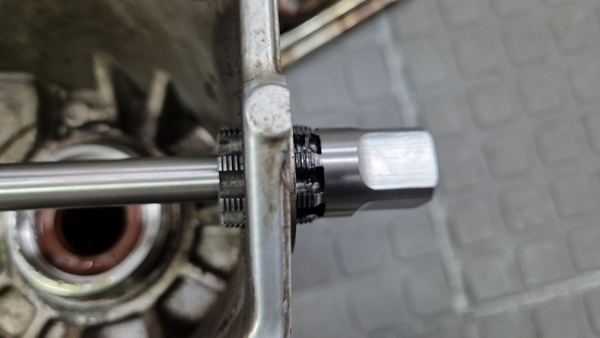

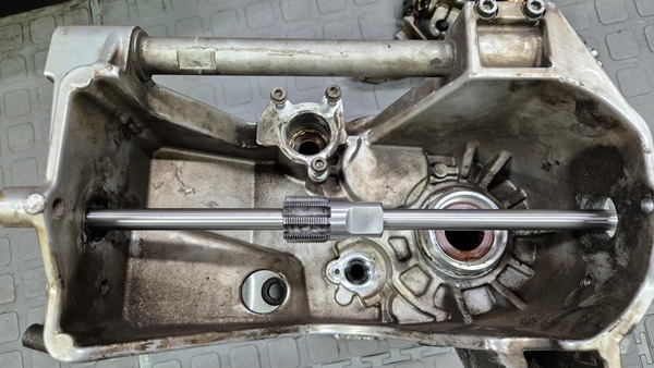

So it works like this
The guide adapter screws into the LHS pivot hole and accommodates one end of the 12mm shaft
Attachment 47874
The newly made tap slides on the guide rod and is used backwards and exits the hole on the RHS, repairing the thread as it goes. This ensures that the thread is exactly in line and there is no chance of cross threading it, which is very easy with such a large (26mm) tap.
Attachment 47875

And with a little black added.

Nice fix, I had to do similar for the exhaust ports of my veteral AJS.
A hollow tap with internal guiding rod is a rarity indeed and a unique way to insure you started straight in the original undamaged part of the thread.
Not saying they don't exist, but I don't think I've ever seen one other than line taps for tubing fittings
