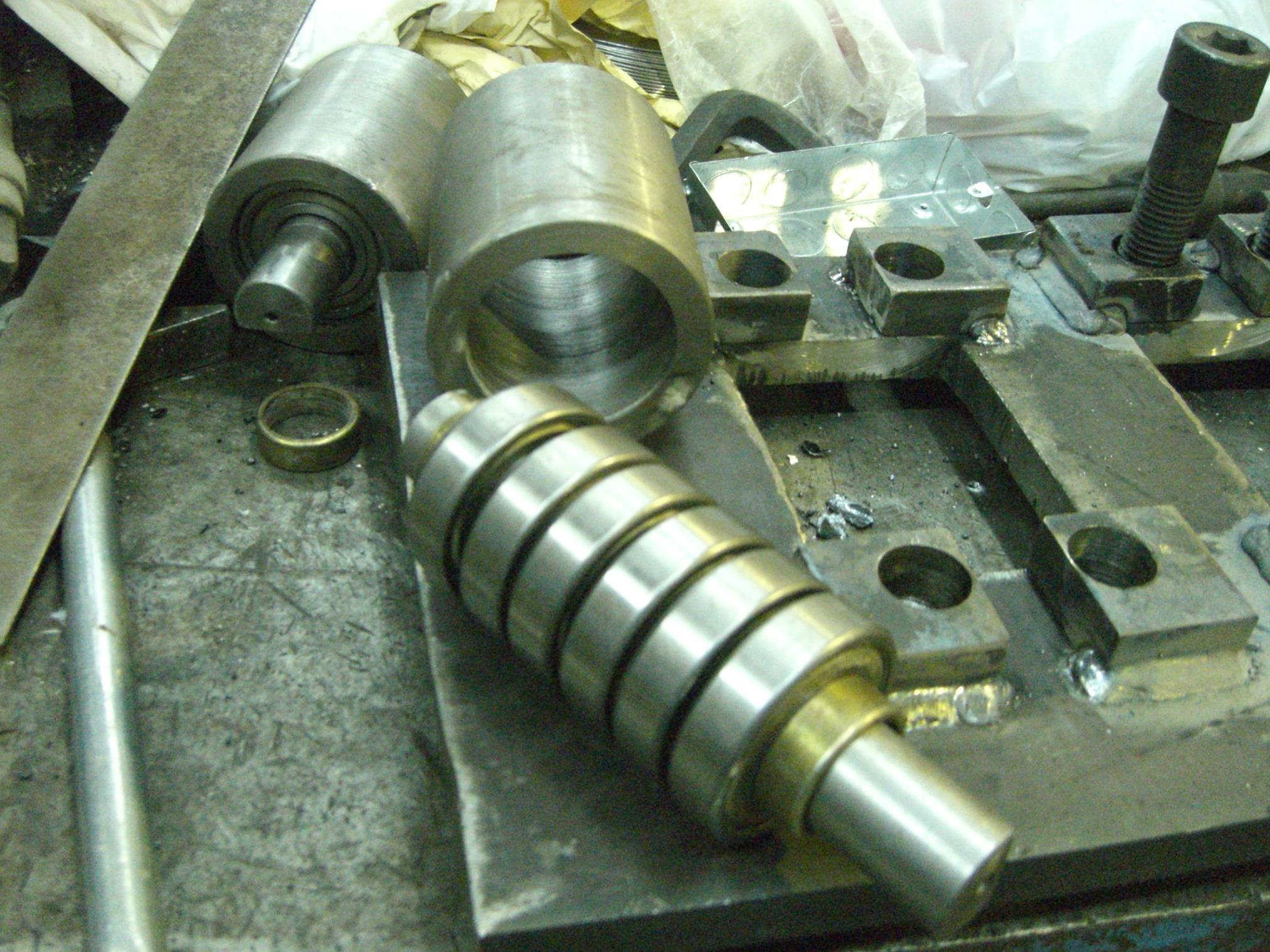

the bottom bearings
Attachment 31919

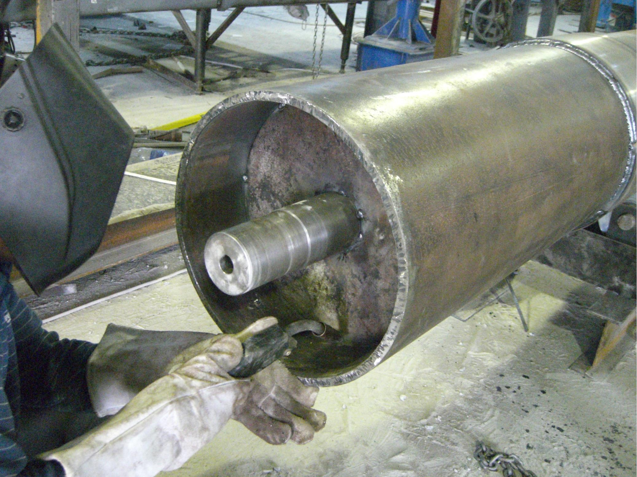

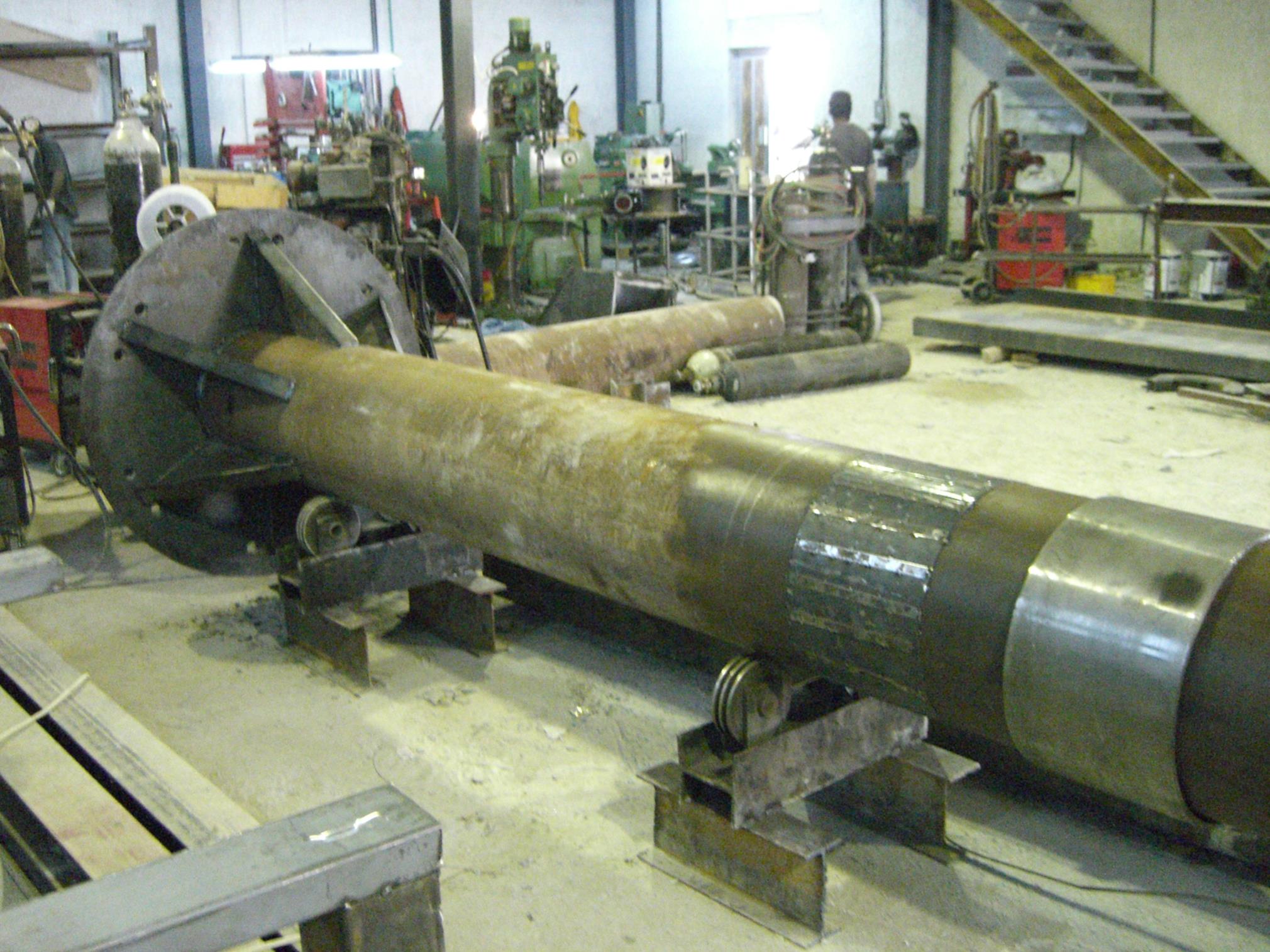

the crane leg 18" sch 160 pipe
Attachment 31920

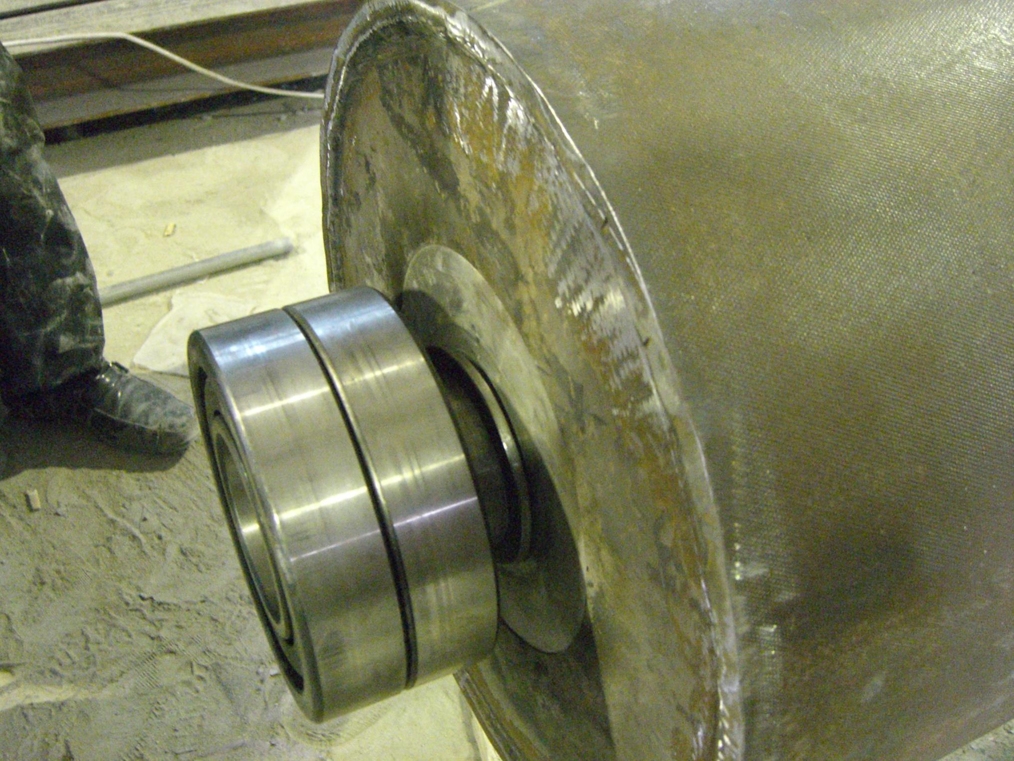

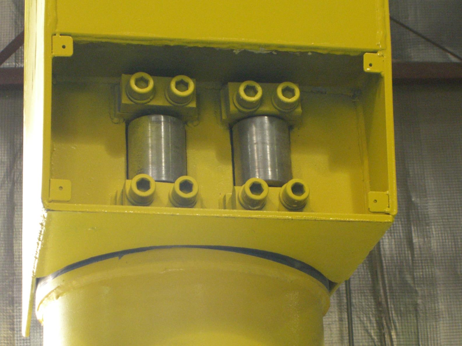

the bottom bearings before assembly into the outer shell
Attachment 31921
top bearings on the 3 1/2" top pivot shaft
Attachment 31922
crane leg machined, fabricated and ready for paint
Attachment 31923

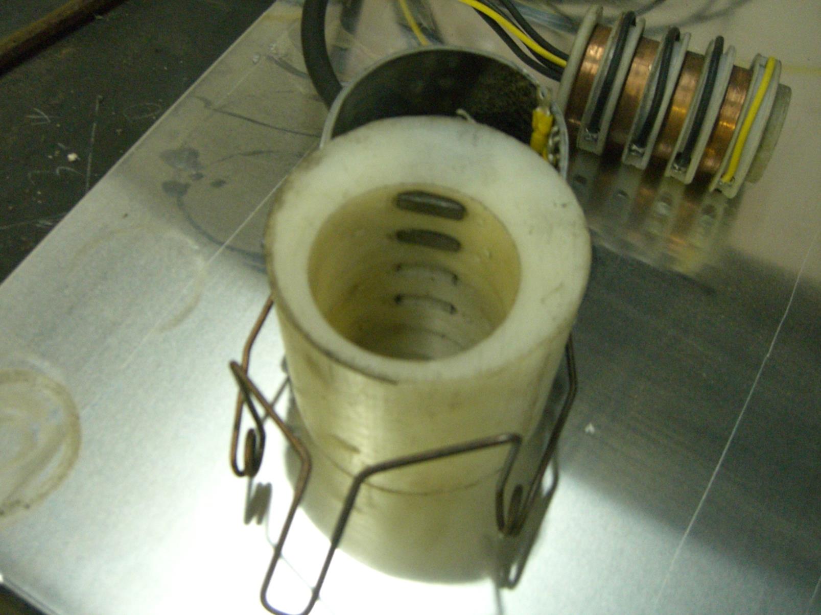

Home made carbon brush swivel for 3 ph with ground 3/8 by 1 1/2" brushes
Attachment 31924

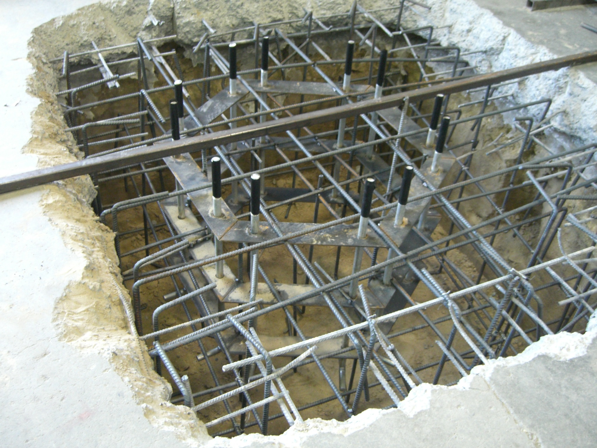

Anchor bolt assembly for mounting of the crane the pit was dug 6 ft deep 10 feet wide by 10 feet long
Attachment 31925

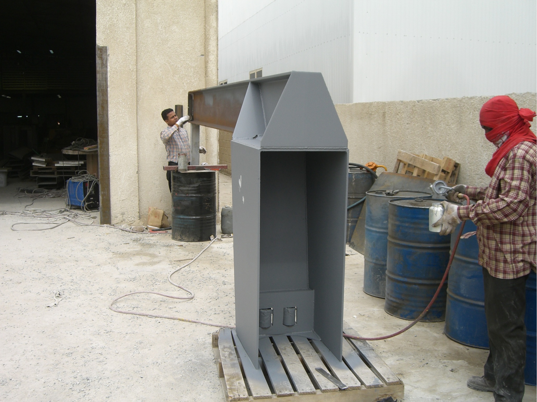

crane boom ready for paint

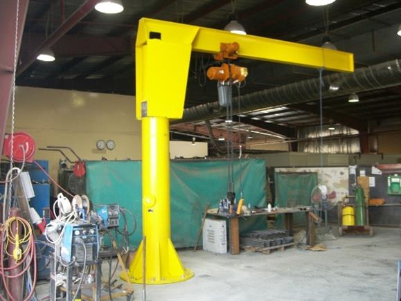

Attachment 31927

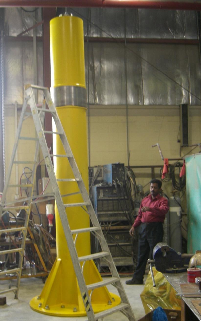

installed and ready for use
Attachment 31926
