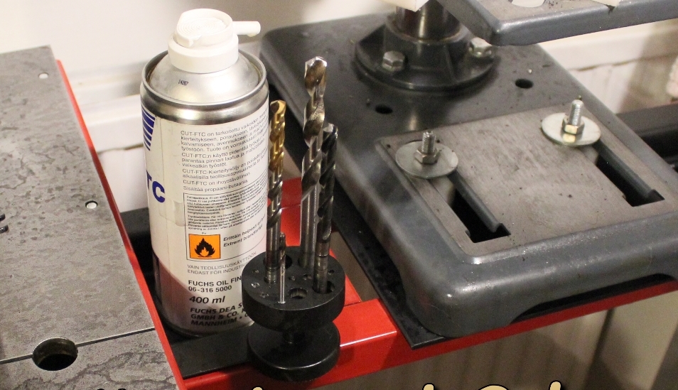

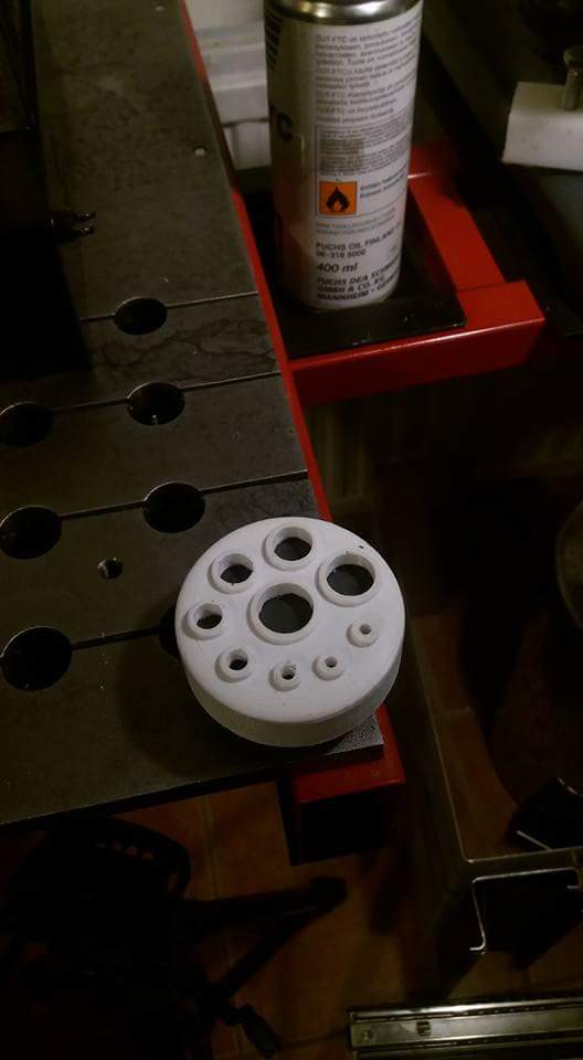

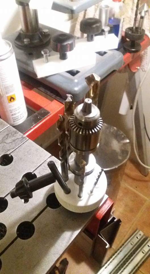

Made this holder for dremel and drill bits.
Attachment 20129
Its for keeping near those bits that im currently using.
Magnet hold bits on their place even upsidedown.
Faster bit changing.
Materials:
3D-print "hat" and two magnets. Magnets connected together with cut M6 bolt.
Magnets was 2.5€ each.
Design in tinkercad: https://www.tinkercad.com/things/llD...or-50mm-magnet
