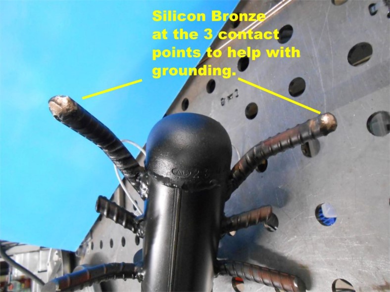

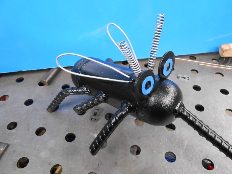

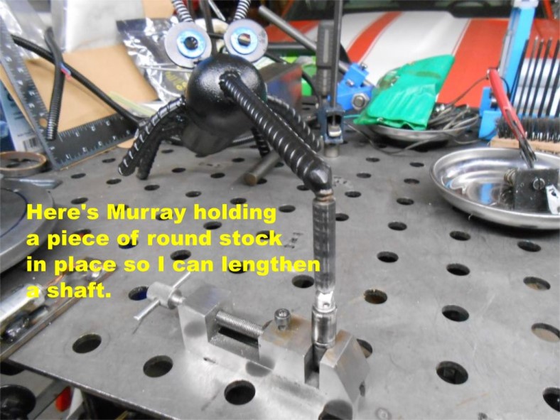

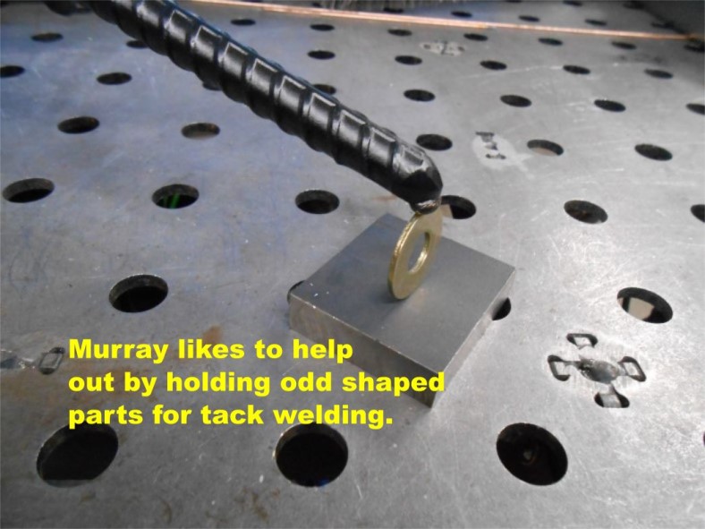

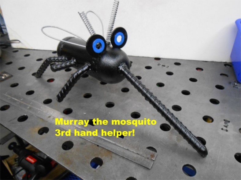

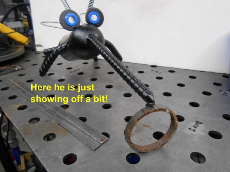

Meet Murray! He's my new welder 3rd hand helper. :D

I like the bug motif. The body is heavy enough for secure hold; but I wonder does the fulcrum so far back lessen potential?
Not re-arranging the legs, the body position, perhaps sliding along the rod.
It has a nice amount of forward weight to it lifted up on tall objects. It's quite heavy overall. If you needed to use for a very tall piece I suppose you could put riser blocks for the rear legs to sit on. :)
