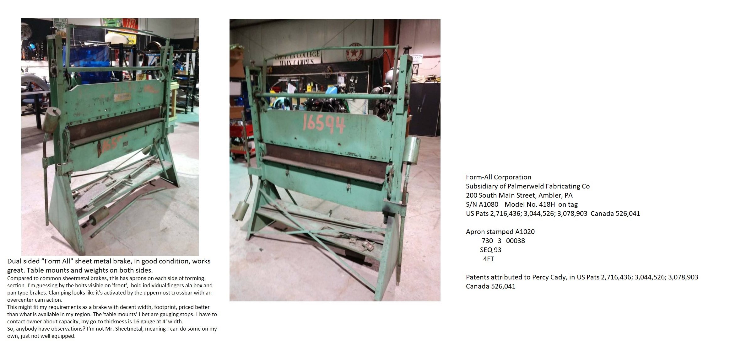

I, for one enjoy patents. Especially when related to products I utilize in some manner.........So patents articles as you've generated already, are informative. For me an even greater benefit would be in the technique, maybe a 'checklist' of recommended & successful search avenues.
My brake is a good example. Very little appears, even less starting from my usual point -brand name and trademark.
Attachment 25925
So far, patent numbers and date info was not all that close to what I have. Kind of disappointing.
