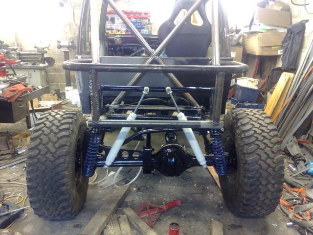

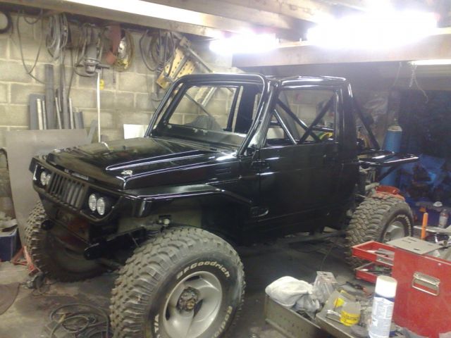

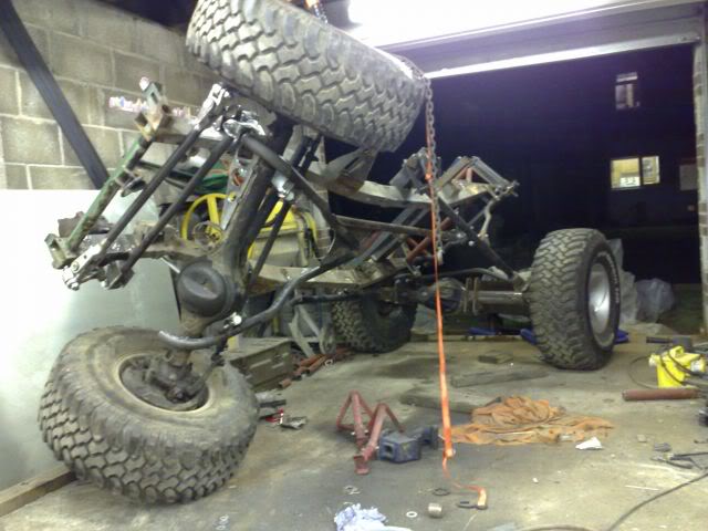

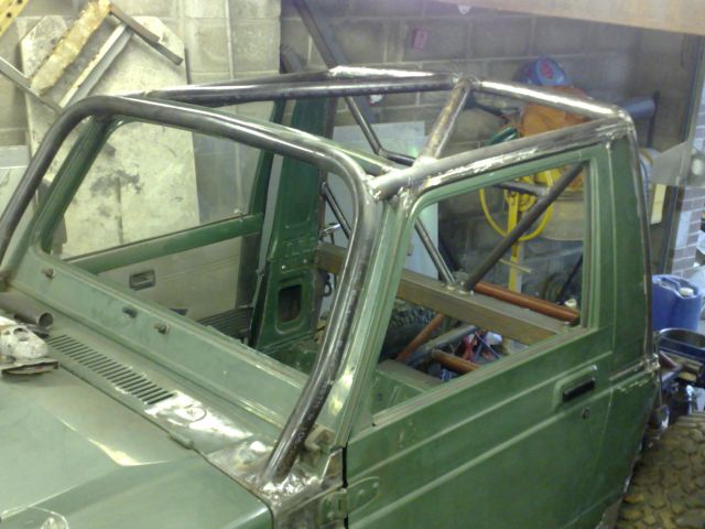

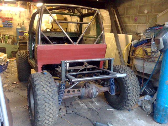

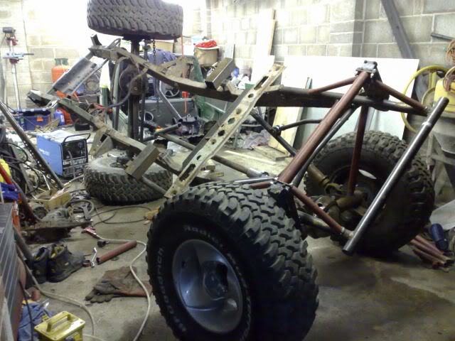

This Samurai, built by TripleZuk on Pirate4x4.com, showcases a great deal of fabrication ingenuity.
The build started with a donor LWB Samurai that came without an engine. TripleZuk added a 1.6L 16V EFI engine, shortened the wheelbase, installed ARB lockers front and back, and mounted 33" tires.

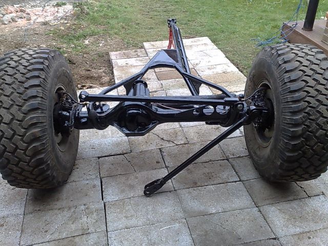

Among the numerous unusual custom additions were a triple transfer-case, a custom tank to hold the fuel pump so that fuel can be delivered while the vehicle is at any angle, custom-fabricated mufflers, and a custom rear suspension setup designed for maximum travel with zero rear steer. Hence the build name: "Triplezero".
