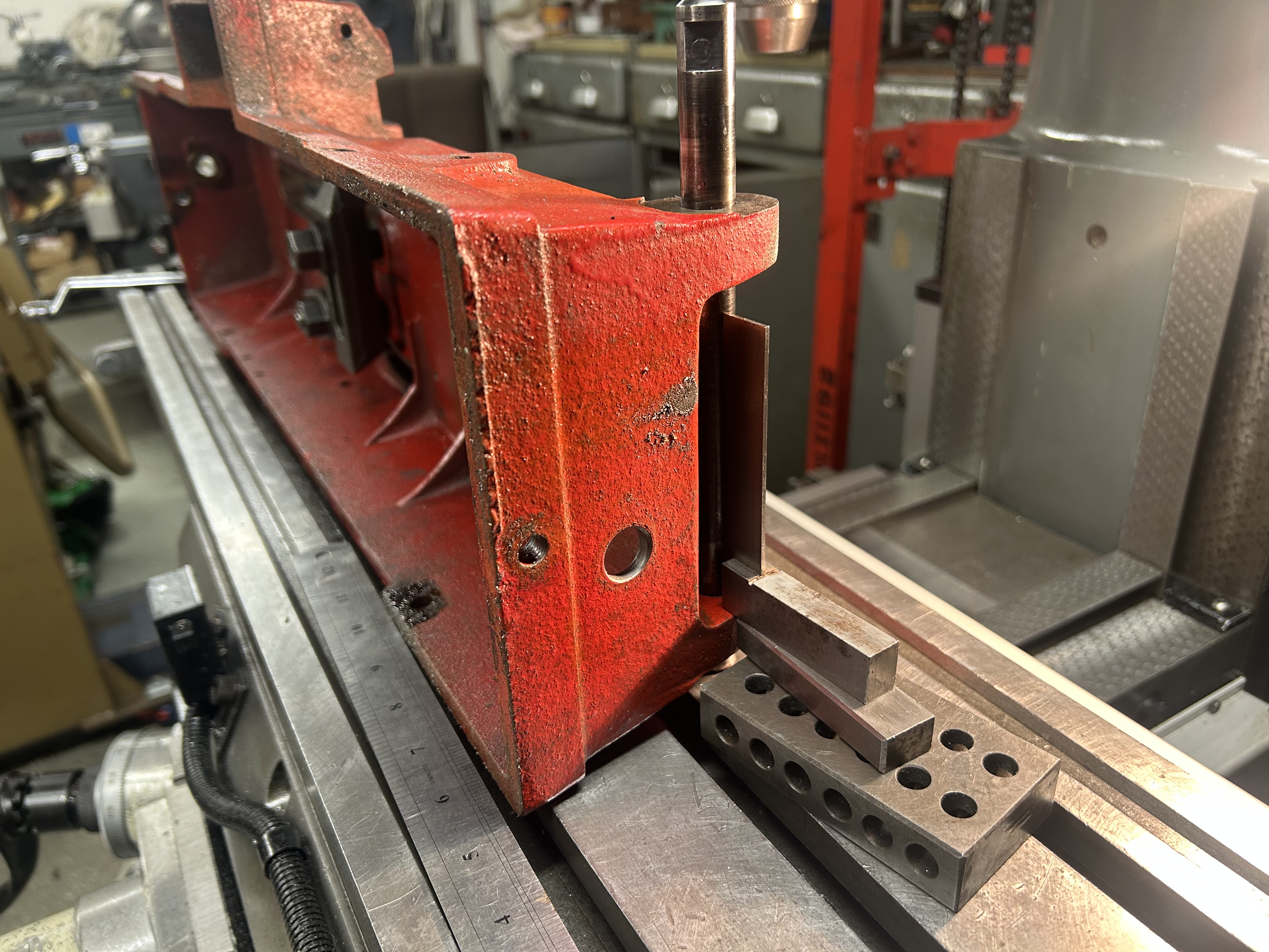

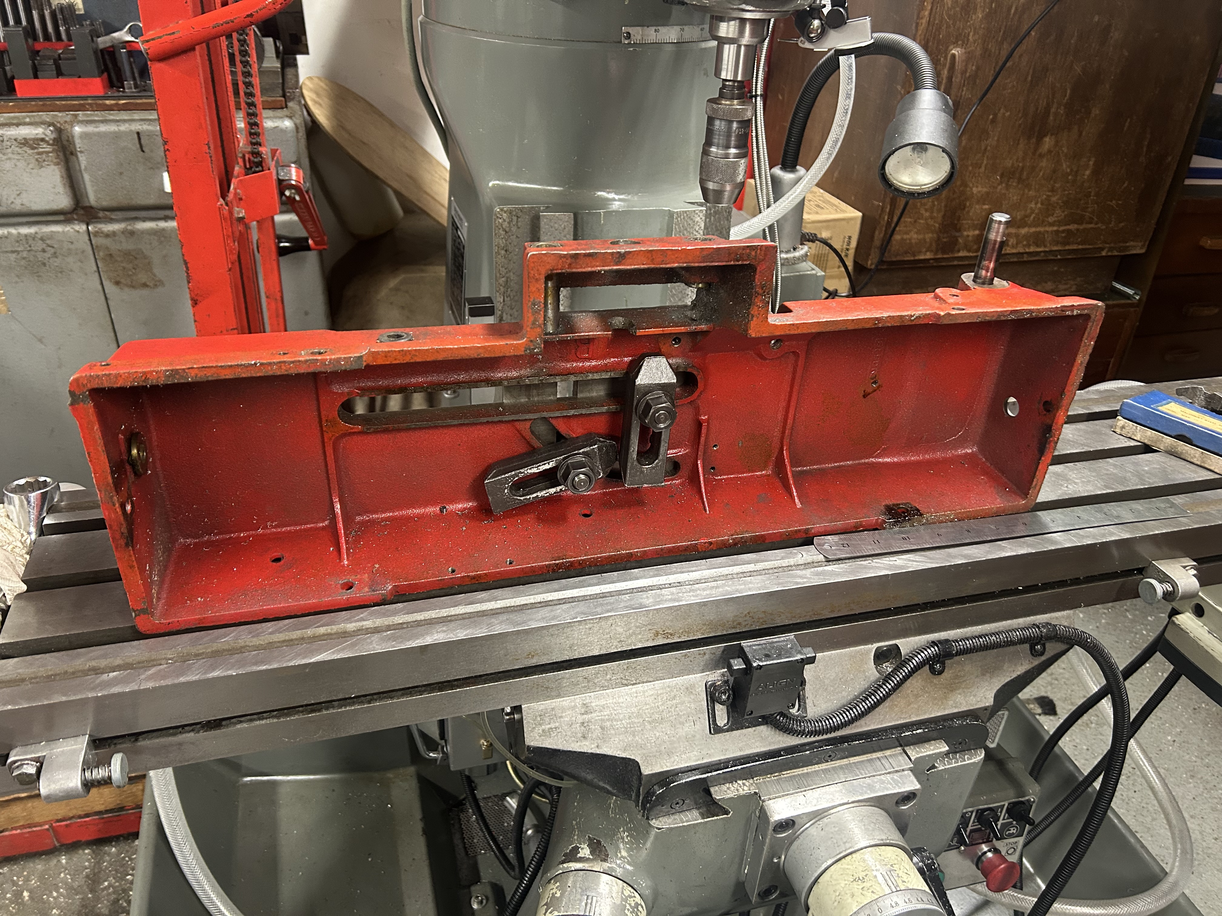

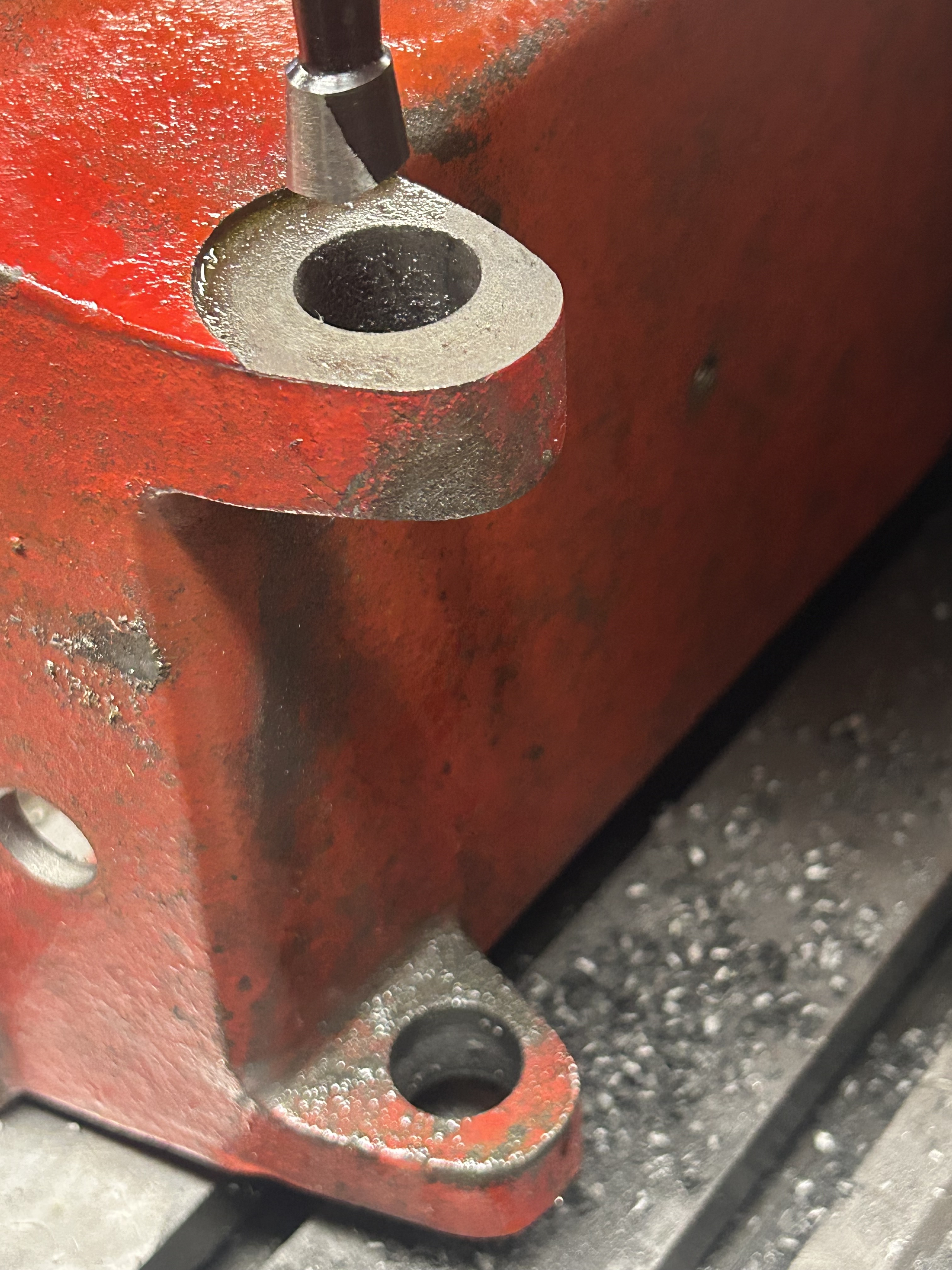

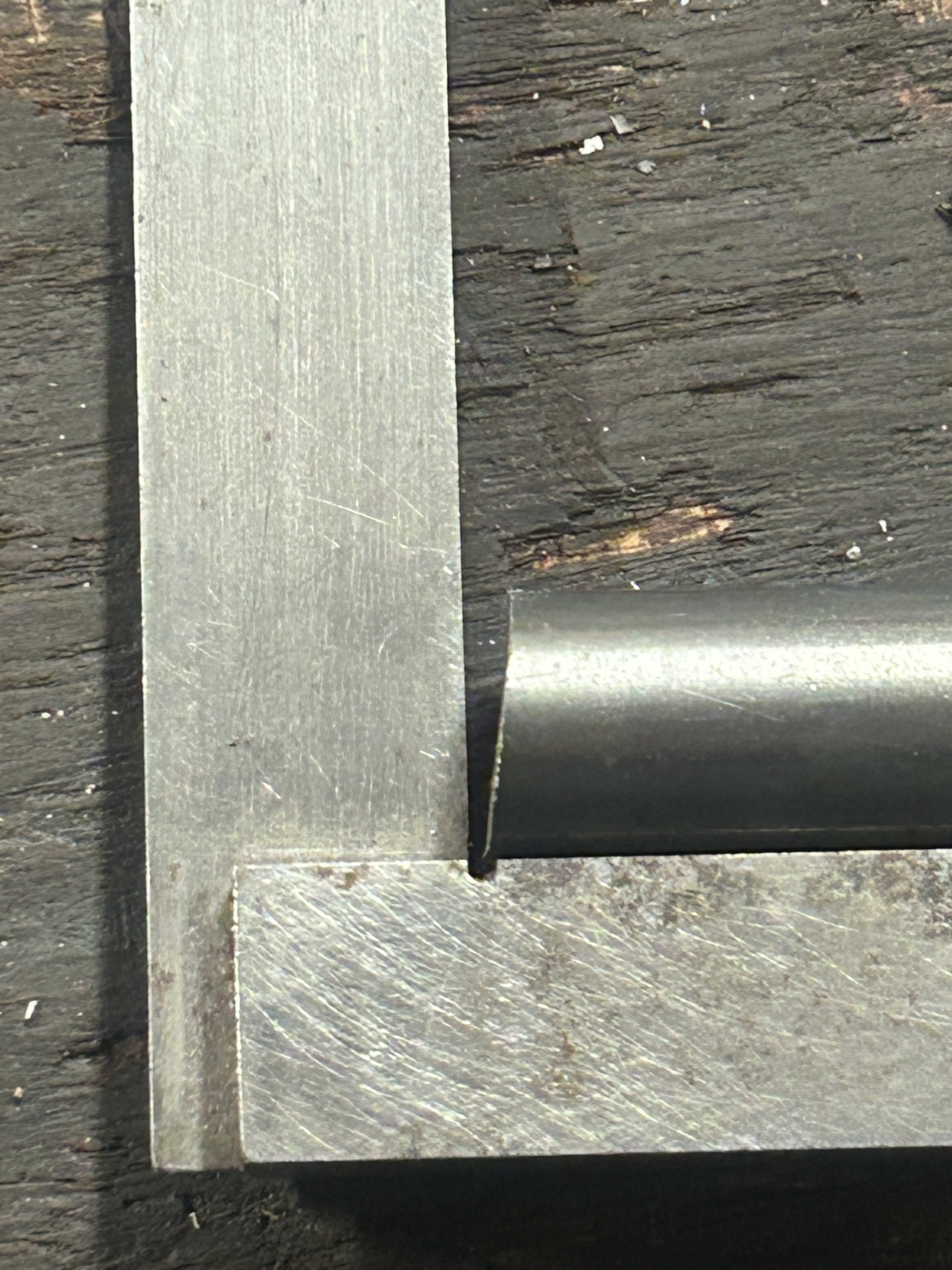

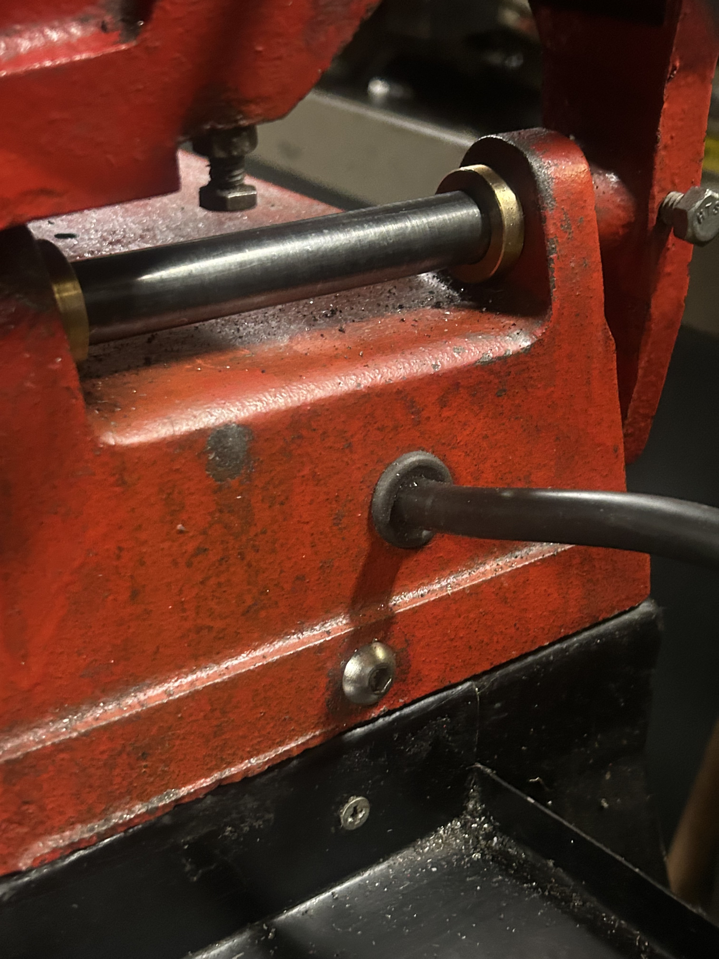

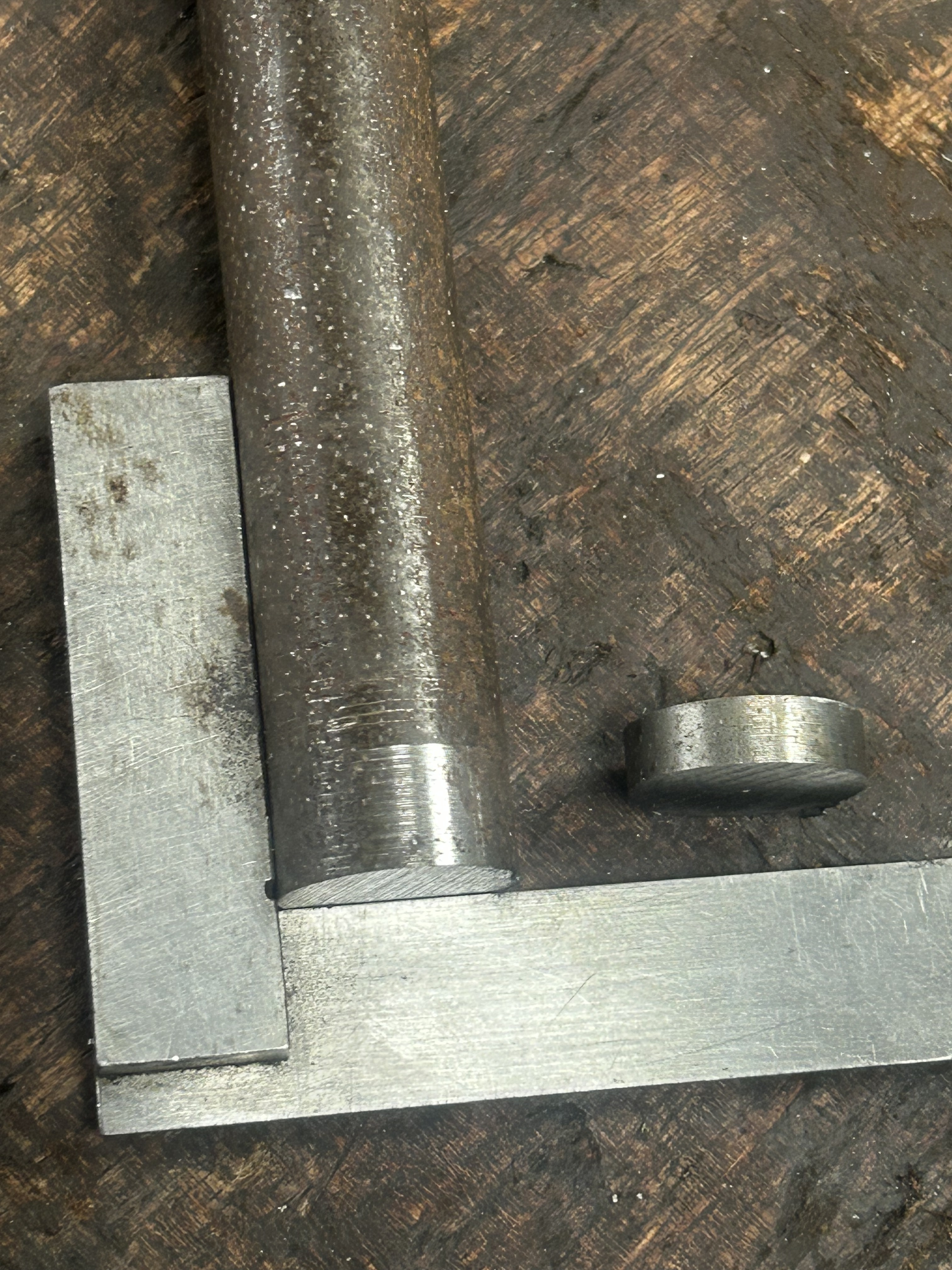

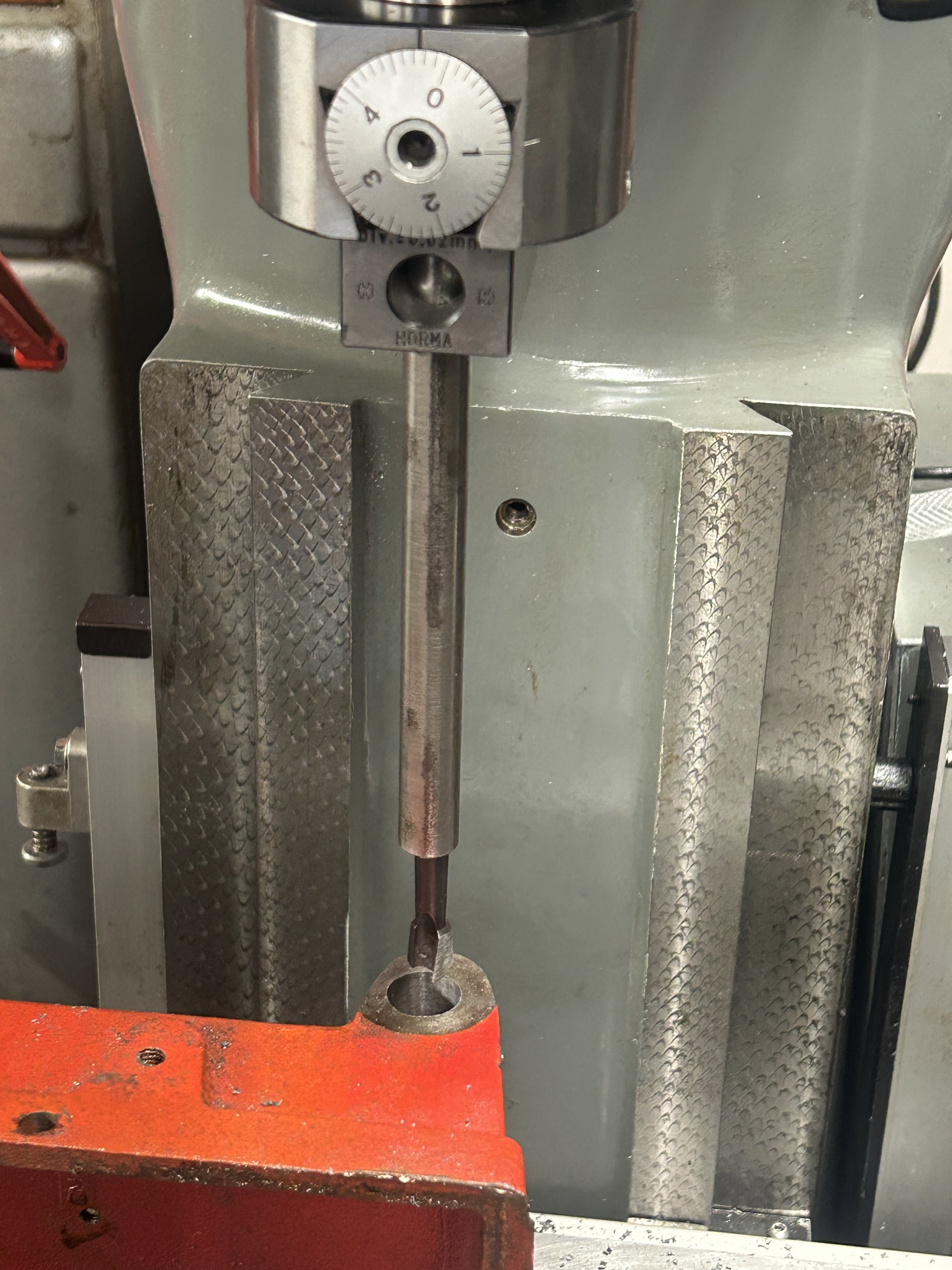

I have had issues with my 40 year old 4x6 bandsaws throwing blades and not cutting square, which got to the point where I didn’t want to use it for the last year or so. My last project needed some larger size stock to be cut, so it was time to investigate the issue. All the normal checks had been made so there had to be something more serious. On inspection there was plenty of of side play which appeared to be wear in the casting where the bandsaw pivots. The saw was stripped down and there was 0.035” of wear in the casting. To overcome this problem I decided to machine the casting and fit bronze bushes. The following photos show the setup and the final result.
Attachment 5033712mm diameter bar not cutting square.
Attachment 50338Base clamped to angle plate.
Attachment 50339Checking alignment with a square.
Attachment 50340Extended boring head bar.
Attachment 50341Both holes bored out to accept bronze bearings.
Attachment 50342Bearings and saw put back together with no play.
Attachment 5034325mm diameter bar, saw is now cutting square.
