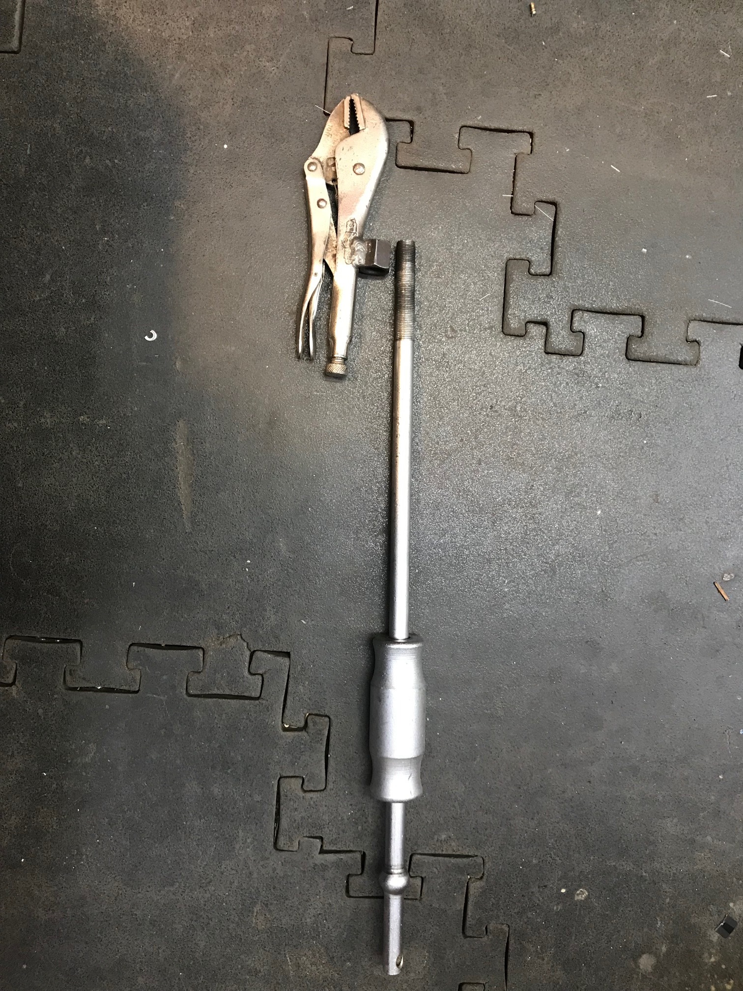

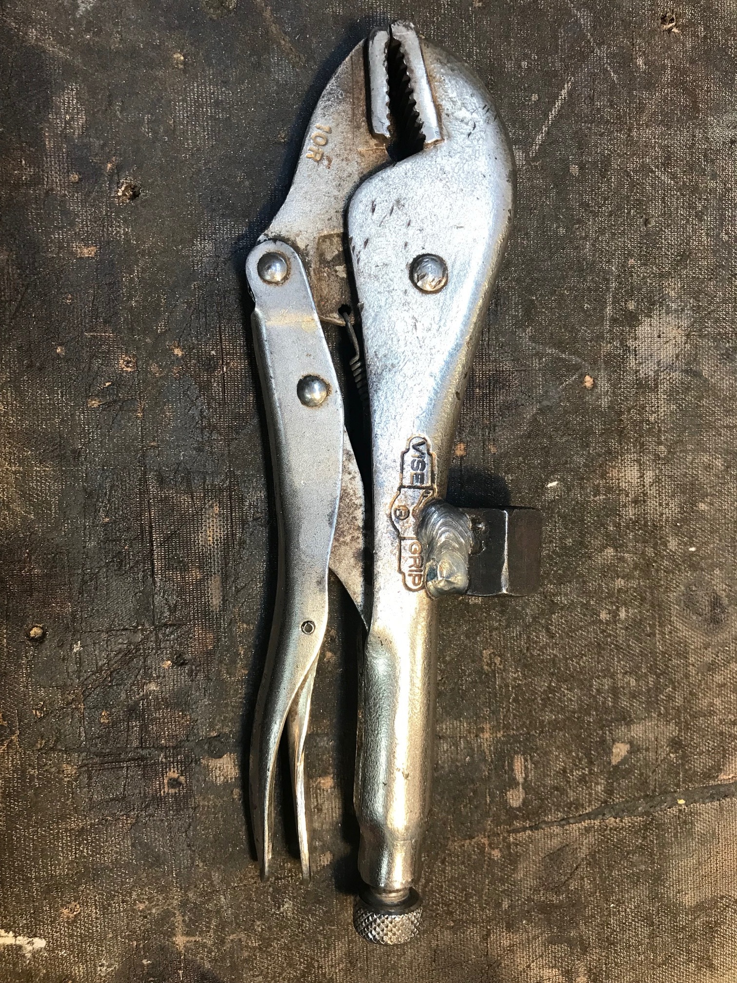

And you can weld a nut on your Vice Grips and use them with a slide hammer...
Attachment 43235
Attachment 43236
Another way to use a slide hammer w/visegrips:
