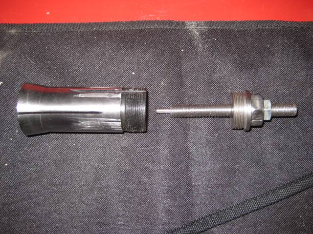

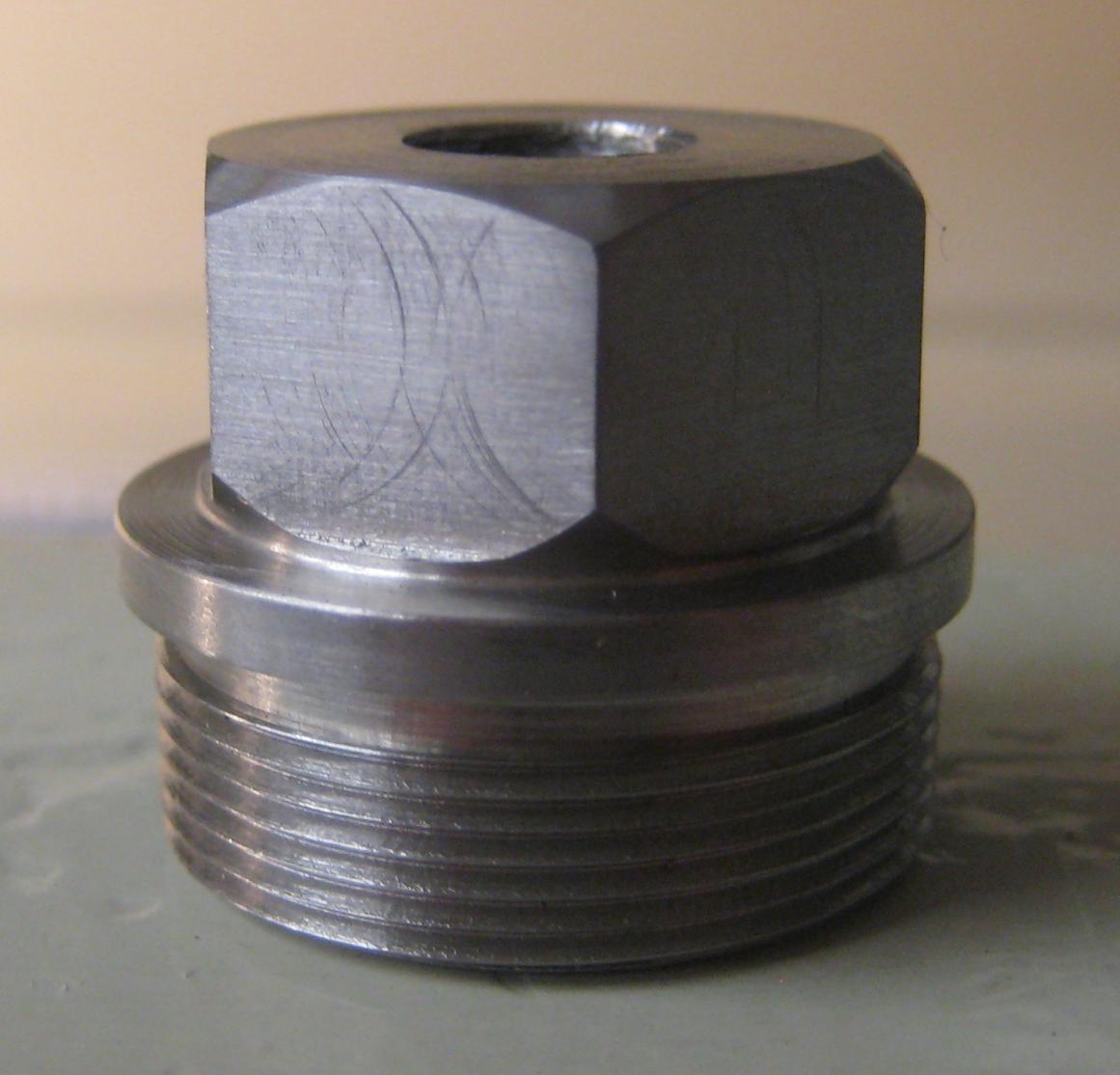

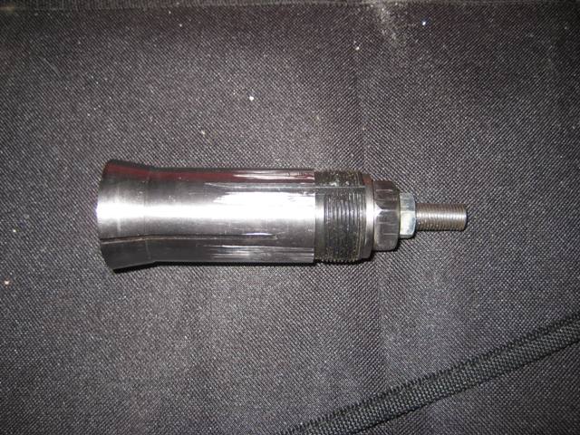

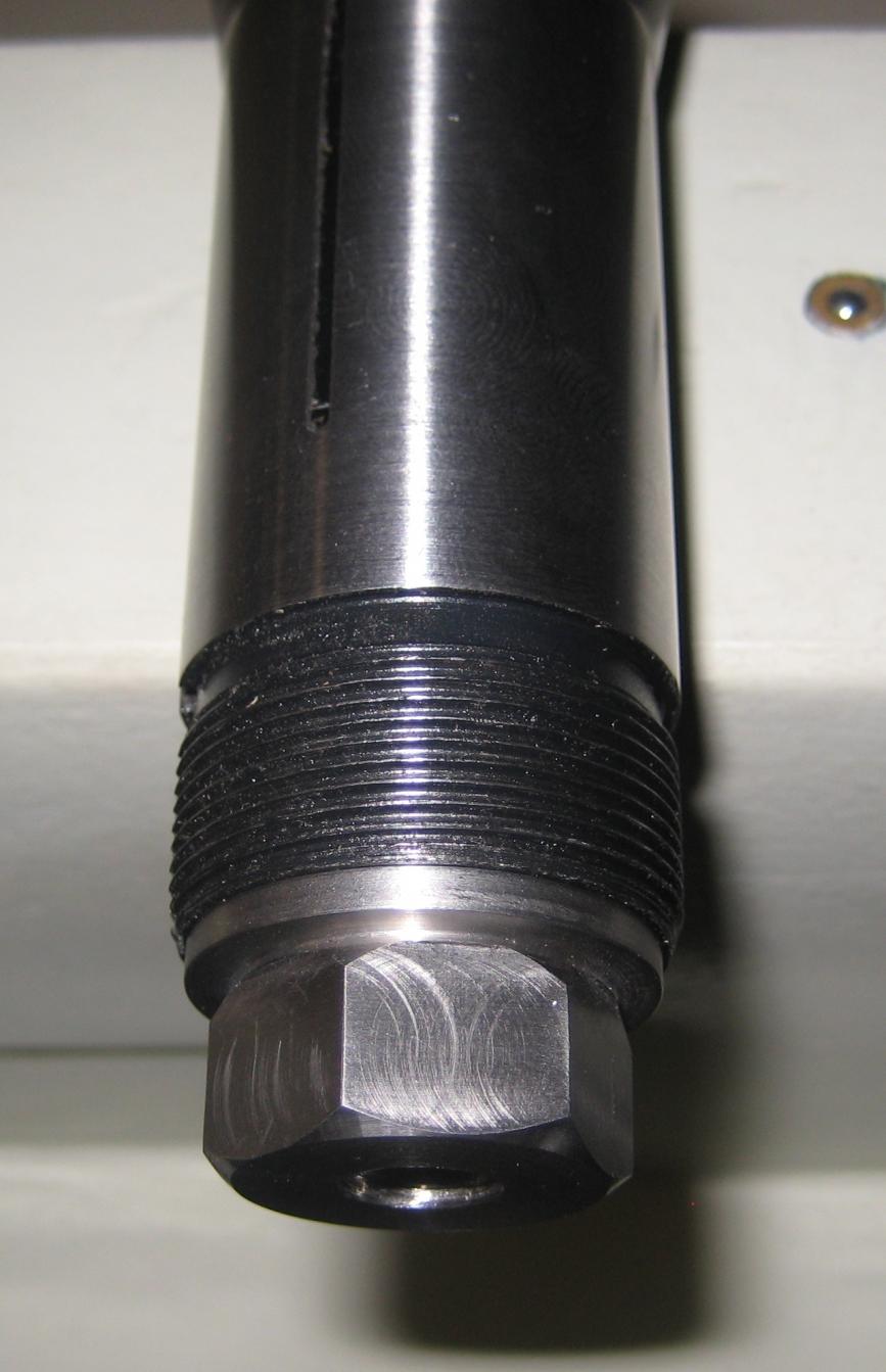

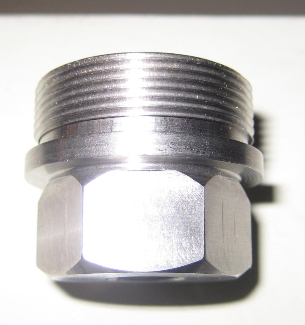

A 5C Collet stop
This gizmo threads into the back of a 5C chuck. A threaded rod with a jamb nut runs up through the center. It can be positioned to locate work in a collet for multiple operations or multiple parts. You can, for example, use this to part or face stock to the same lengths.
Attachment 257Attachment 258Attachment 259Attachment 260Attachment 261
