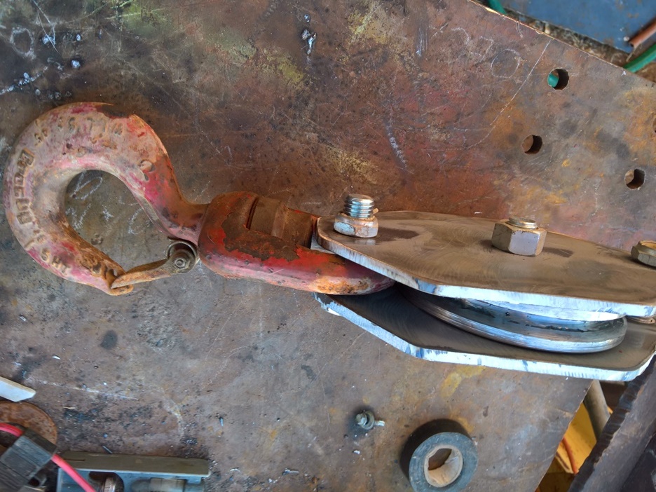

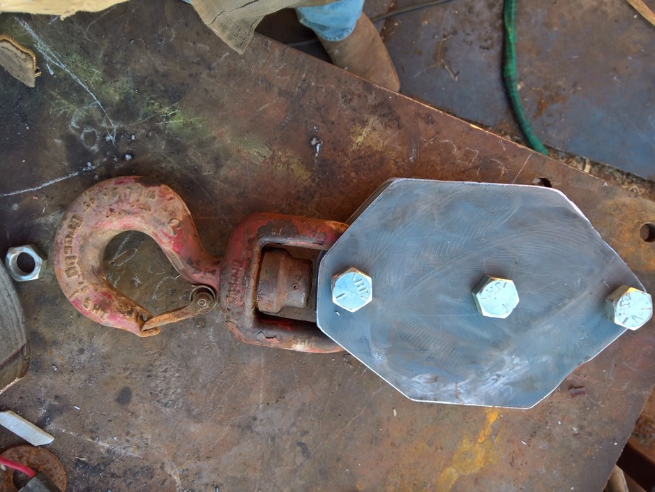

I made this 6 inch snatch block in a similar fashion as the 4' one with the exception of adding a 5 ton Crossby hook with sfety catch.
Attachment 32634
Attachment 32635
Attachment 32634
Attachment 32635
It does look like you made the pulleys from scratch.
Yep why waste 3/4" thick plate when I already had these thinner disks. Welding deep in the grove is always a pain and even harder to machine but a grinder will remove the air hardened bilby layer easy enough to allow taking a slight cut with HSS ground to a radius
That's a new word to me, a search changed the spelling to Beilby layer. Lots of odd research on the effects of surface treatments, polishing, passivation, that affect the atomic surface structure, and seen with x-ray diffraction.
But I understand your use as to the welding resulting in a air hardened surface layer that would be an PITA to cut through with just about any cutting tool.
I've always found using form tools to be noisy from the cutting force vibration of the tooling.
thanks for the correct spelling, yes the layer forms from chemical reaction of the welding process when quickly cooled called freezing the puddle.
This layer can also be formed from friction and or work hardening and has been known to defy just about every cutting tool designed at one time or another unless you can get under it on the first cut then it will simply shear way as chips the key is getting under it in the first place. More's the reason why I usually try ti grind it away as much as possible prior to cutting.
Even cutting through a weld with torch or a plasma can yield difficulties at times
