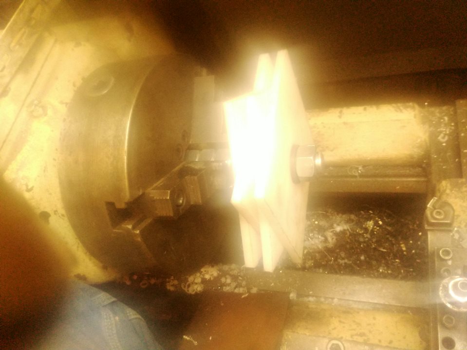

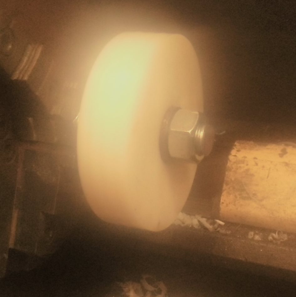

I needed several disks to fit the hone shaft for honing a 6" cylinder so I cut a few square blanks off of a strip of 6 1/2" wide 3/8" thick UHMW then cut some of those in quarters for the 3 inch disks
Attachment 40655
Attachment 40656
