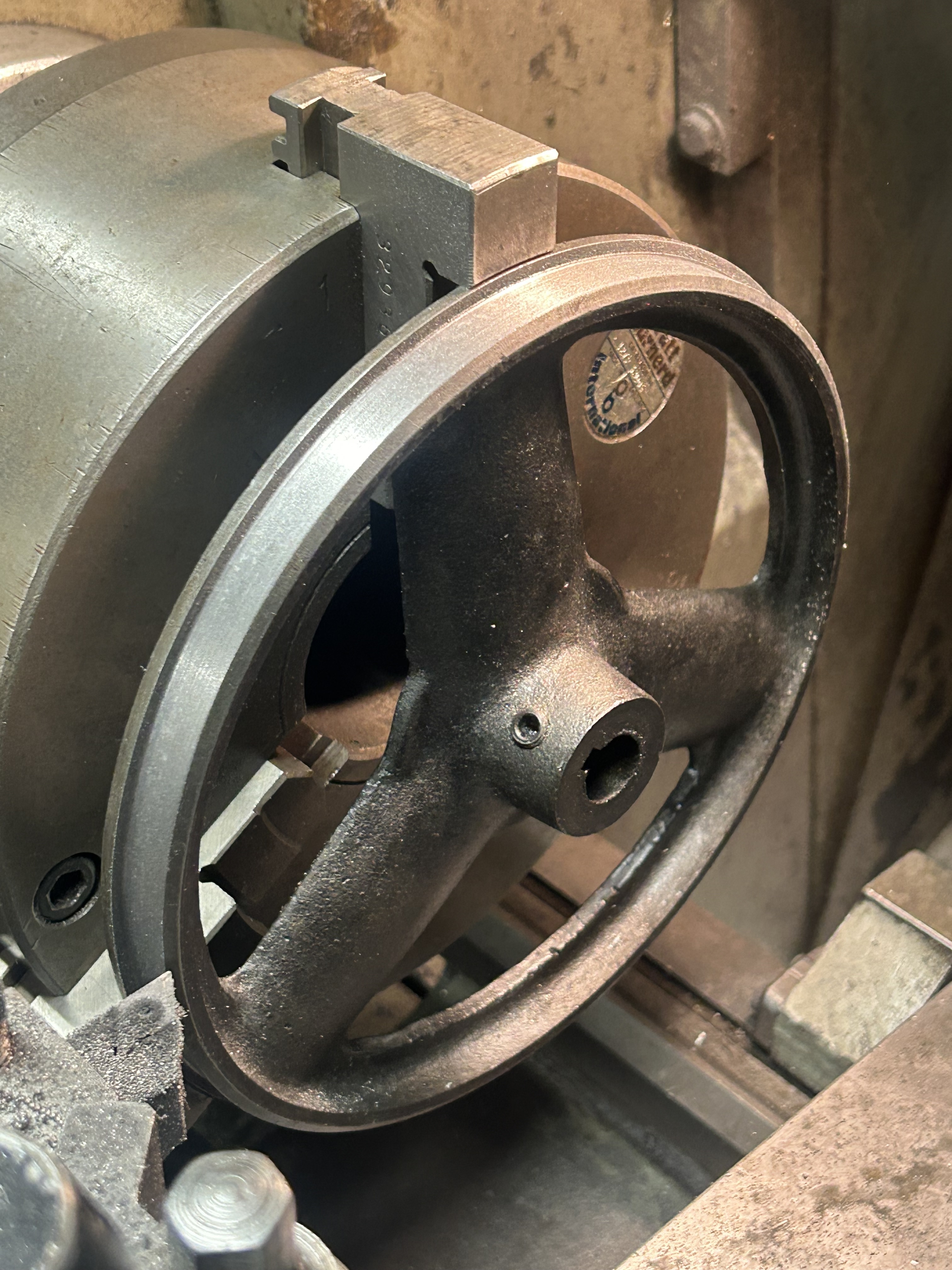

I have made many modifications and what I consider improvements to this machine. But no matter what I have tried from new it just keeps throwing blades. So enough is enough! l decided to try and machine the drive and idler wheels with a 2 degree taper back towards the flanged edge to correct this problem. This did work and stopped the blade from throwing off the wheels but created a different issue. As soon as the blade came into contact with the workpiece the blade would slip on the wheels. I couldn’t put any more tension on the blade and all other checks had been made with no improvement.

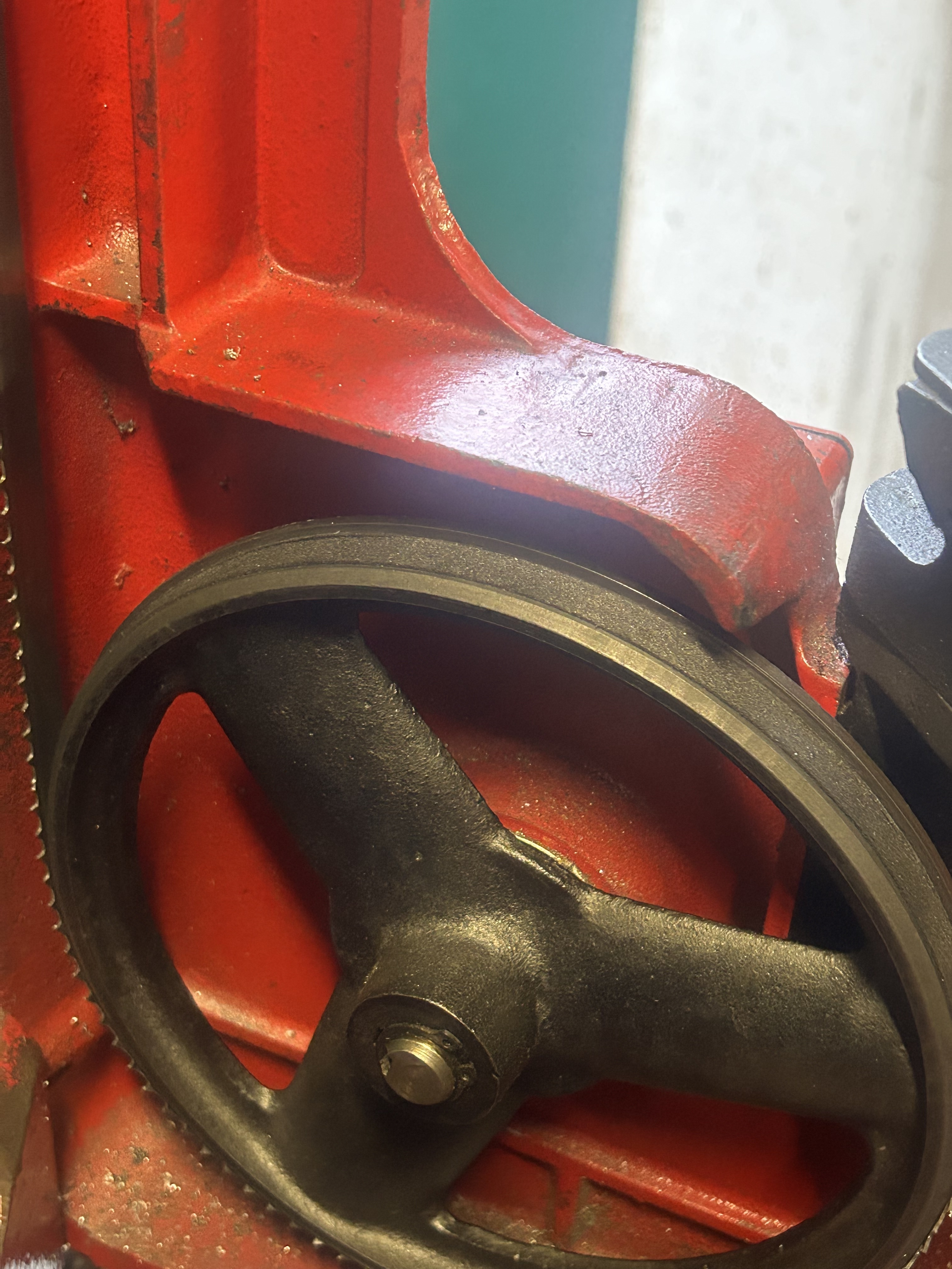

I left it for a week and was now considering purchasing a more industrial machine secondhand. But the machine had one last chance. I purchased some EVA foam seal tape self adhesive strip 10 mm wide 1 mm thick which is used for door or window insulation. Applied it to the driven wheel only and the blade no longer slips or jumps off the wheels. The foam acts like a tire which is found on the more expensive machines. It has been on the machine for a month and several cuts made with no issues.

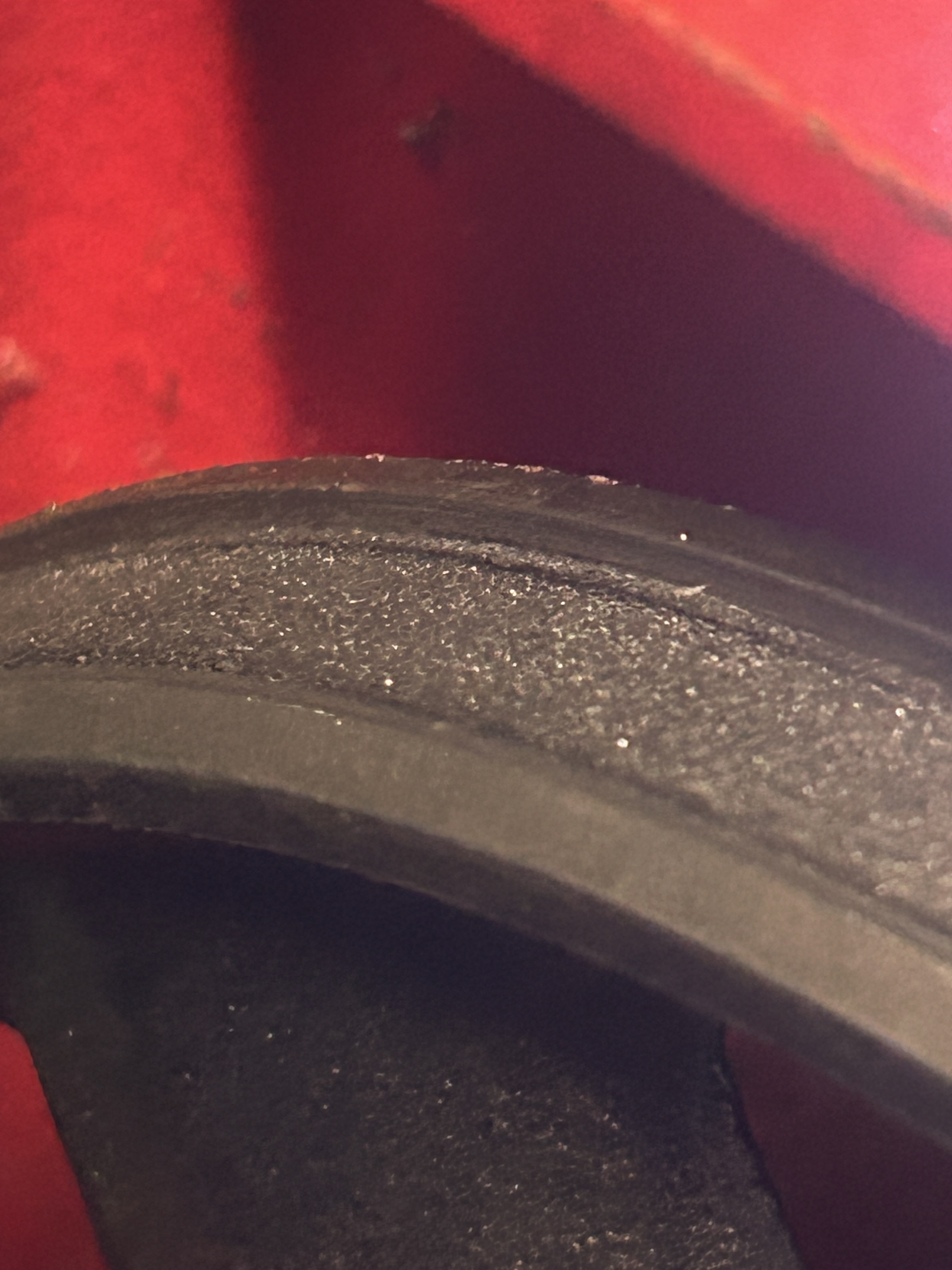

Attachment 47510 Tape on wheel
Attachment 47511Blade teeth doesn’t ride on the tape.

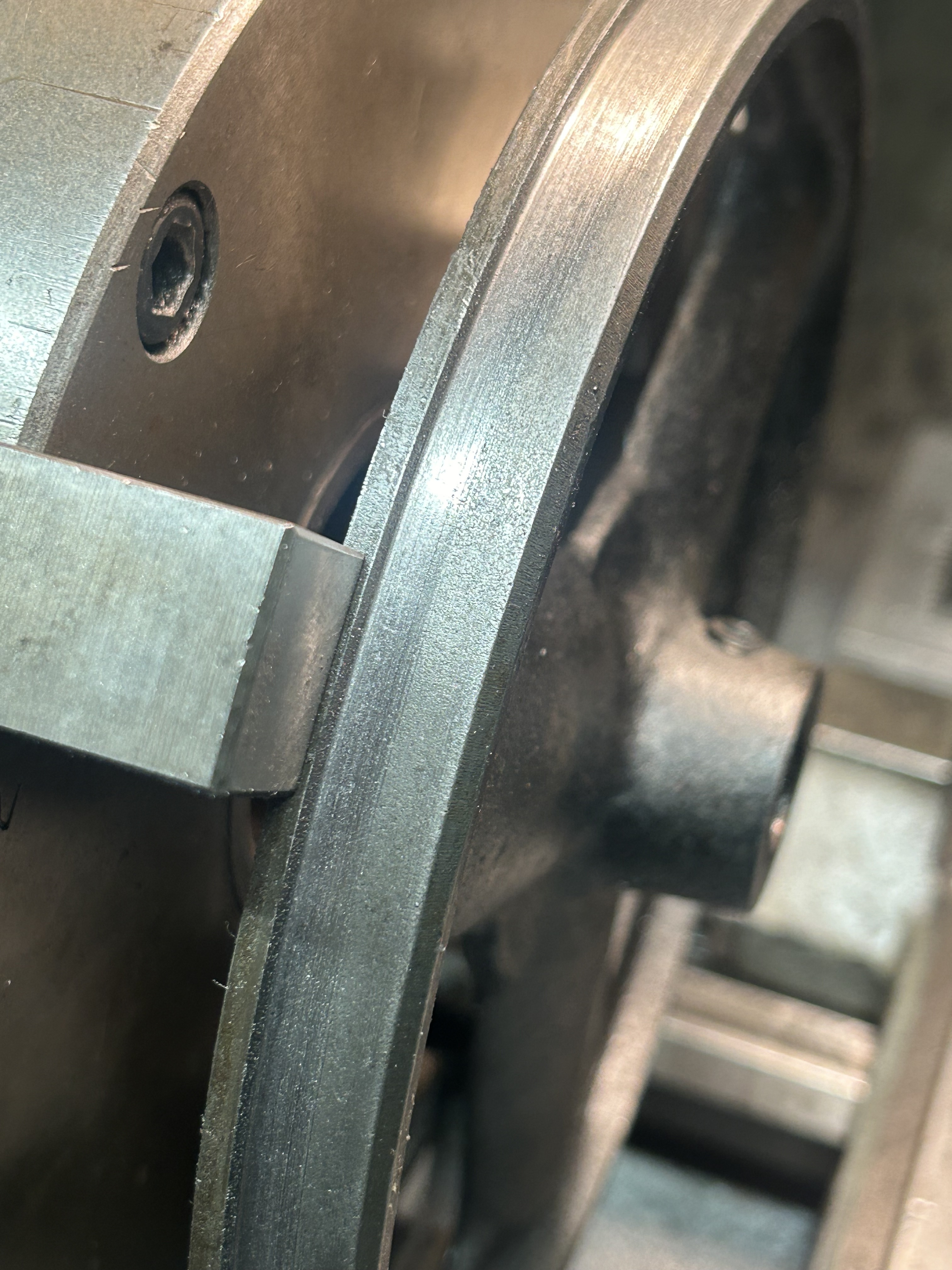

Attachment 47512Machining taper
Attachment 47513Surface is very smooth which I think caused the blade slippage.
