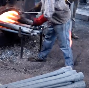

Some things that really caught my eye;
Steel Toe sandals.

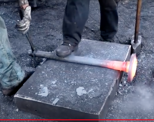

Attachment 40045
Surface plate for checking run out and straightness.

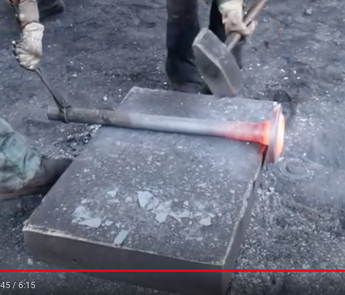

Attachment 40046
And the precision used to straighten any defective axles.
Attachment 40047

It's an impressive amount of work to accomplish in just two heats.
I think there may be 3 heats involved. At about 1:40 they switch from straightening the bends to reducing diameter. Cannot be sure but I think they may have reheated before they switched to that work station.
