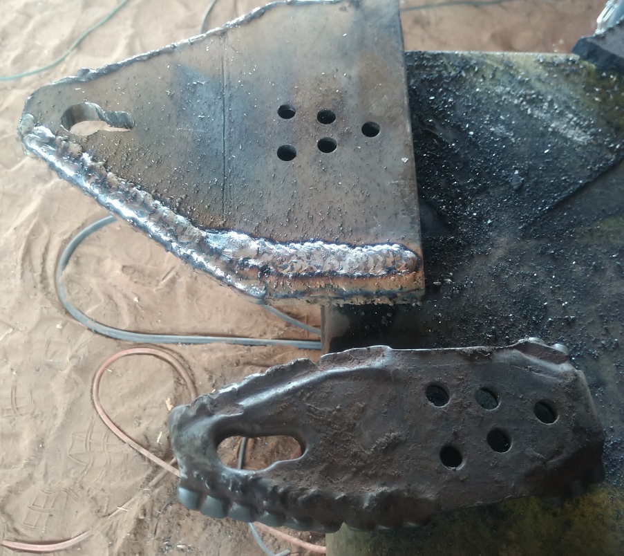

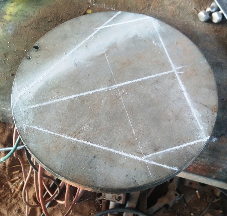

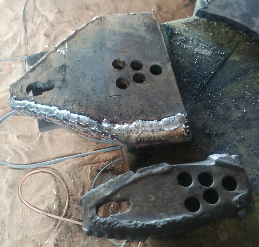

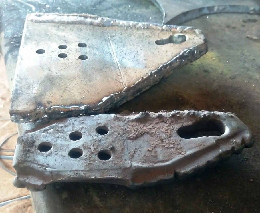

In the horizontal earth boring world some tooling for older machines is no longer available or if it is it will be 6 months lead time to get replacements.
If you remember a couple of weeks ago, I made a 4-conduit chute to plow in the conduits for fiber cable. Now they need to cross under a road but the largest bit available was 6 inches,
made then one that is 9 inches Out of 5/8: tempered stainless and hard faced the digging edges
Using a worn out 4" duck bill bit for the hole locations and bend angle
Attachment 48995
