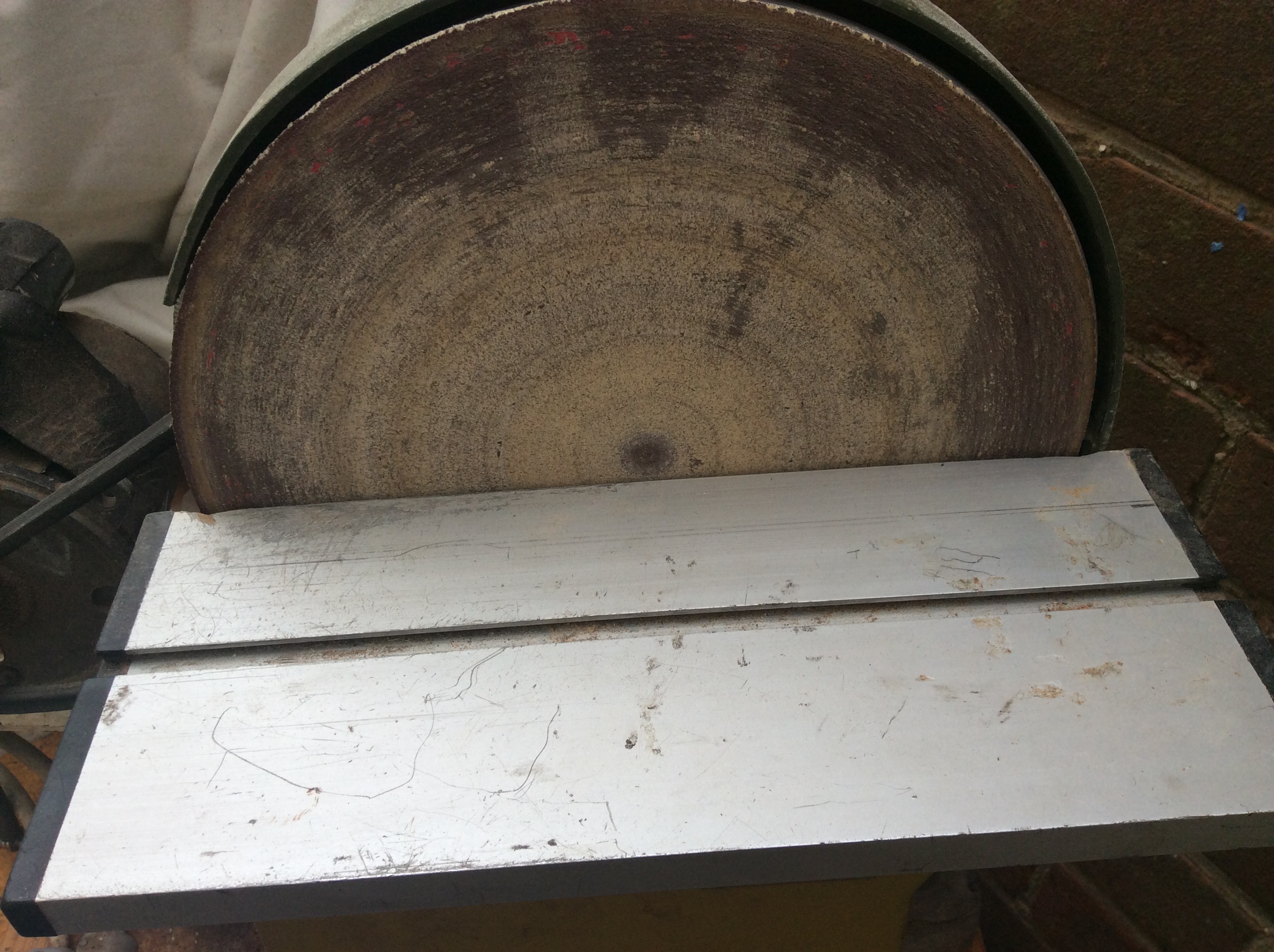

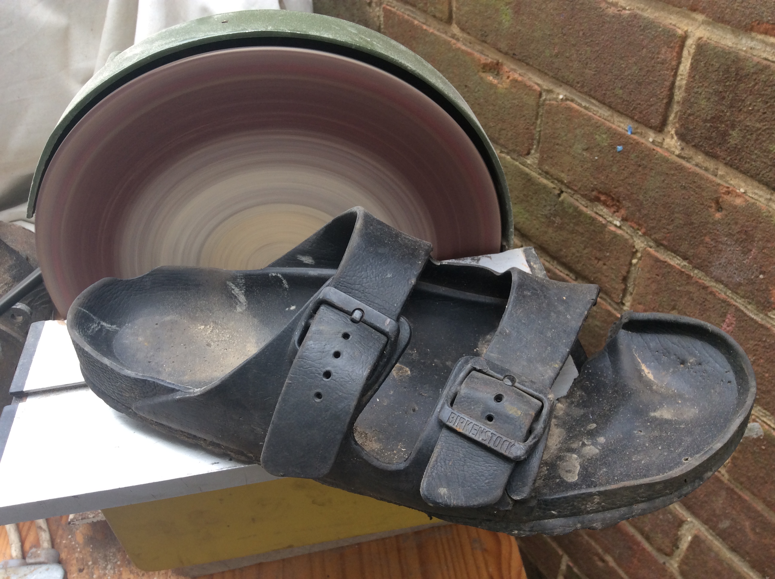

    I think that an old shoe is just as effective as a proprietary sanding belt cleaner

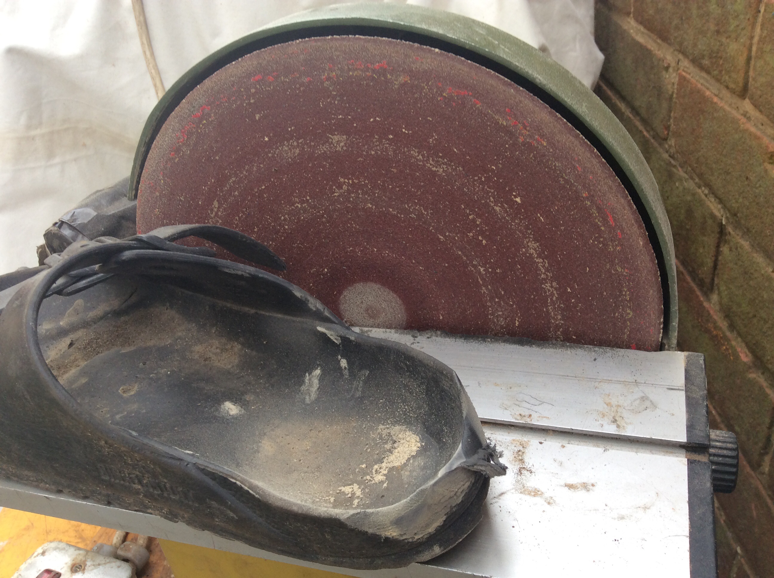

    Supplementary picture showing cleaned disc and the amount of wear on the sandal.

    I use an old tube of silicon that has gone off and that seems to clean disc and belt sanders pretty good.
