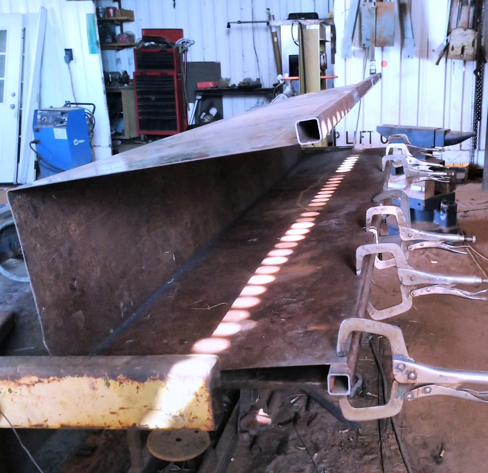

Made from a full 4x8ft sheet of 14ga Much deeper than I need but better to be too deep than not deep enough.
Attachment 45261

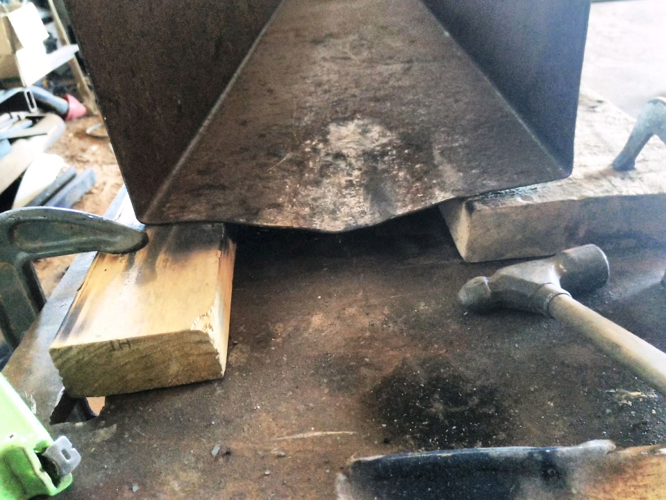

trough formed in for draining.
Attachment 45262

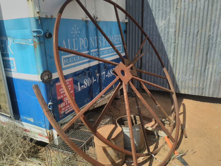

source of sq tubing for legs and rim the round part I straightened out to a larger radius to make trusses for my green house.
Attachment 45263

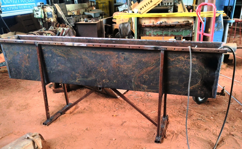

finished vat just needs painting but that will wait.
Attachment 45264

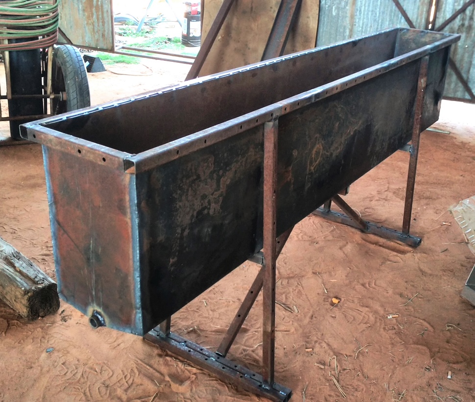

The brass valve may be a problem might have to replace with one made of stainless
Attachment 45265

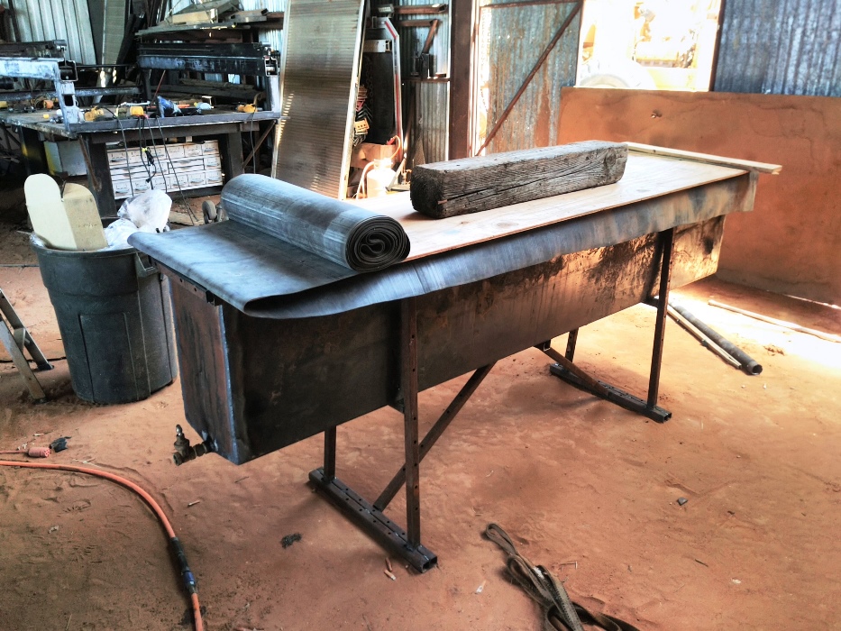

the acid arrived and the parts are in the vat I covered the vat with a makeshift top using a roll of rubber and a piece of plywood this is to contain any fumes and slow evaporation.
Attachment 45334
It always seems that no matter the situation I most always have something in my storage bins to cover what needs to be done. in this case the roll of 3/32" thick rubber that I have had for at least 25 years
