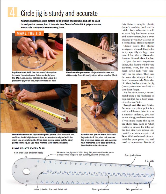

See the attached images. I hope this helps. It's much easier than it may look.
