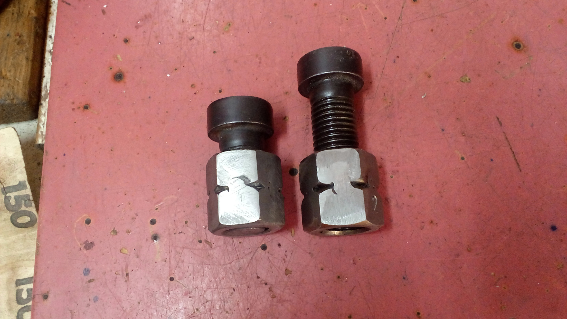

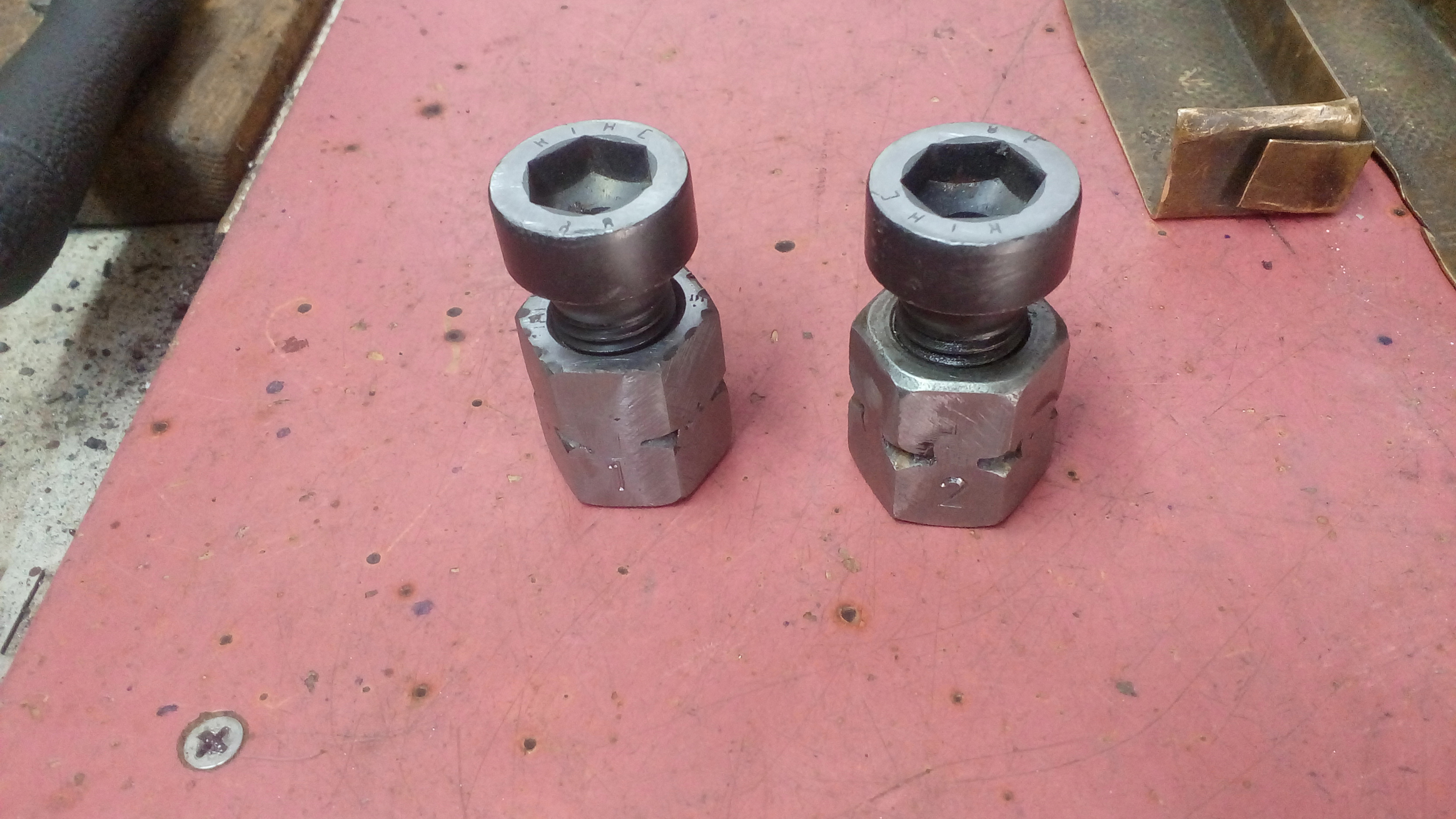

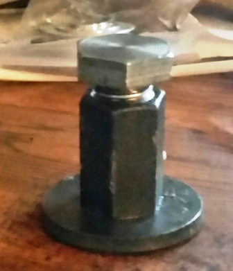

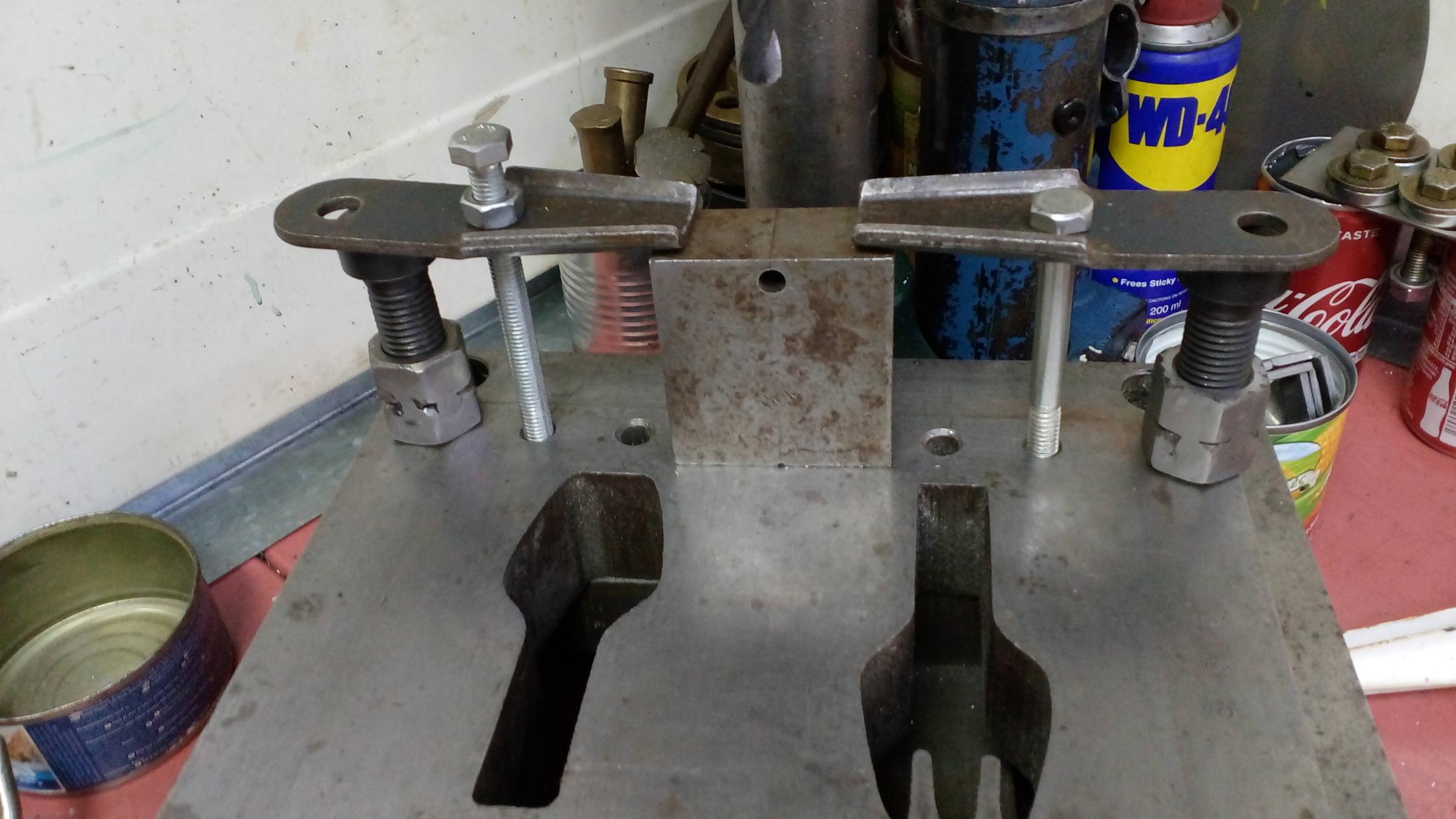

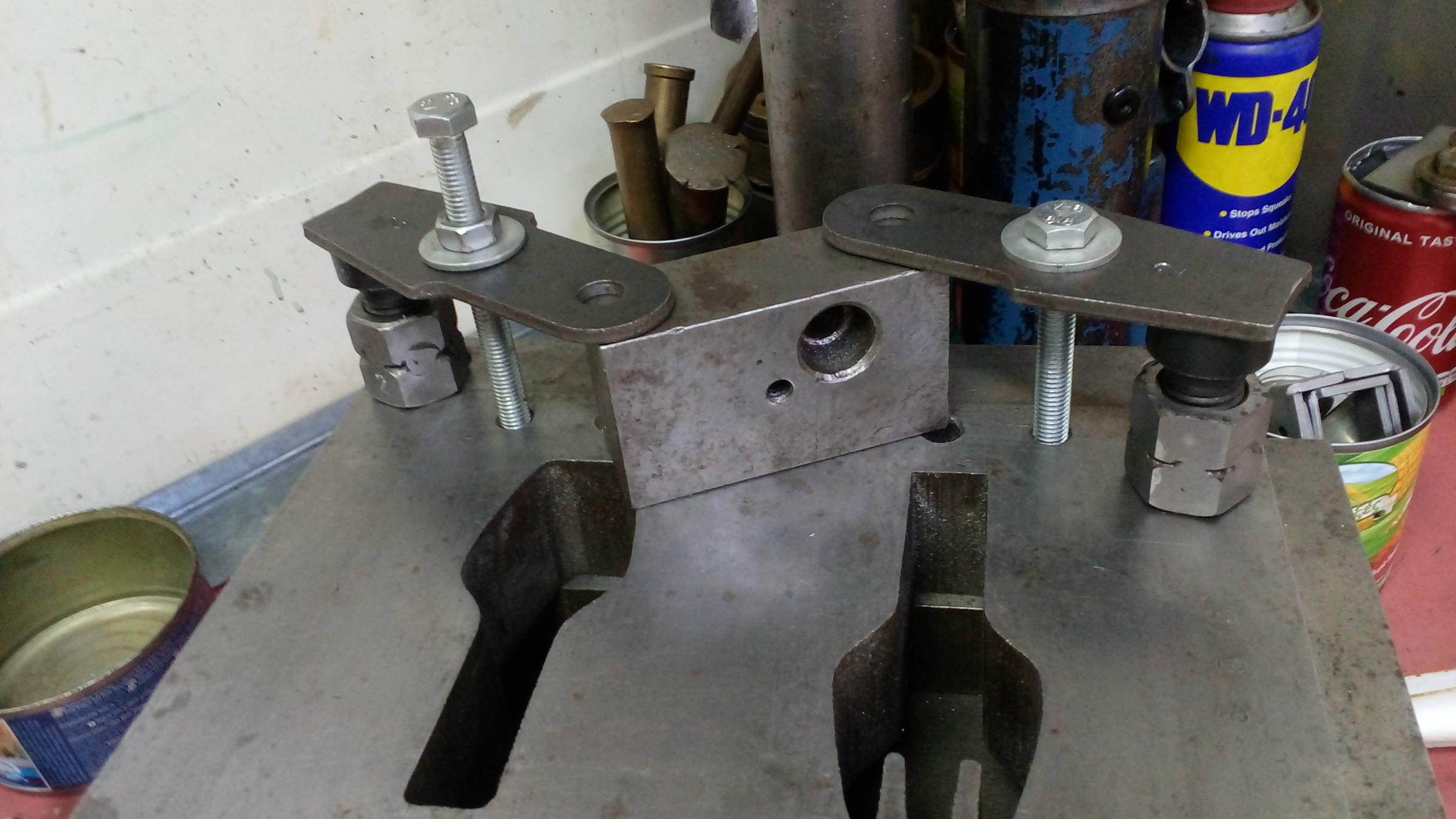

Adjustable Clamping Spacers
https://youtu.be/6uugW-zornk
Materials:

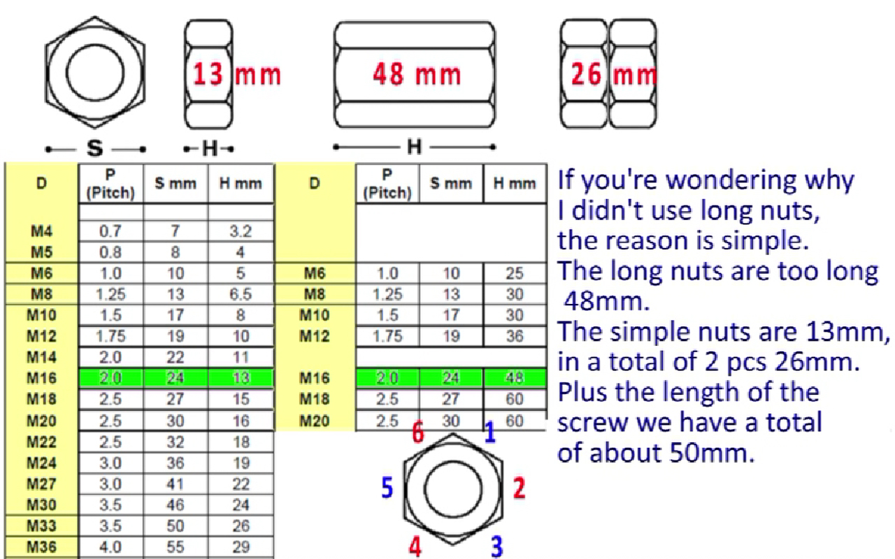

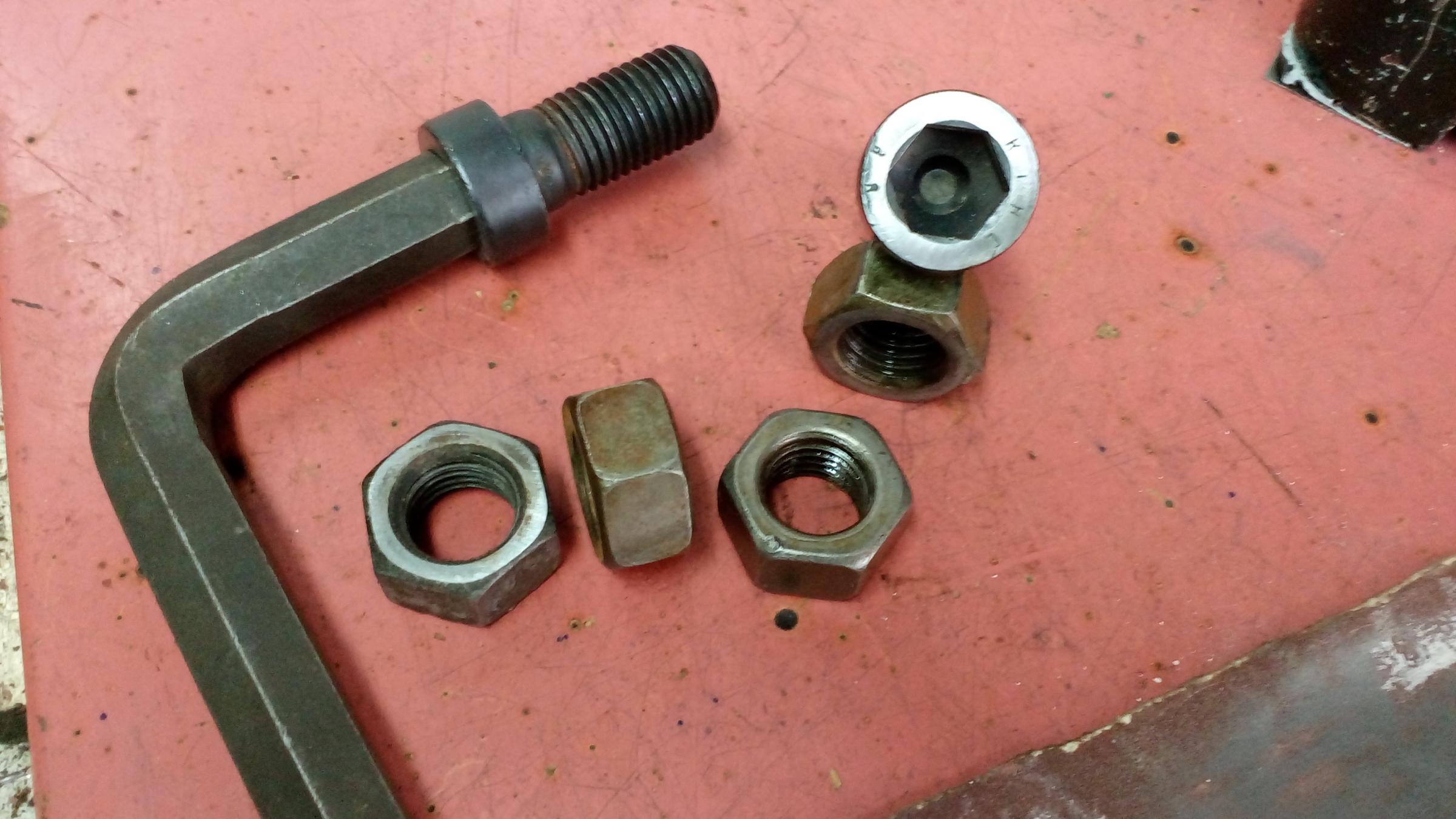

2 Bolts Low profile Allen socket head M16x35mm and 4 nuts M16.

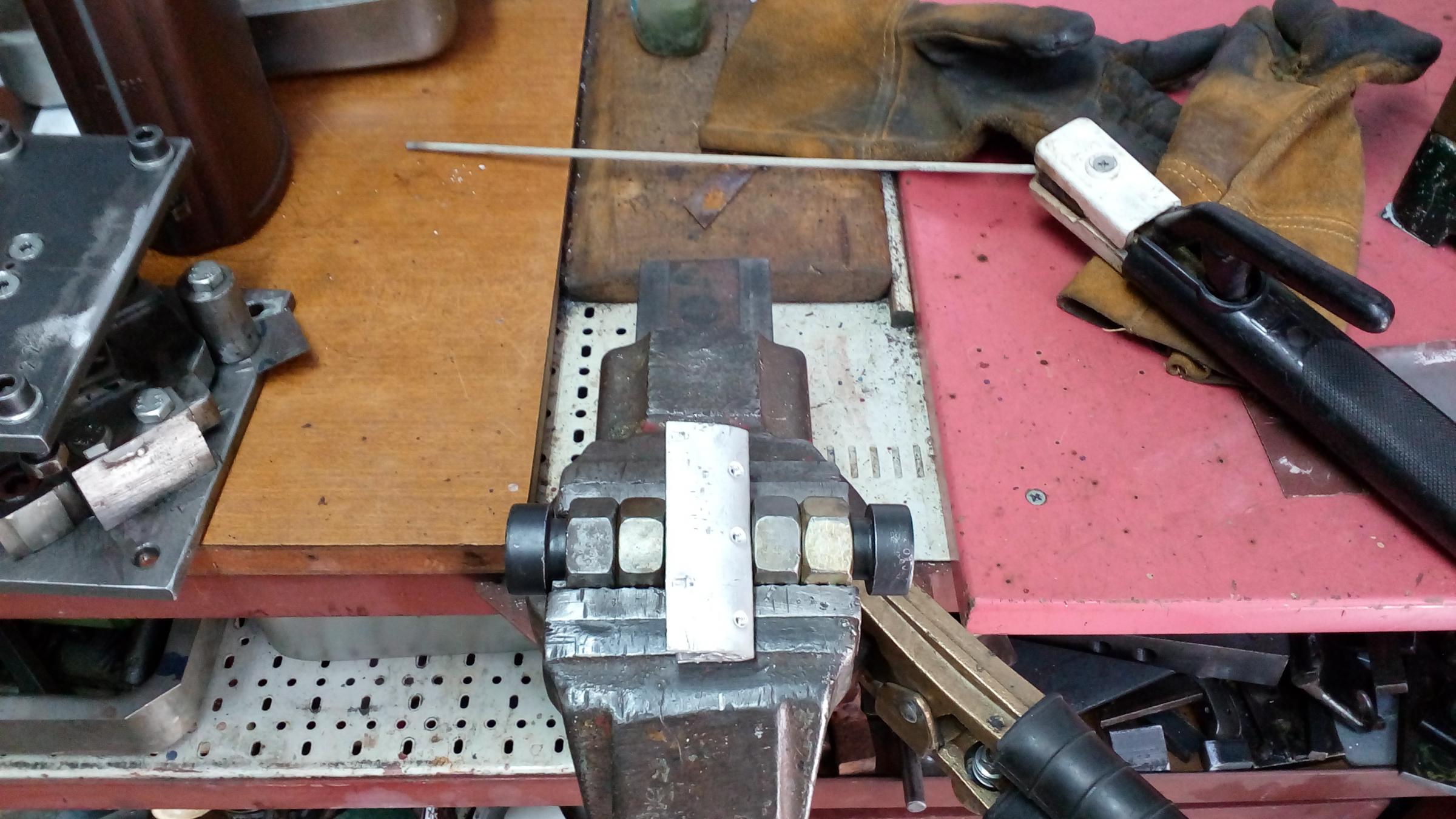

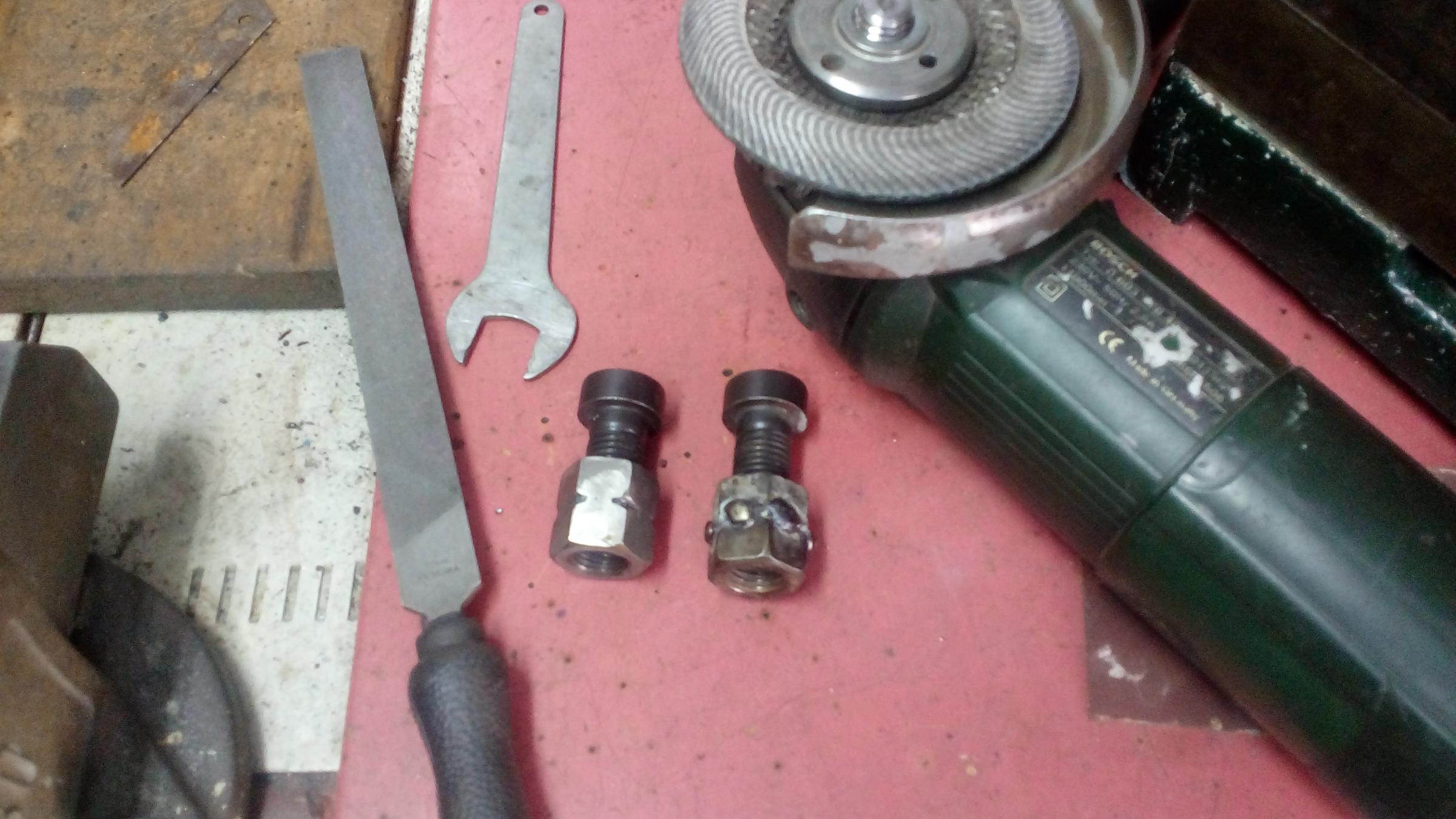

Tools:
Vice, welding machine, angle grinder, file.

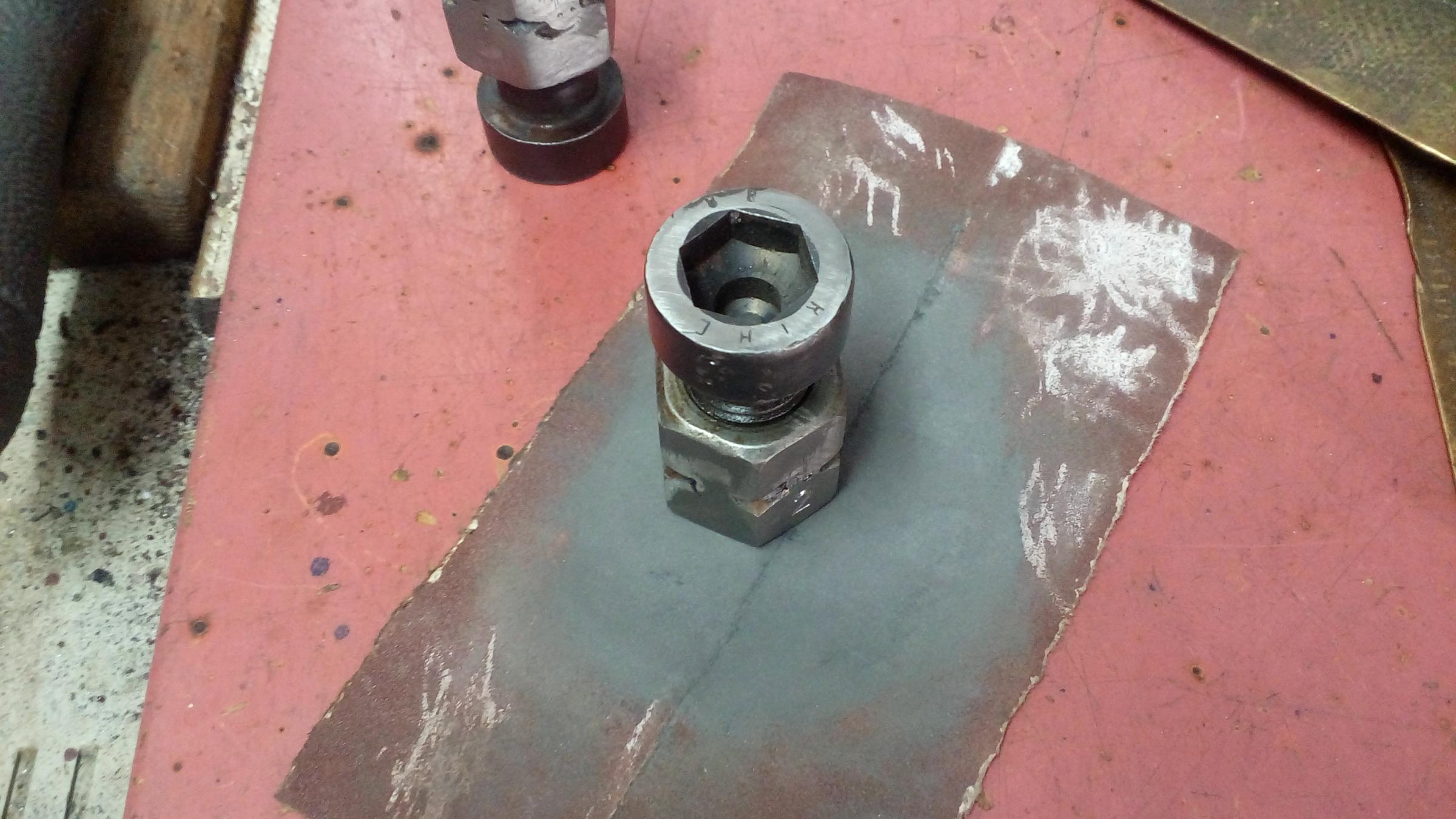

Place/adjust two pairs of nuts at the vice so as the bolts can screw/unscrew correct and freely.
Tack welds the sides of nuts using the combination:
single sides 1-3-5 at first and then the even sides 2-4-6.
Attachment 35686 Attachment 35685
