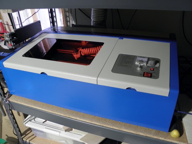

First a little background. K40 lasers are cheap CO2 laser cutter/engravers that are available on e-bay, amazon and a few other sources for around $500. They are functional but lack many features. Below is a picture of my K40 to give a point of reference as to what this platform is installed inside of.
Attachment 16761

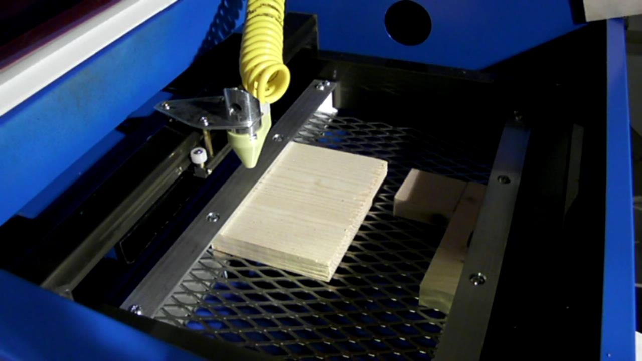

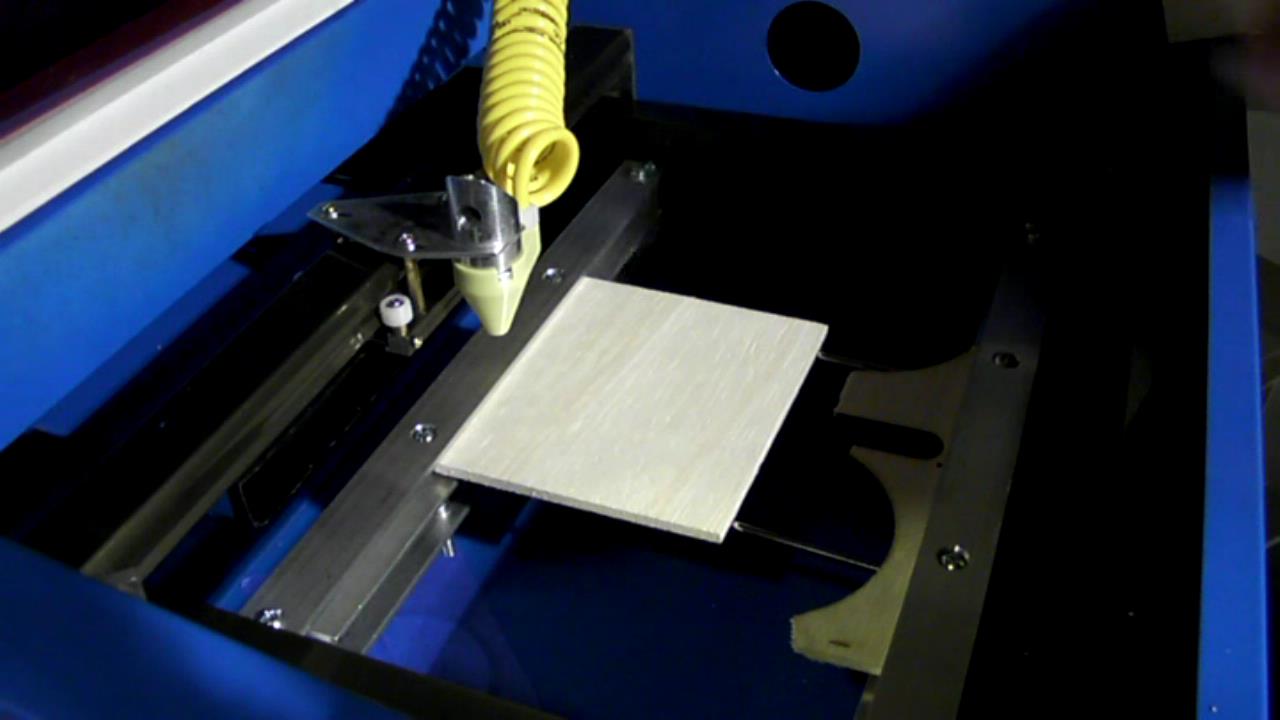

The purpose of the platform is to allow for the use of different thicknesses of material while maintaining the correct distance to the surface of the material so the laser is always focused at the material surface. I achieve this by having springs push the platform up to a hard stop formed by a piece of angle aluminum. When an item is placed on the platform a small portion of the material is pushed under the hard stop surface. Then the springs push the material up until the top surface of the material is positioned at the laser focus height by the hard stop.
Here is a picture of the adjustable bed used with expanded metal mesh

Here is a picture of the adjustable bed used with two rods to minimize the support area.
Attachment 16760

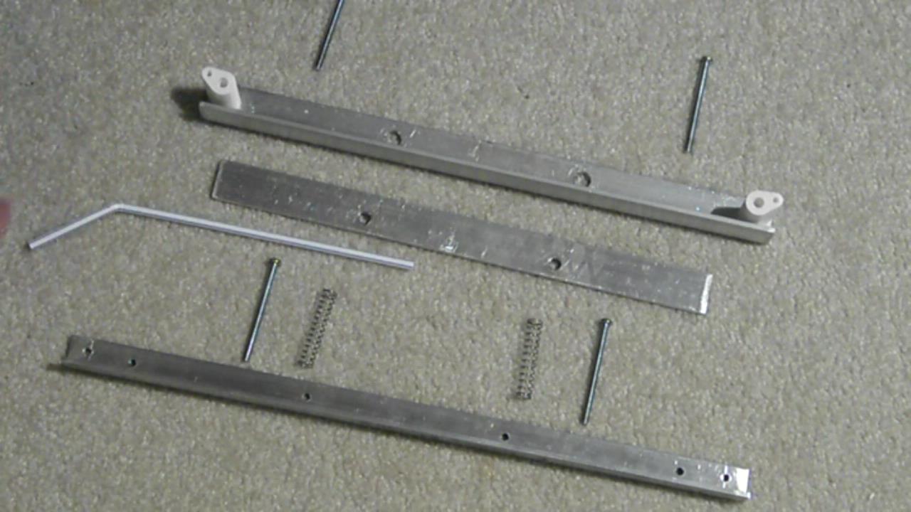

This is a picture of the parts from one side of the bed support.
Attachment 16758
