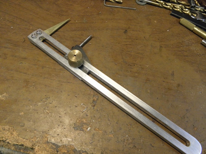

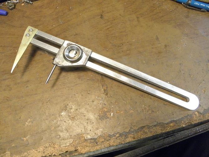

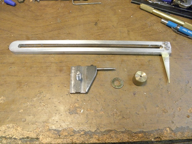

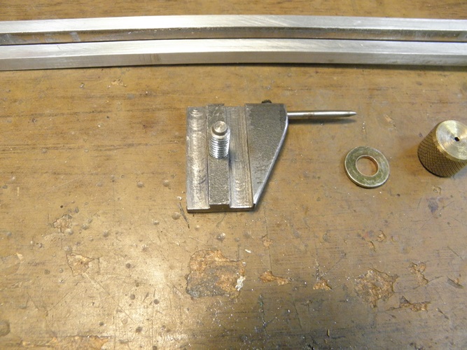

Adjustable Metal Caliper Marker. Made from cold rolled steel/aluminum/brass. This scribe is better than regular calipers because the outer stop is longer and will go past rounded edges keeping an accrete measurement between centers.
