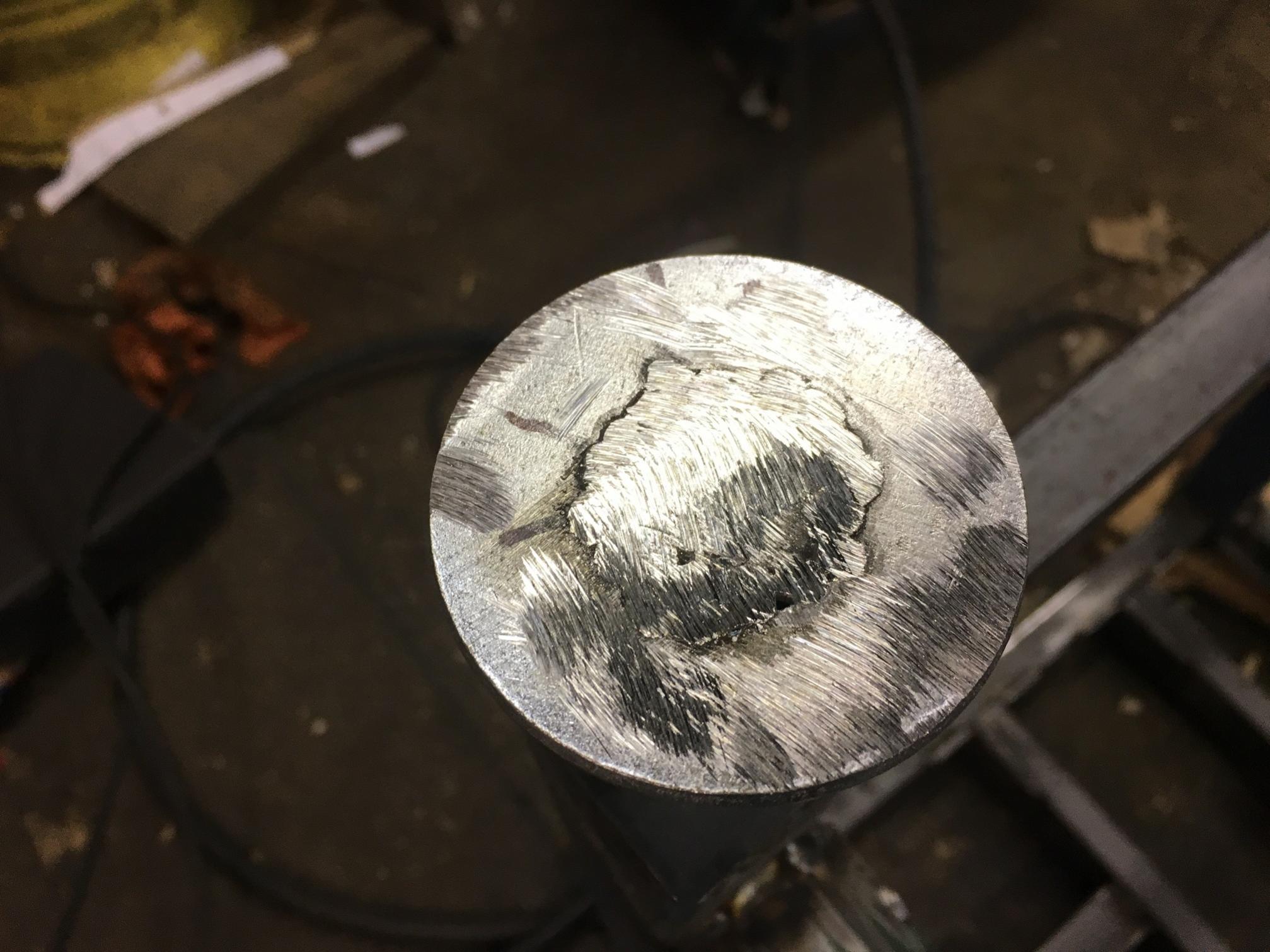

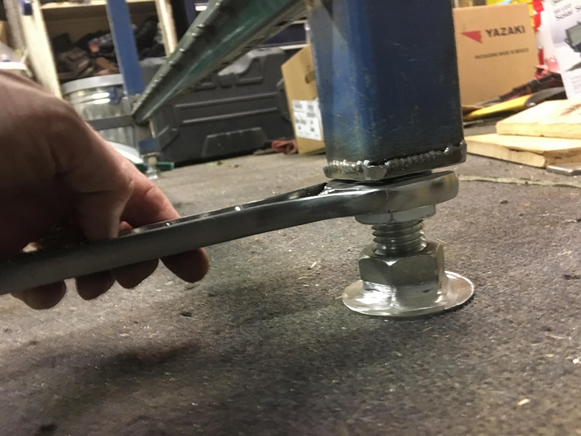

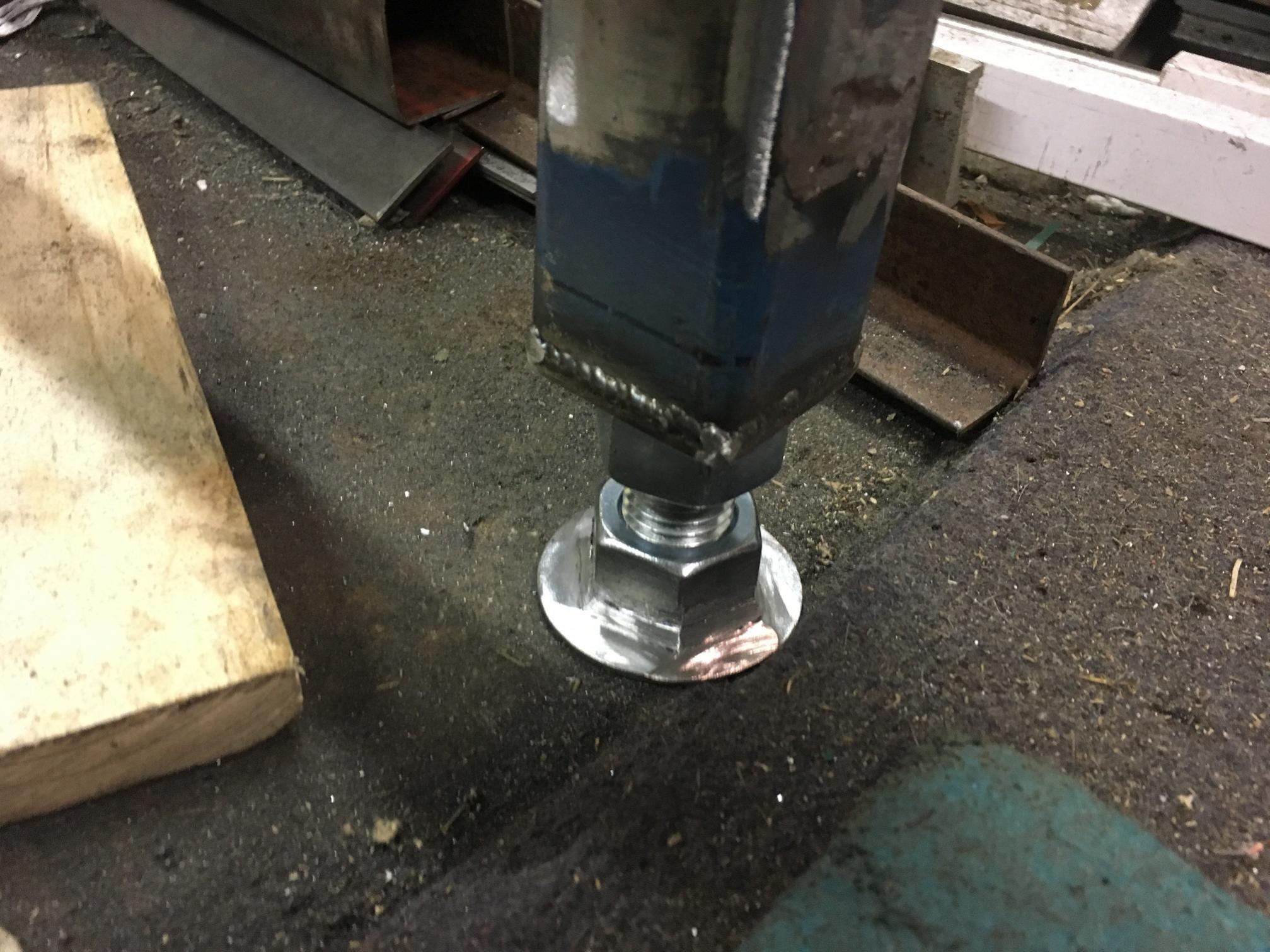

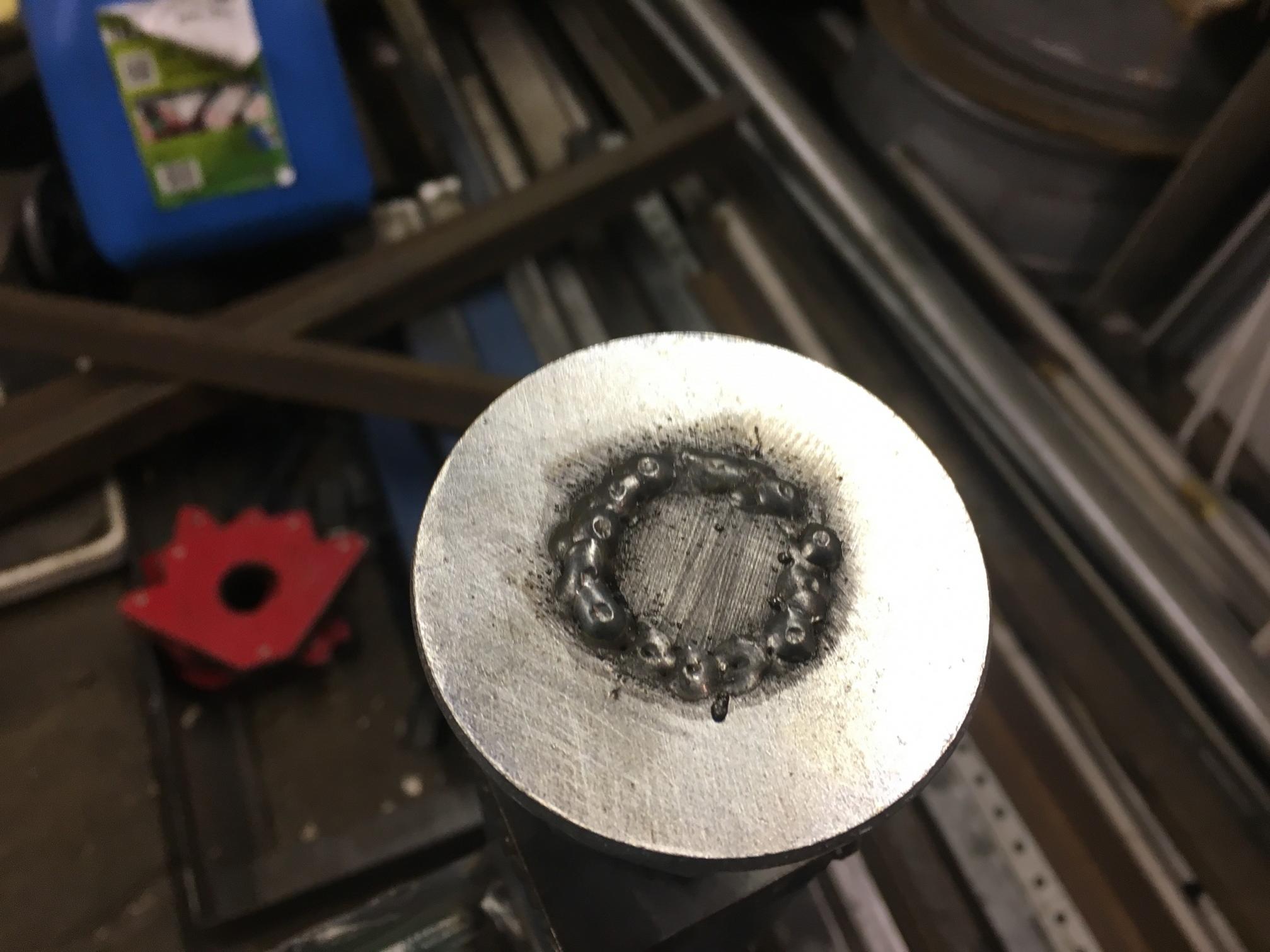

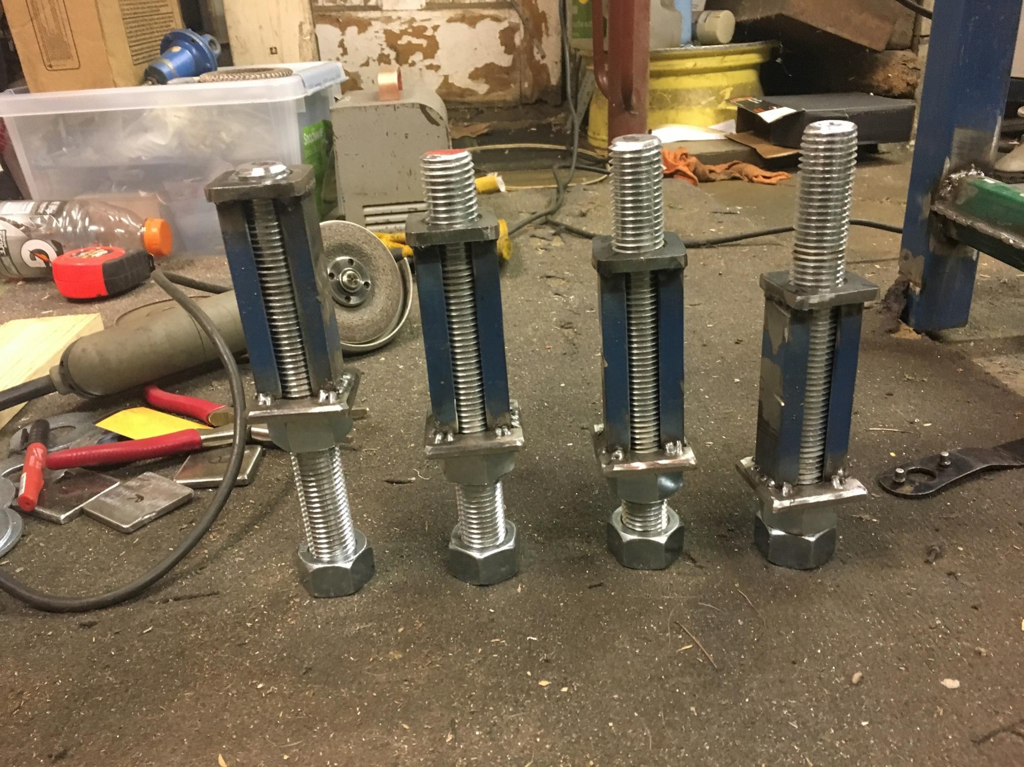

These are for the lathe table I'm building. 1" threaded rod, nuts and washers; 1/4" plate and C-channel.
Attachment 16505

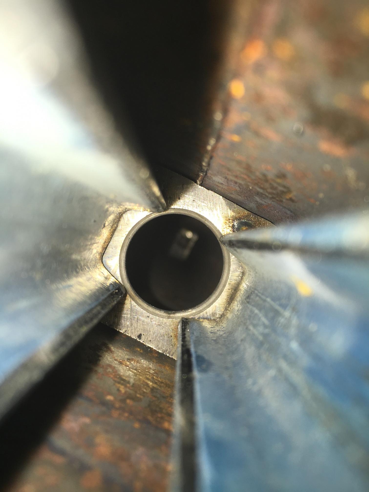

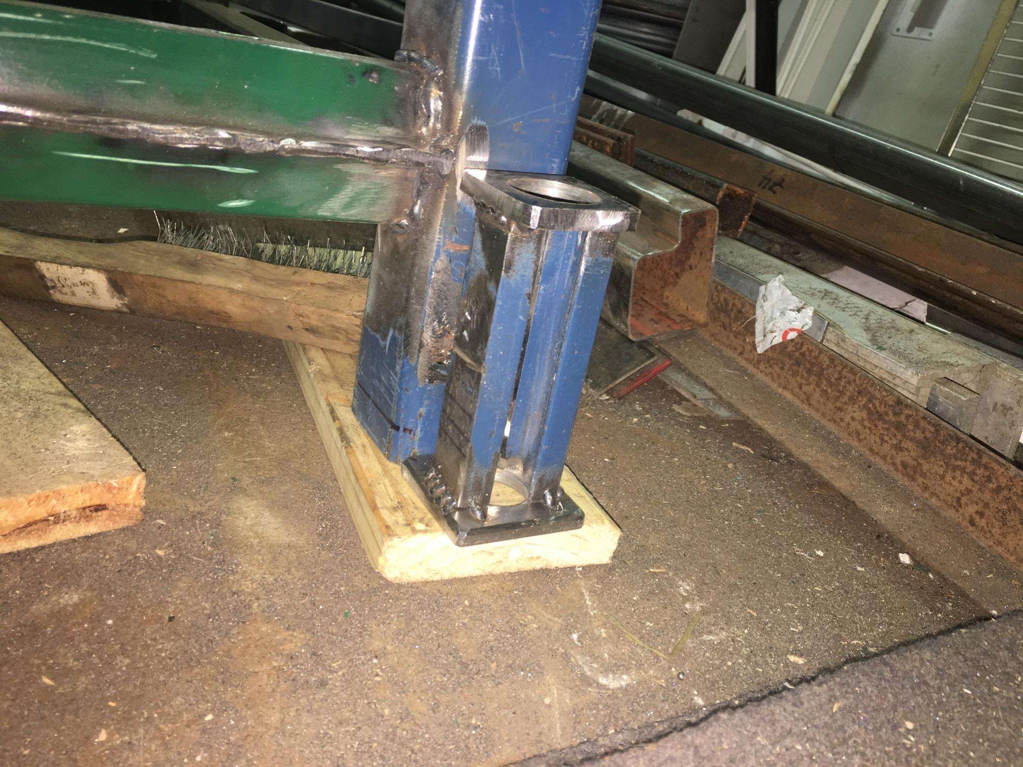

The C-channel acts as a guide for the bolt.
Attachment 16501 Attachment 16502 Attachment 16503 Attachment 16504 Attachment 16506
Attachment 16500
There'll be rubber pads on the bottoms of the feet.
