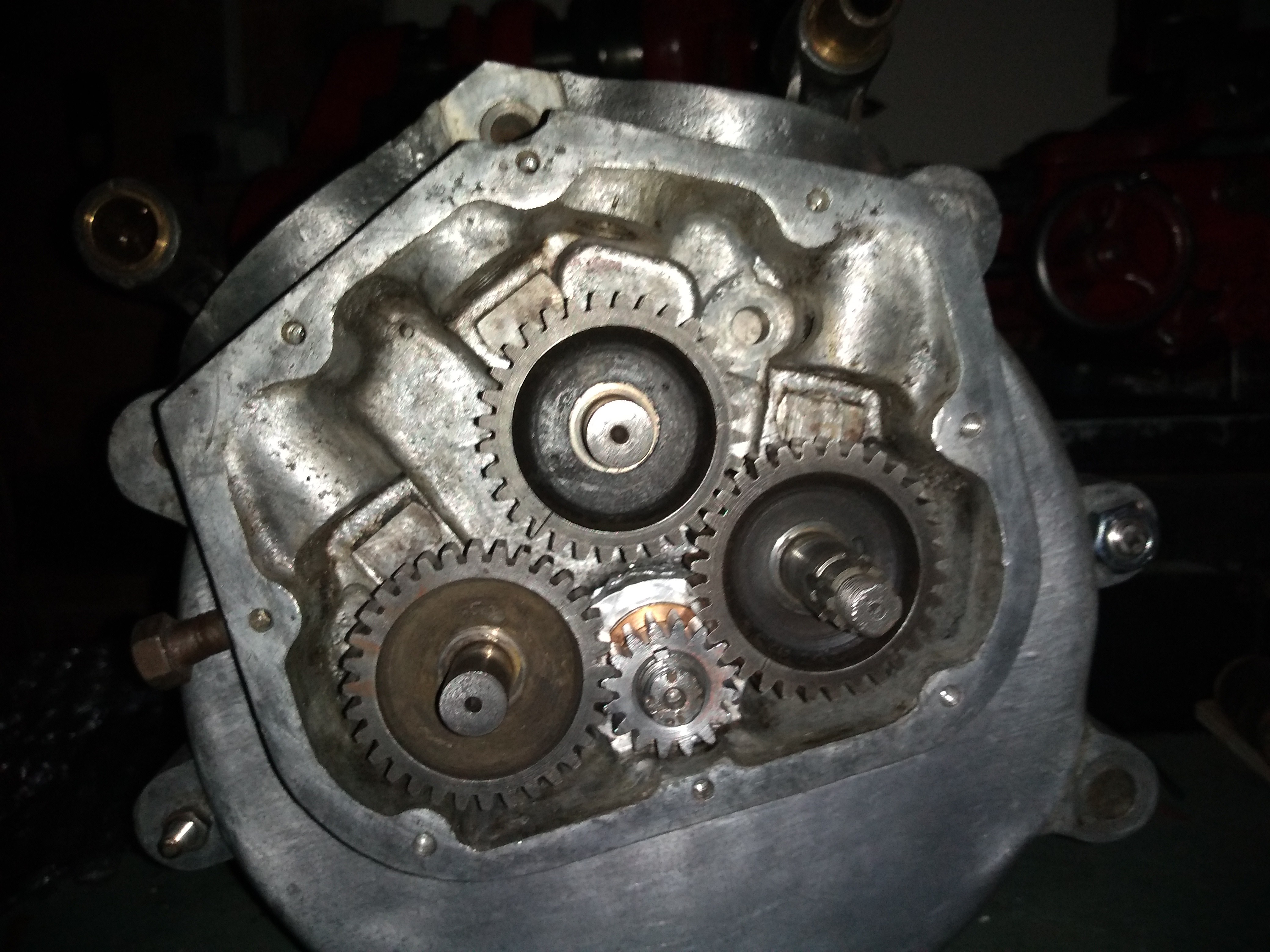

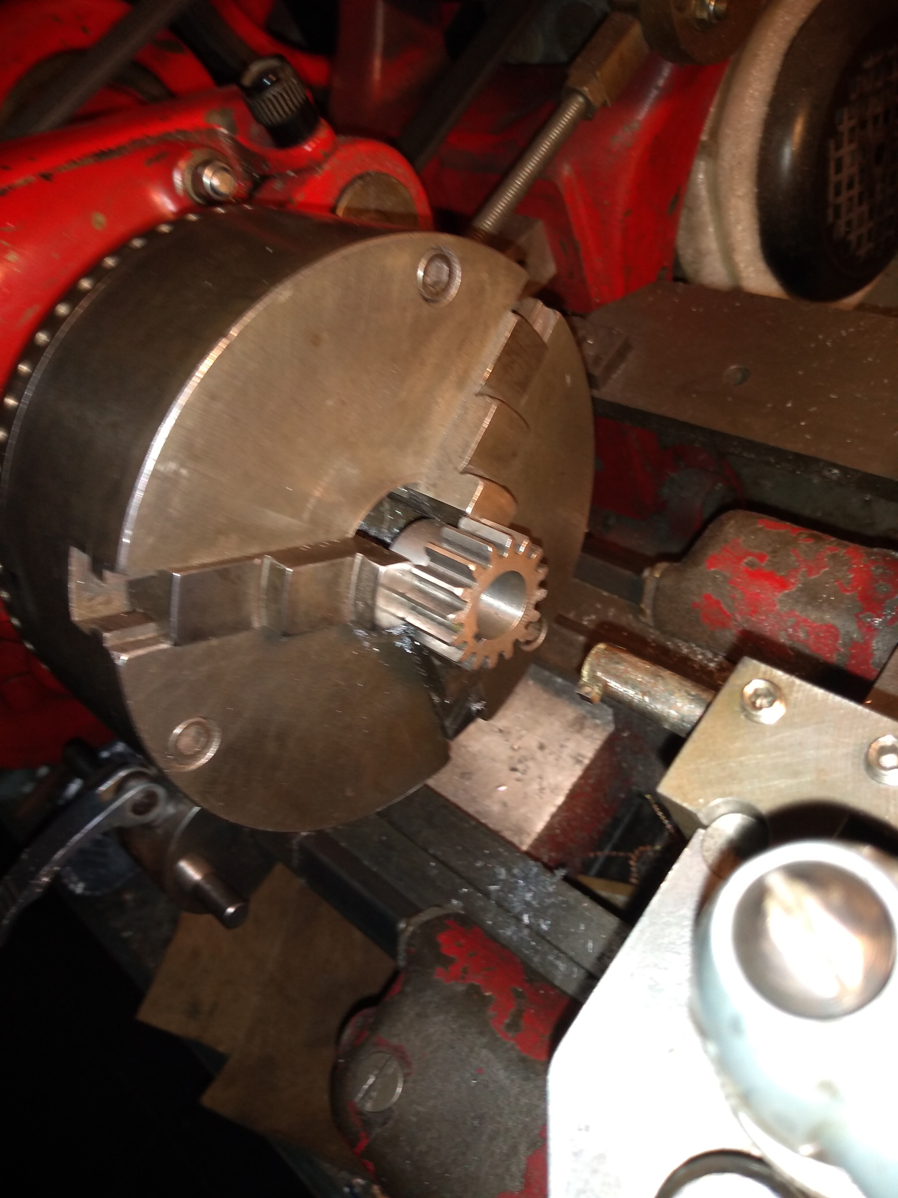

Hit a major problem with the timing gears in that the crank gear was found to have cracked from the keyway to the root. I had no option but to cut another gear 16T 20 DP from some tough mystery metal that will be case hardened. The keyway was cut using the top slide as a ram which does give it a good work out.
Attachment 42425
Attachment 42426

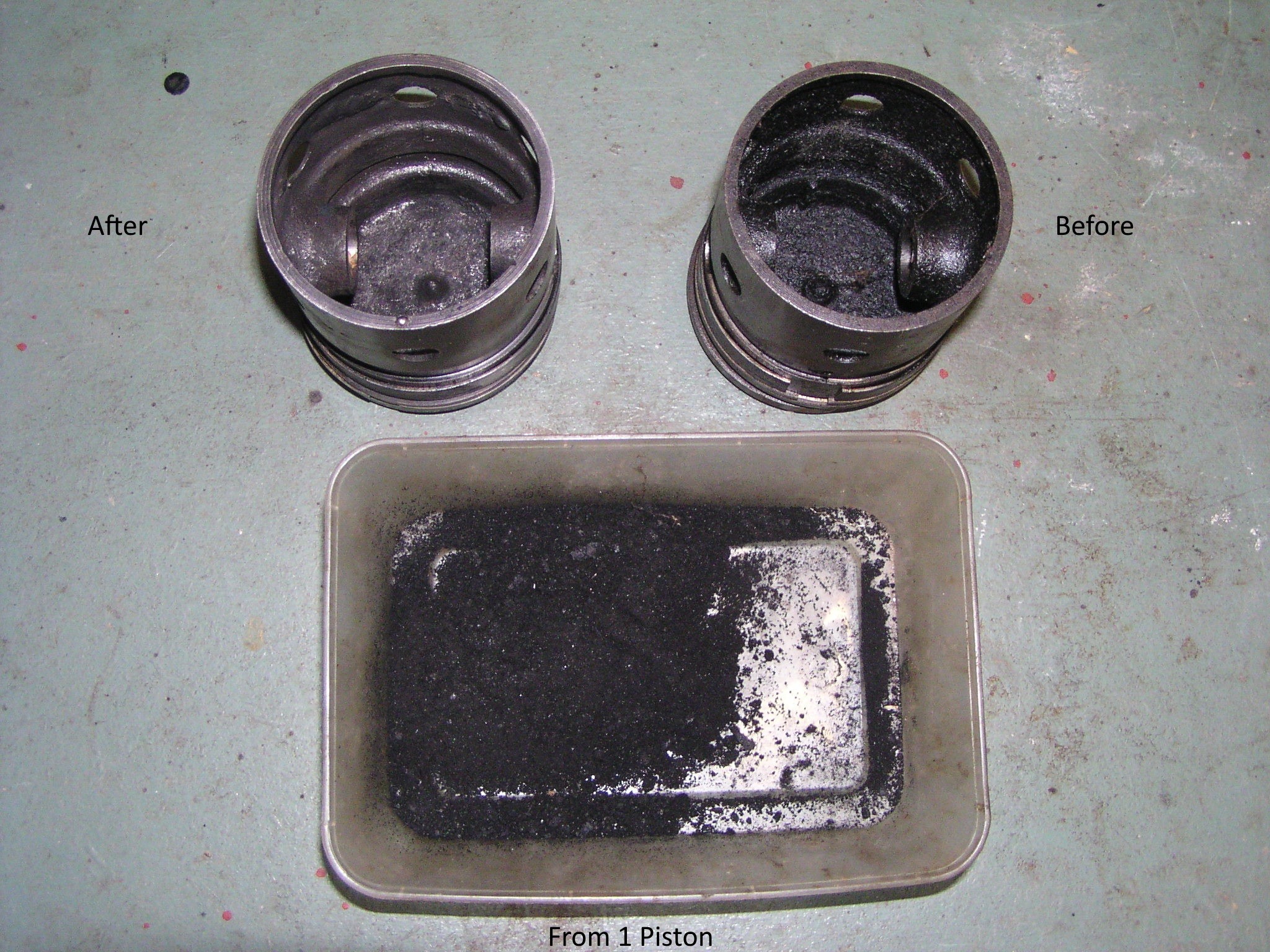

The heads/ valves and barrels are ready so looking forward to some progress soon. The pistons are in good condition reamed for new gudgeon pins, apart from very coked up.
Attachment 42427
