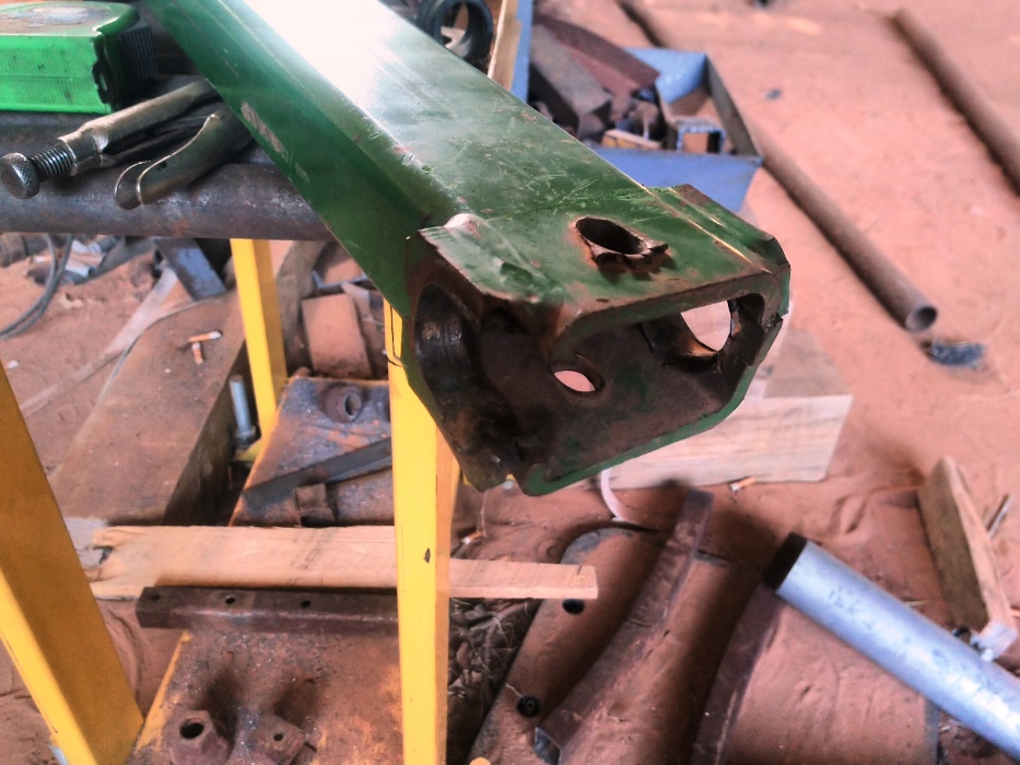

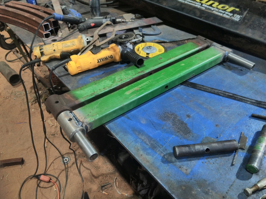

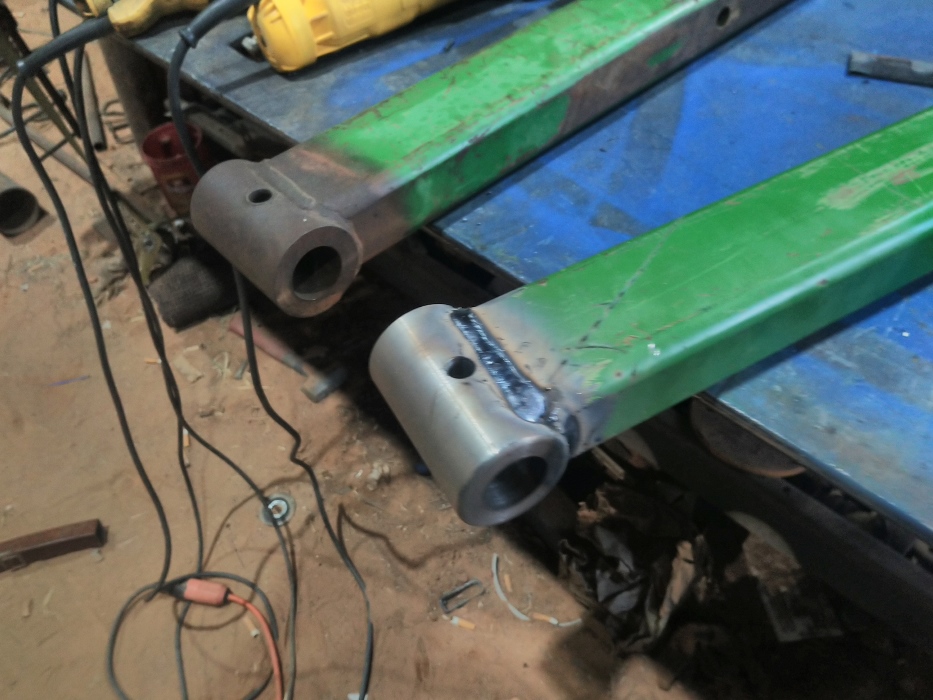

One of the local Cotton farmers dropped of a a pair of link bars for his disk plow. One of them had been repaired years ago but the other one was in very bad shape I needed to make new ends for it and had to make something to be sure they had true parallel alignment.

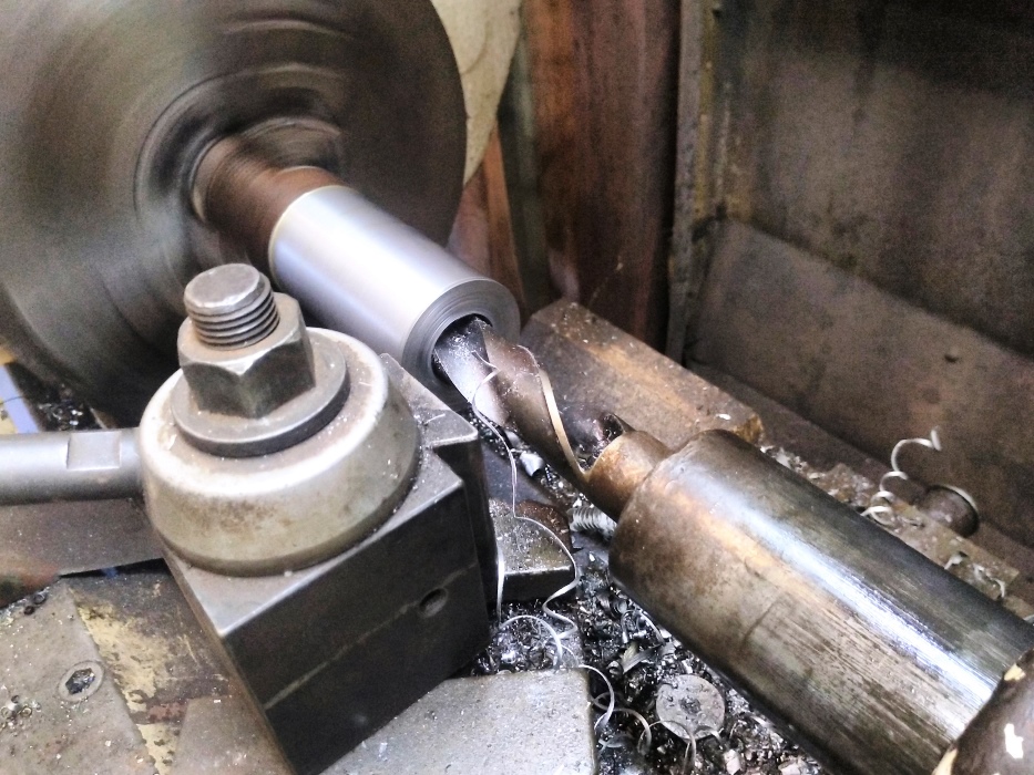

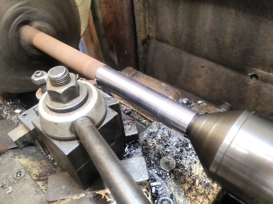

I made the new ends out of a piece of 2" round bar drilled then bored to proper ID. For something to use as alignment pins I just turned a length on 1" pipe to fit the ID of the new ends
