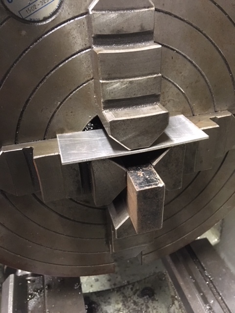

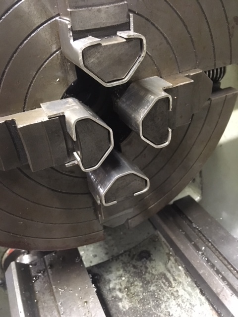

I made some soft jaws today out of some aluminium sheet. The photos below show the method I used. What I hate about setting a four-jaw chuck is the damage the hard jaws can do to the component. Also when using packing between the job and jaws this tends to fall out when adjusting the job to run concentric.
These soft jaws only took ten minutes to make (please no comments like “it looks like it” lol) It took me longer to find the material than to make them and to write this post.
As you can see these are retained around the jaws so no more frustrating time looking for packing in the bottom of the swarf tray.

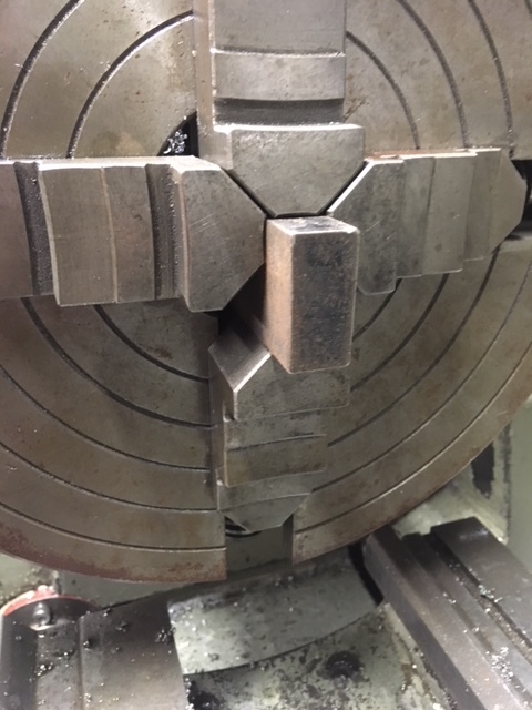

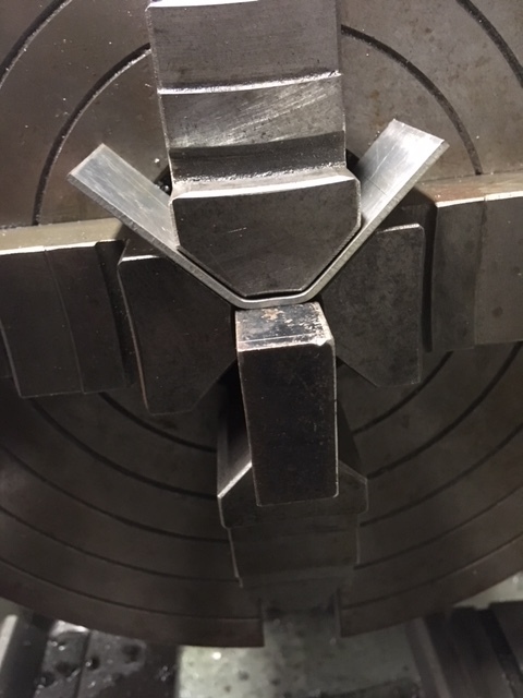

Setting the four-jaw chuck up to use as a press tool the piece of stock is there purely to flatten the bottom of the soft jaw
Attachment 21832

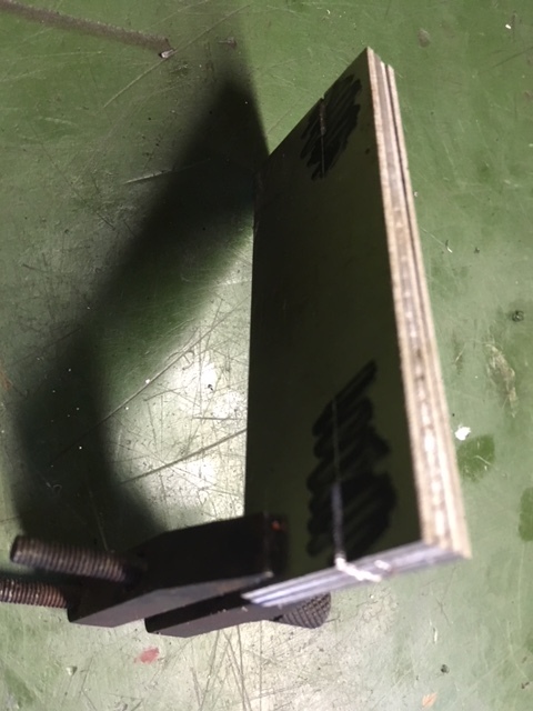

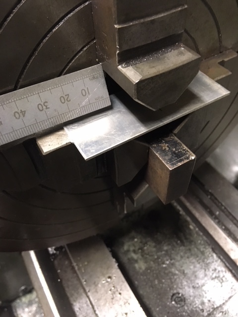

Gang cutting all four pieces of aluminium, the slit will form the locking tabs
Attachment 21836
Setting the aluminium central to the jaw to ensure they bend evenly
Attachment 21833
Pressing the sheet with the chuck jaw down tightly on to the stock
Attachment 21834
Attachment 21835

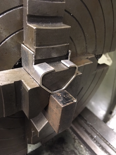

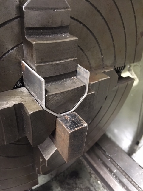

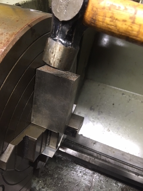

Knocking the sheet to fit tightly to the Jaws.
Attachment 21837
Bending the locking tabs down
Attachment 21838
Attachment 21839

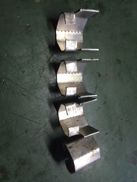

Finished soft jaws.
Attachment 21840Attachment 21841
Hope this will make your life easier when you don’t want horrible jaw marks all over your work piece
