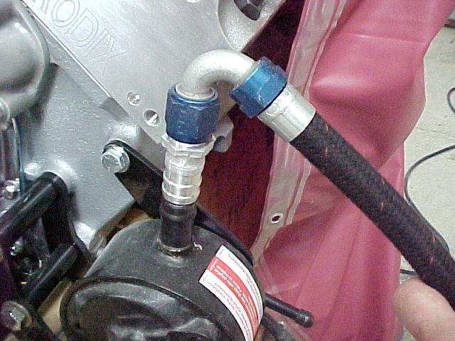

I needed a fitting for the '86 Chevy Power Steering return hose from the reservoir. The pump has a 3/4" tube nipple and I couldn't find a fitting to go from that to -10 37 degree flare. So I made one.
Here is the pump with a long piece of 3/4id hose stuck on it.

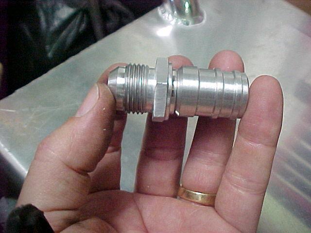

Inside this chunk of 1" diameter aluminum is a 3/4" OD "hose barb". You can't see it, but it's in there... :)
http://images14.fotki.com/v219/photo...MVC002F-vi.jpg
I bought a couple of -10 weld bungs from Speedway. The bung will get welded to the barb after it's turned on the lathe.
http://images16.fotki.com/v368/photo...MVC003F-vi.jpg
