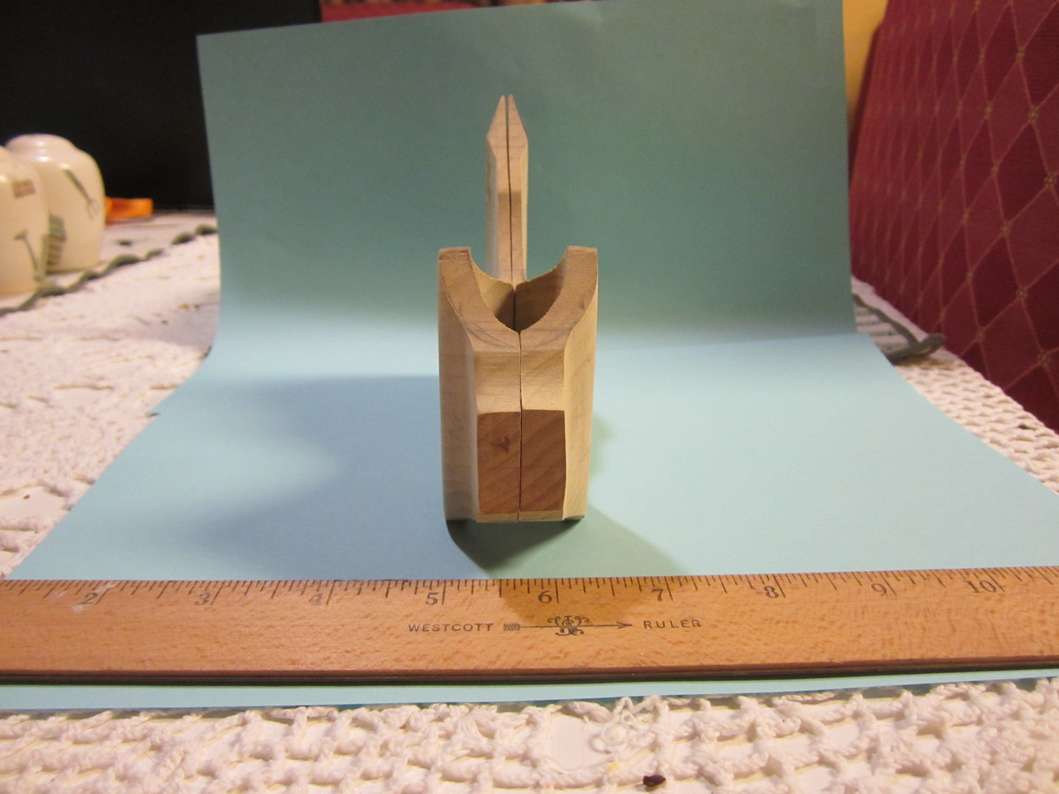

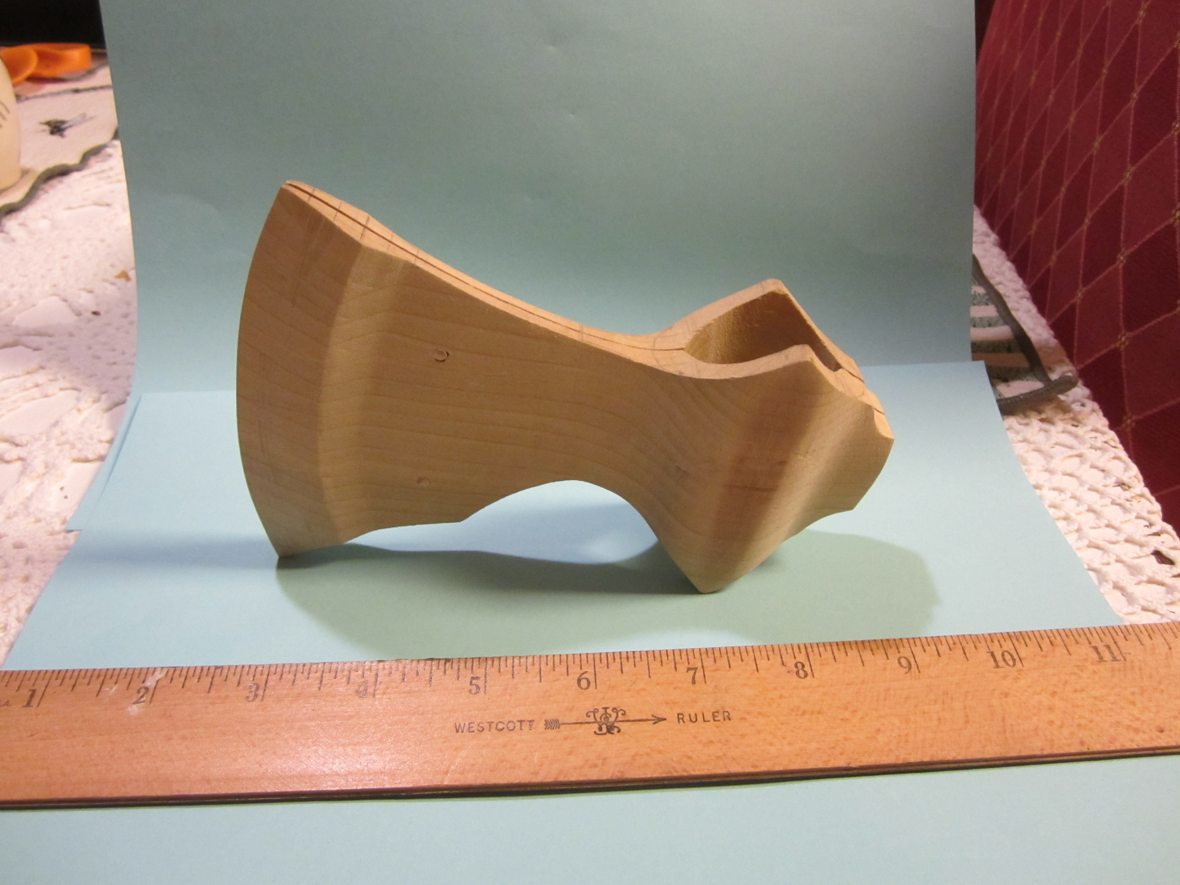

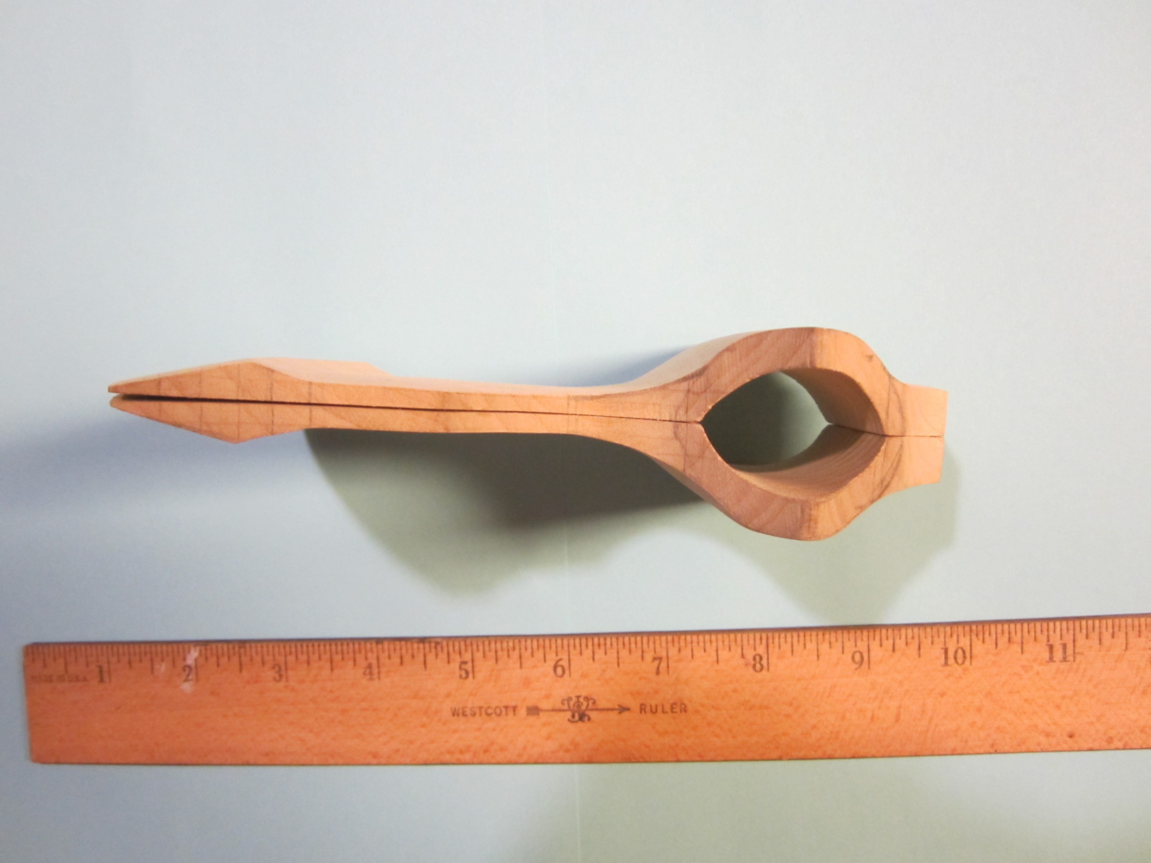

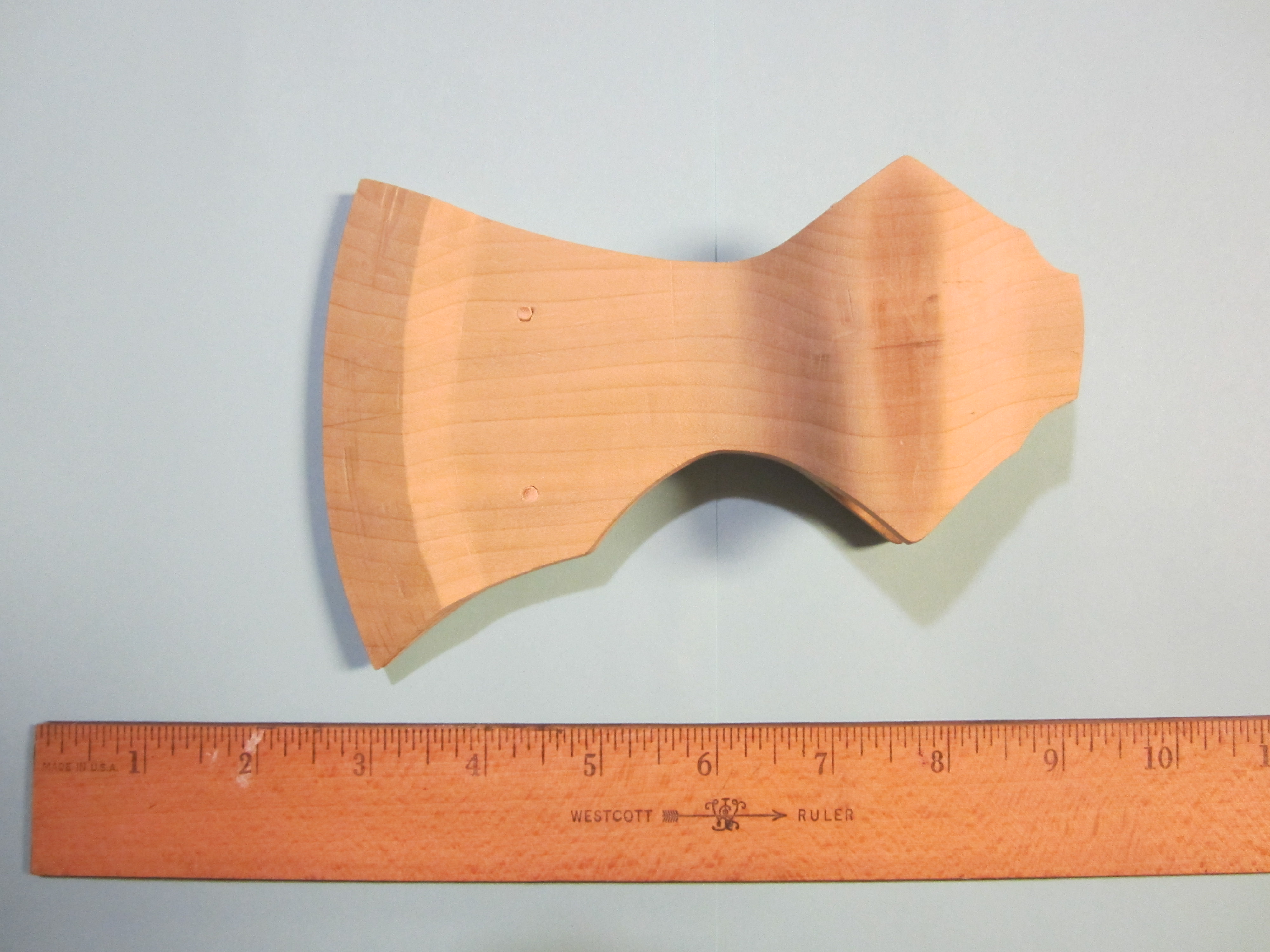

Pattern side view. Blade is about 4 1/4". Axe head is about 6 1/2" long. The wood used was a poplar 1x6 from the big box hardware store. This started out 1 1/2" thick, but most of it was chiseled and filed away. Attachment 26502
Back view of axe head pattern showing poll. Attachment 26503
Side view of pattern. Attachment 26504
Bottom view of pattern. Attachment 26505

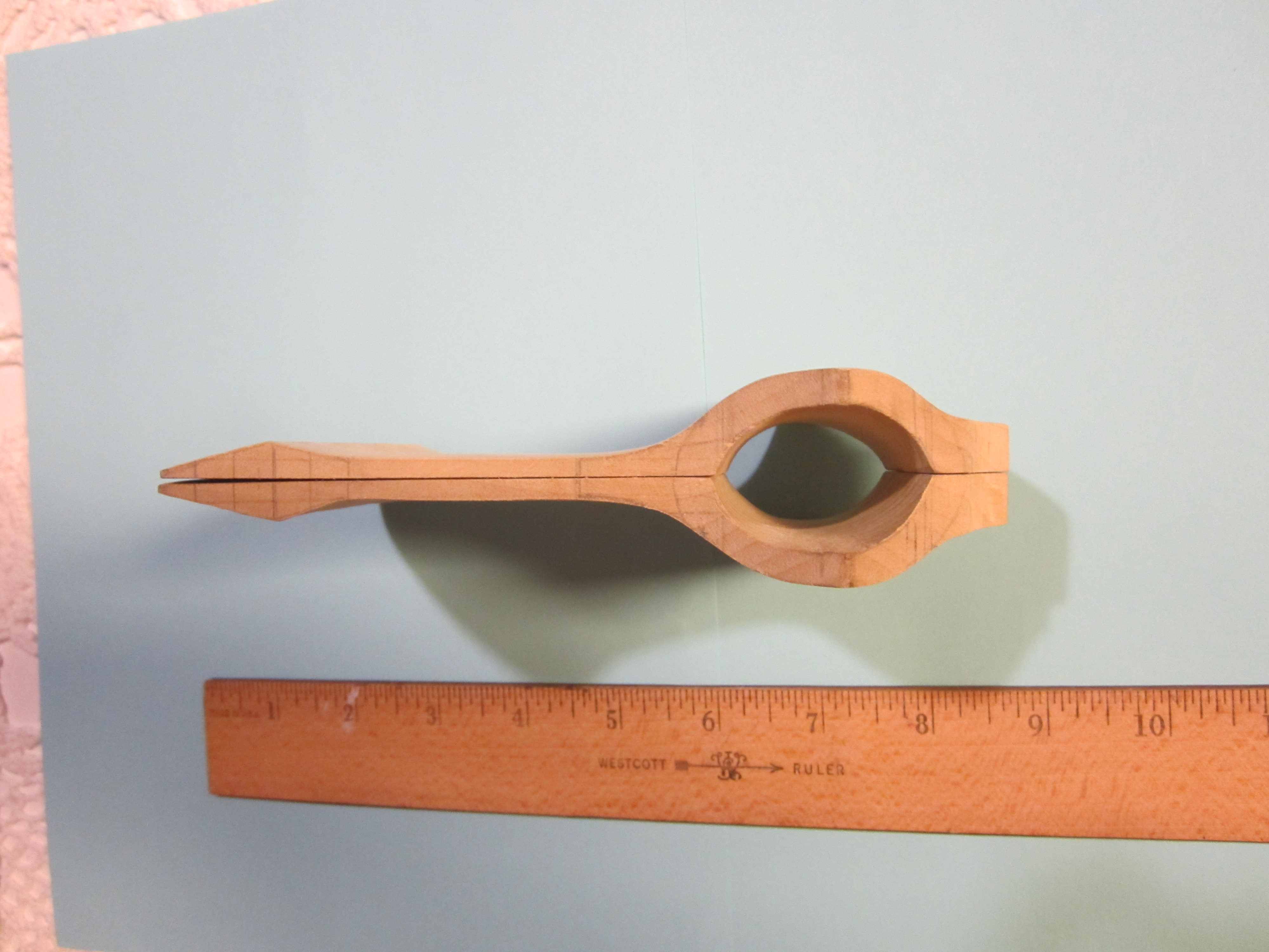

Top view of pattern. After removing so much wood, the remaining wood de-stressed some along the blade, resulting in the gap that you see, but only on the edges, not in the center. It was worse, but I put clamps on it and got it to move as much as I could back to a flat position. Attachment 26506

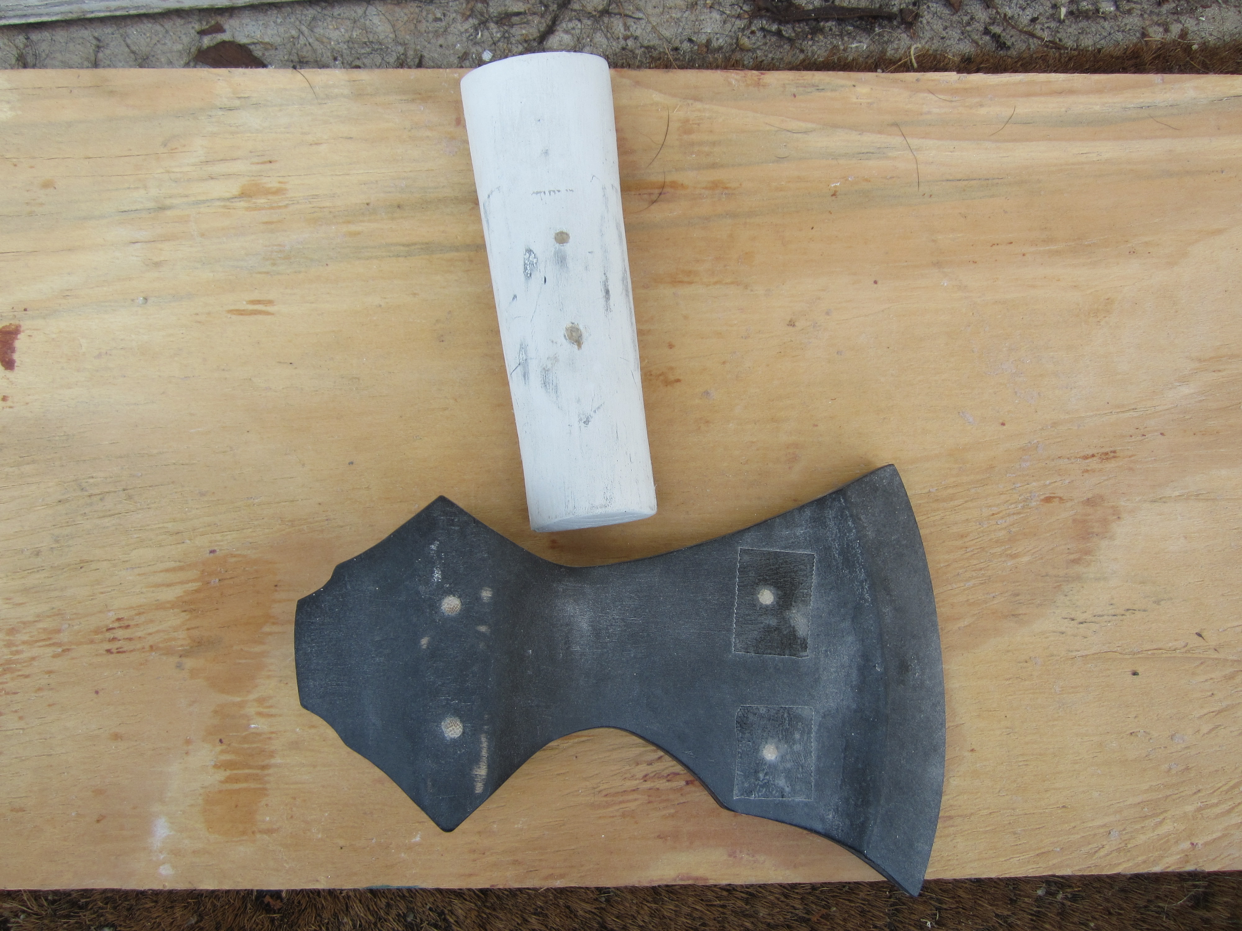

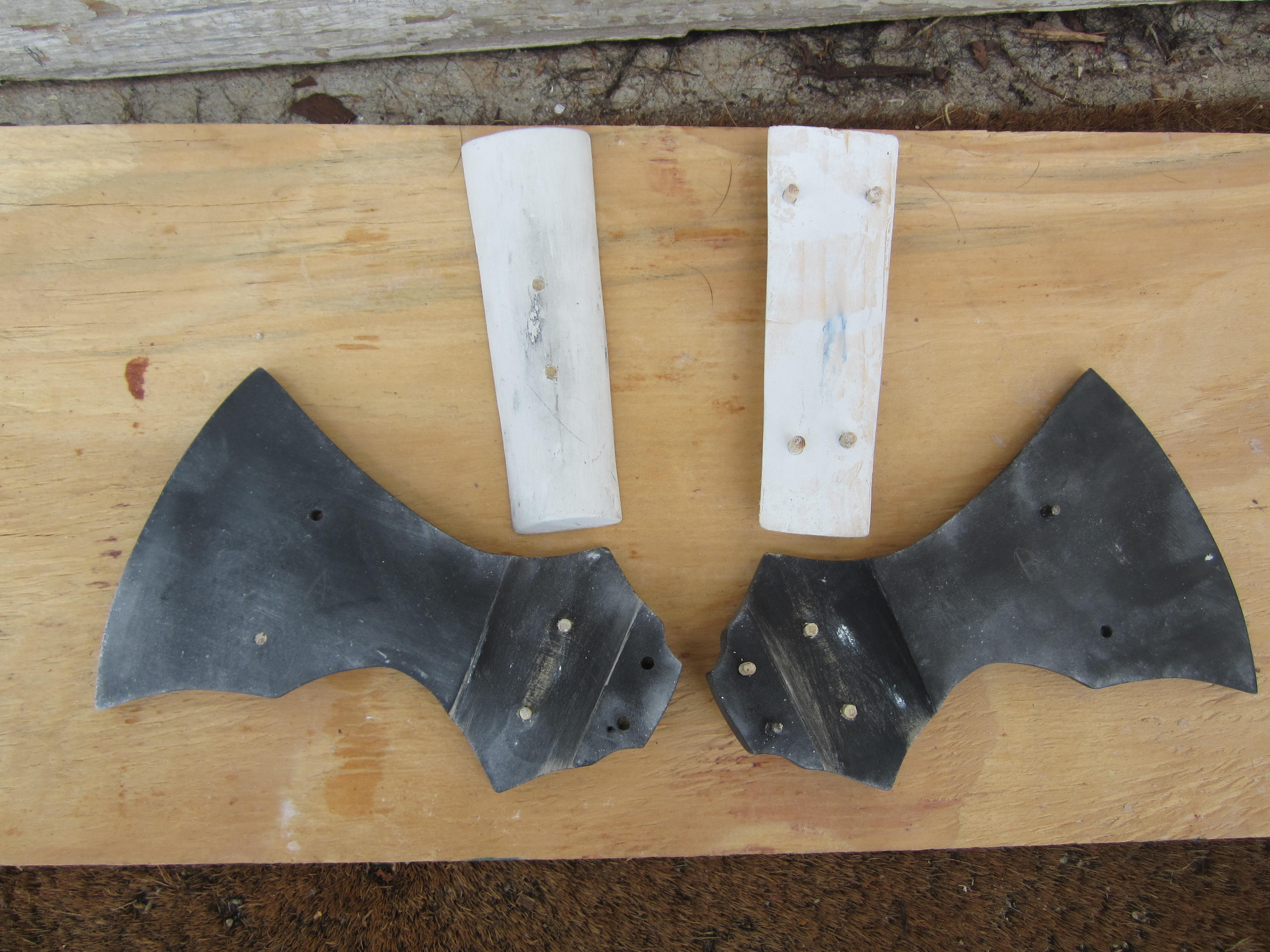

Painted axe head and handle dummy. The handle dummy was used to cast the core by making a mold out of plaster of Paris, and then filling that with sand mixed with stove gasket cement, which I learned from watching Tobho Mott's YouTube video on how to make cores -- https://www.youtube.com/watch?v=TeXkFgIfZzQ The core worked very well. Attachment 26507
Inside of the axe pattern with dummy handle pattern. The handle pattern on the left is face up to show the holes that index on the pegs in the axe head eye. The handle pattern on the right is showing the inside surface to show how the handle pattern is fitted together with pegs inside. Attachment 26508

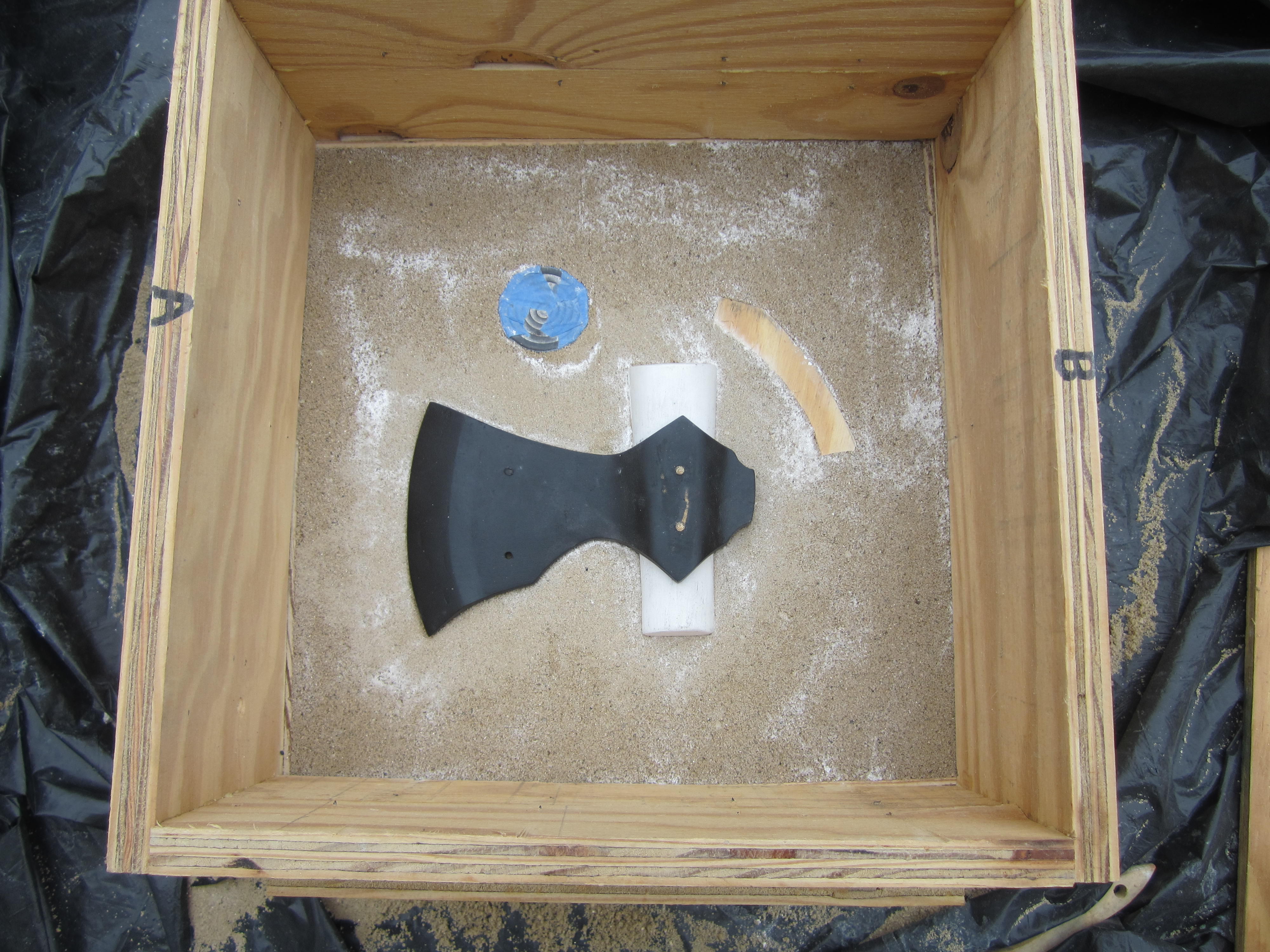

Drag rammed up. The pegs have been removed from the handle pattern that will fit down on this part, as the handle patterns index on the axe head, and don't need to be held together once they are fitted to the axe head. The axe head still has the pegs in it (the other half does, not this one), and it will index onto this part of the pattern, thus everything will be aligned for ramming up the mold. (file too big for this board -- link is here: https://i.imgur.com/L2PPnmu.jpg )

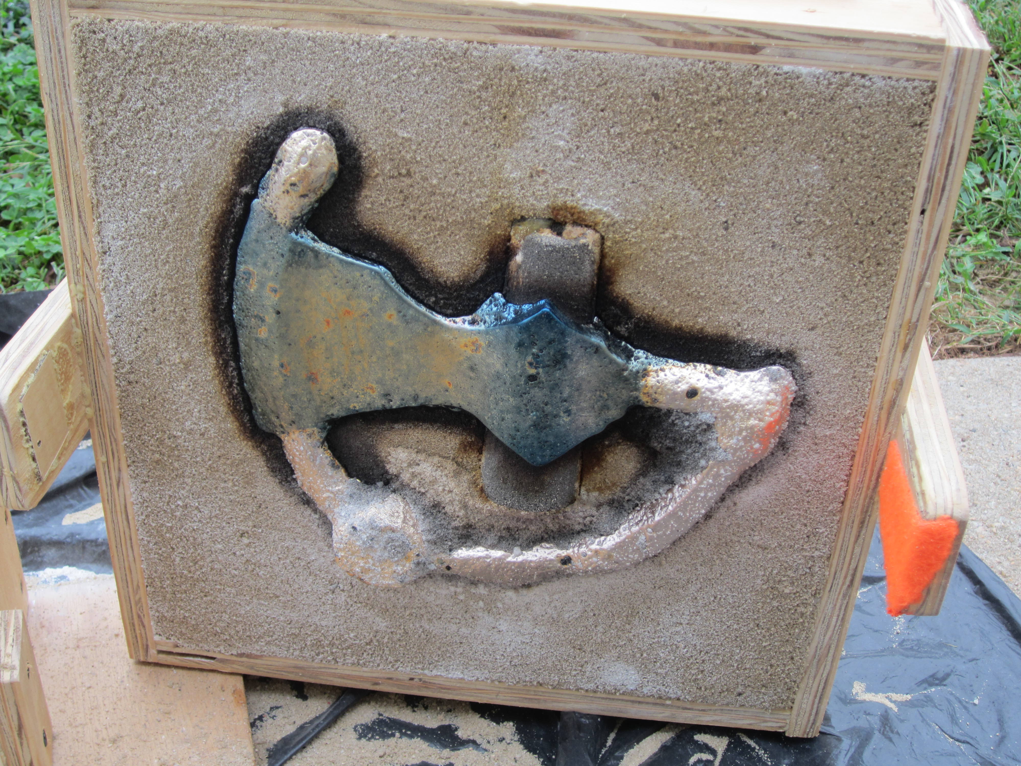

Top half of pattern in place, ready to ram the flask. The other parts are the sprue bottom (blue) and a bit of a runner (wood) that will be completed free hand. Attachment 26509

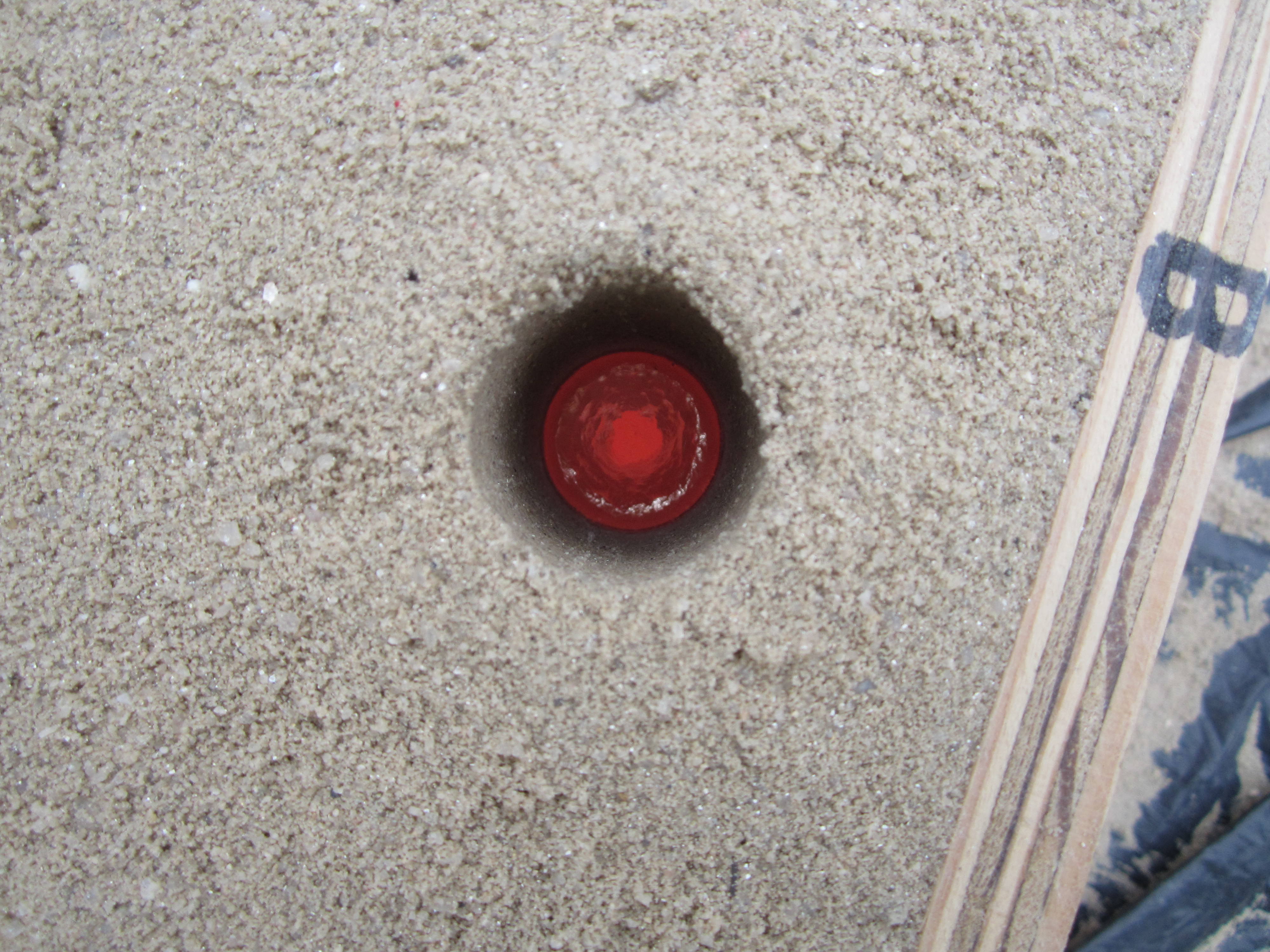

Rammed and ready to pour. (again, file too large -- link here: https://i.imgur.com/tV95eMZ.jpg )
That stuff is HOT! You can see that it is already cooling and sucking metal down into the part from the riser (this is the riser by the back of the axe.) Attachment 26510
You can see the sand and furnace cement (sodium silicate based) core in the pattern. I forgot to take a shot of it in the empty mold.

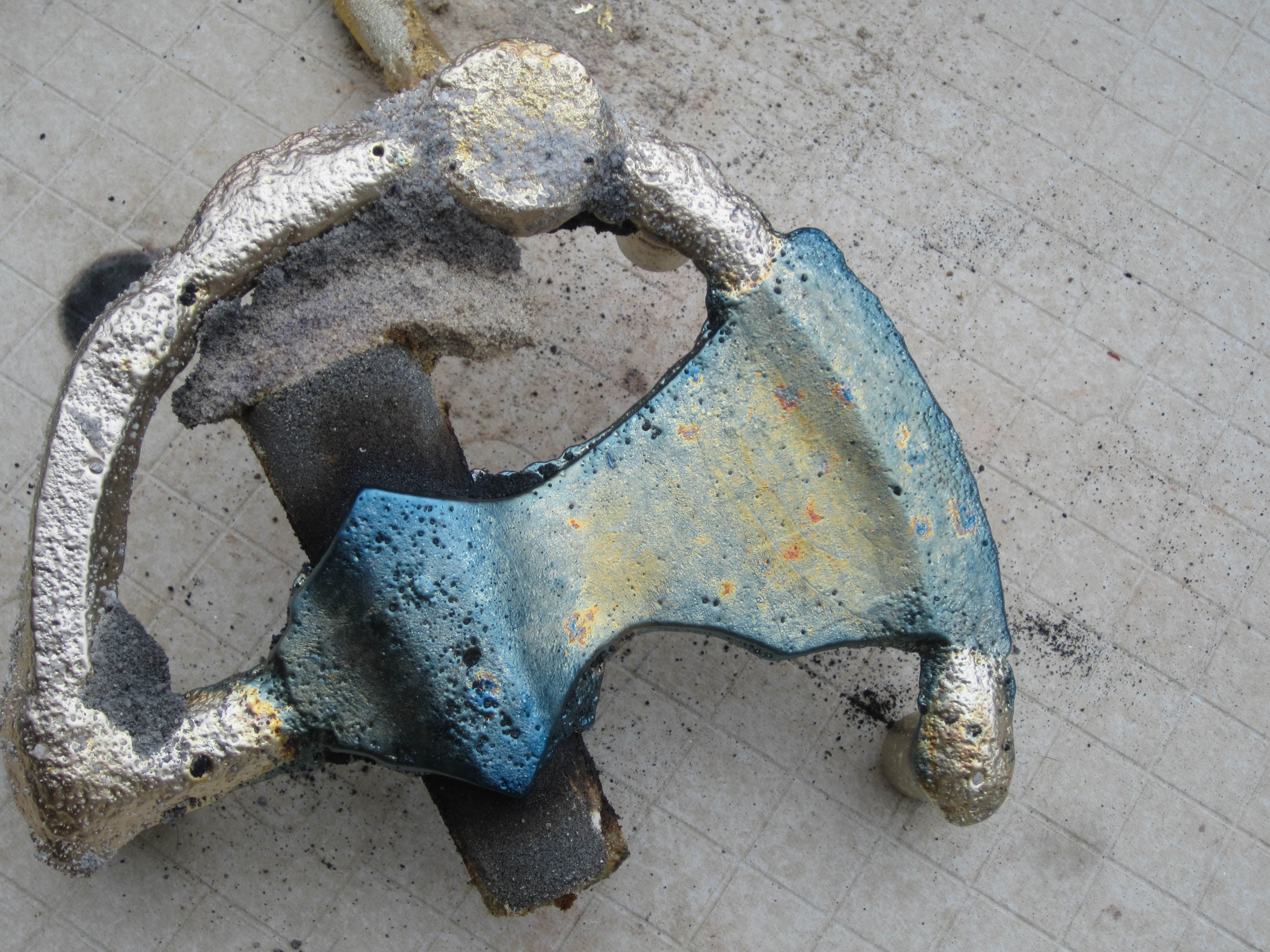

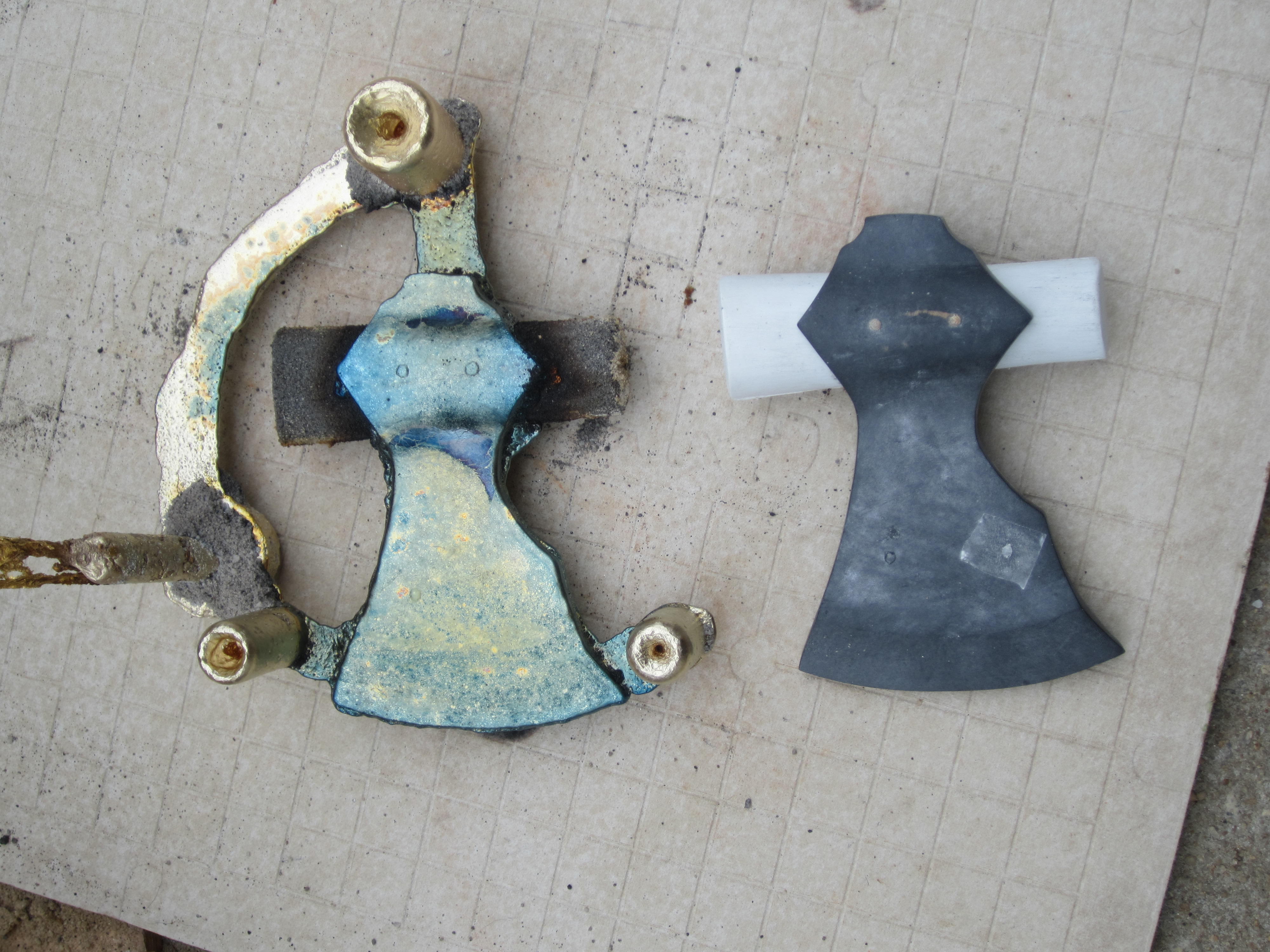

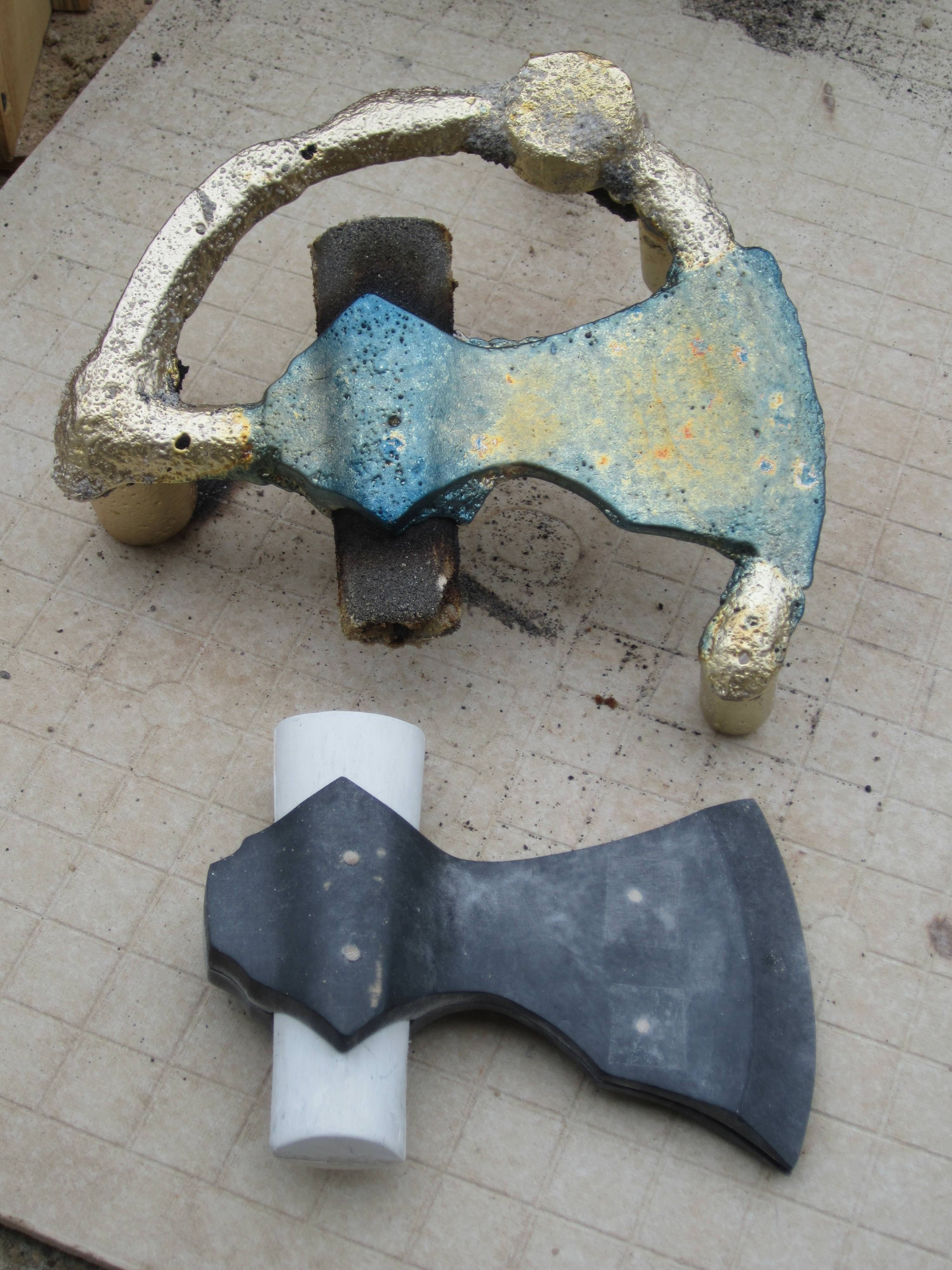

Upper side of the pour. Very good detail on the casting, and pretty smooth finish. It even picked up the two dowels that I left slightly proud on the pattern (I meant to do that -- no, really!) You can see, though, that I barely made enough metal to pour the mold. I would like to have had the risers about 2" higher. This is about 2.5 kg of metal. Attachment 26512

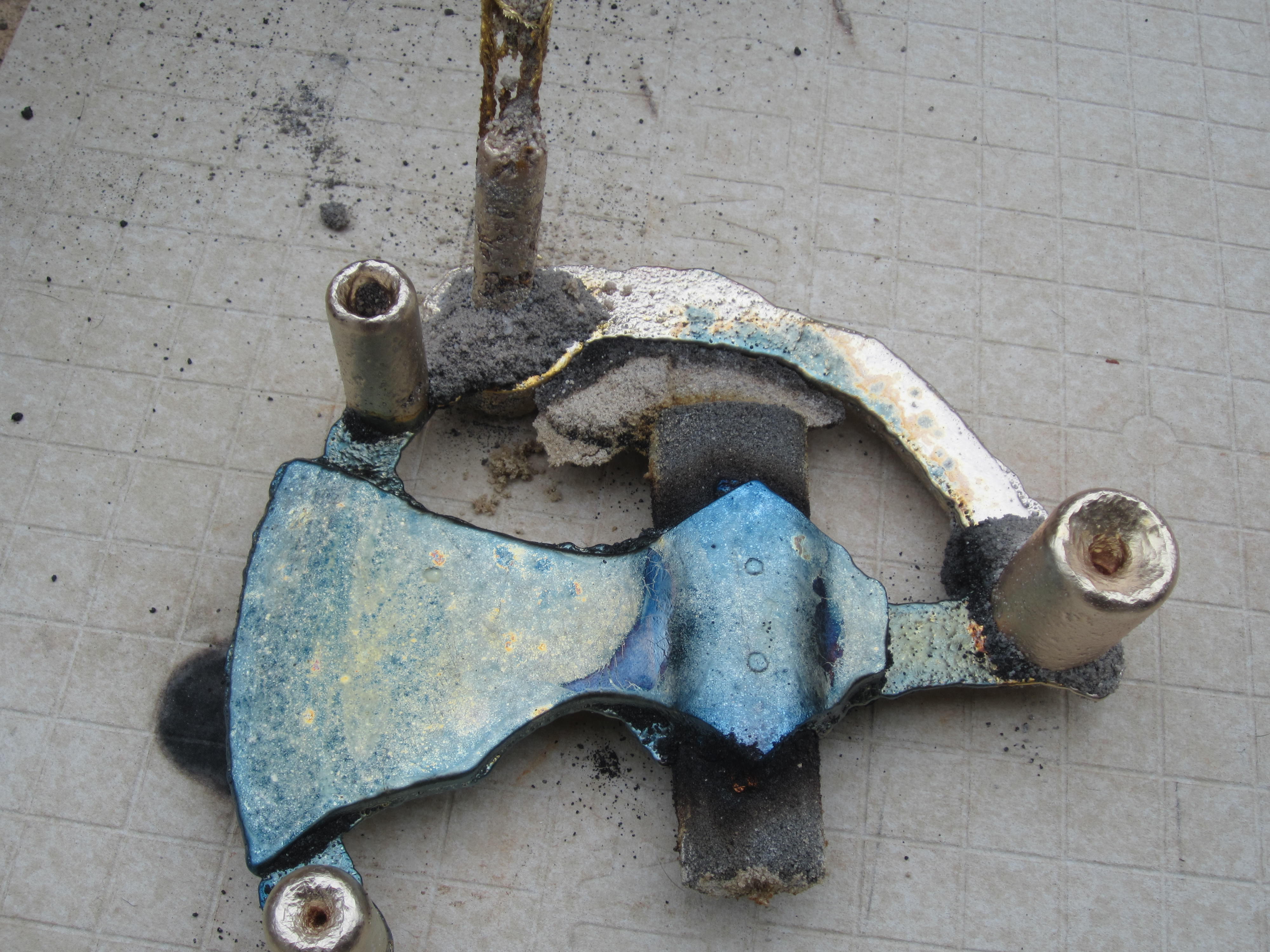

The bottom has the dreaded gas pits. The sand is probably too wet. There are only a few really ugly ones, and they don't go more than about 2 mm deep. The core held its shape very well. It was hard to break apart, especially getting it out from the inside of the axe. Attachment 26513
Comparison -- bottom side of casting. If you look closely, you can see that the casting picked up the detail of the cellophane tape that was covering the peg holes on the pattern. Attachment 26514
Now to cut it free and get it cleaned up! Attachment 26515

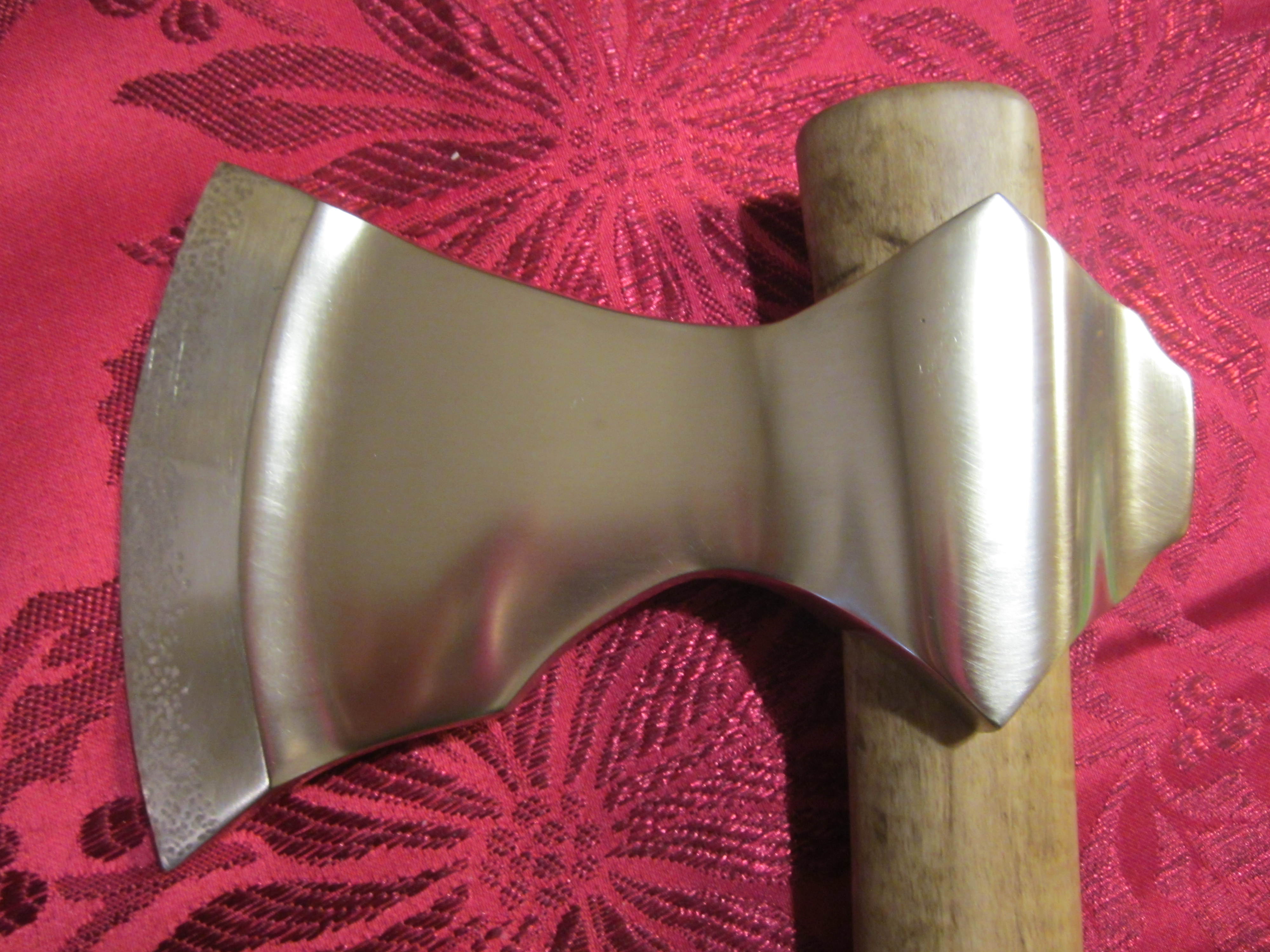

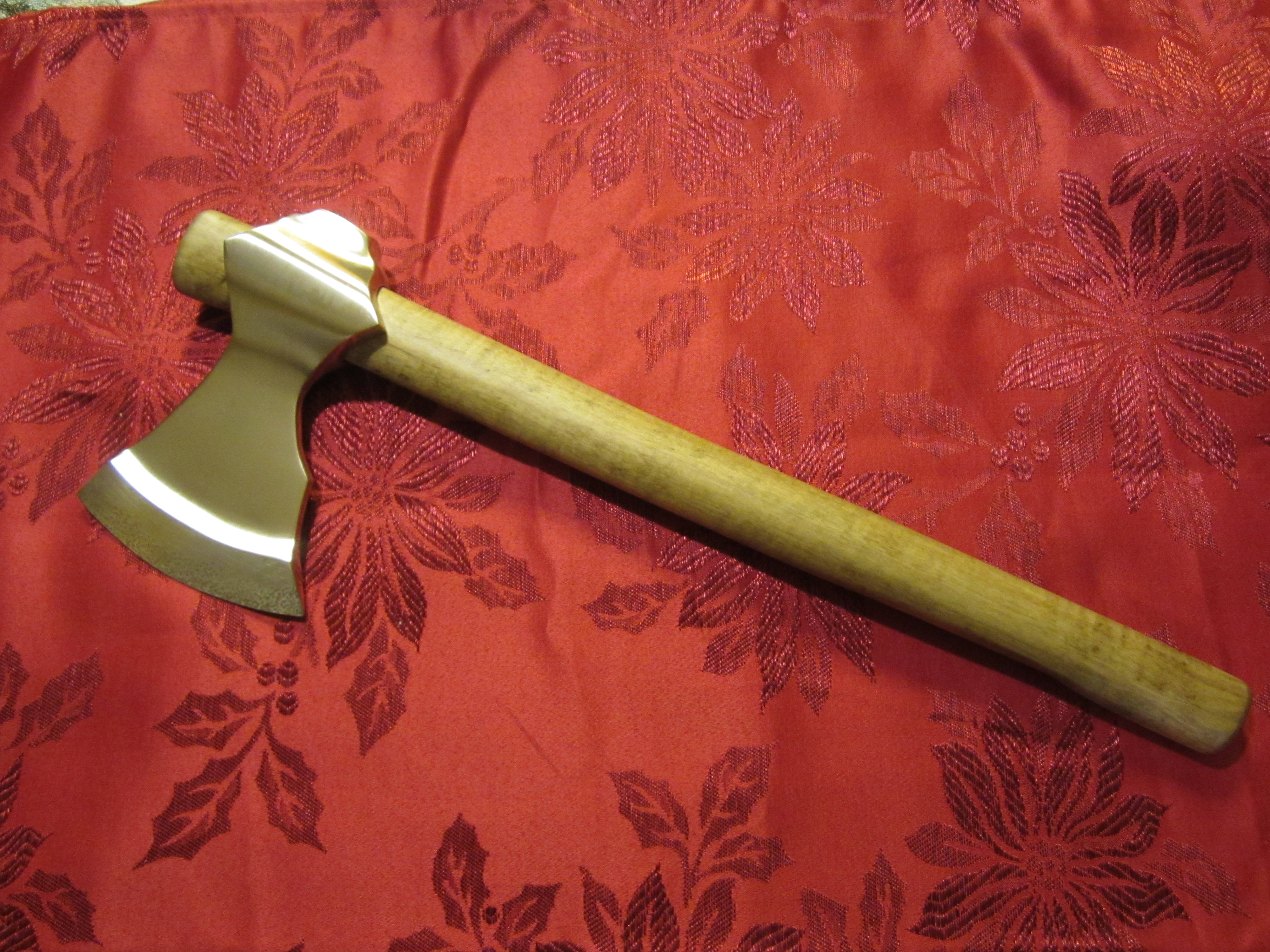

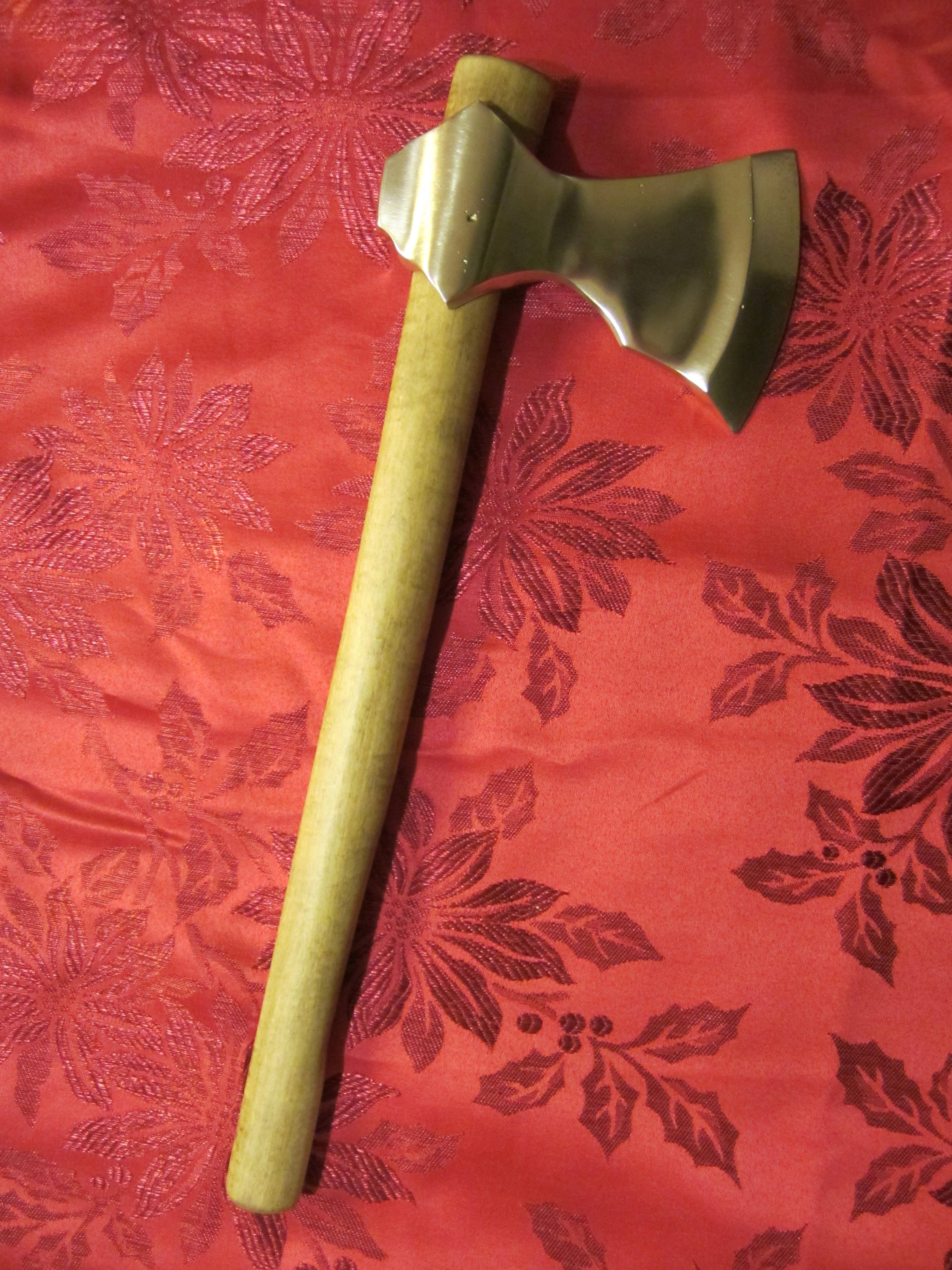

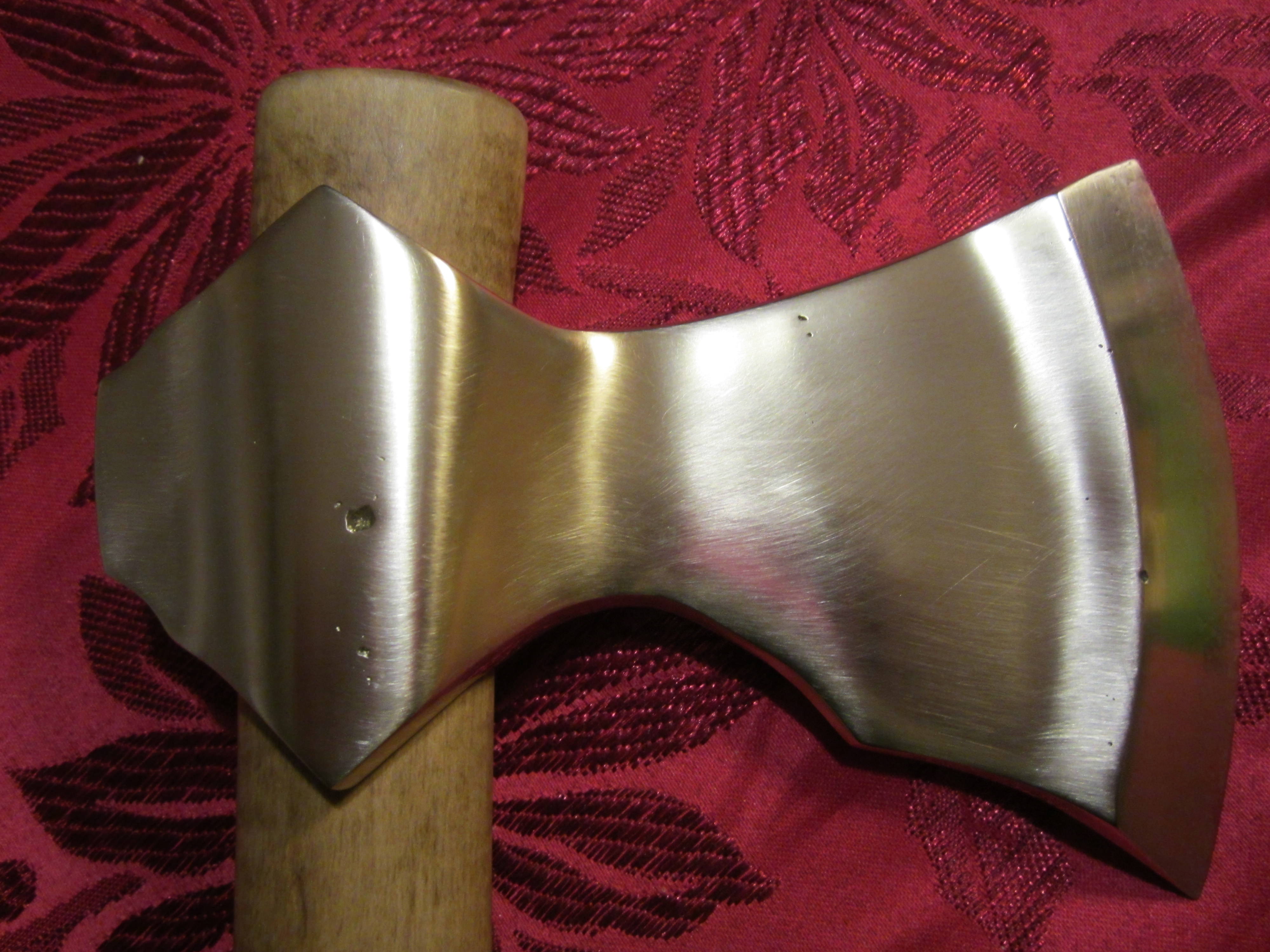

Finished aluminum bronze hand axe. Handle is maple (with a little bit of curl in spots.) Axe handle is 17" long. Axe head is 6 1/4" from blade to poll, and edge is 4 1/4" long. Maple handle was split from a log and hand carved to size. Axe head weighs 1 pound 12.4 ounces -- 804 grams. Attachment 26516
Left side of axe head. This side was the top (cope) side of the casting, and the rough casting had very little pitting on it. You can see that the edge of the blade has been peened. The surface has been sanded to an 800 grit. Attachment 26517

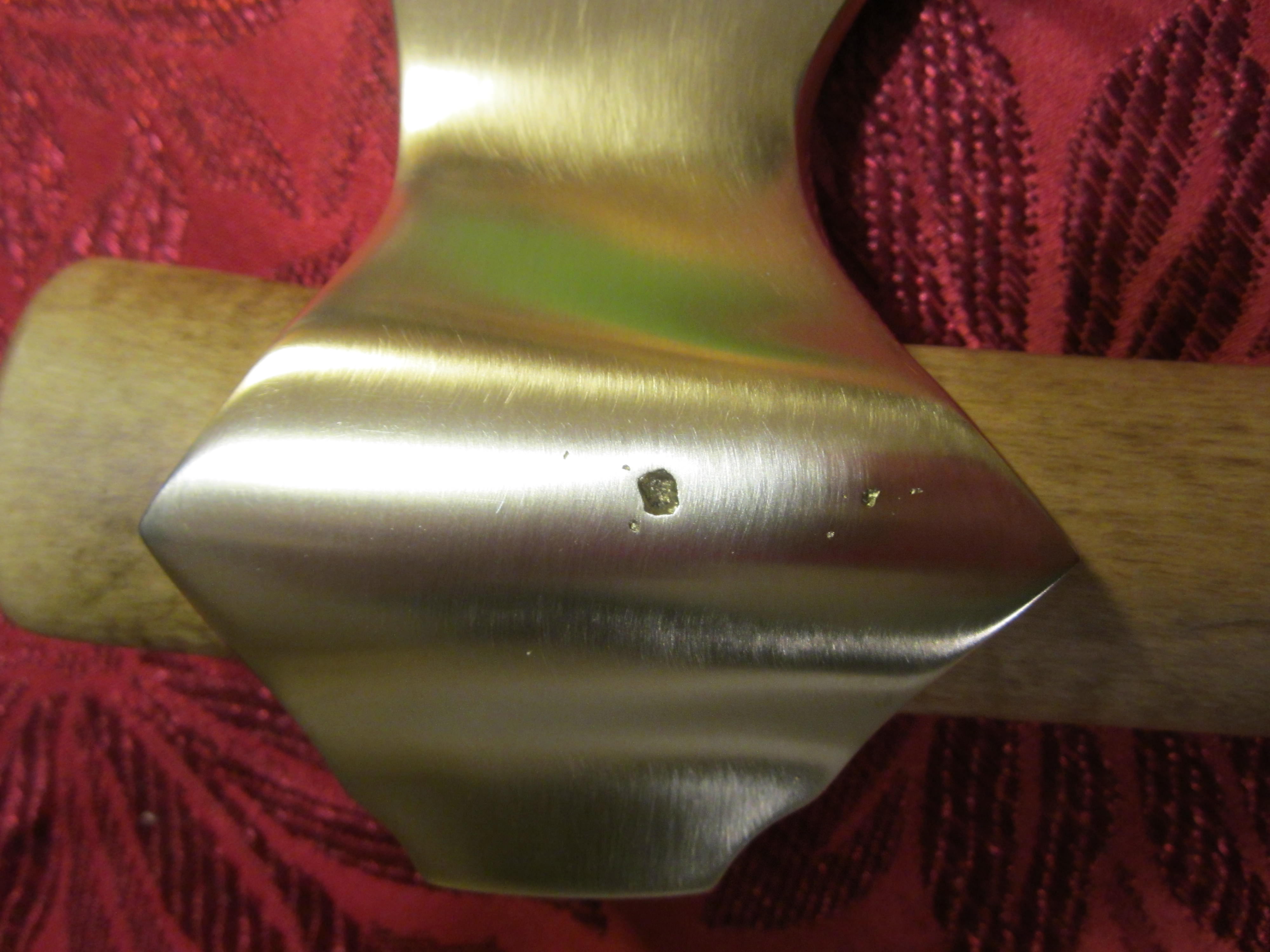

Right side of axe head. This side was the bottom (drag) side of the casting. It was fairly heavily pitted, but I was able to grind out most of the pits, although a few remain, including one large one that measures 1/8" -- 3mm -- in diameter and about 2mm deep. Attachment 26518

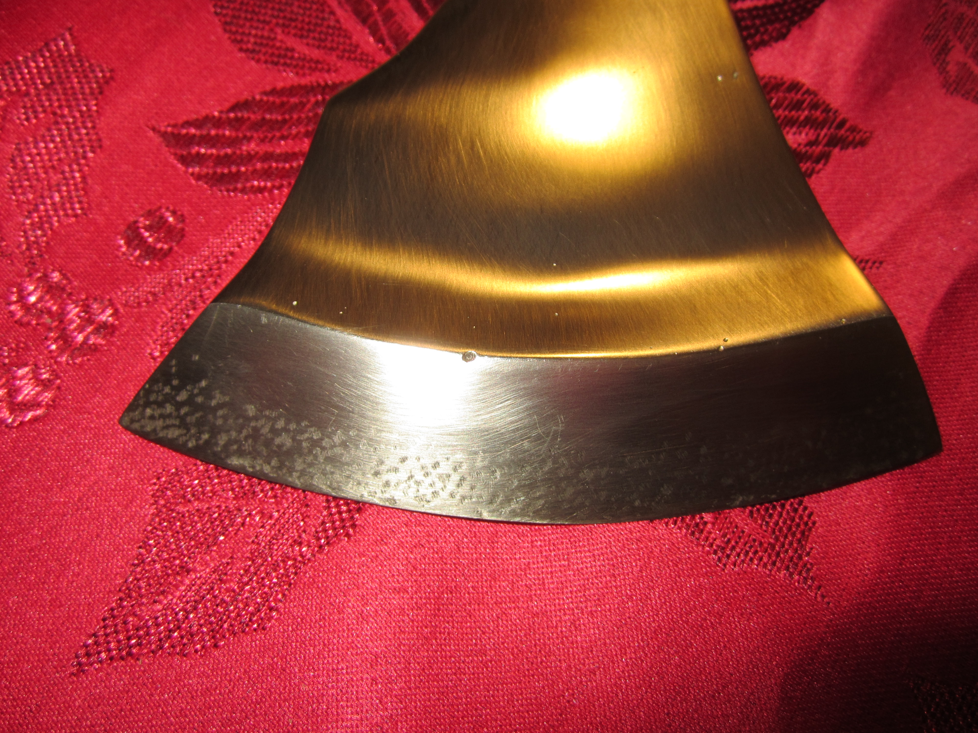

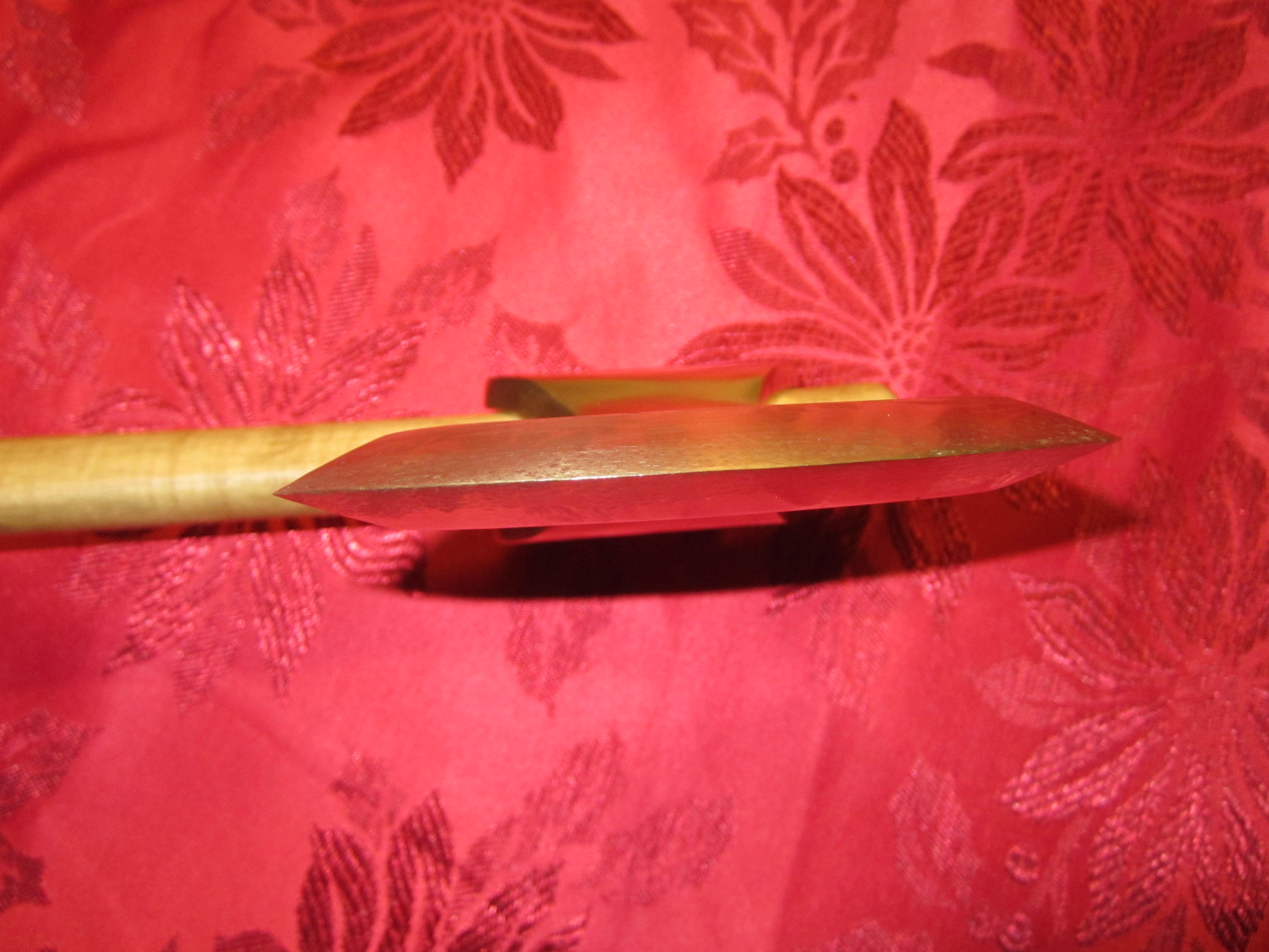

Edge of axe. The edge is sharp enough to chop with, but it won't slice paper easily. I haven't actually sharpened it properly, but have just filed it to an edge and sanded it before peening. I chopped a 2" square piece of maple with this edge and it did not dull any. You can see a little bit of the curl in the maple handle. Attachment 26519
Close-up of the peened edge. I might peen this side some more. The other side is peened a little bit more than this. The peening work hardens the aluminum bronze so that it will hold an edge without deforming. Attachment 26520
This is the large pit on what was the bottom (drag) side of the axe. Again, it's about 3mm in diameter and 2mm deep. Attachment 26521
