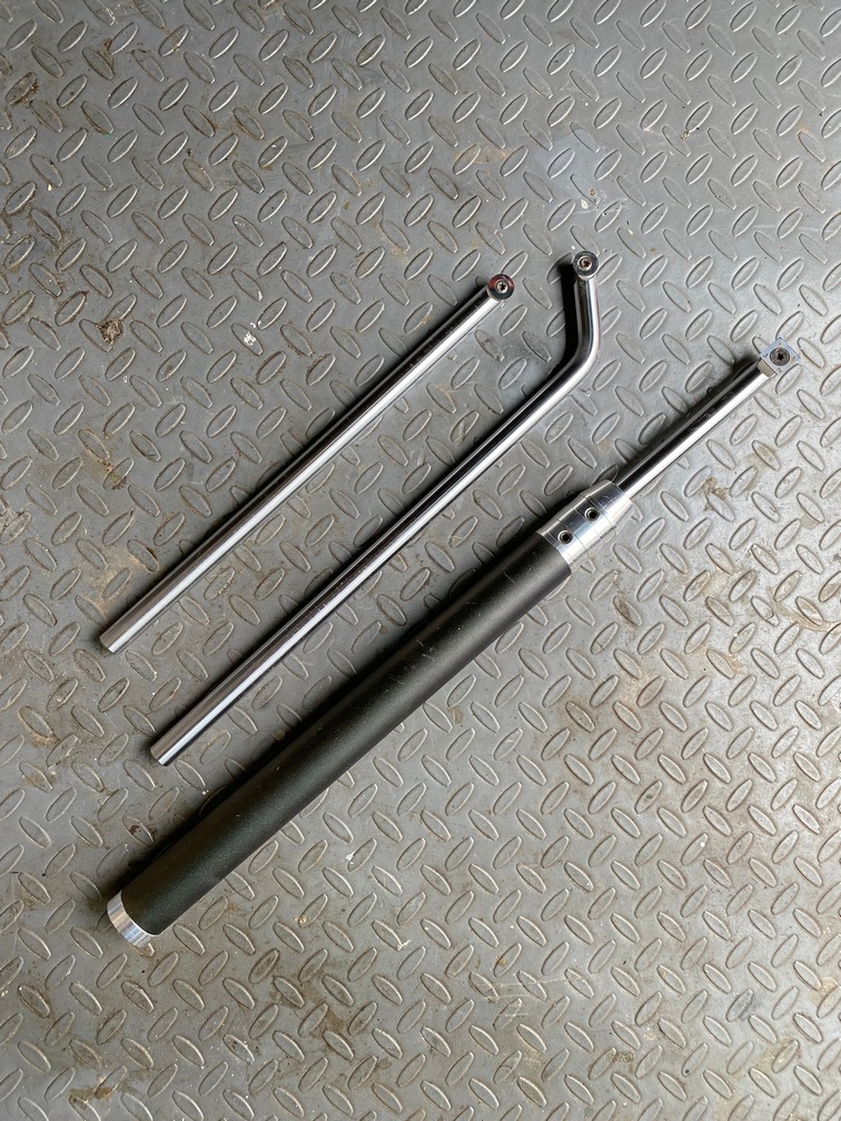

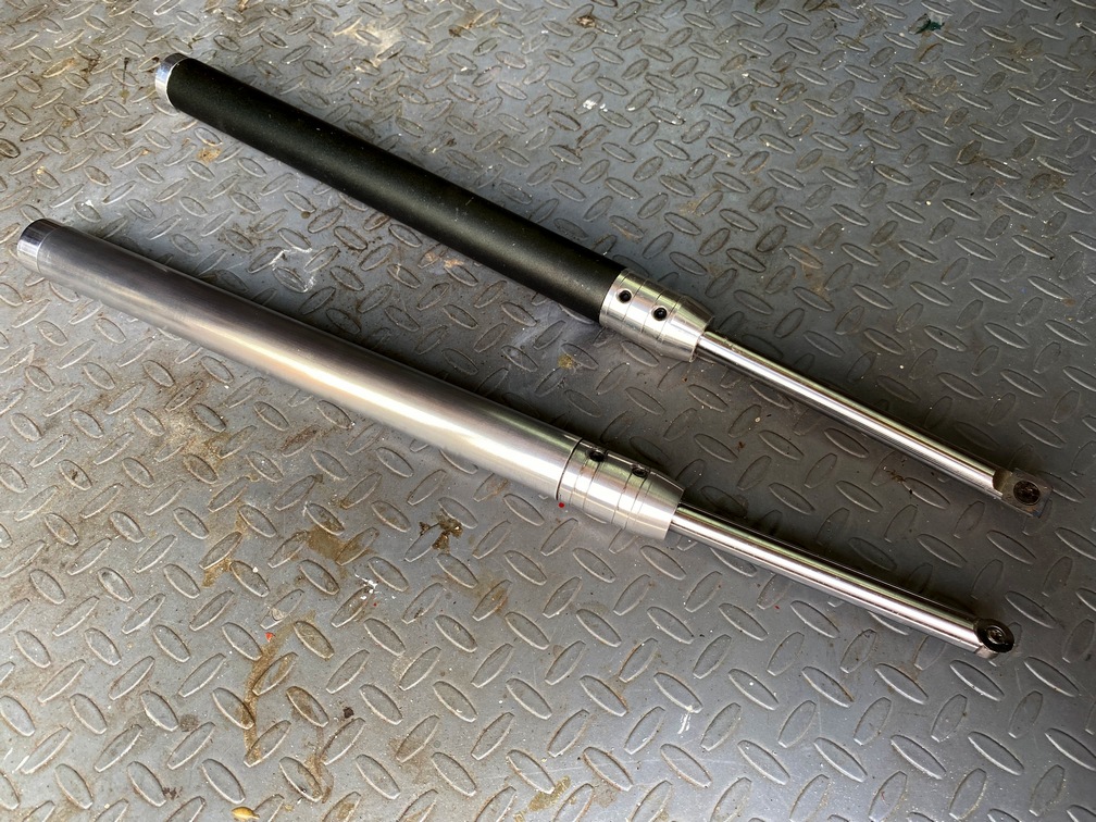

Some time ago I bought (at Banggood) three types of woodturning tools with carbide inserts and an aluminum handle. All three tool types (or others) are interchangeable and can be used with the same handle. I thought about making another handle out of aluminum to have two tools ready to use.
Commercial woodturning tools and handle
Attachment 43379

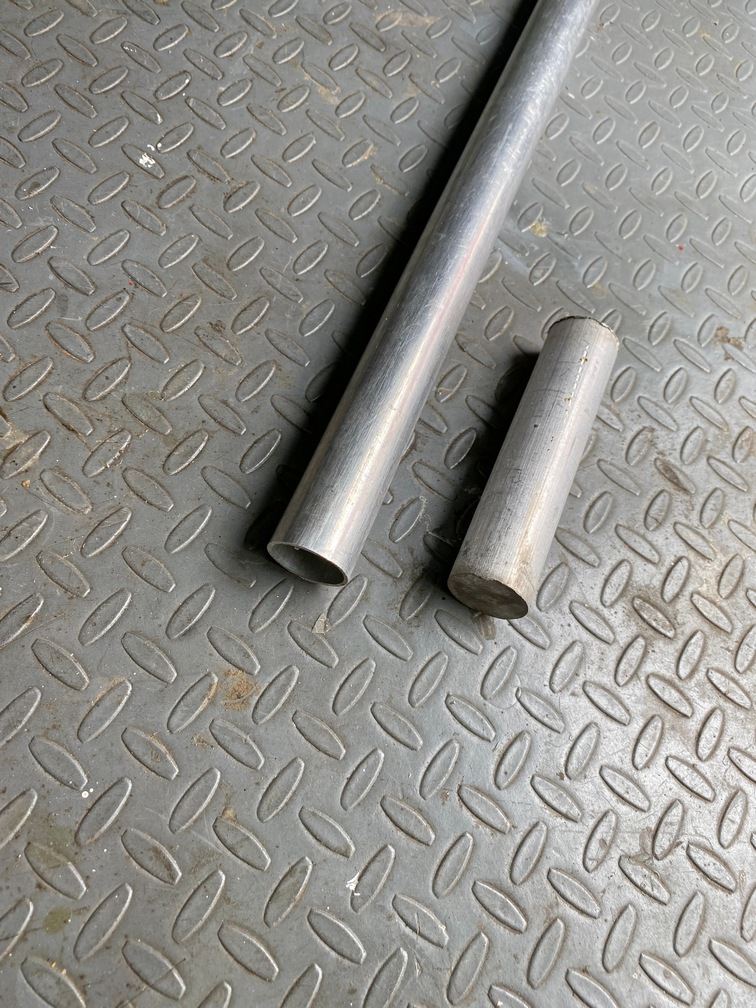

Used materials
Attachment 43380

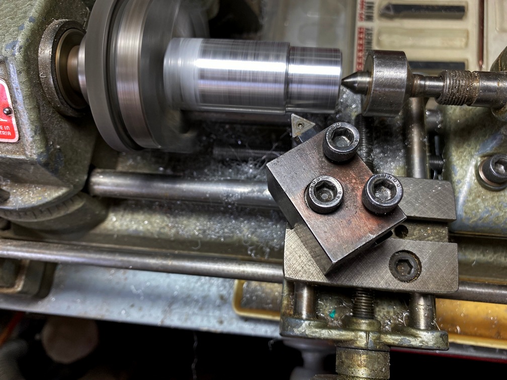

Turning solid aluminum (receiver)
Attachment 43381

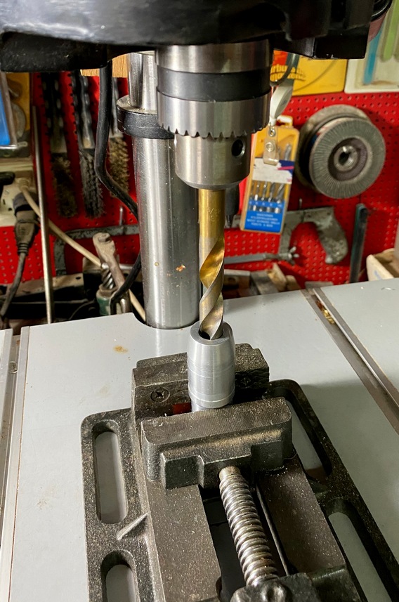

Making a 31/64” hole
Attachment 43382

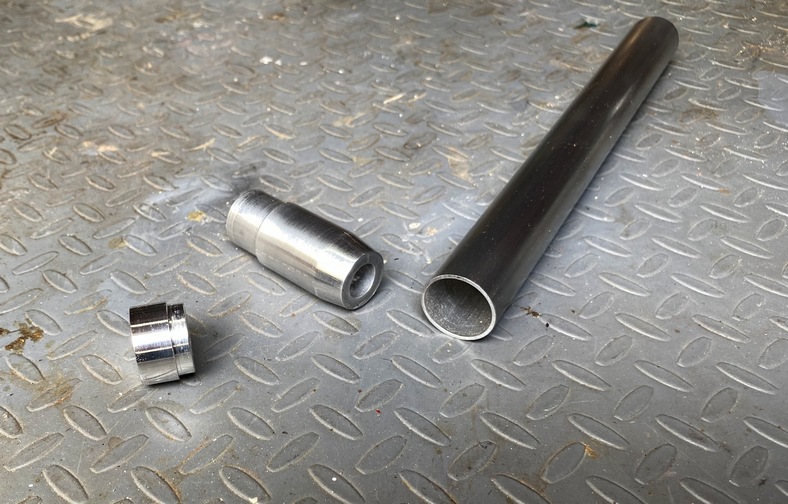

Finished pieces
Attachment 43383
Assembled parts
Attachment 43384

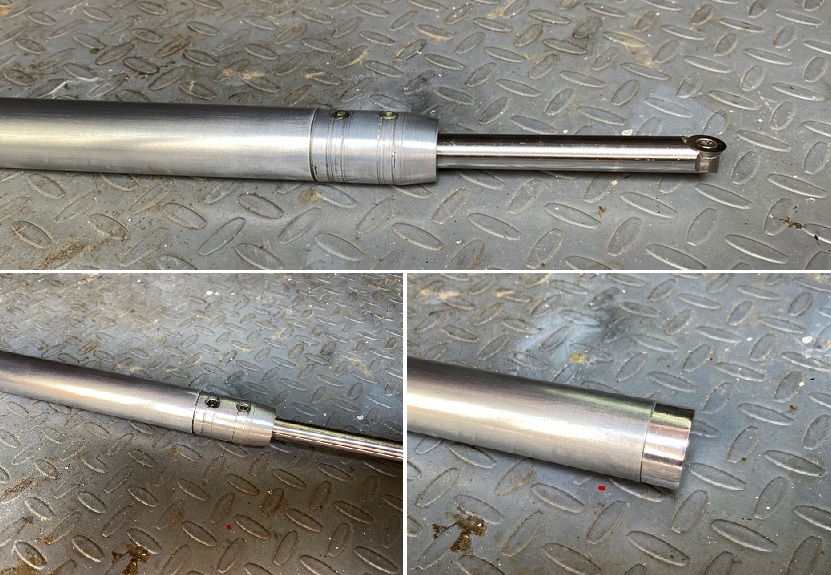

New handle (and old) ready to use
Attachment 43385
Now I'm planning to make a third handle.
