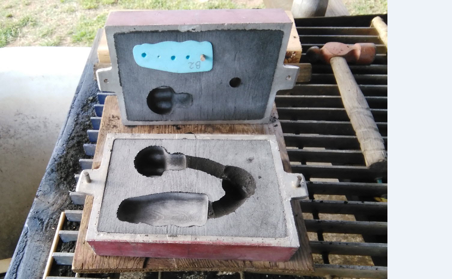

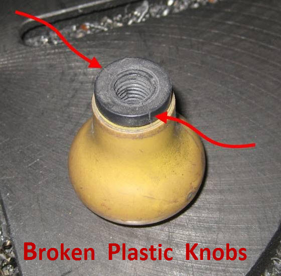

I enjoy re-building equipment that needs a little TLC, and my drill-press handle knobs needed to be replaced because all 3 had cracked and did not hold on the handle threads anymore.
Attachment 10121

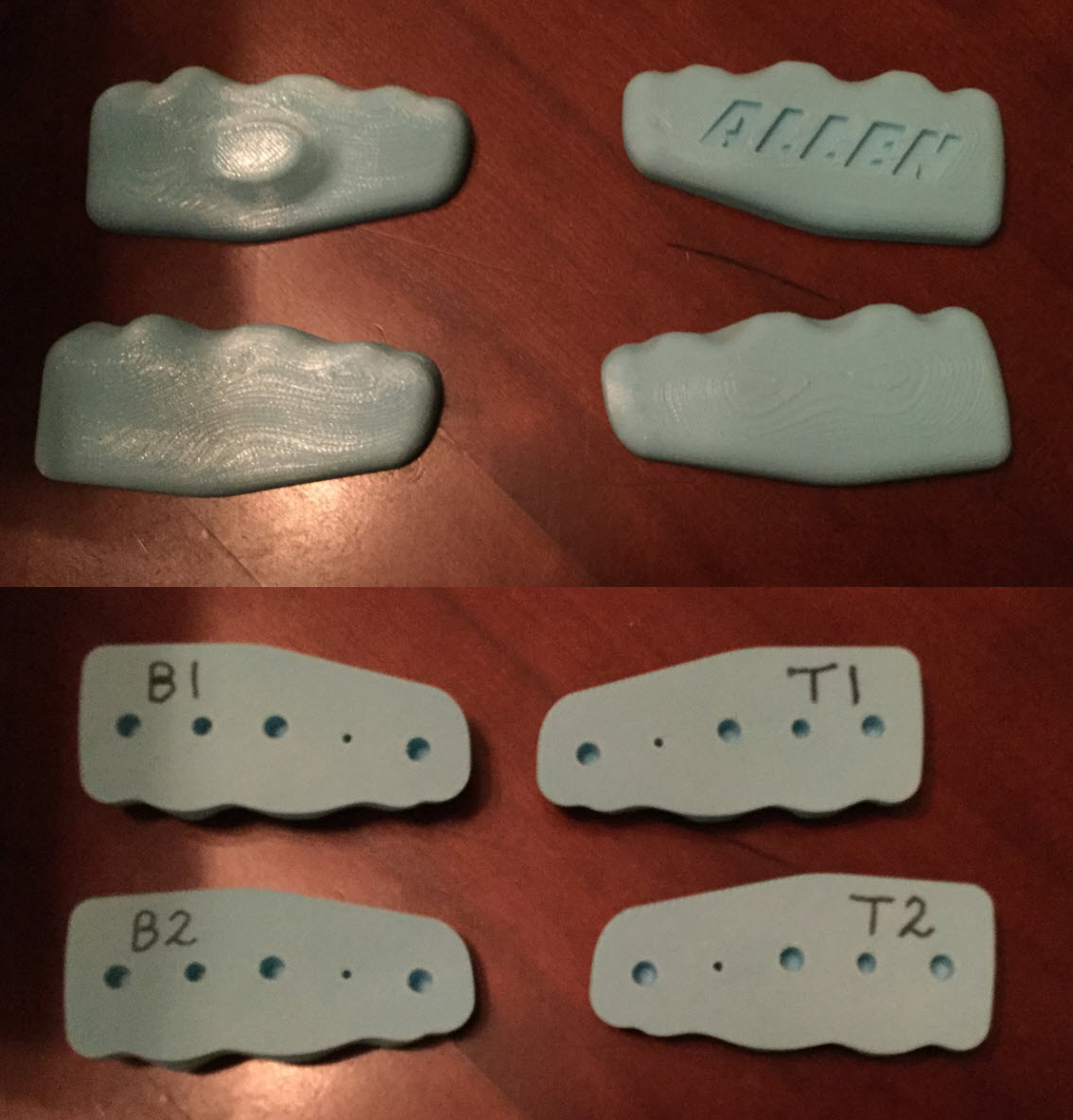

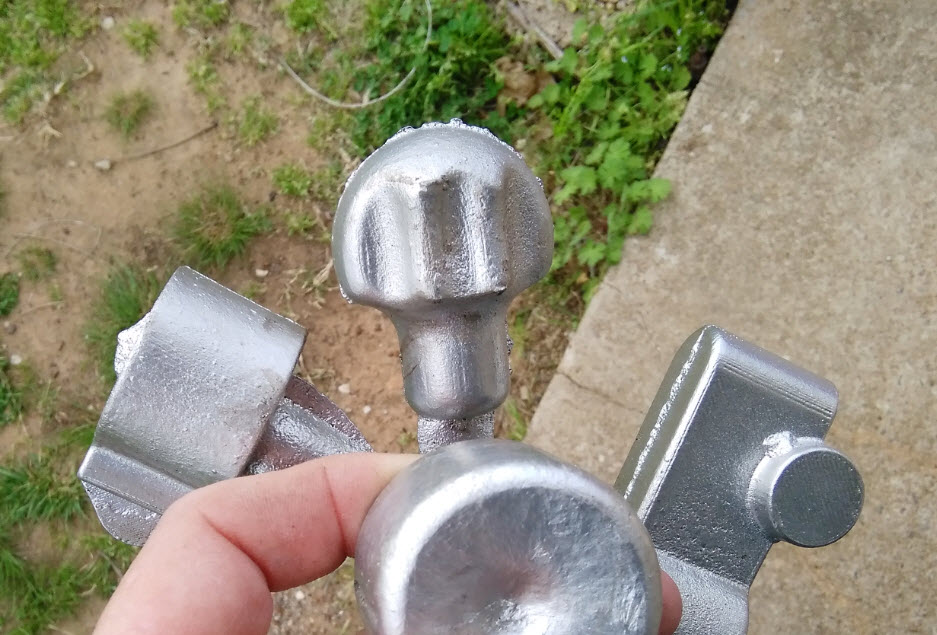

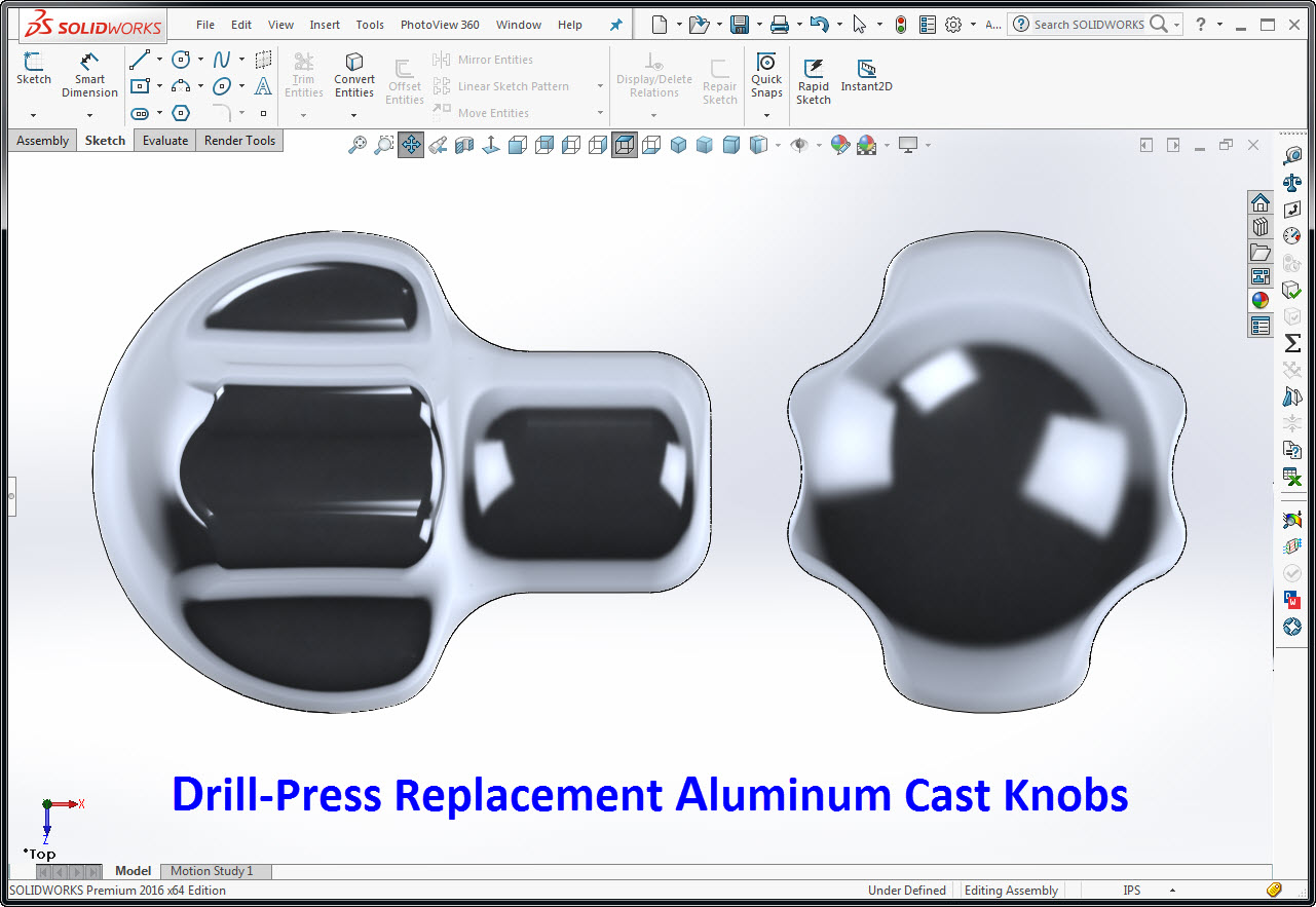

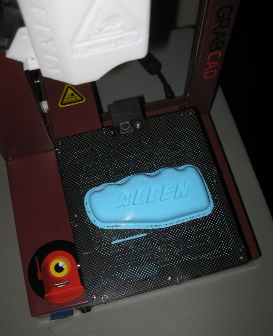

Could have purchased some new Knobs and quickly replaced them ... but much more fun to Cast some out of Aluminum.
Attachment 10122

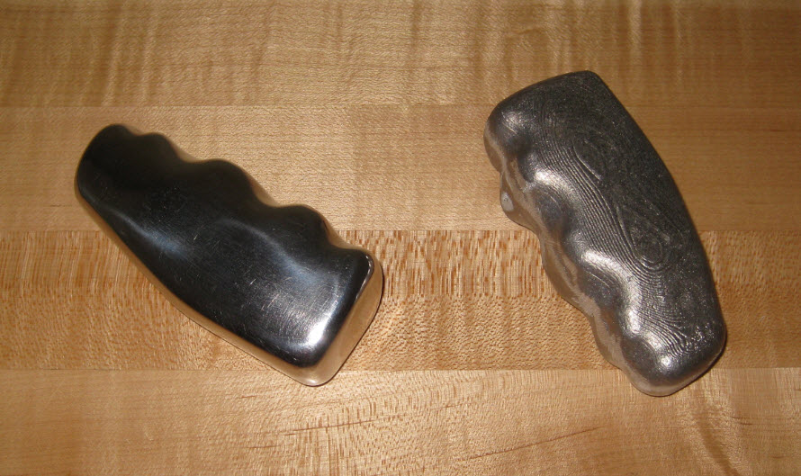

No special reason for the unusual shape ... Just wanted something different :p
Attachment 10123

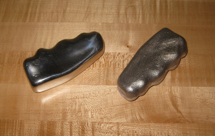

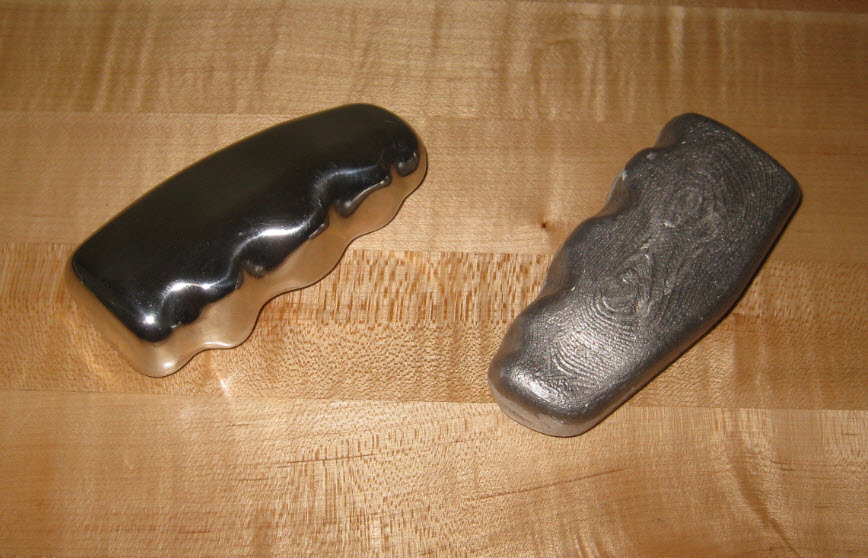

Ground & buffed them off just enough to get rid of the sharp edges ...

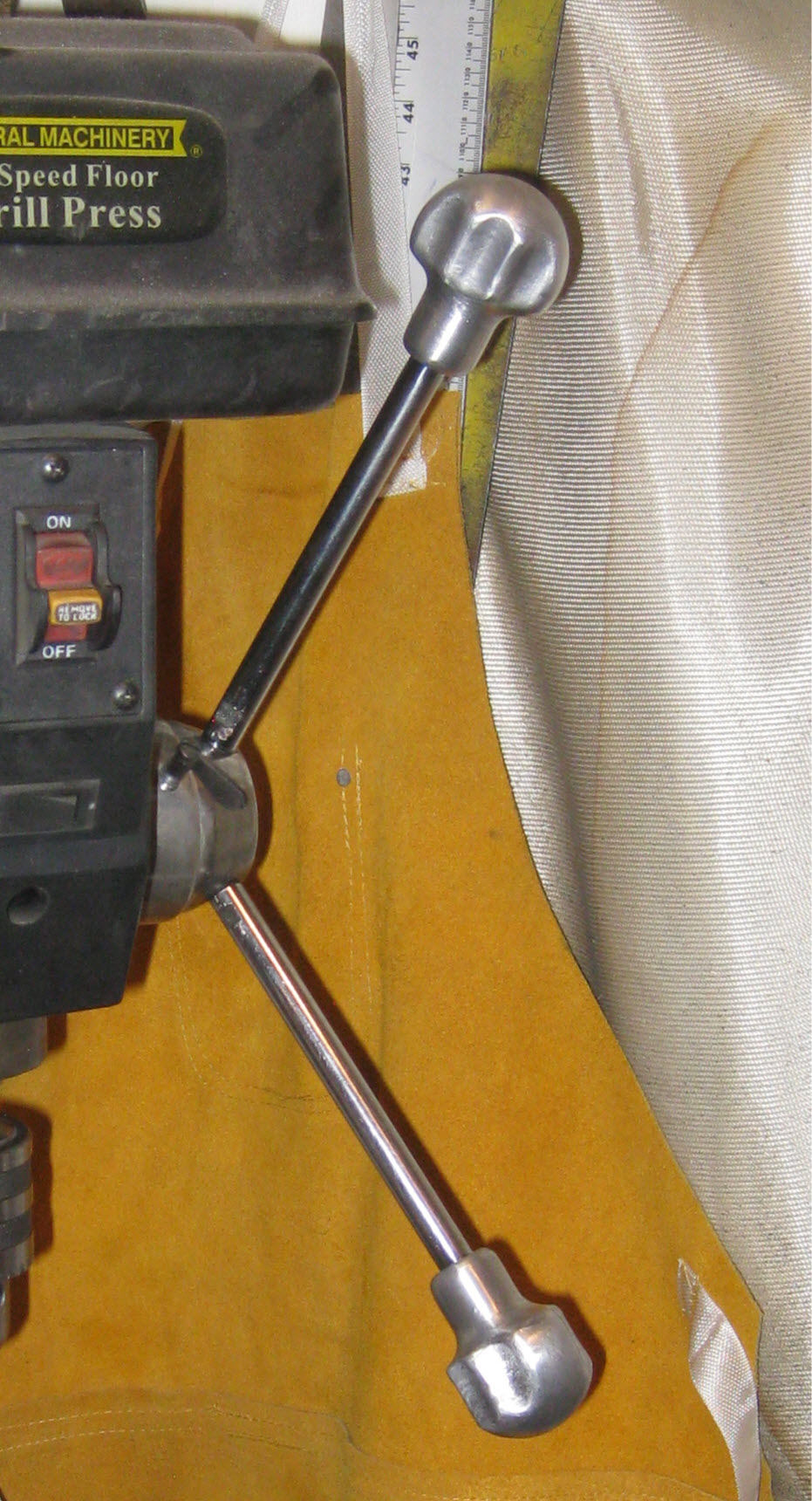

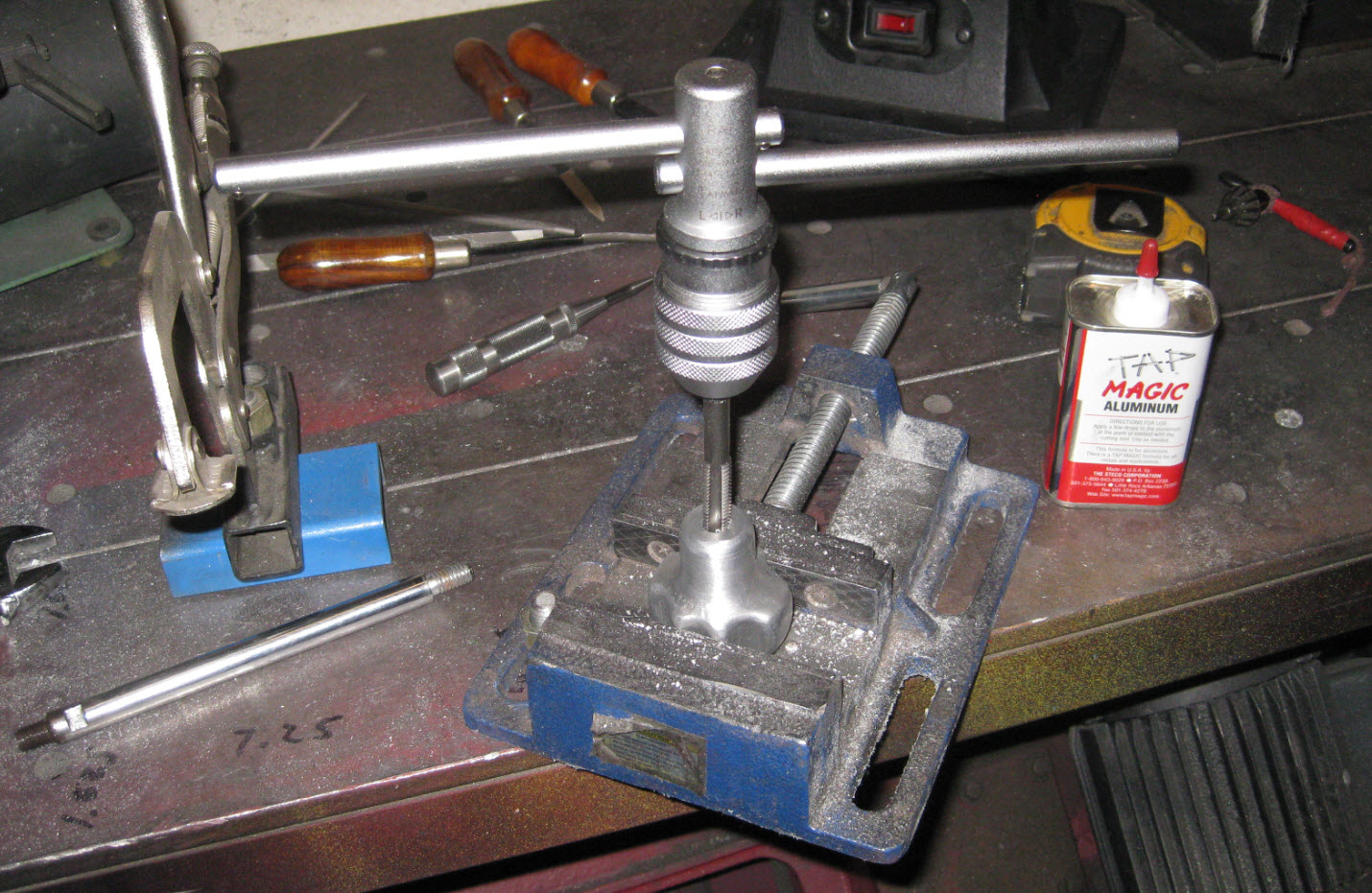

Then tapped the knobs with metric M10 x 1.5 Thread to match drill-press handles.

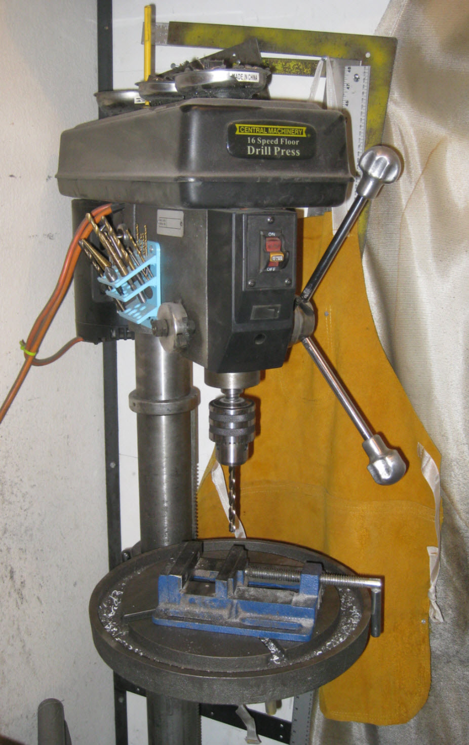

Attachment 10120
Once Again ... Nothing Fancy but works for what I need. :)
