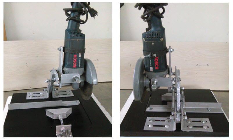

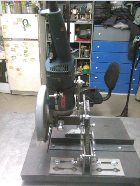

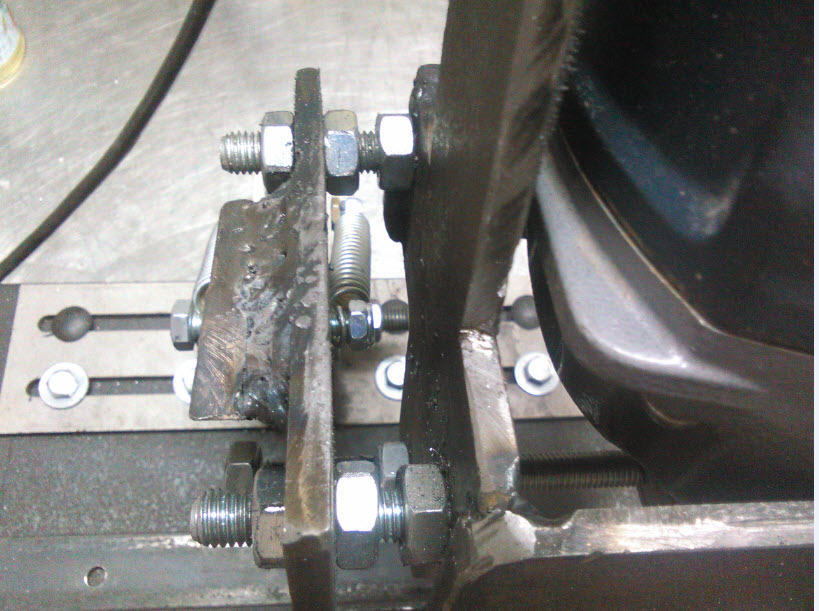

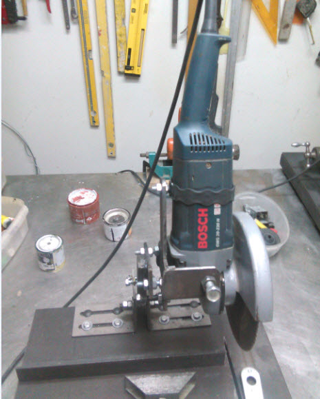

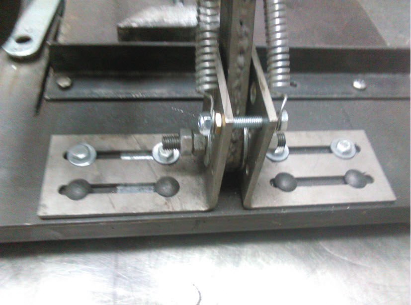

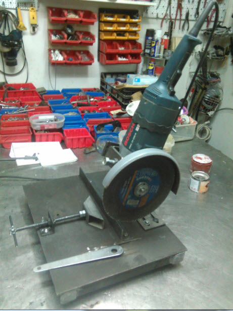

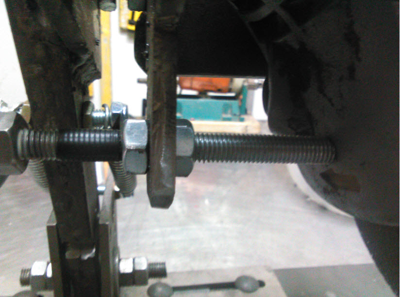

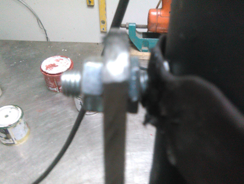

    ANGLE GRINDER 230 mm STAND
    An easy and useful construction you can make with a small angle grinder , a drill and a welding machine. The table is about 50x40 cm. The cover of the table is iron 6 mm .The other dimensions depend on your own angle grinder. The other parts are from iron 5 mm. You can control the tool very easy in every direction. YOU CAN WATCH THE VIDEO OF THE CONSTRUCTION AND THE USE HERE:
