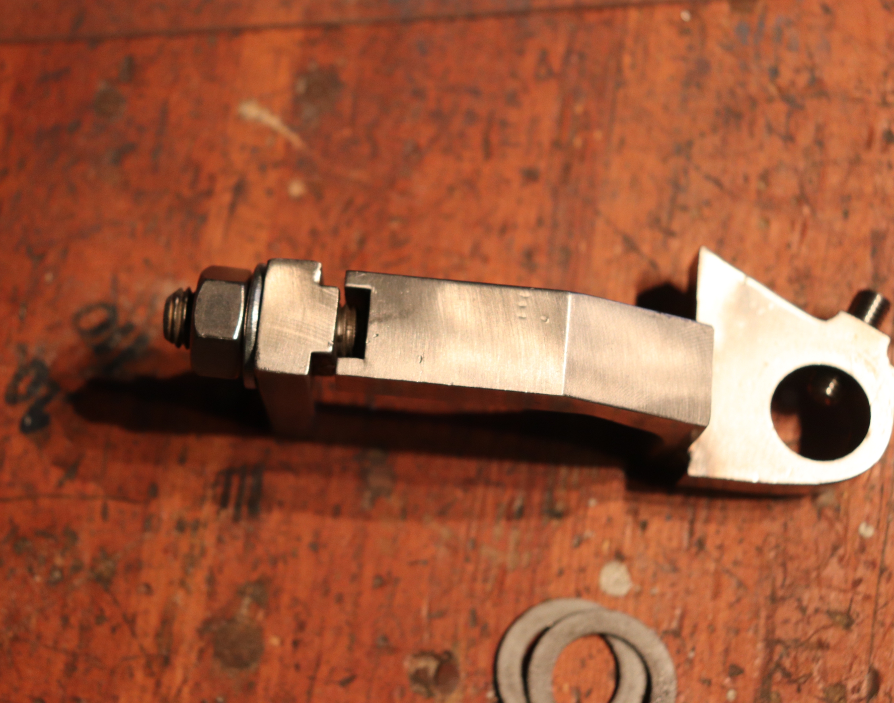

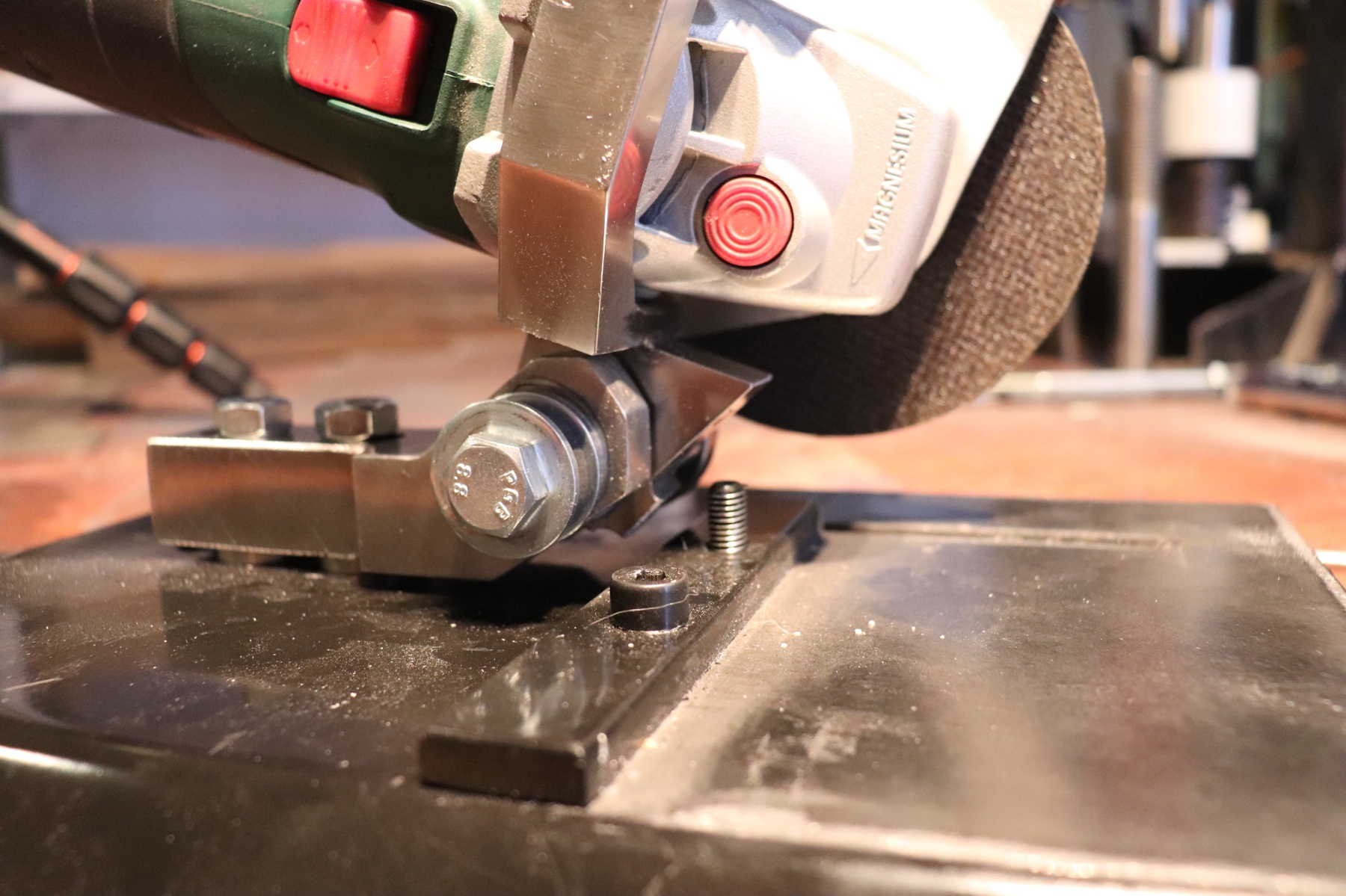

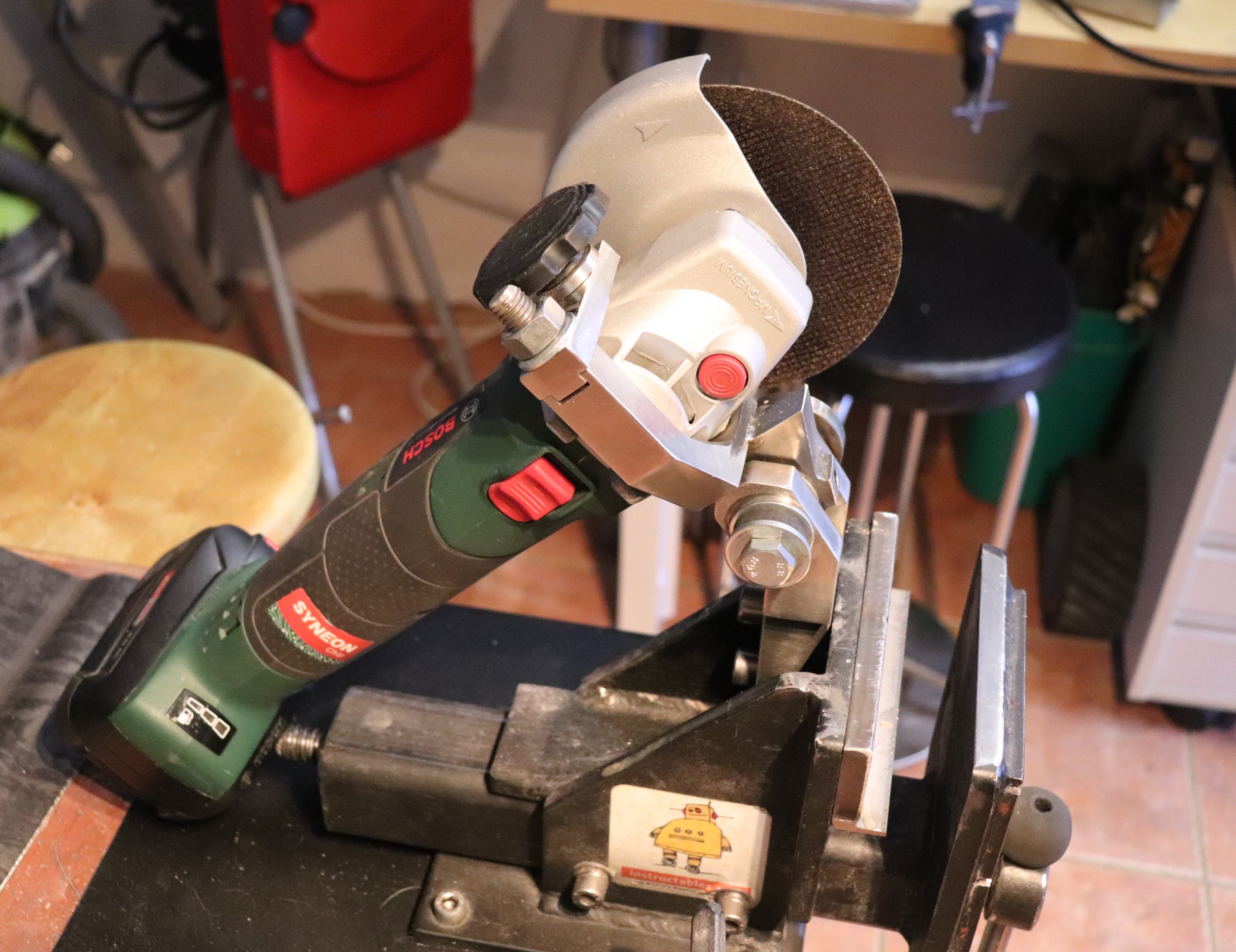

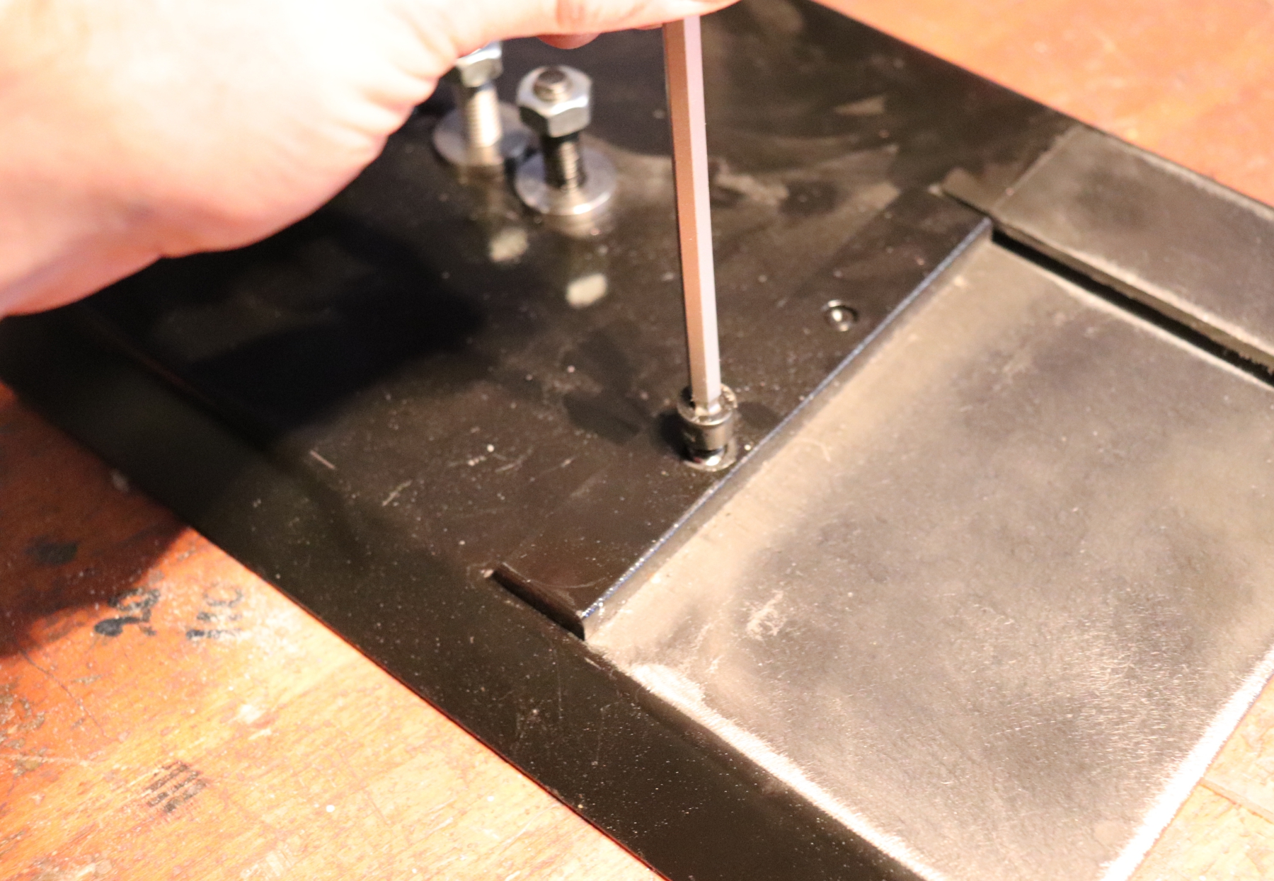

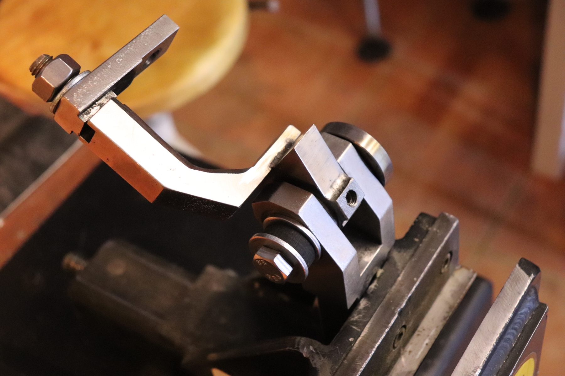

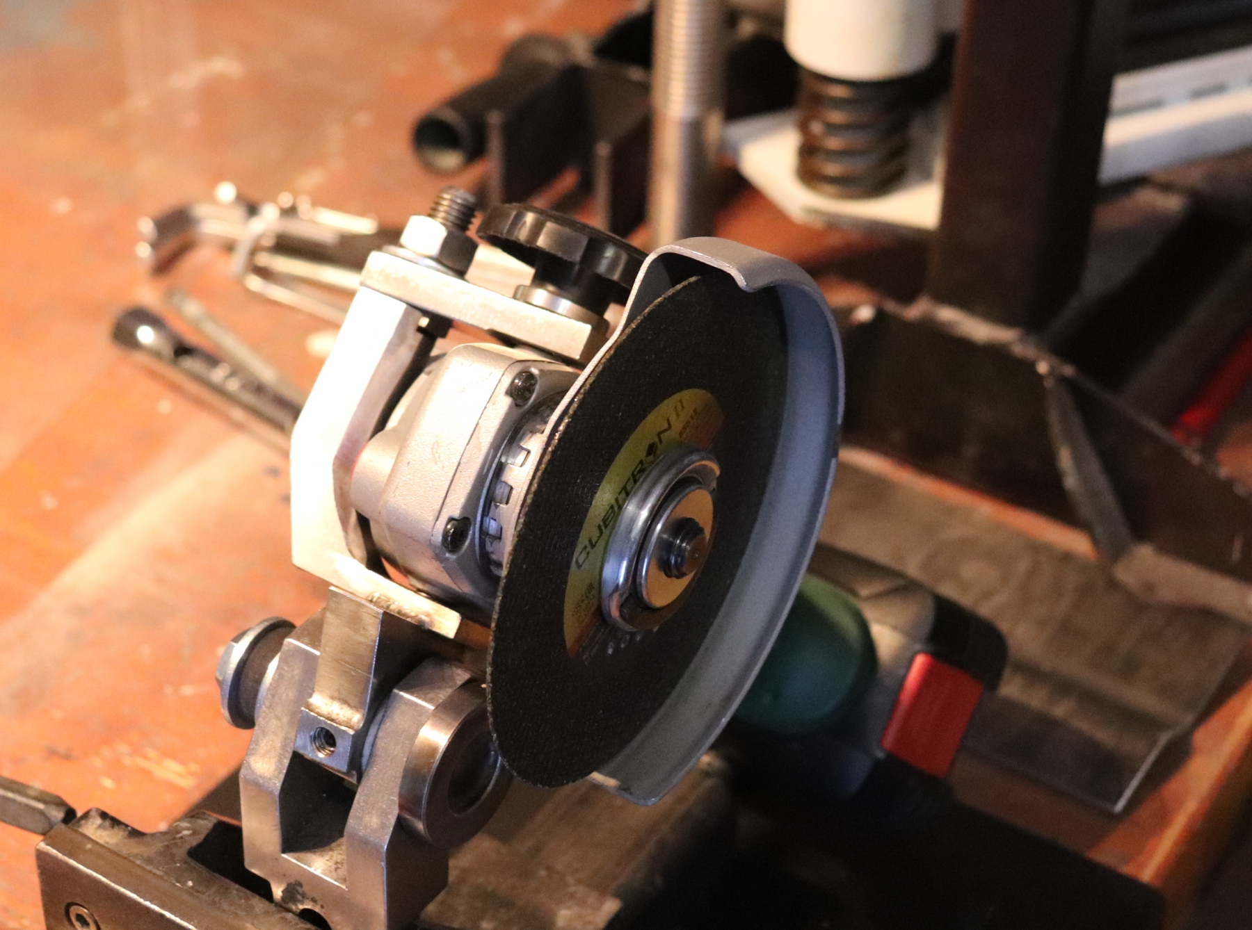

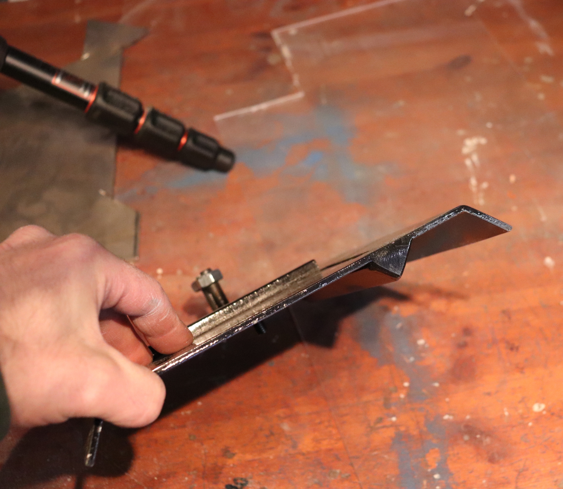

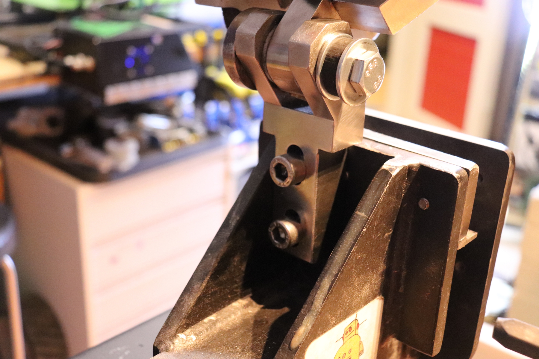

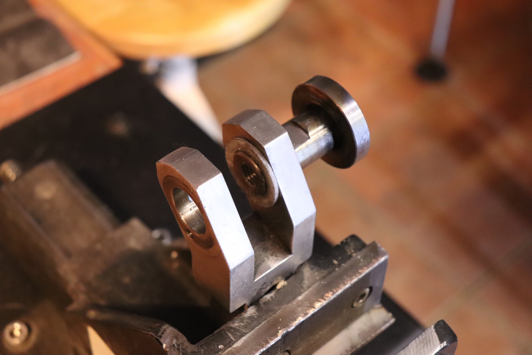

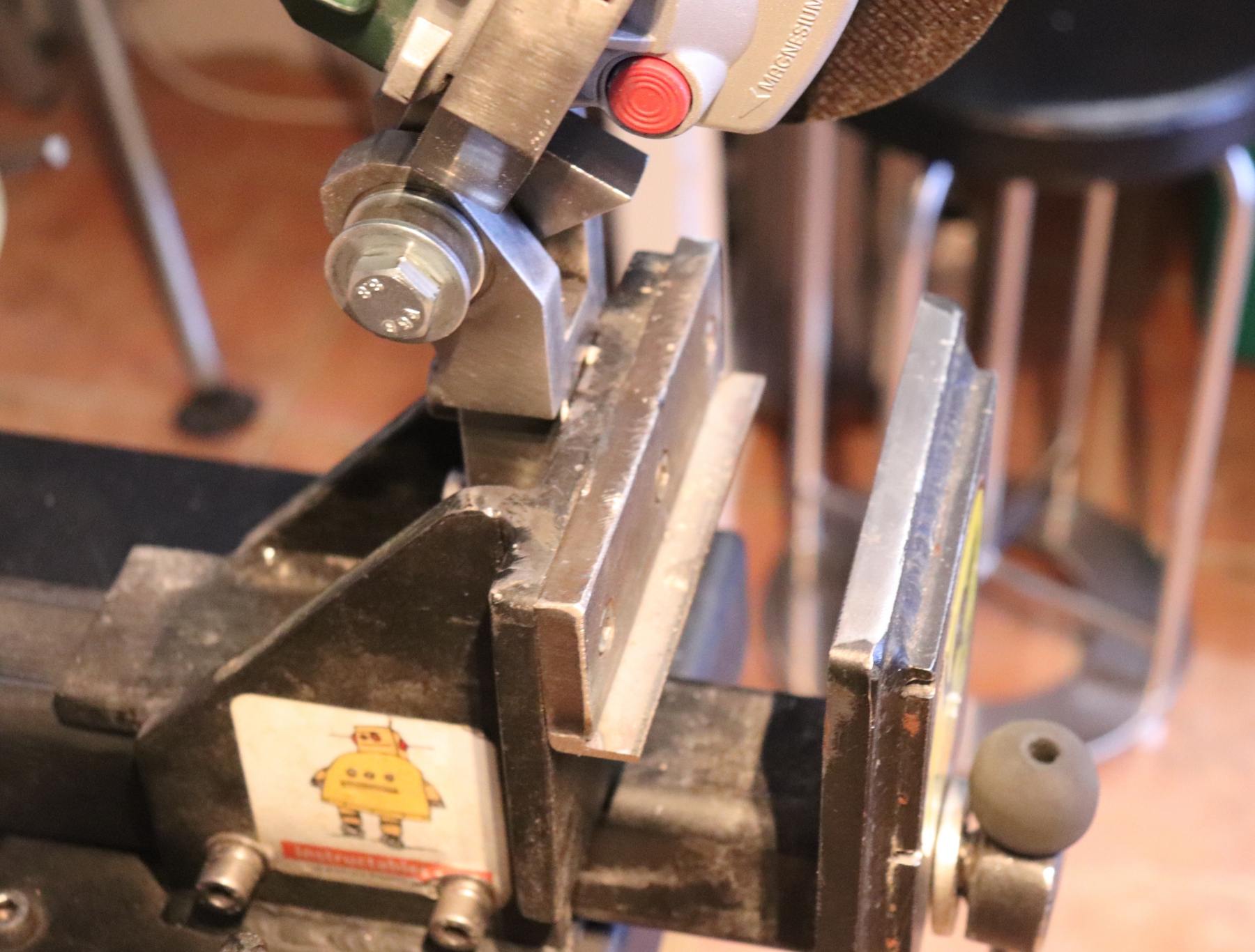

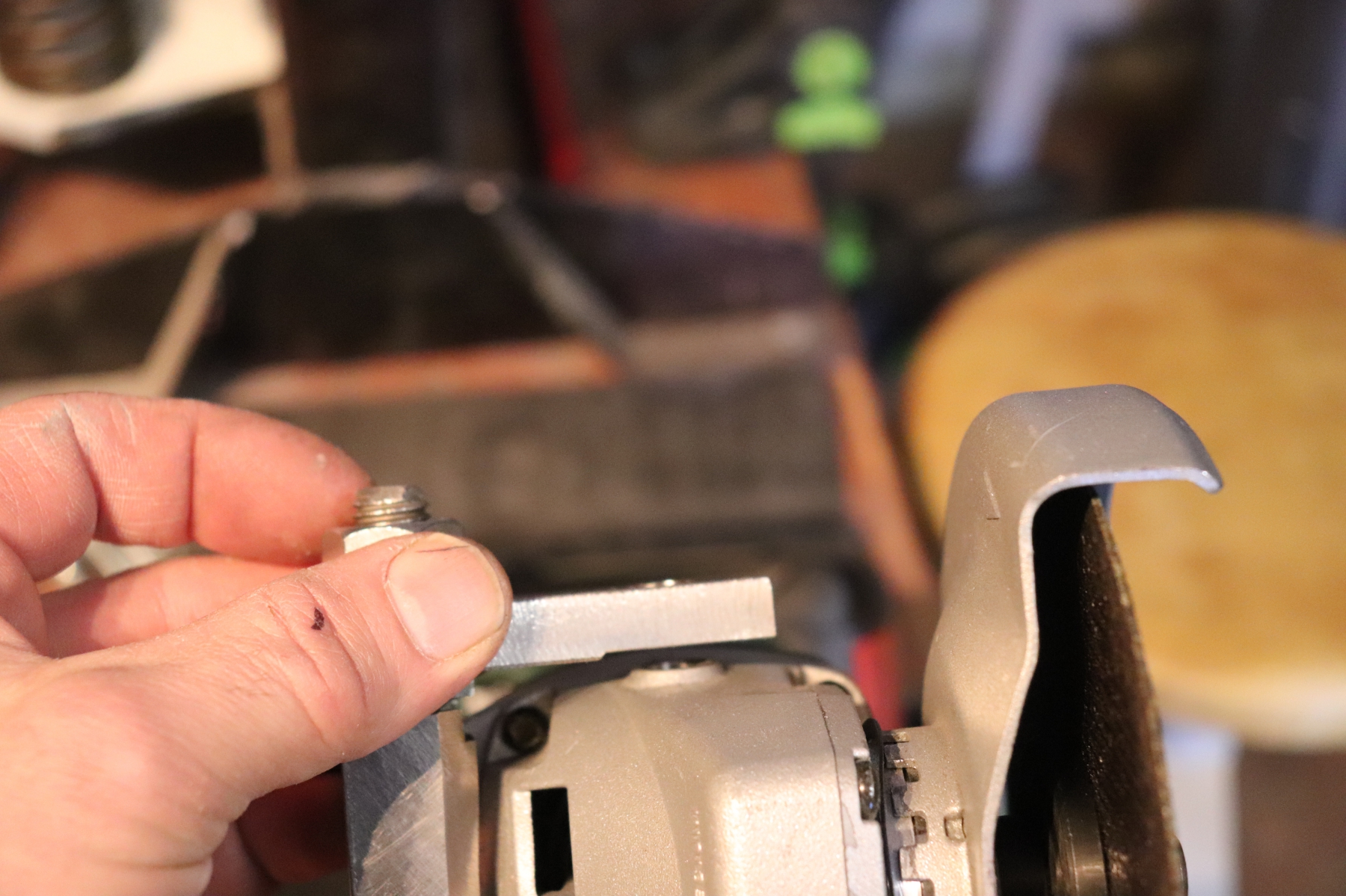

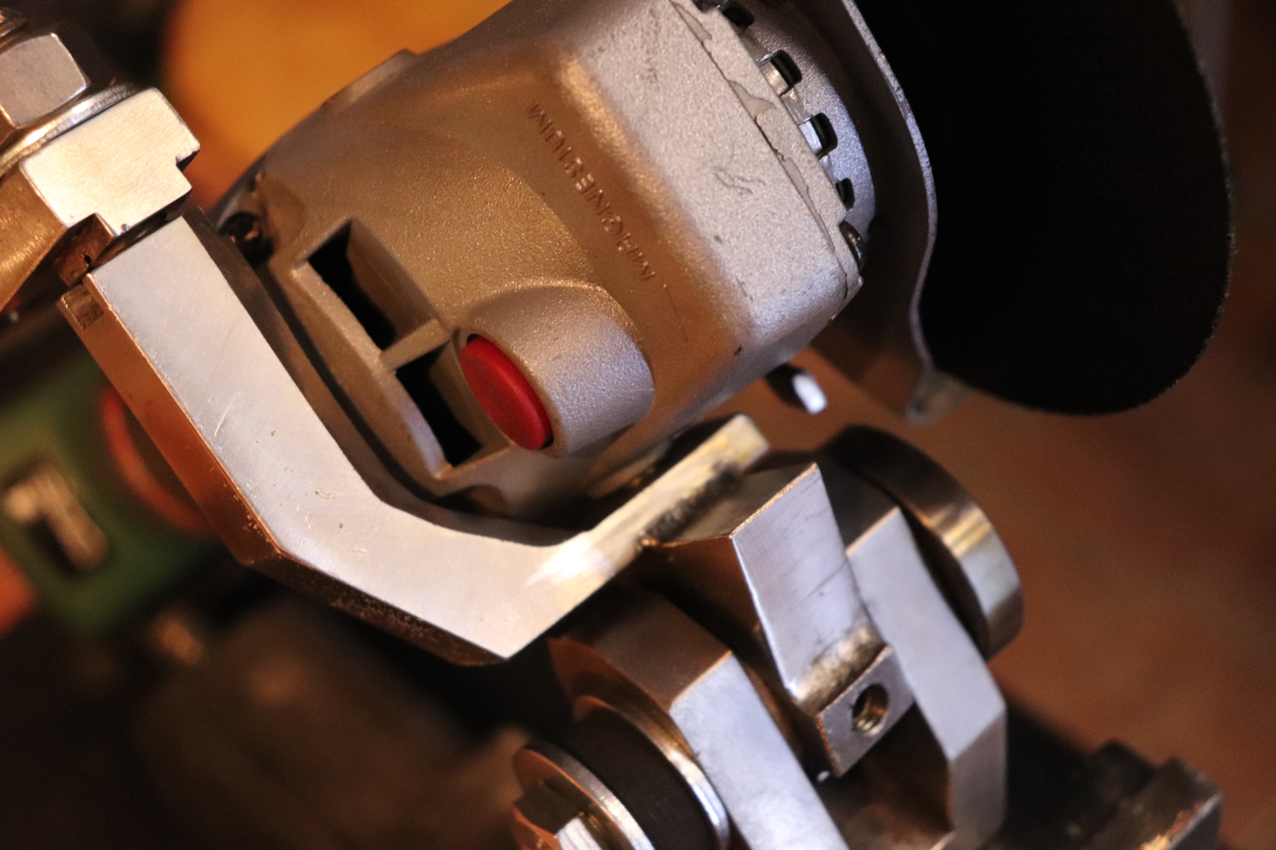

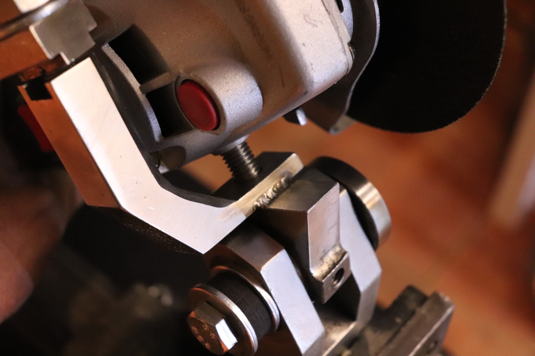

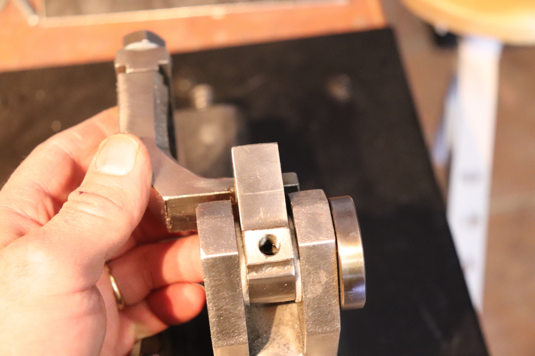

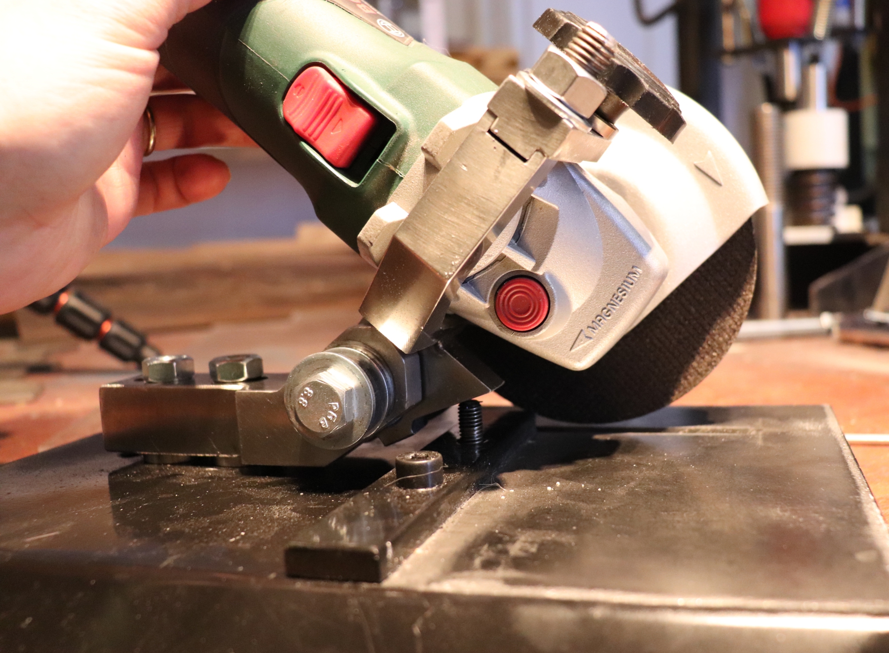

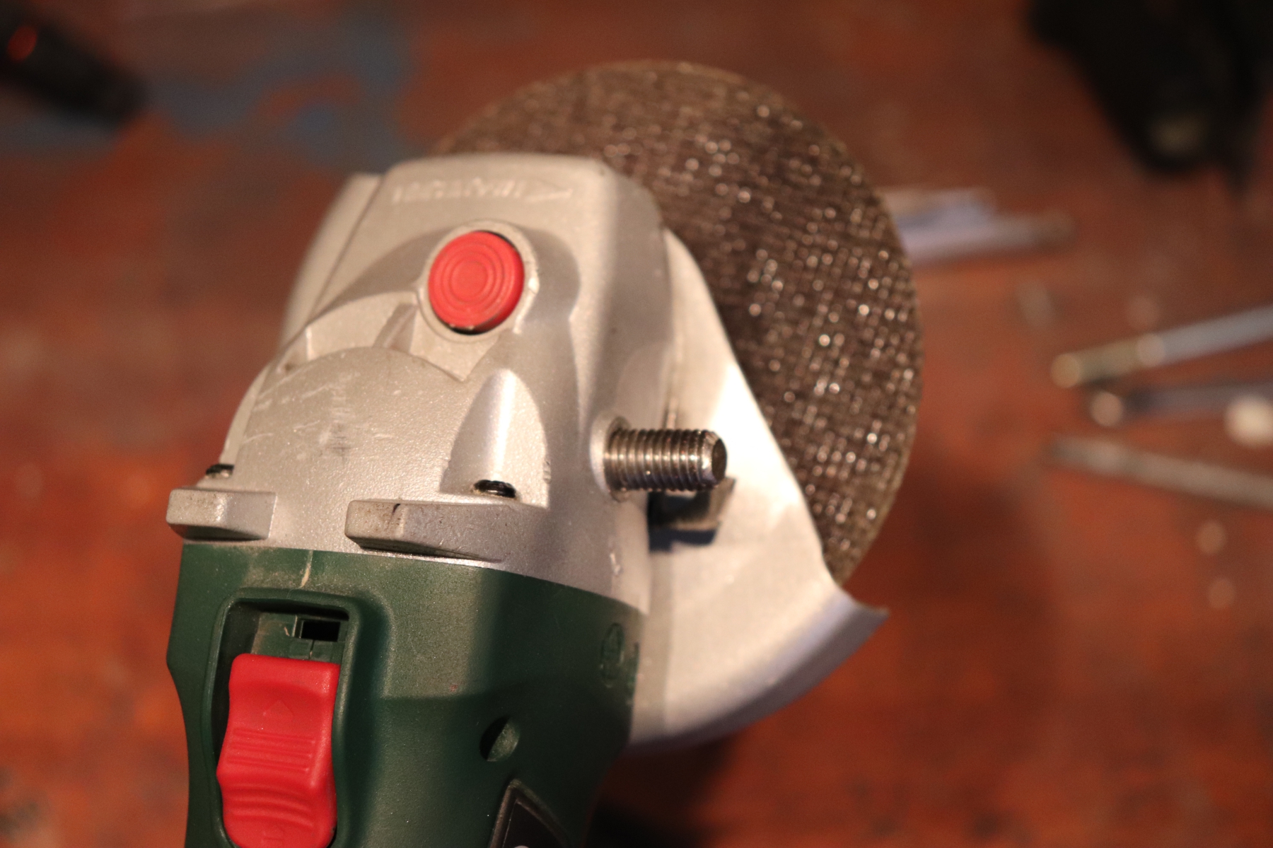

Made this kind of mount for angle grinder.
https://youtu.be/IVkguJXlhnk
My friend asked tool post grinder. I decided to build one with other uses too.
Pictures about the design comes little later.. forgot to resize them.
Material is stainless 316 and nylon.
Stand is made from mild steel.
